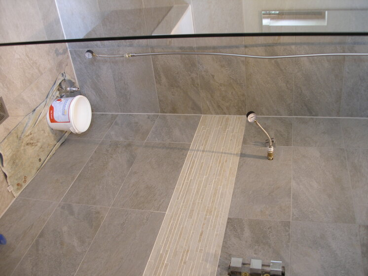

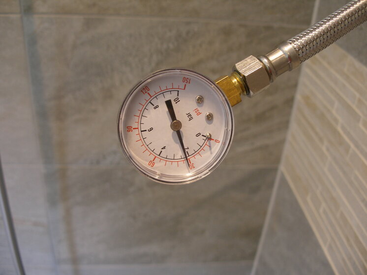

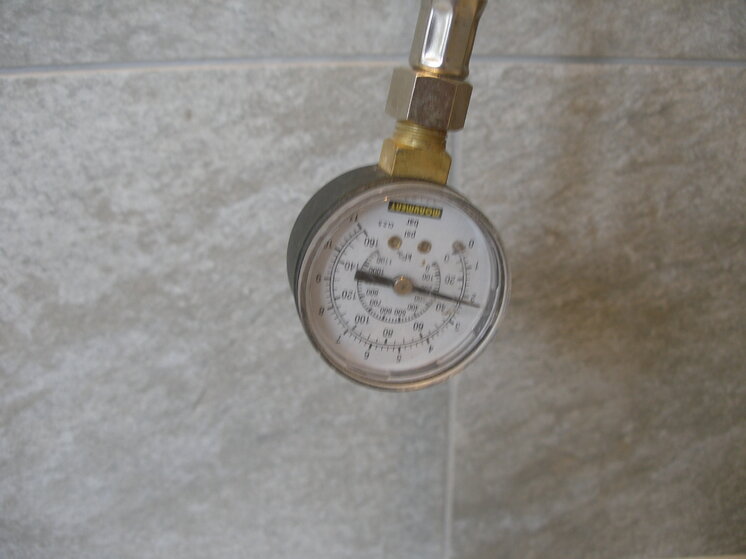

Anyway, was just going to update you as the plumber came today (at last!). It was the first time he had been back since installing the bathroom and was quite surprised at the extent of the damp patches on the grout. He pressure tested the two outlets (see the picture attached) at 2 bars and there was no drop in pressure over half an hour or so. He seemed to mend the drip in the elbow of the hand-held shower by putting some more tape on, but thought this had been unlikely to be the cause of the problem as we hardly ever use the hand-held shower. When he dismantled the valve there was no sign of leaking behind it.
So....not sure where that leaves us now! He wondered if there was still a pool of water under the shower tray tiles dating back to pre-epoxy, and that since applying epoxy grout, this dampness can only escape by travelling to the areas outside the shower tray which still have normal grout. I suppose that it is possible that this drying out is not an even process, and that maybe some days there is more evaporation than others, which we mistook to be leaks from the pipework, but could be unconnected?
He thought the only way to test this was to turn up the underfloor heating (which is all over the floor apart from in the shower tray) and try and completely dry the damp patches. Then to start using the shower again and see if it comes back. If it does, we know it's not coming from the pipework, but getting through the shower tray somehow. I wonder if it is getting in around the drain, as the tiles have been cut very tight to the drain here, so there is not much grout in the gap?
In any case, if it is getting through the grout it should not be pooling under the tiles, should it? The tiler thought he had fixed this problem by pouring more adhesive down the gaps when he removed the old grout, but perhaps this didn't work?
So that's how we left it. I'd be interested if anyone disagrees with this logic, or has any other suggestions on how to proceed? It seems we have ruled out plumbing problems!
Meanwhile, we have a very warm bathroom floor!

I was looking at his pressure test , the way your plumber has had that rigged up its only testing the two outlets unless hes done the test from the main stopcock and not the actual shower valve , by using the main your actually testing the whole house but its the only way to test the actual shower valve unless youve access to the pipework,

yes, you are right, but he took the faceplate off the main shower valve and inspected inside (it is buried in quite a large void in the wall) and there was no sign of any leakage from any of the pipes leading into it (I had a look myself). I can double check this with him, though if you think it's relevant.

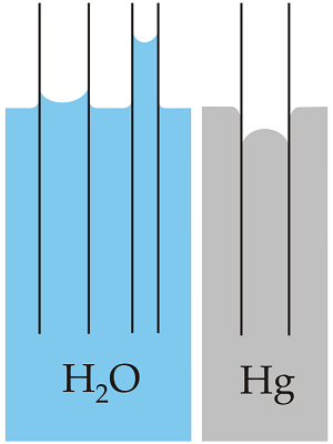

Water wouldn't disperse from behind the tiles like that. It would equally spread across the whole floor at the lowest point. The moon makes waves move because of mass. It doesn't make individual molecules move anywhere. It's not a magnetic attraction.
Gravity is stronger on earth (because of the greater mass) therefore the molecules collect and form a drop and it falls down.
Different when water is in air they're rising with heat not the moon though lol clouds don't follow the moon.
The particles in the grout aren't close enough together to cause 'suction' which is what can happen in a thin straw and the shape of the convexed surface area causes the water to climb because the weight of the water doesn't have enough mass to fall down and work against the shape of the surface area.
Evaporation only really starts when it's at the surface already. So it's not evaporating behind the tiles.
It's dispersing, spreading around, and it will try to disperse equally. But that would mean it would be a much slower process and the whole floor would have the same damp feel. And I dare say nowhere near enough to cause a droplet. Let alone enough to wet tissue.

So it's usually okay for tiles to have cement-based grout, it get wet, water get behind the tiles and soak a bit into the cement-based adhesive, because the water that collects will fall into the drain, and the remaining water behind the tiles would disperse and dry out via the grout generally across the whole floor.
You'd get wet / darker grout using the shower, and a hour or so after, it'd dry out. Wouldn't stay patchy, but might be a bit patchy during drying out etc.
The epoxy has perhaps if anything stopped a bit of that and is pushing the moisture further into the bathroom maybe.
But the fact you're getting droplets of water and it's in quite a few grout lines, but then not others right next to it, would suggest as Deano's said, it's fresh water that's quickly gathering, and taking ages to dry out.
So I'm not sure what's going on around the drain. But it's okay for water to get there usually, as the drain would get rid of it (gravity) and the rest would disperse into the floor generally and evaporate once it's (evenly) reached the surface of the grout. But I've never seen droplets like the earlier images.
I don't think I've still answered you lol sorry. I just don't know what to say about it.
I'm with deano though, I'd have pulled a tile or two up around the drain by now.
This was doing my head in. Couldn't for the life of me remember what it's called when water climbs something due the the skin shape on the surface of it.
"Capillary Action" it's called. Capillary Action of Water: Definition & Examples | Study.com
So the water keeps trying to level out, but the edge of the water where it touches whatever it's climbing ends up higher than the centre of it. So it starts to climb. Weird effect of H20.
I didn't realise this, but it appears not every chemical does that. Every day's a school day.
Well, the tanking is meant to fall into the trap/drain. So the tiles then just become aesthetics to make it all look nice and easy to clean. They're not there stopping water getting anywhere sort of thing.
JUST A THOUGHT.....
I'm loathe to do that as that will probably damage the membrane. From what you are saying, I just wonder whether the problem is arising with the shape of the shower tray? If you are now saying that it is normal for water to get under the tiles around the drain (I thought before everyone said that this shouldn't happen unless the adhesive was spread unevenly and there were lots of gaps?), but that is OK as gravity will cause it to fall into the drain down the slope, then maybe our slope is not steep enough?
That may have lead to more 'pooling' of water under the tiles than would normally be expected, and therefore it would take much longer for the water to evaporate through the grout, leading to permanent damp patches (which is what we had pre-epoxy). Now we have stopped evaporation through the epoxy, the water is just migrating to where there is normal grout, through which it can evaporate (this is how plants move water from their roots to their leaves, as evaporation takes place through pores in the leaves and leads to a difference in water potential from leaf to root, hence flow of water). So that's why we have damp patches beyond the shower tray.
How would I find out if anyone else has had this problem with an Impey tray? When I originally spoke to them, they said that I should not have any permanently wet patches and that it was a tiling problem!
If you have cement-based adhesive, and cement-based grout, and have tiled to a former, that runs into a trap, and you use a shower, you have water behind the tiles. As it's getting through the grout. That isn't water PROOF, just doesn't break down with water.
So it's going to fall into the trap.
Right?
Am I missing something?
Oh right.
Sort of renders tanking useless then if the tiles are the water barrier eh?
@Paula, listen to @deanotile, he's the tiler out of the two of us.
I don't want to tarnish the thread with a bad tone or anything so I'll stay out of it if I'm giving the wrong advice.
tanking is a failsafe so that if there is a problem the water is contained and the background is not damaged the primary waterproofing is the tiling.
