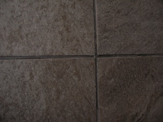

thanks so much for your considered thoughts, SJPurdy: it's great to hear from someone who has experienced similar issues. My grumpy tiler has come back today and liberally sprayed a can of sealer (Vitrex?) all over the shower floor and told me to wait for 24 hours before using. I've tried to take photos of the grout….but even though I tried to make them smaller this time, I still can't get the hang of uploading them. I have taken Cam up on his very kind offer of posting previous pictures of the shower for me, so I will email him photos of grout in the problem areas too and ask him to upload them, too. To my untrained eye there isn't any obvious cracking, but I'm sure you will be able to see if there is a problem.

That grouting is cracked.
I'm on my iPhone so can't get a good close up of it.
