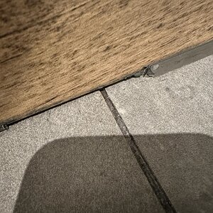

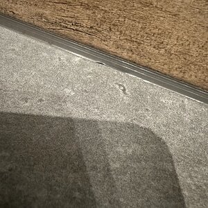

    not good anyway. usually corrections are done over the door/architrave as it is difficult to go around a bathroom and meet up exactly. Having said that, it is much easier nowadays with a laser.

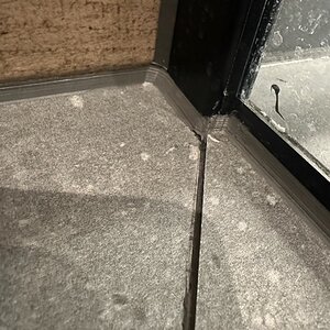

    This floor should have been screeded to encase the pipes and provide a flat floor prior to tiling using a flexible self-levelling compound (or other) suitable for underfloor heating.
    The use of a tile clip-system for installing the tiles is highly unsuitable as it has created hollow voids...
