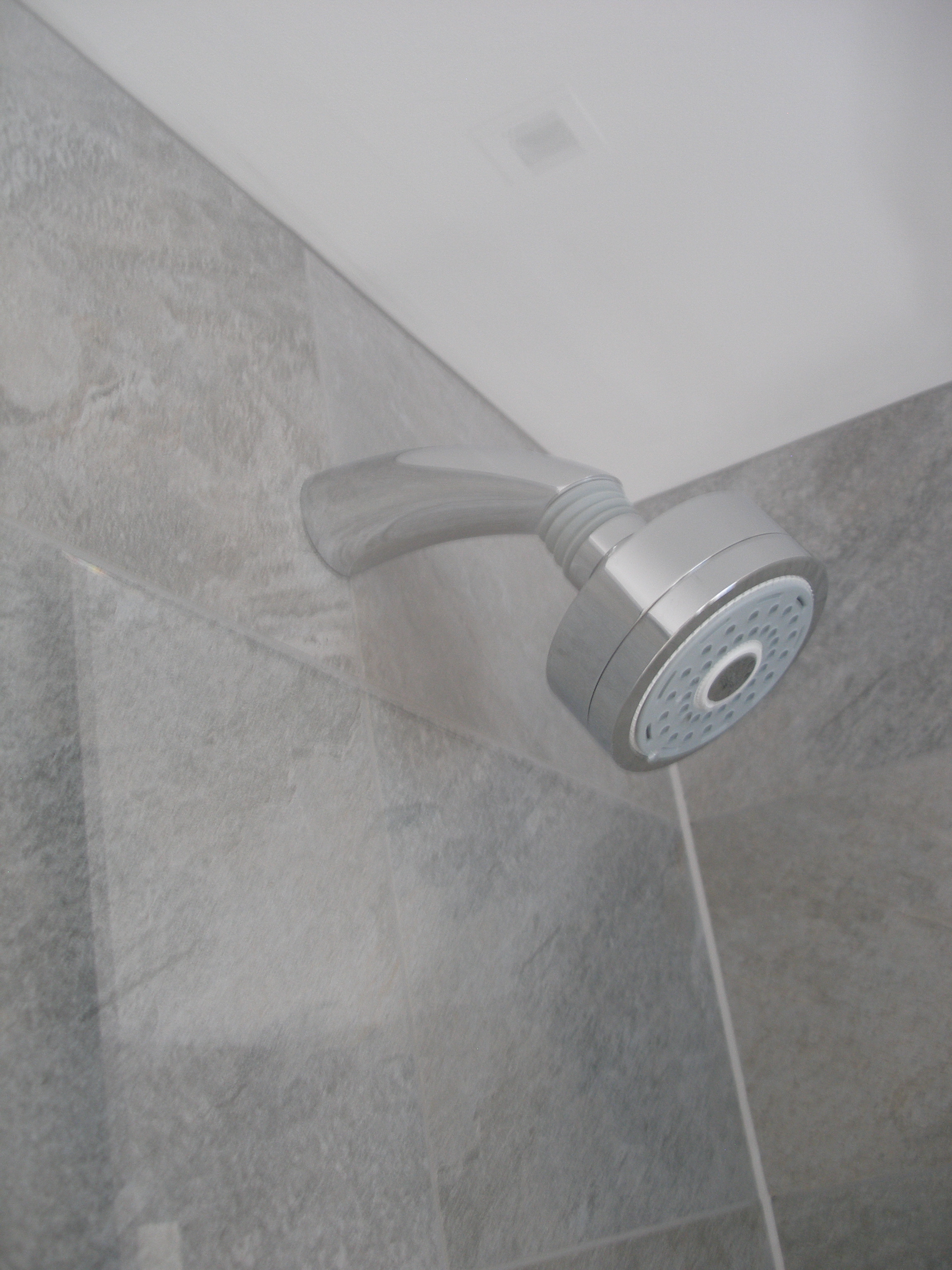

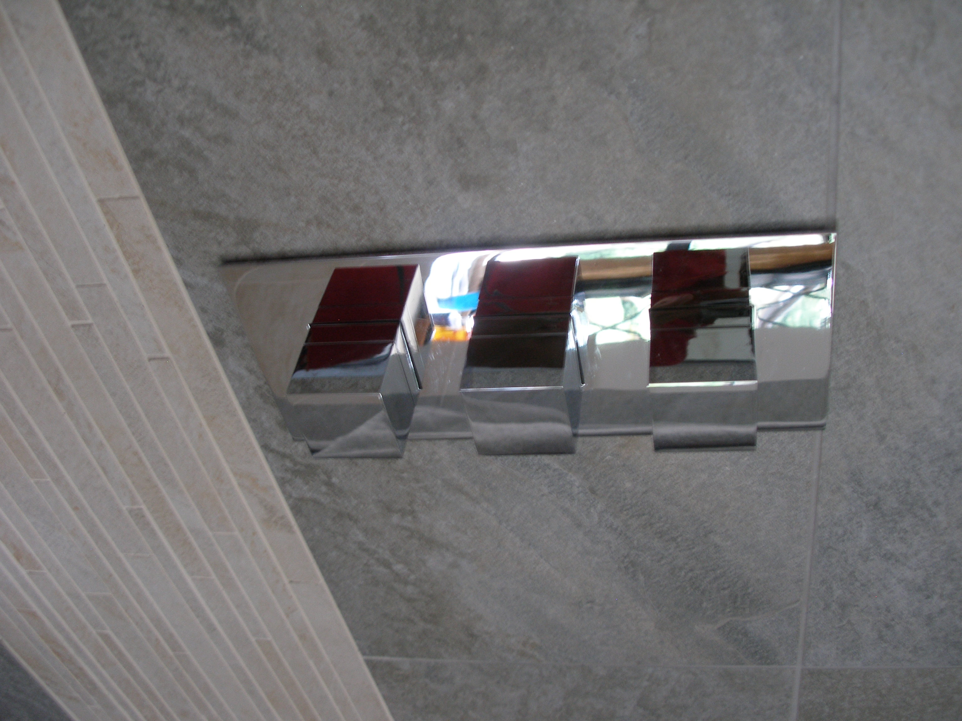

OK, Bob, I've taken some photos of the fixed shower head (very expensive Grohe, solid brass) and the valve (Crosswater, also brass I believe). Hope this helps!

Thanks Paula, is there any pipework for the shower visable from the loft?
