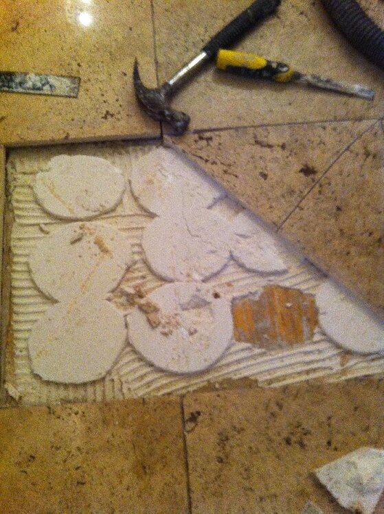

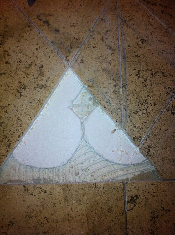

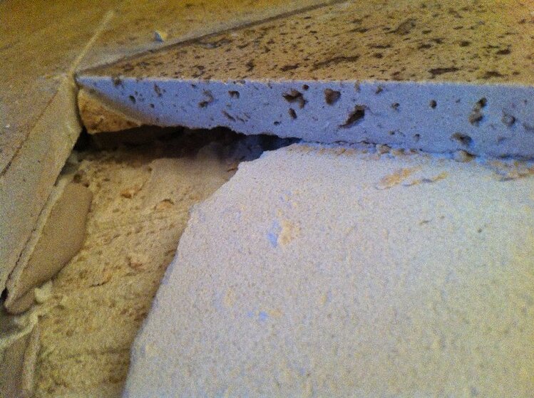

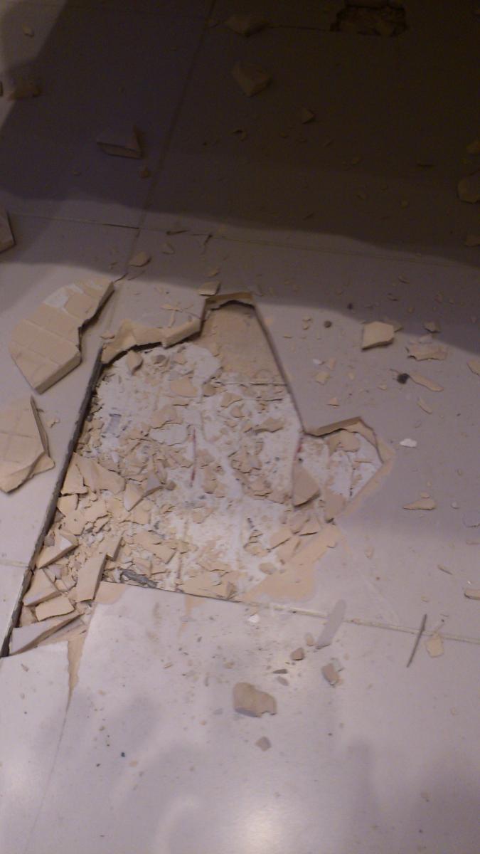

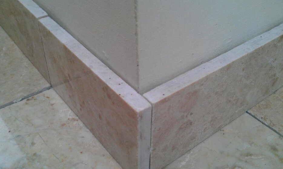

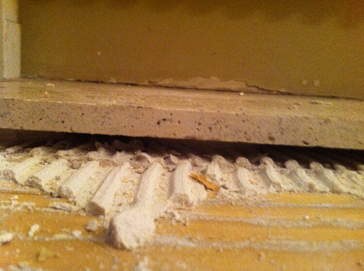

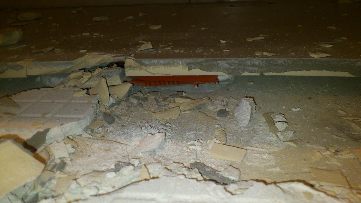

Here you go. 10 cracked Travertine tiles in a floor due to bad tiling. Travertine floor-Tunbridge wells 001.jpgTravertine floor-Tunbridge wells 005.jpgTravertine floor-Tunbridge wells 007.jpgTravertine floor-Tunbridge wells 009.jpgTravertine floor-Tunbridge wells 010.jpg
Nice one.
I thought somebody must have seen something somewhere 🙂
Bubble were the tiles blown or loose ? or had this fixing method worked just out of interest ??
The ones around the pan were cracked but the rest were fine & so was the grout. TBH, it took me HOURS to get them up. They were a nightmare!

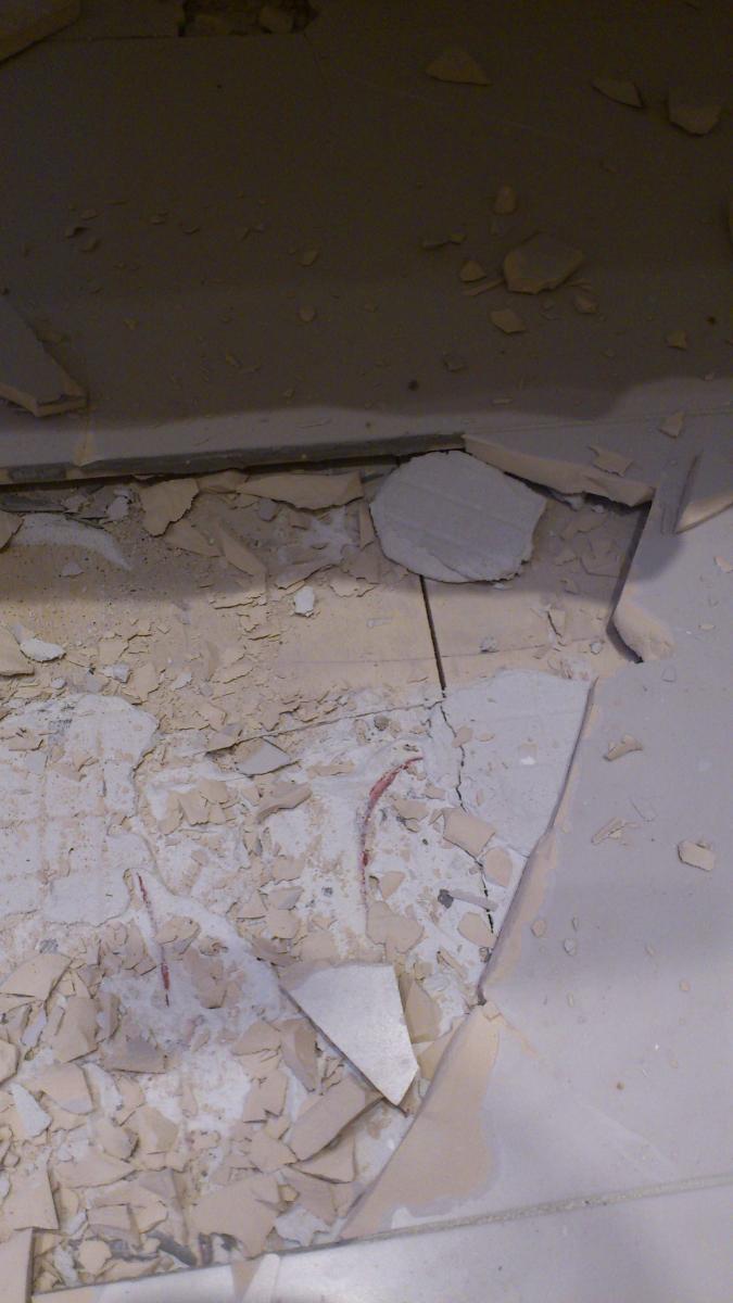

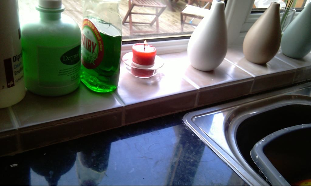

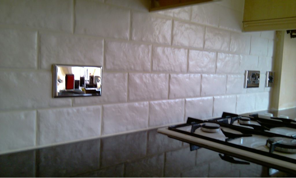

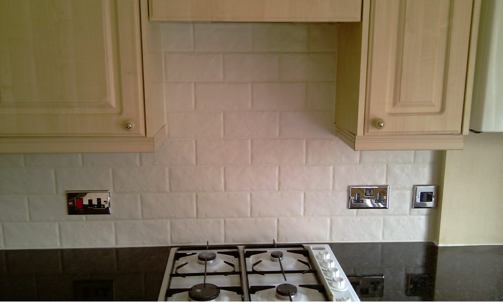

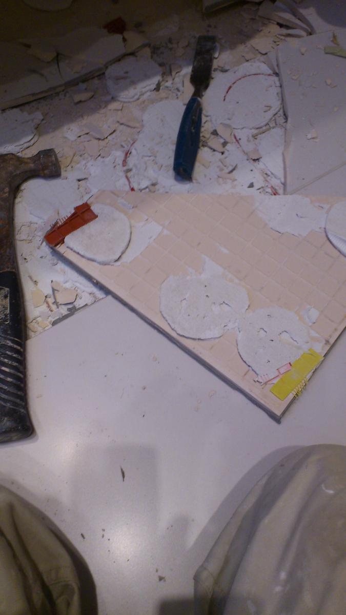

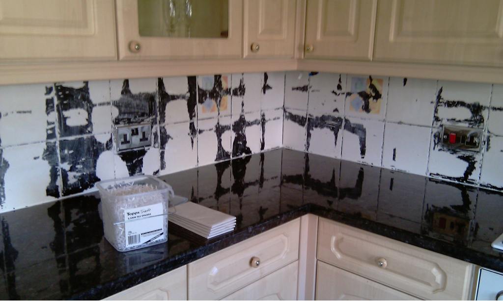

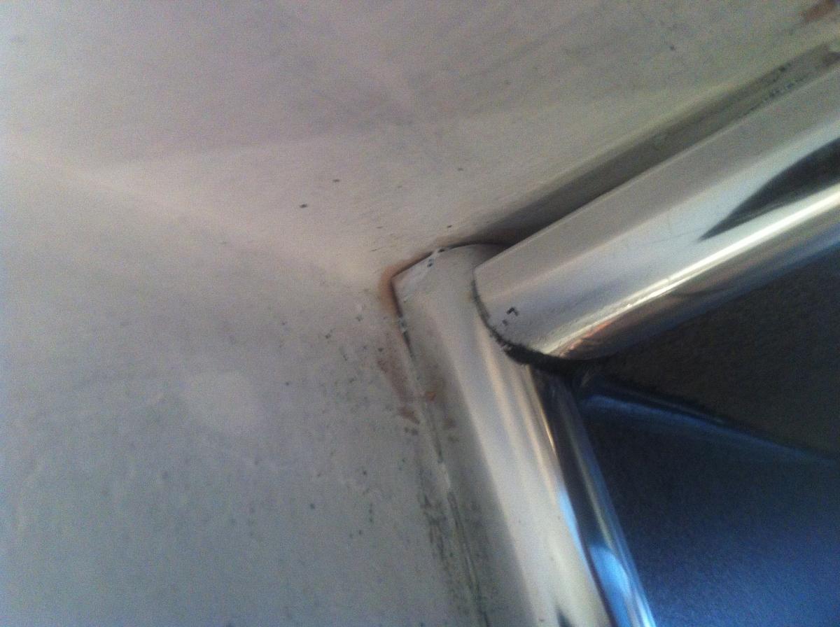

And there was this one. Guy started @ 9am & was still there @ 10.30pm that night to do 4m2. This is the result the customer got:

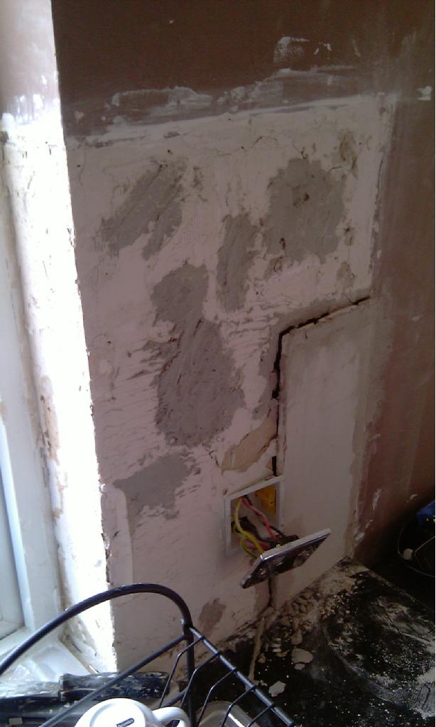

After removal of the tiles I noticed some areas were packed to at least 25mm with ready mixed addy. The plasterboard had been attempted to be stuck to the brick wall with a 50mm cavity with ready mixed too.
He stuck the tiles to painted existing tiles
I started @ 9am, removed both sets of tiles, re-sheeted, tiled, grouted & siliconed by 3pm. God knows what he was doing to be there that length of time. Customer even bought him a chippy @ 7pm as they felt bad for him.

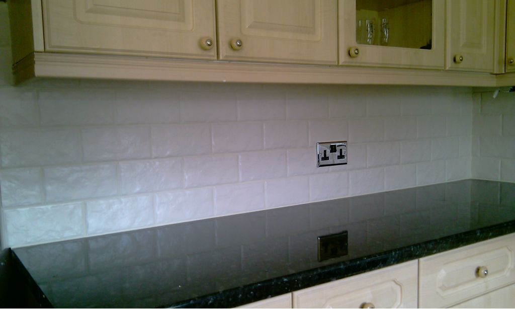

Heres the end result with Milford Cream I think it was
i know that Blob fixing or dot/dab or whatever you like to call it, is frowned -on and not -up to BS, but it's equally still not illegal to fix like this it's just another way to fix tile ( i and most on here would never dream of fixing like this ) but as said i think it allowable !!! technically .......

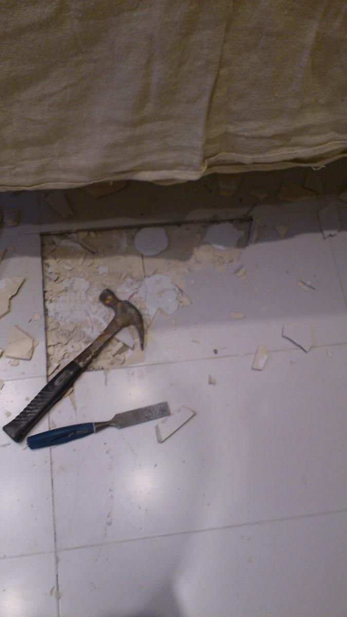

Not good. I bet they didn't sound as hollow as you'd assume either then. Silicon would take the impact from the coin test too and make it sound a bit duller than you'd get with adhesive.
Suprised the grout held up though. It's a vote of confidence for whatever make that was!
They didn't sound hollow at all. Even at the pan where they were cracked. I had priced to uplift them if fitted the correct way or near enough. Normally would have had it all up in about half an hour. Took me a whole day! Couldn't even let the customer know as he was abroad so just I took the hit on it.
The grout must have been mixed with a latex to hold up to that

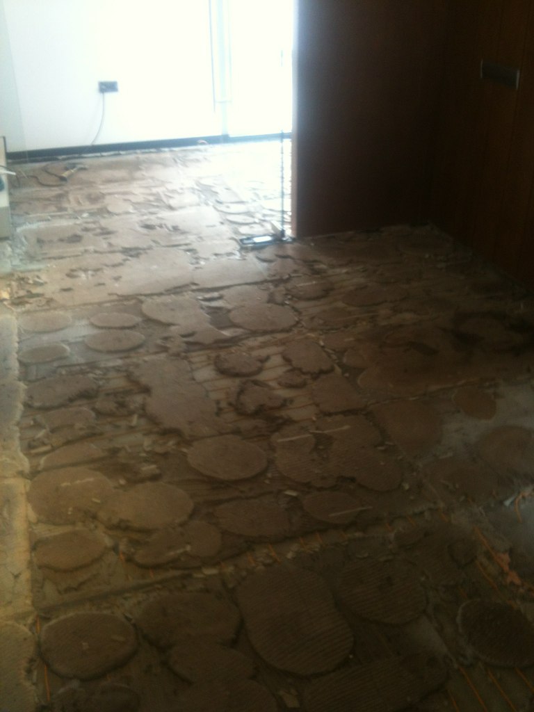

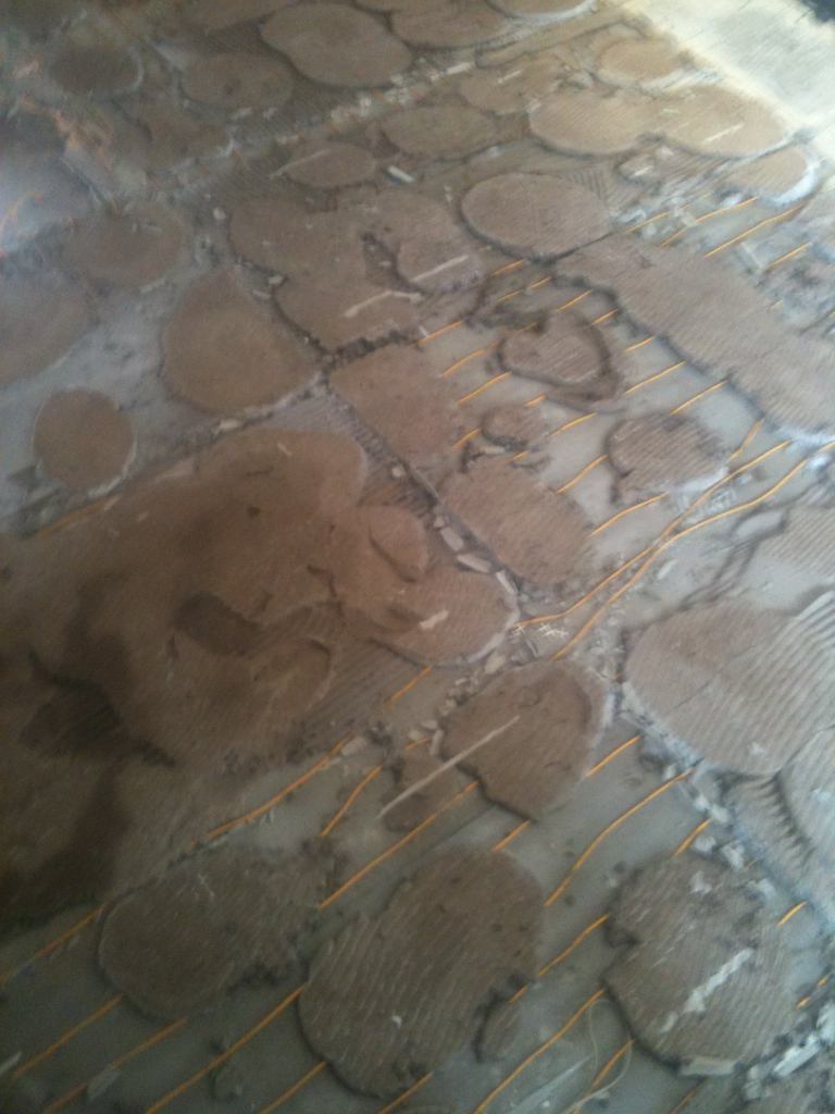

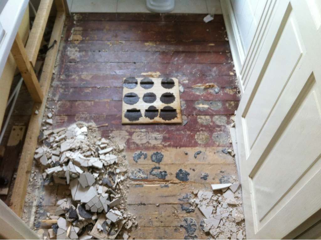

I've posted these before I think, dot and dab over UFH, 1200x600 porcelains. Was only there to replace a couple of loose tiles, ended up ripping the lot up and starting fresh.
They were put down in 2008, customer bought the house last March, I found the house on Zoopla and they paid 950k for it, there is approx 300 m2 of tiling all fitted like this, it's only a matter of time before it all fails.
no using trowel under vanity unit , toilet.... just little dots of adhesive :mad2:. Cheap ply screwed on few screws (drywall screws), some floor boards not fixed. So i ripped everything off, and started again :thumbsup:

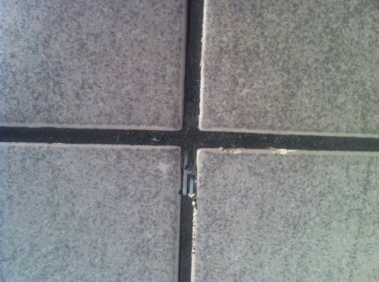

I have a few pics of cowboy workmanship...

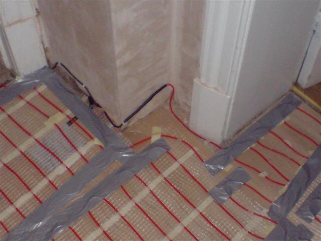

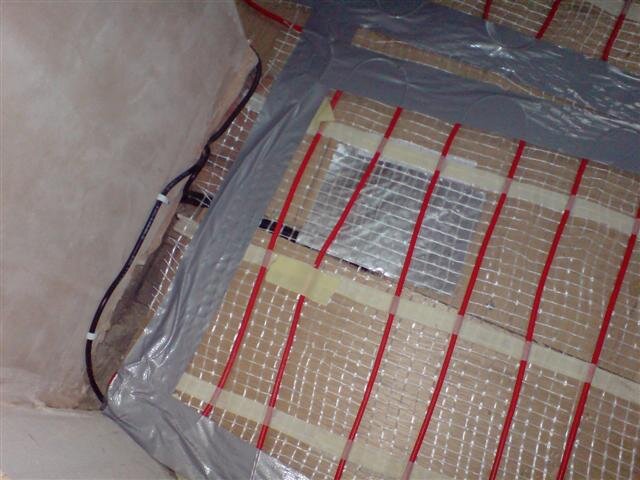

This couple show how NOT to install sensor in UFH..
i would use more of that tape, to stick ufc down :lol:
- - - Updated - - -
Did you have to sort that out for them Dave? At least it didn't get tiled over, or did it????!!!!!!
It was for a company that is now B/rupt... they argued it was ok and said tile it.. 🙂 .. so SLC over it and tiled.. what happened after that god knows :lol: ..

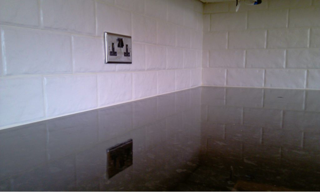

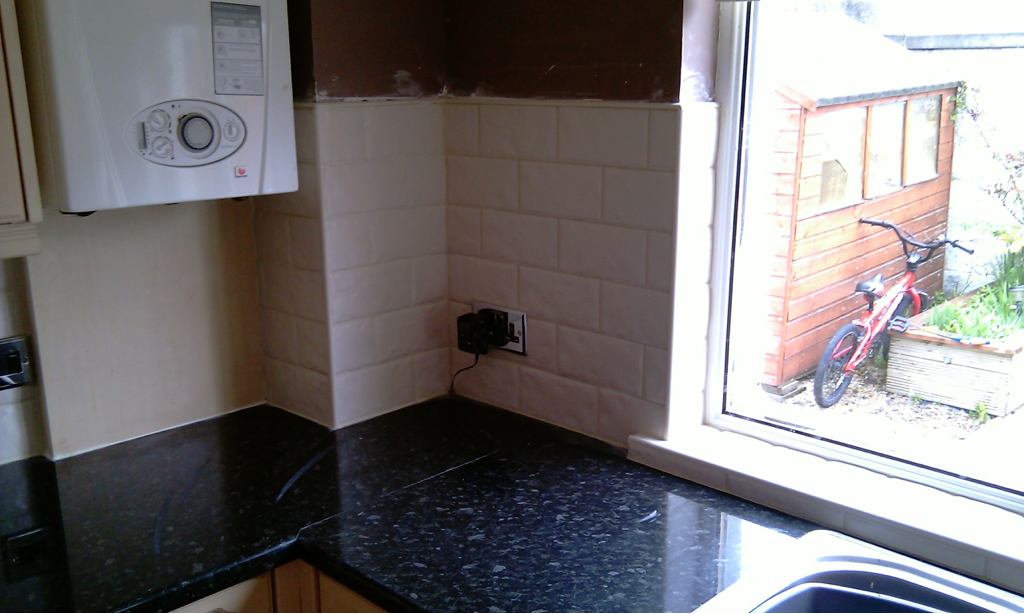

This one is on going , so yet to be resolved...cannot say anymore than that but i have it to lift and relay if it goes ahead , after getting the cowboy who laid it to cough up.

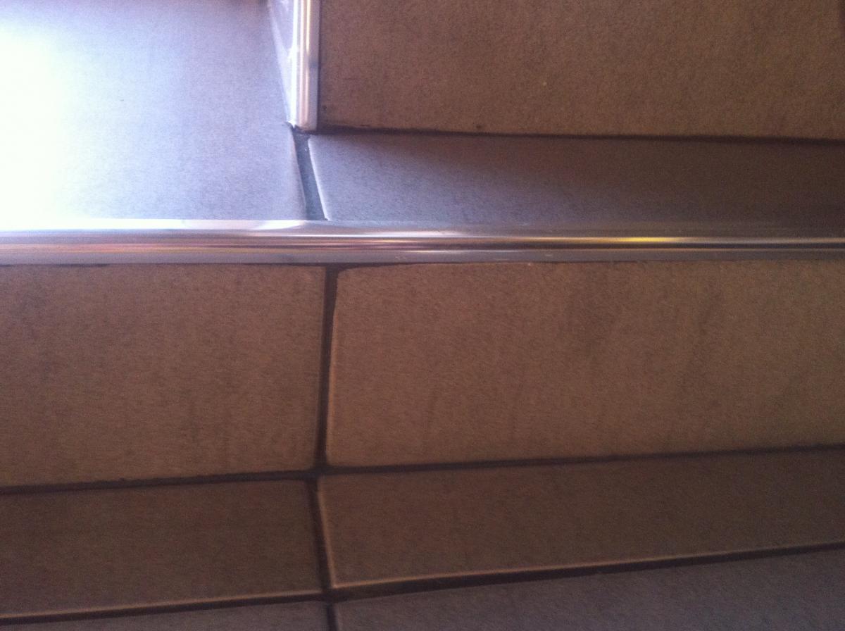

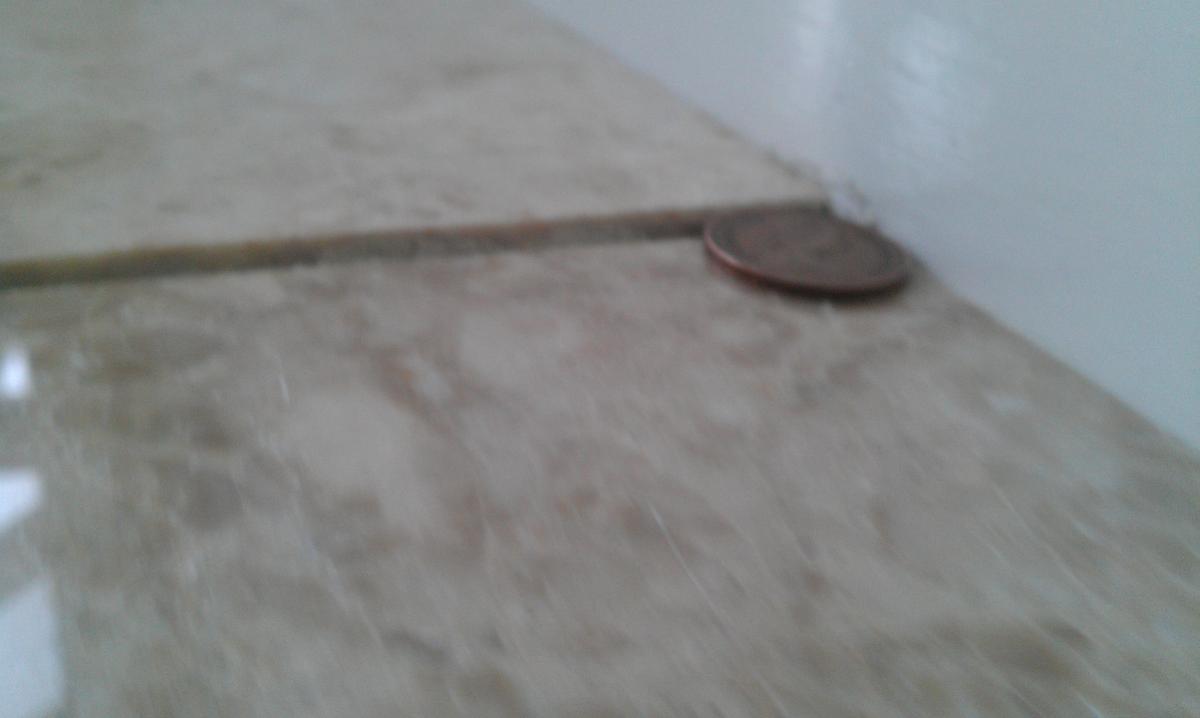

check out the polished skirt edges ..NOT!!! .. :lol:

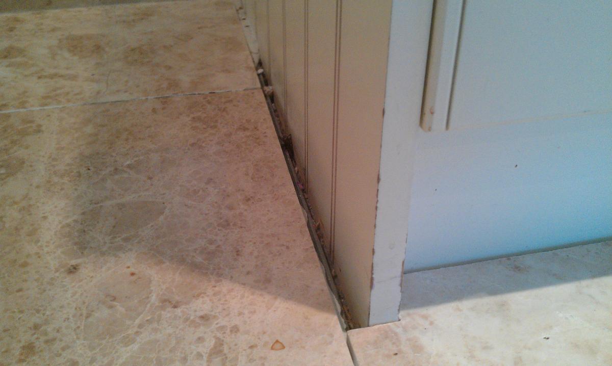

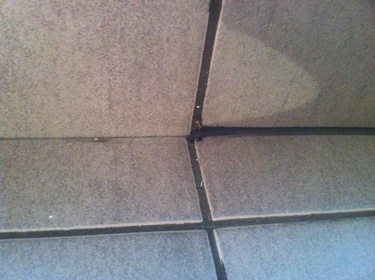

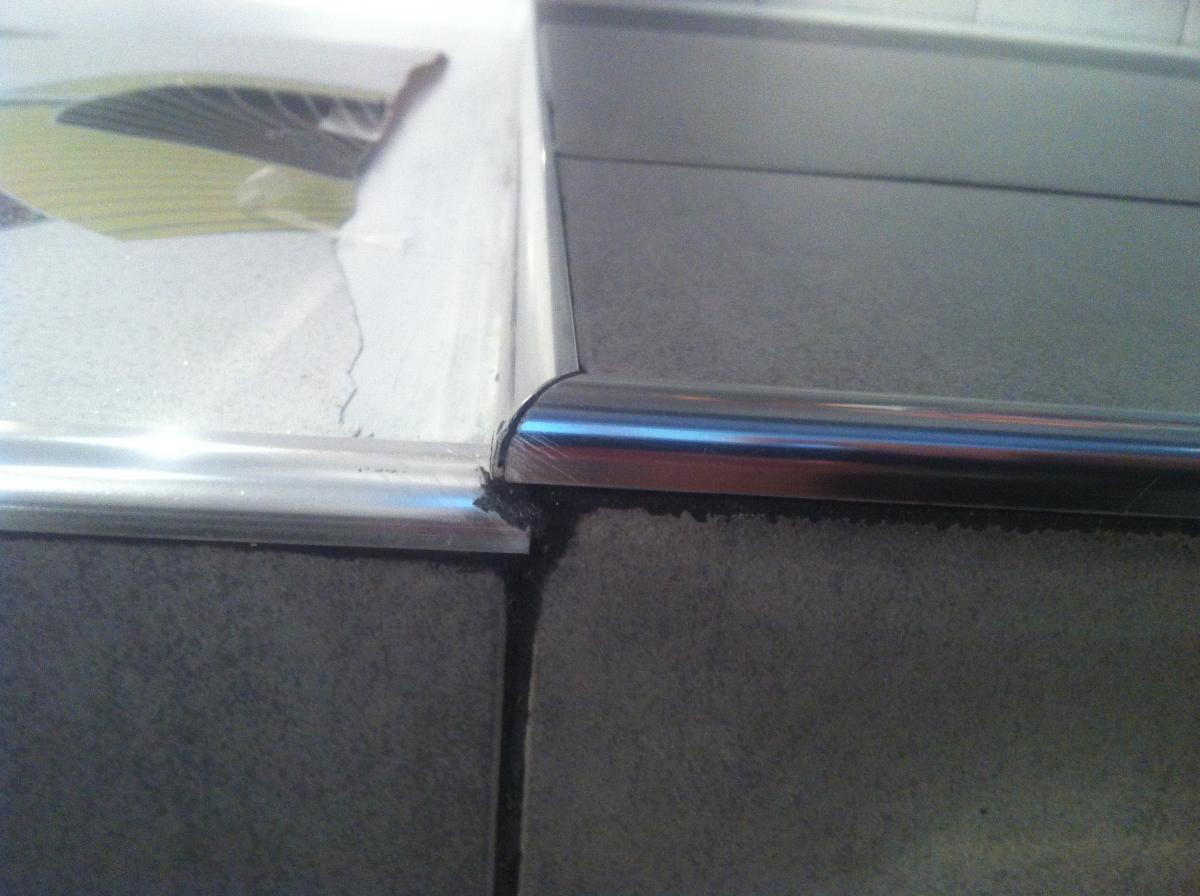

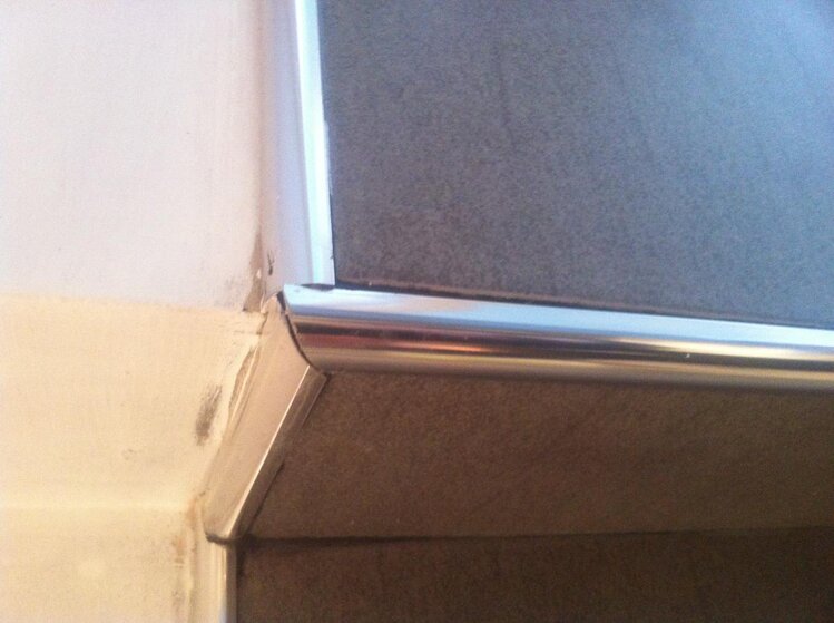

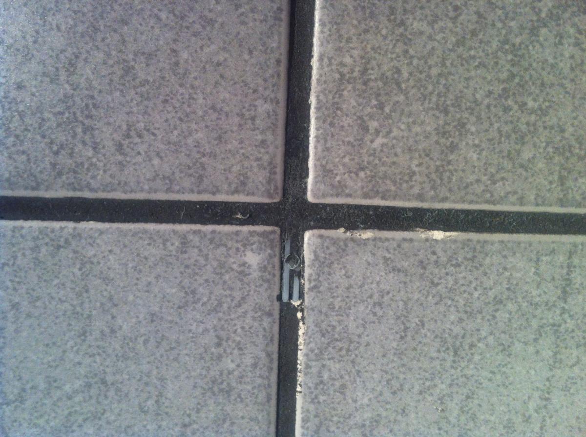

This customer was charged £3k for tiling alone in this bathroom by a builder. As I understand it it it still ongoing as to to payment and the remedy for all the problems.
This is just a sample of photos I took when I had to give an opinion on it. I told them they really needed to rip the whole lot out at the builders cost.
Apologies for the creak in the neck after looking at these :thumbsup:
