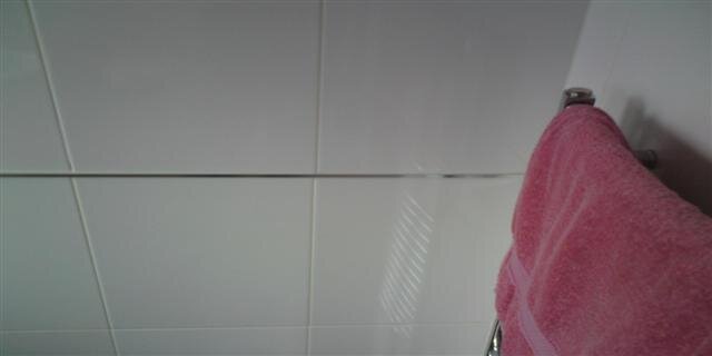

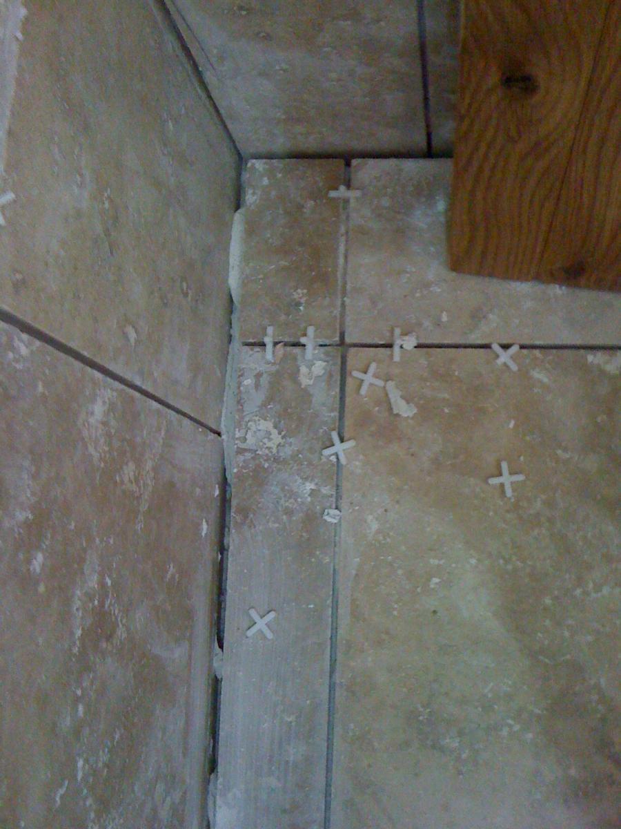

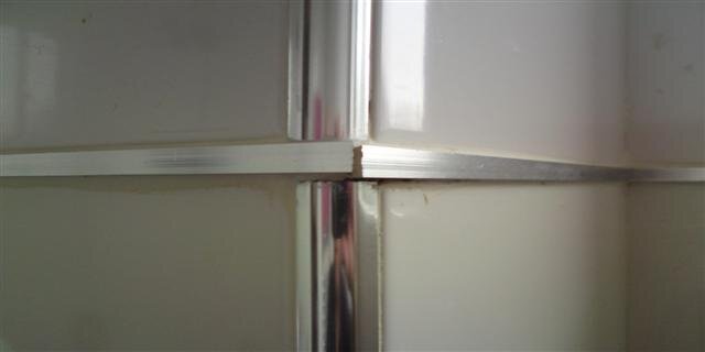

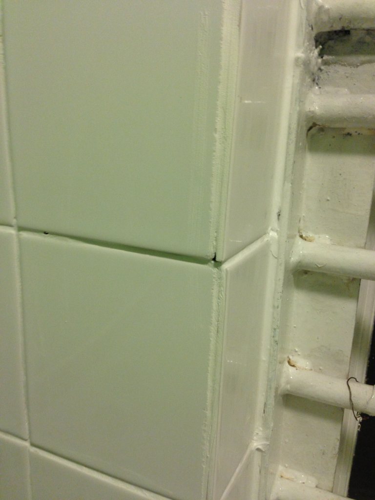

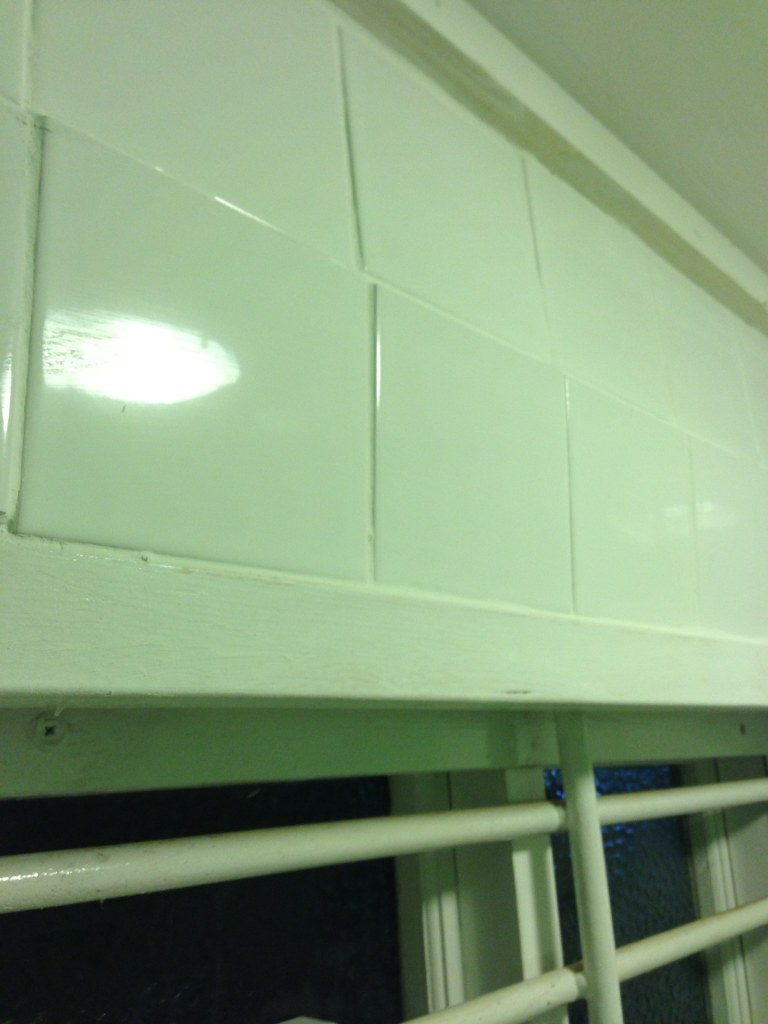

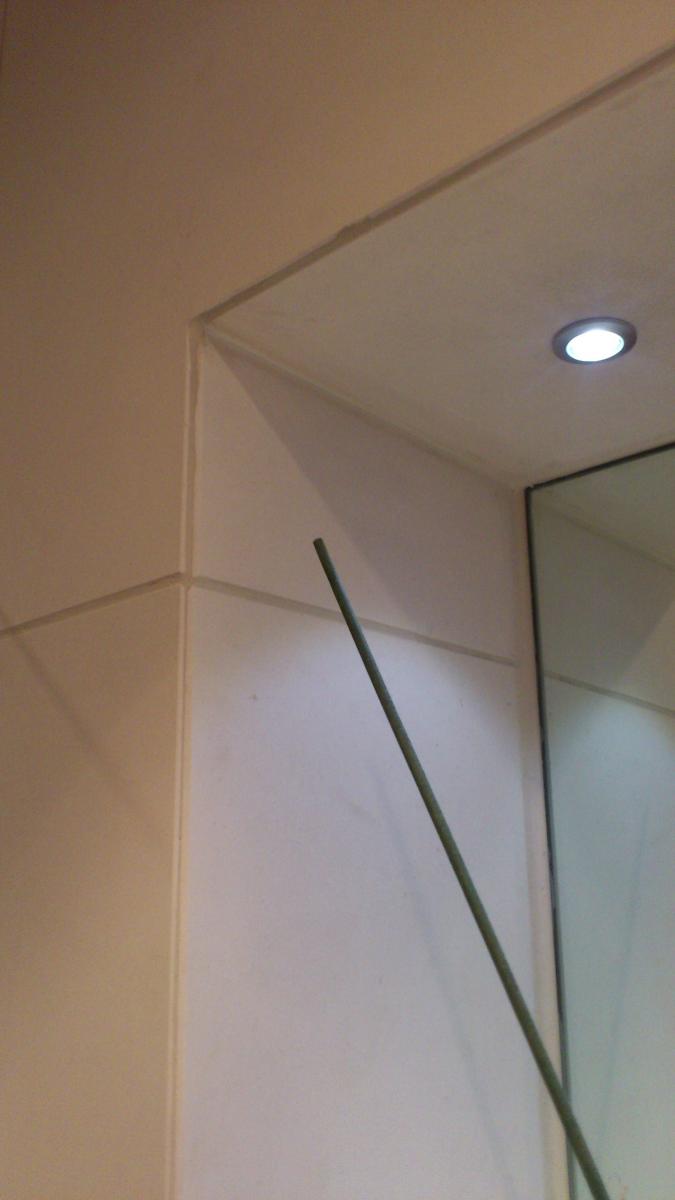

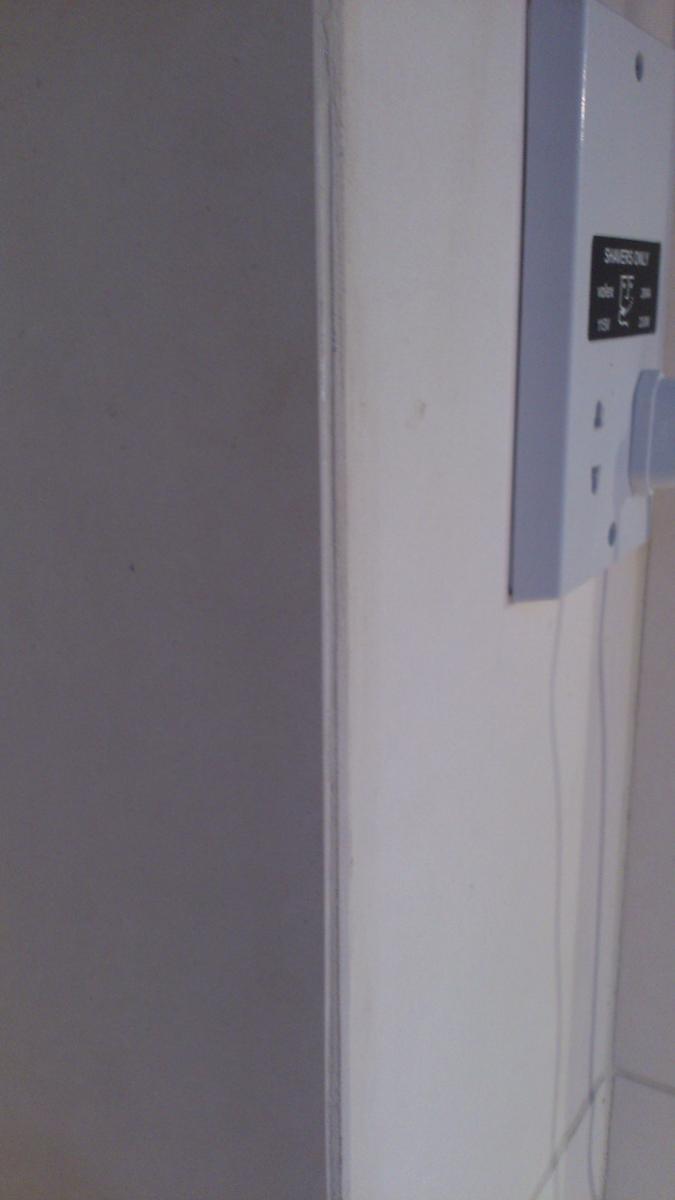

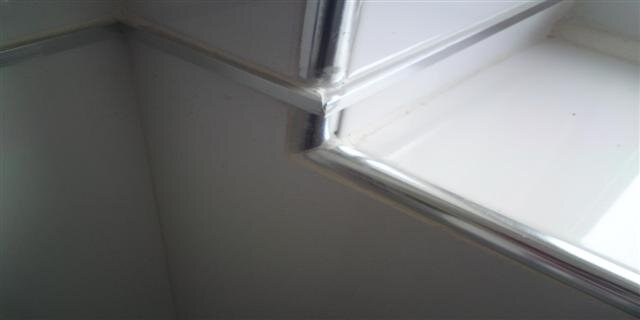

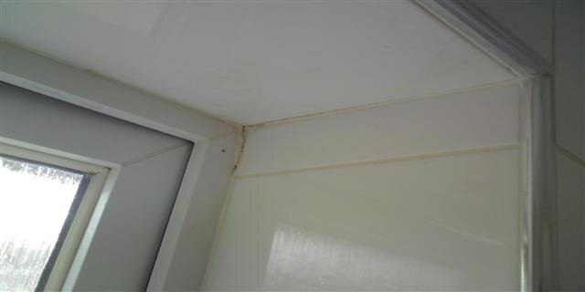

They are classic don't have a clue about tiling pics John, deffo a descendant of John wayne . :lol:

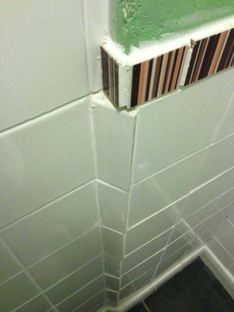

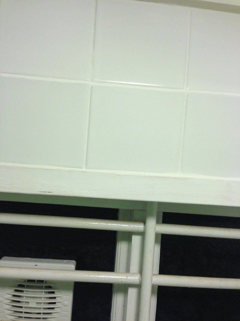

same house as above, just different builder did it
perfect mitre :lol:
I wonder if the people who do work to this level ever stand back and look at their work and think, that doesn't quite look right. Or do they look at it and think that looks great.
It's just beyond me.

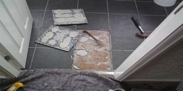

These 2 tilers that did it , ye 2 of them :lol: .. took a contract off me from a kitchen/bathroom comp .. they turned this type of work out day in day out till this happened at one of the salesman for the comps home :lol: ... let's say i got the contract back .. 🙂🙂🙂

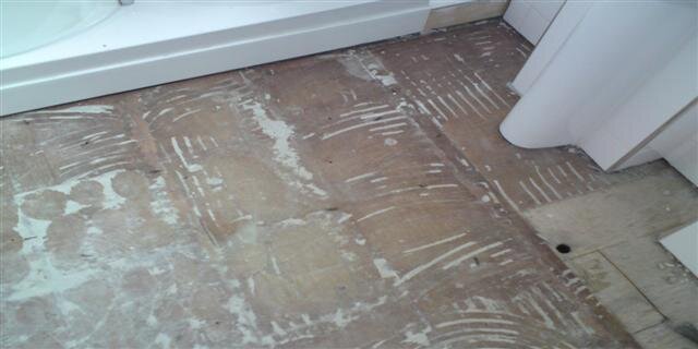

I went to price up a job last night, a recommendation from a previous customer of mine. Builders did some alterations 12 months ago. Bathroom 1 - ceramics dot n dabbed straight onto chipboard. Its failed.
Bathroom 2 - ceramics dot n dabbed straight onto chipboard. Its failed too, I can lift some tiles with my fingers.
En-suite - Acrylic shower tray rocking in 1 corner when you stand on it, probably the leg not tightened up. Its caused the Silicon to pull away from the junction of wall and tray. Also the corners are only siliconed half way up, the top half is grout and its significantly cracked.

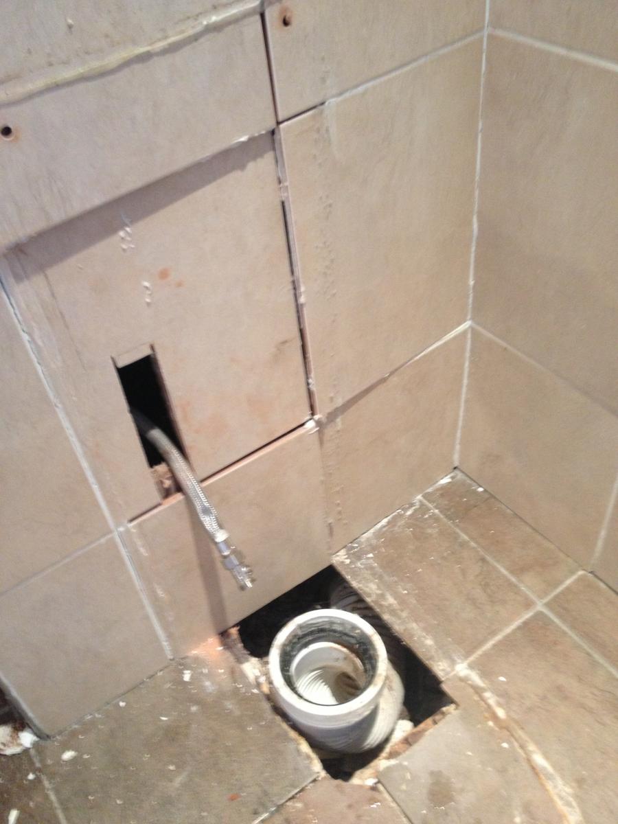

A few other minor issues - 1 WC pan has only one screw in it, the other side being filled with Silicon. They'd tried to hide this by siliconing a screw cover cap on. The other WC pan screwed down but an offcut of some blue plastic used to prevent the screwhead damaging the pottery. In other words a bit of a botch up. Neither W/B pedestal screwed down and the tiles behind both pedestals poorly cut and pieced in to save drilling holes for the feeds. There's probably more to be uncovered as the job progresses.

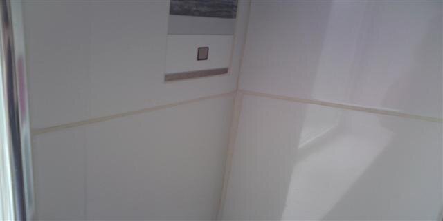

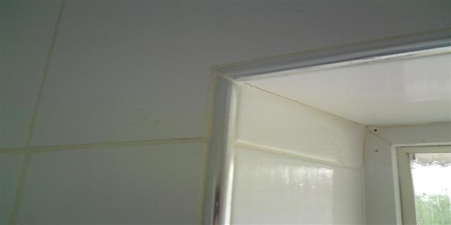

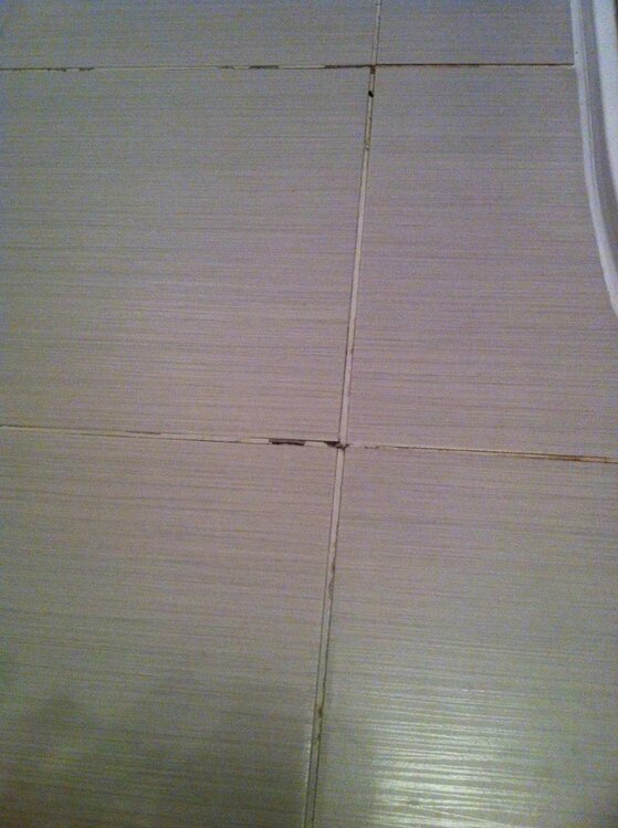

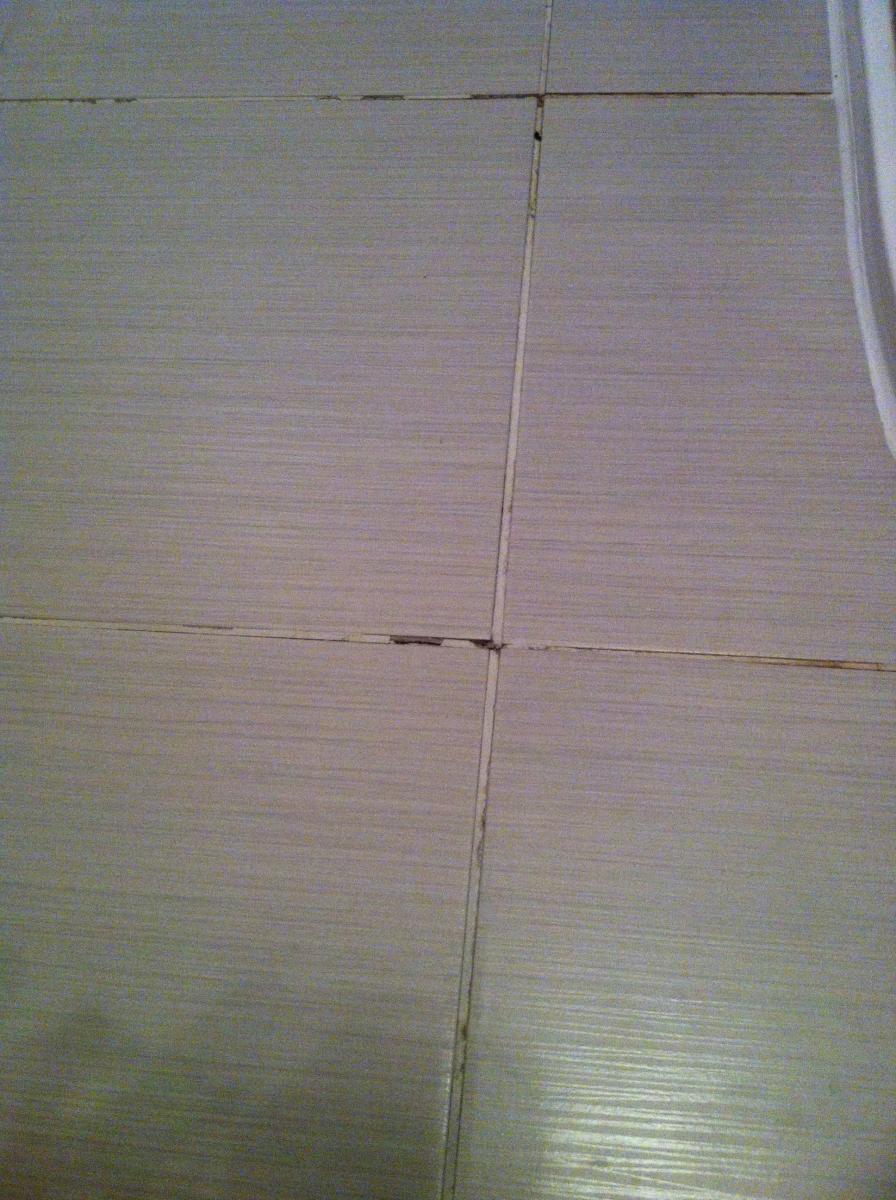

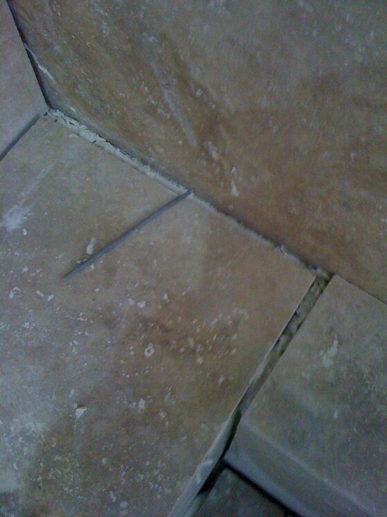

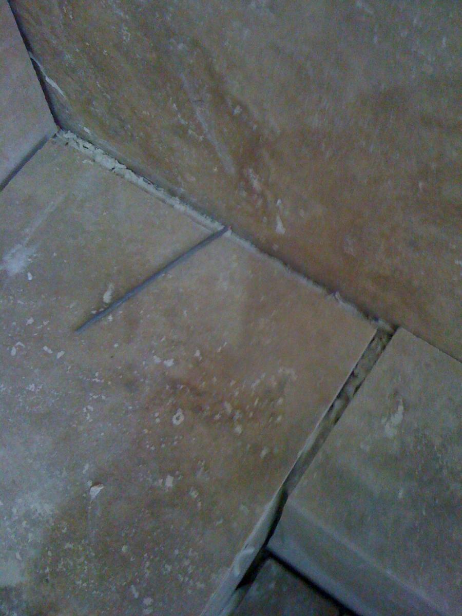

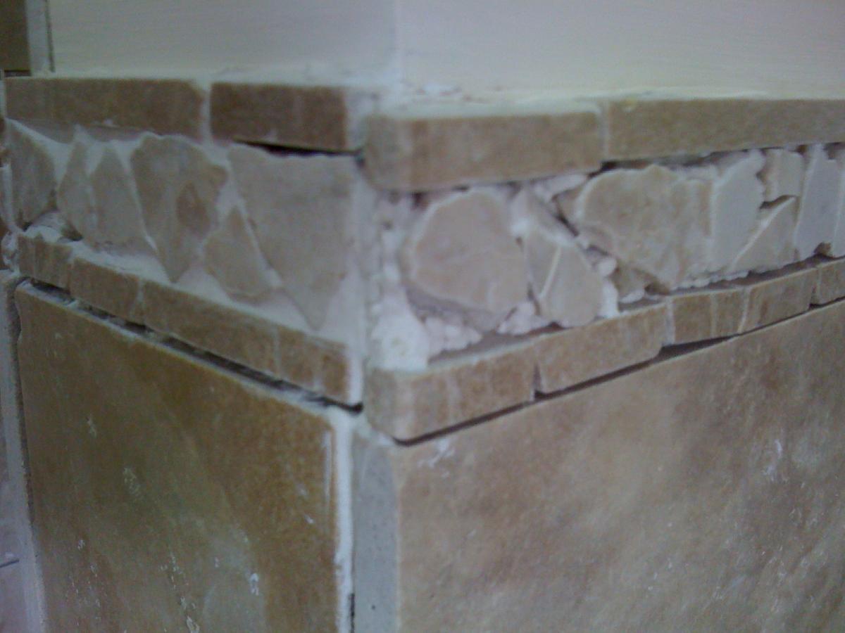

Took these photos a couple of years ago from a plot of 4 new build houses each selling for 1.2 million. This work was done by another "tiler" on site. I had to redo one of the floors he had laid but this room was fine?!
poor tiling.jpgpoor tiling (3).jpgpoor tiling (4).jpgpoor tiling (5).jpgpoor tiling (6).jpgpoor tiling (2).jpg
Crazy expensive. I've come across 2 jobs like this. Bonded tiles with grab adhesive on walls which created a real nightmare to take off. The bond was good, but due to spot-fixing, the damp was really bad. Massive headache to remove!

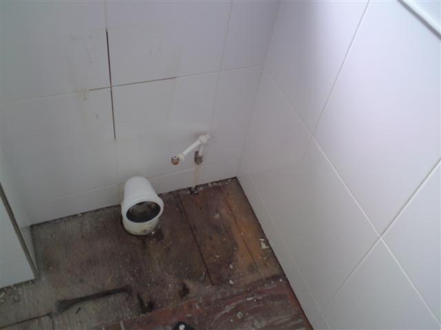

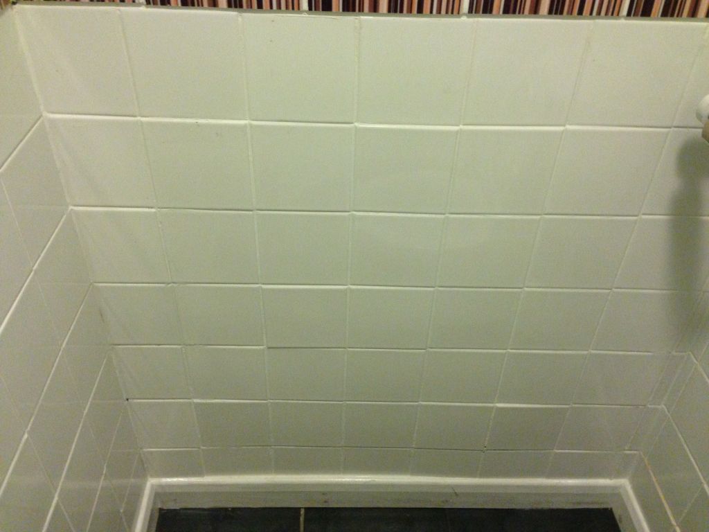

Had this on a job a wee while back this is a small part of a very poorly tiled bathroom. Literally pulled the tiles off by hand

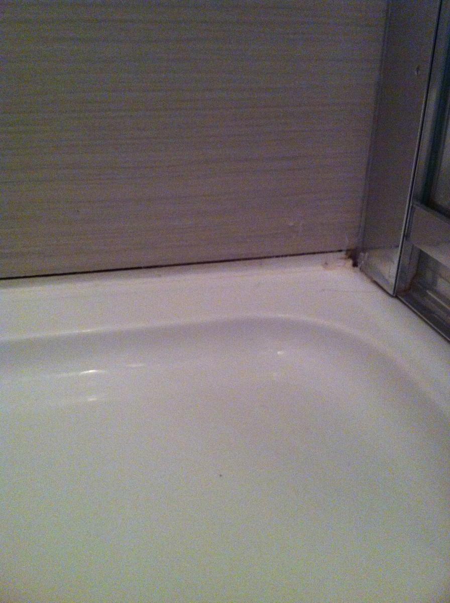

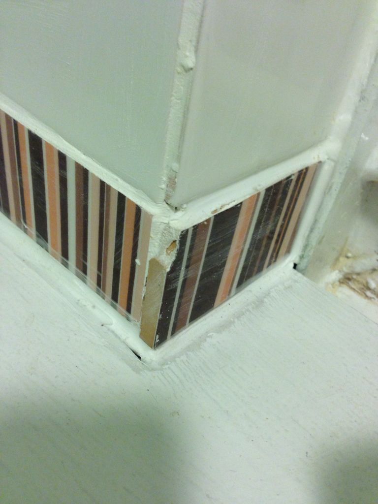

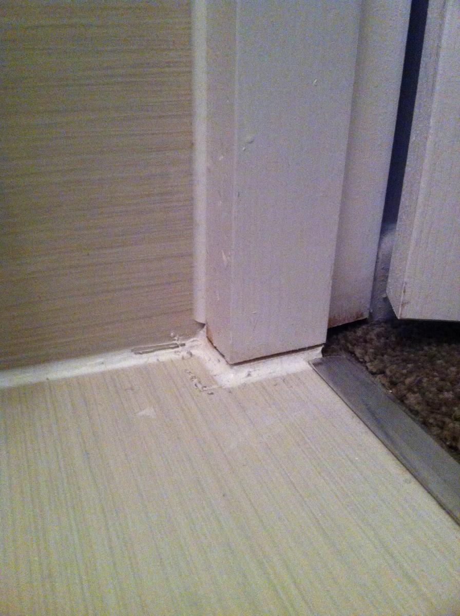

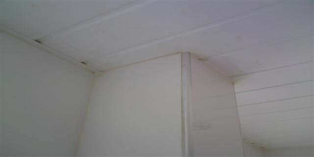

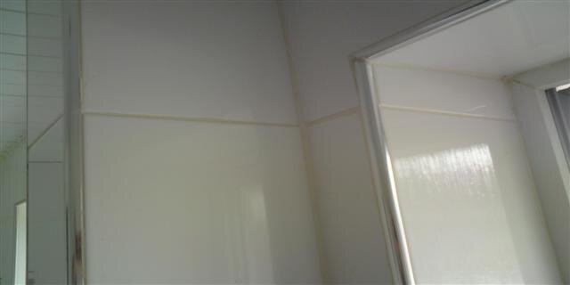

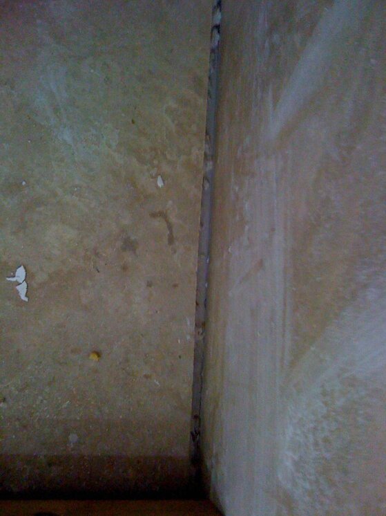

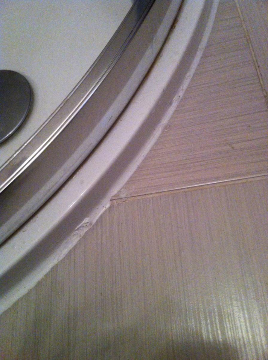

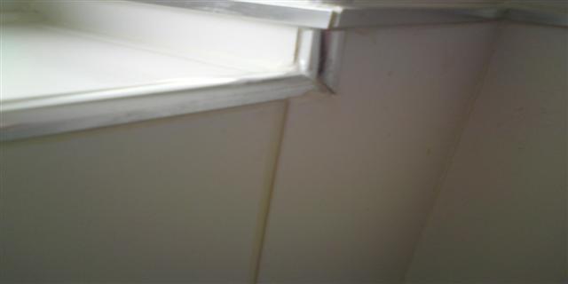

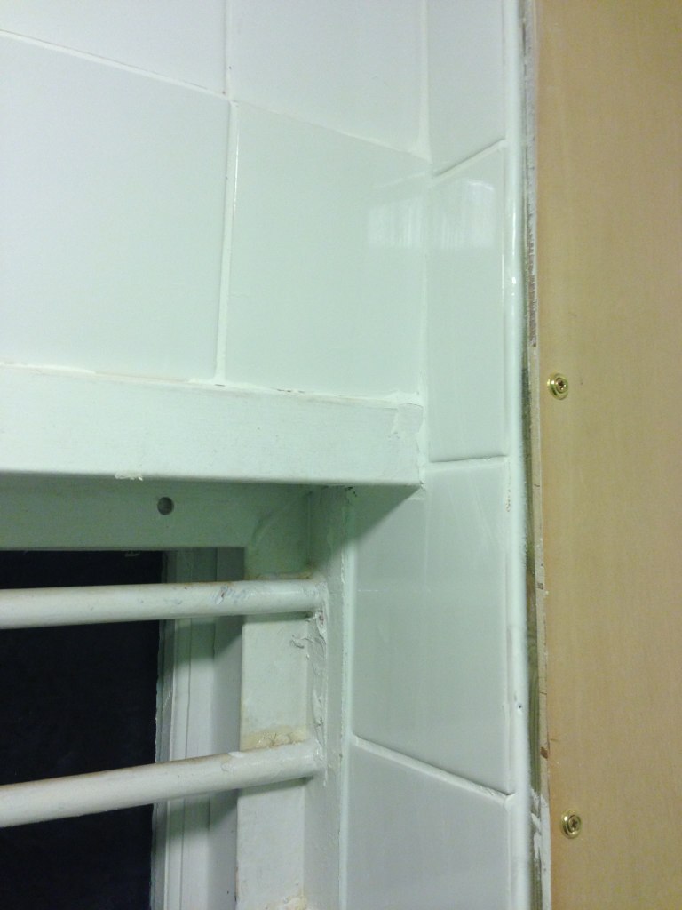

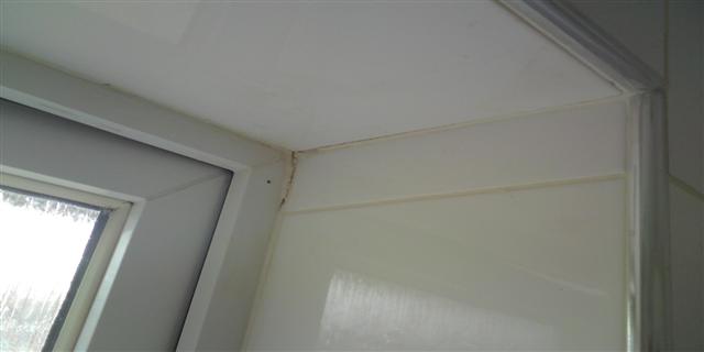

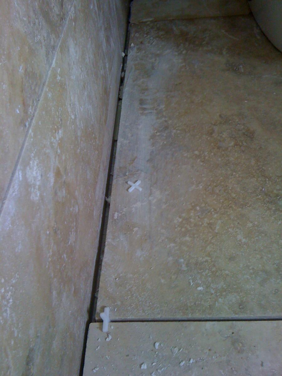

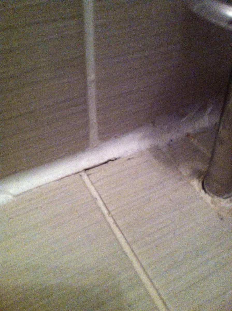

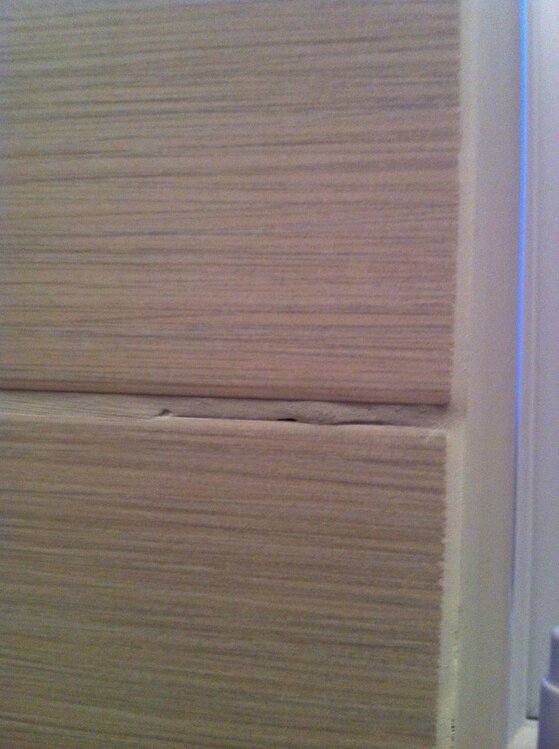

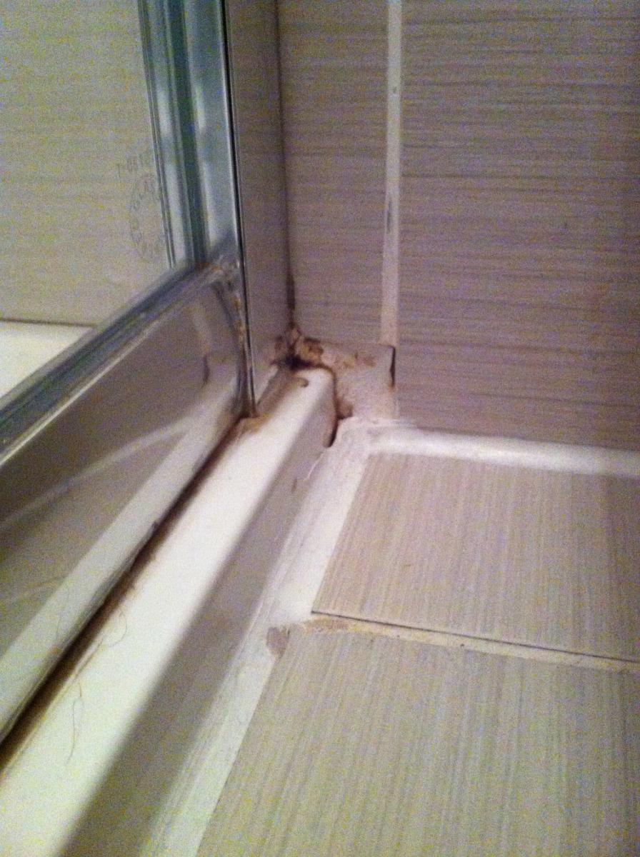

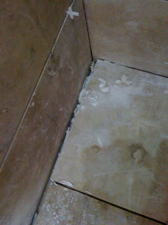

Just been to look at a job. This is a bathroom that was completed just before Xmas 2012, all work carried out by builder.
No silicon between tray and tiles just grout, no silicon between cubicle frame and tray, massive gaps around edge of room filled with grout and then covered in parts with silicon. 1 tile running at 90 degrees in front of shower tray to rest of floor. Notched out tiles where pipes are. joints up to 15mm where walls meet. Tiles not following profile of shower tray. Grout cracking and popping out of joints.
View attachment 50558Bath1.jpgBath3.jpgBath4.jpgBath5.jpgBath6.jpgBath7.jpgBath8.jpg
