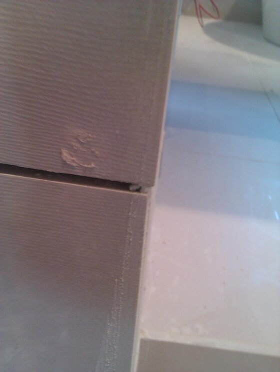

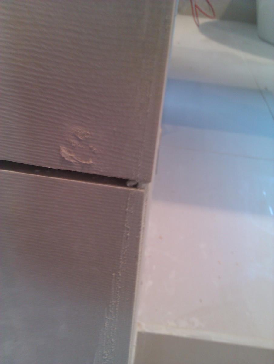

are the floor tiles loose as well..? looks a right mess, still it lasted nearly 3 months, thats a new record for a builder...:lol:
The tiles are not loose yet, but I would say it won't be long before they're rocking Andy!!
That's got to get an award for one of the thickest beads of Silicon ever used!!
That's not a bead Pete, I think he must have had some silicon left on his hands when he fitted the toilet and thought I'll just wipe it on the wall, sausage fingers!!! :lol:

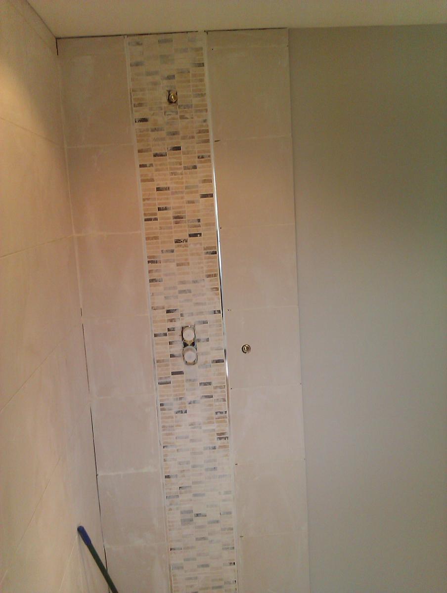

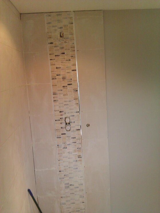

Here's a few ...."Tiler" legged it when a second opinion was requested:
This guy even had a cracking website lol...Pitty about the waste of porcs ! Only bonus was the majority of tiles had been
stuck with tubbed so were easily removed & cleaned. Check the swerve it thw mosaic shower run !!!

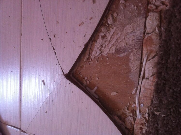

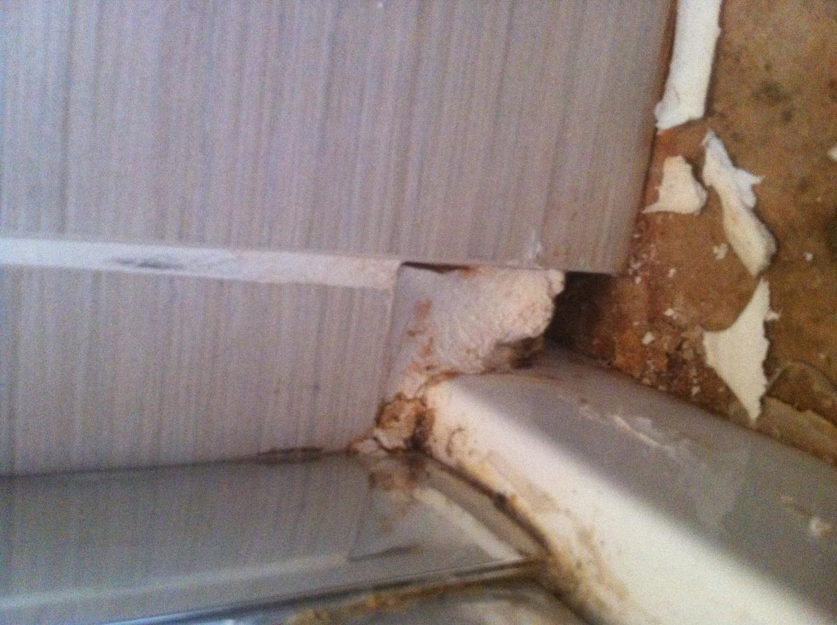

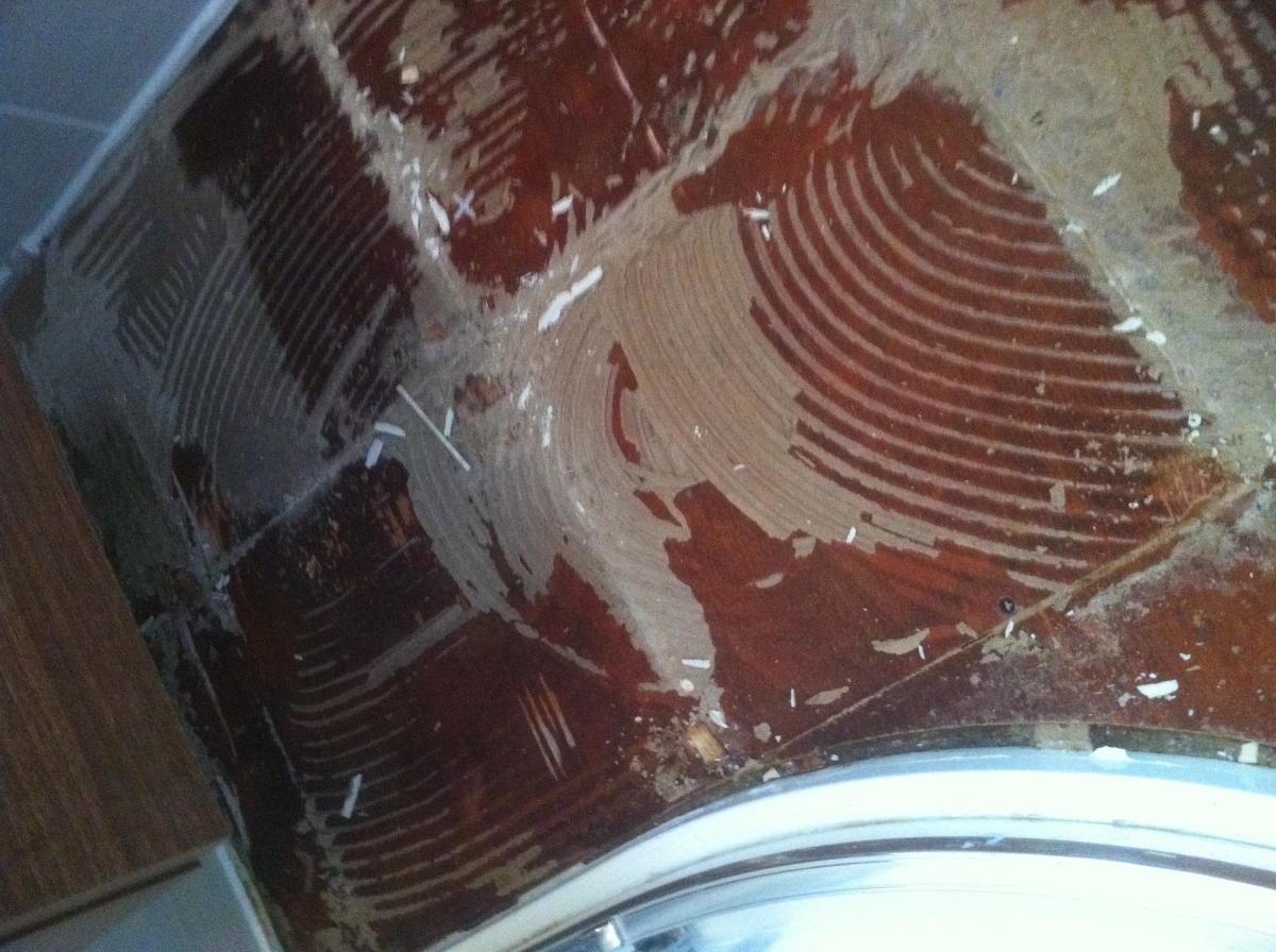

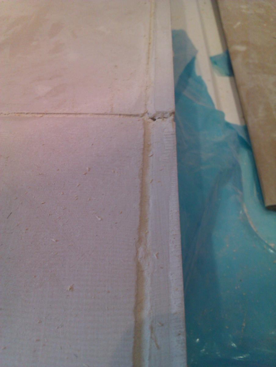

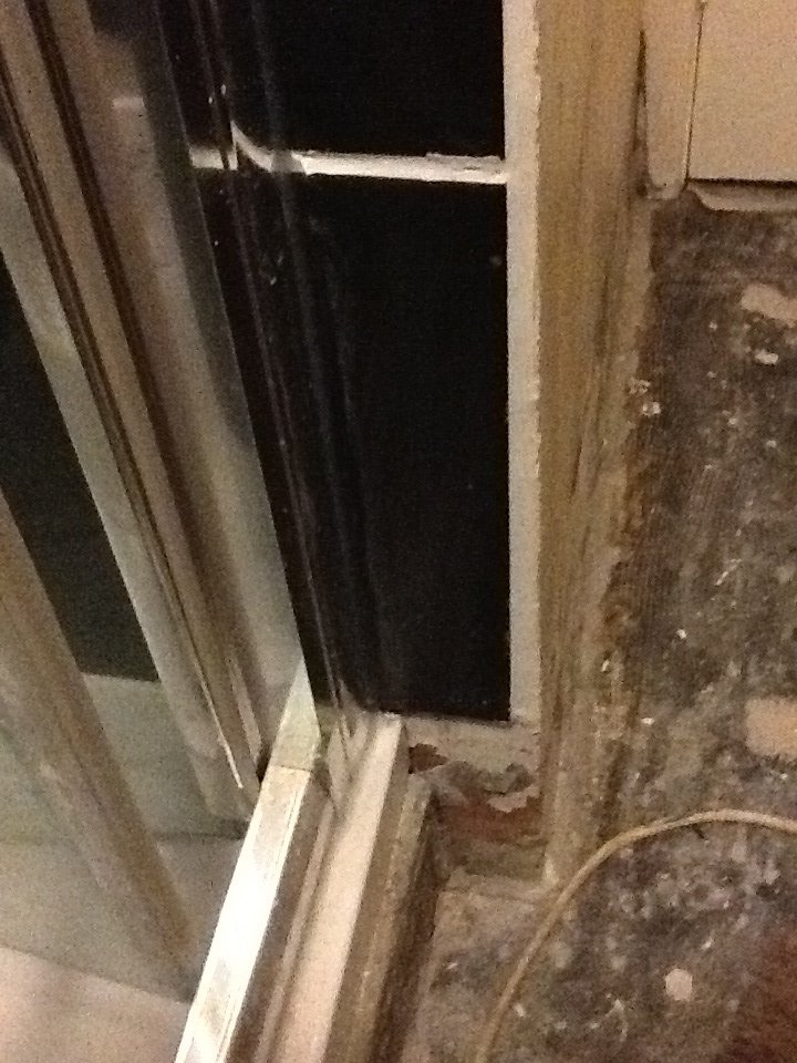

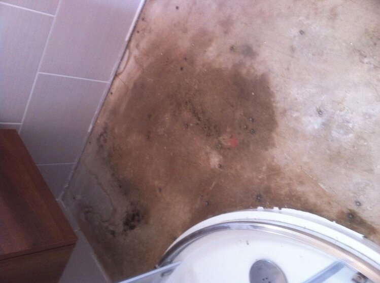

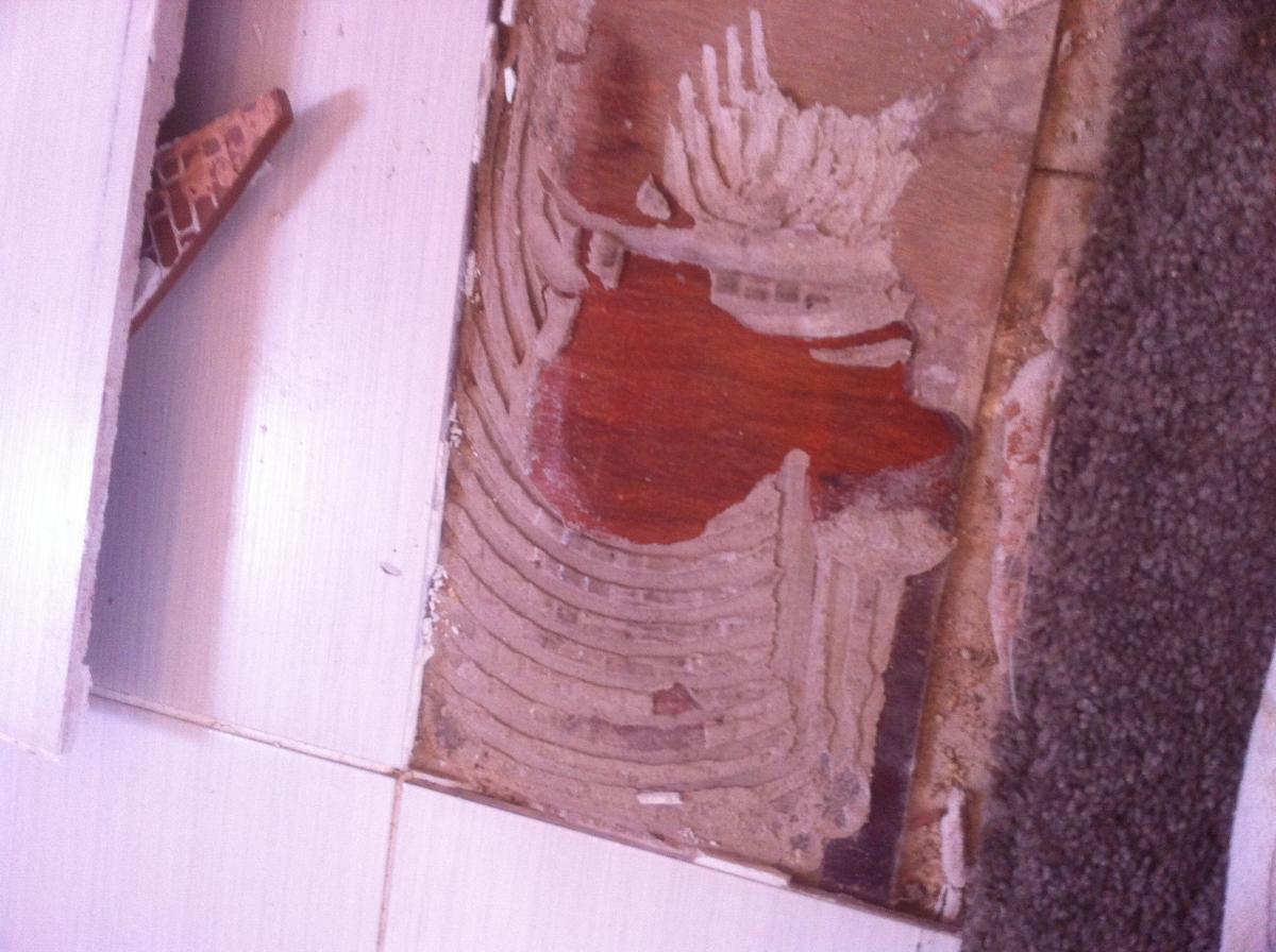

The floor that I posted 4 weeks ago has now come up.
Tiles came up easy. 6mm trowel used and dot n dab, no back buttering, 3mm ply fixed down with 45mm screws (No pipes hit luckily). Lifted first row of tiles and rest came up easy, there was standing water under tiles and ply was already rotten and mouldy. This bathroom was done 3 months ago.
The floor is actually perfectly flat and level so I've no idea why they dot 'n dabbed in places.
And the standing water was from the shower frame that wasn't sealed to the tray and corner that didn't have any silicon
View attachment 51158 View attachment 51159View attachment 51160View attachment 51161View attachment 51162
On a perfect surface... they must of not been holding the trowel right &/Or pressing to much on some & not enough on, As As before it is a shame we cannot name & shame... just to Save the Customers money (And in your case John, there floor!)

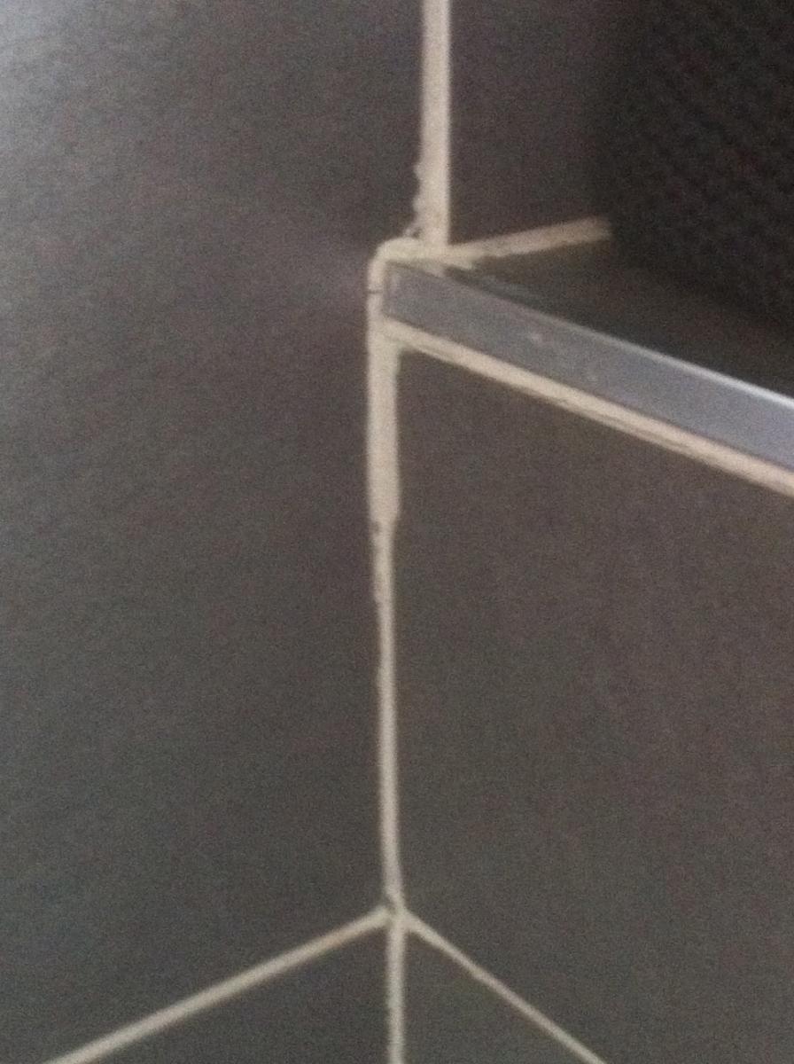

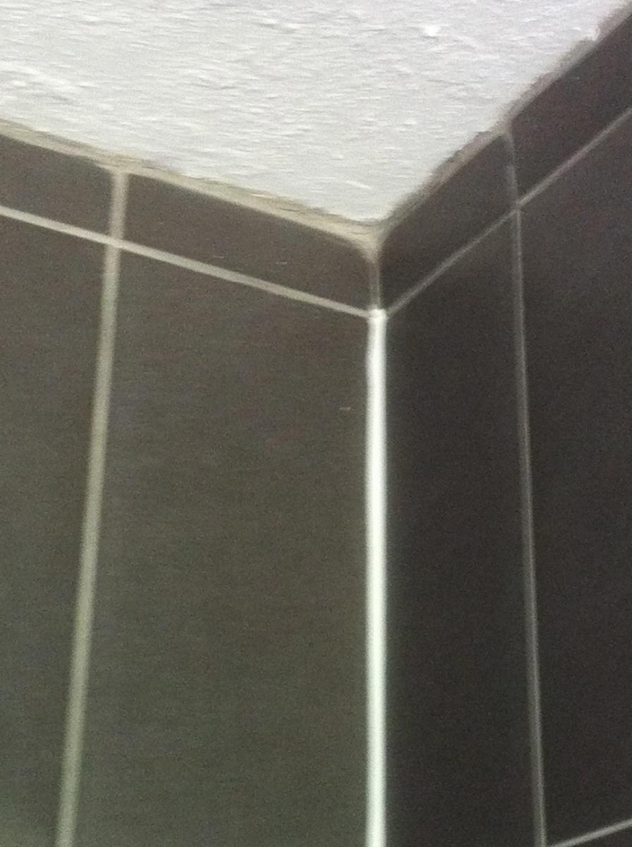

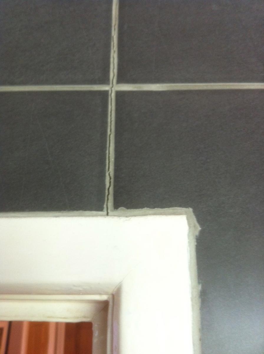

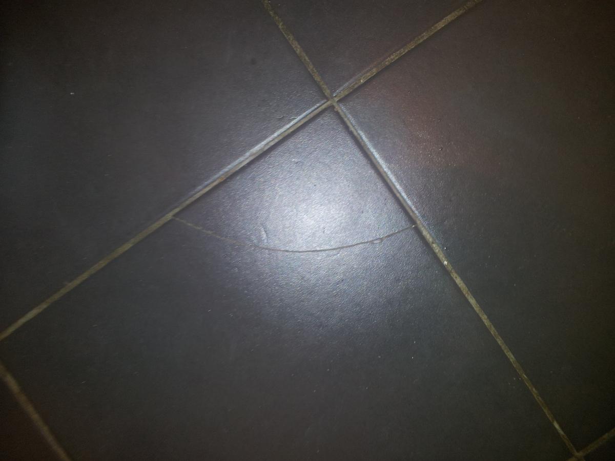

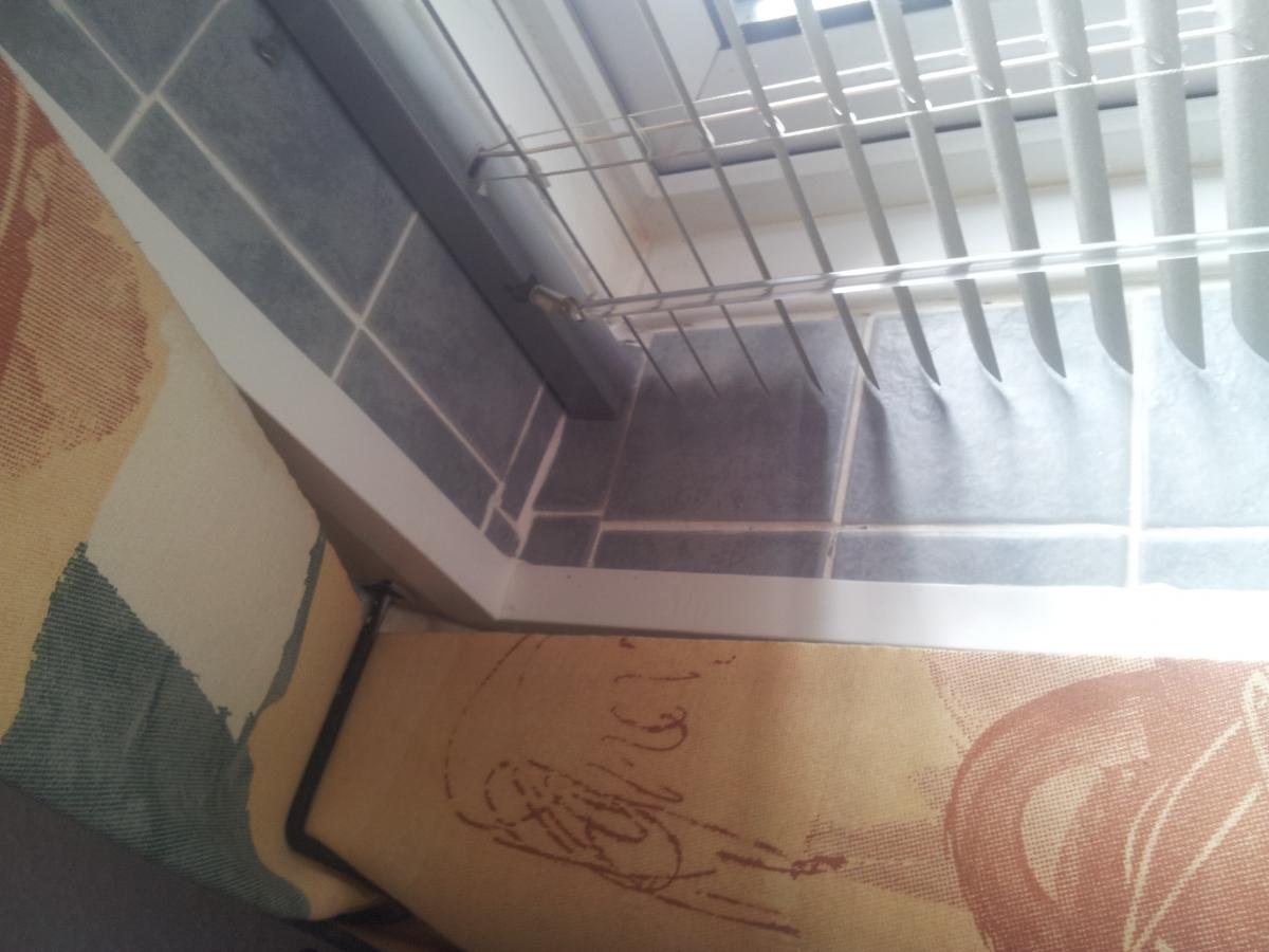

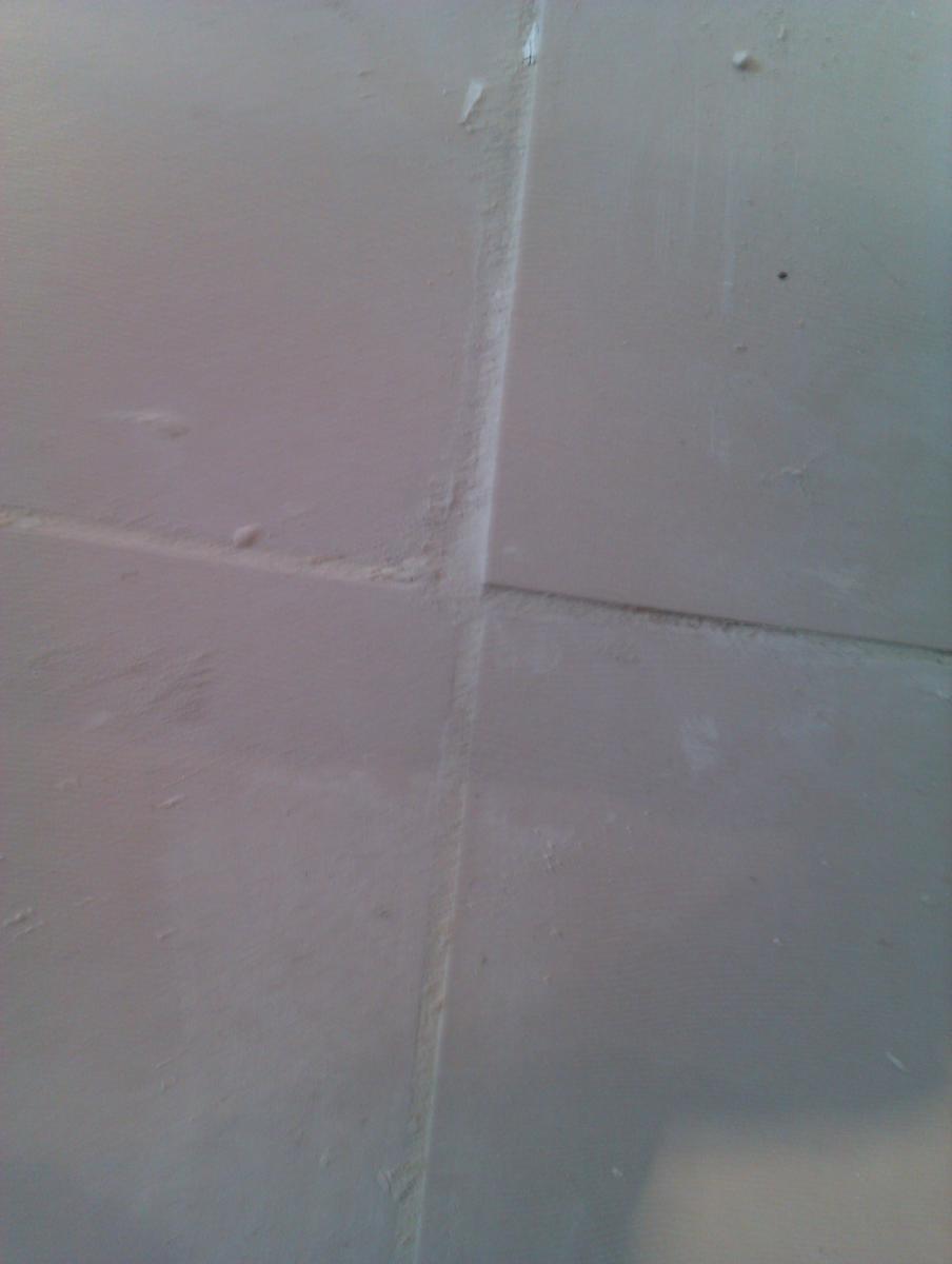

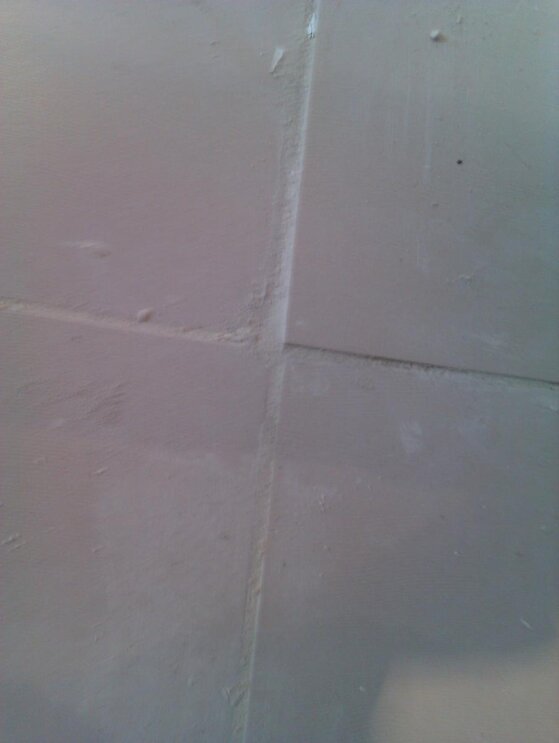

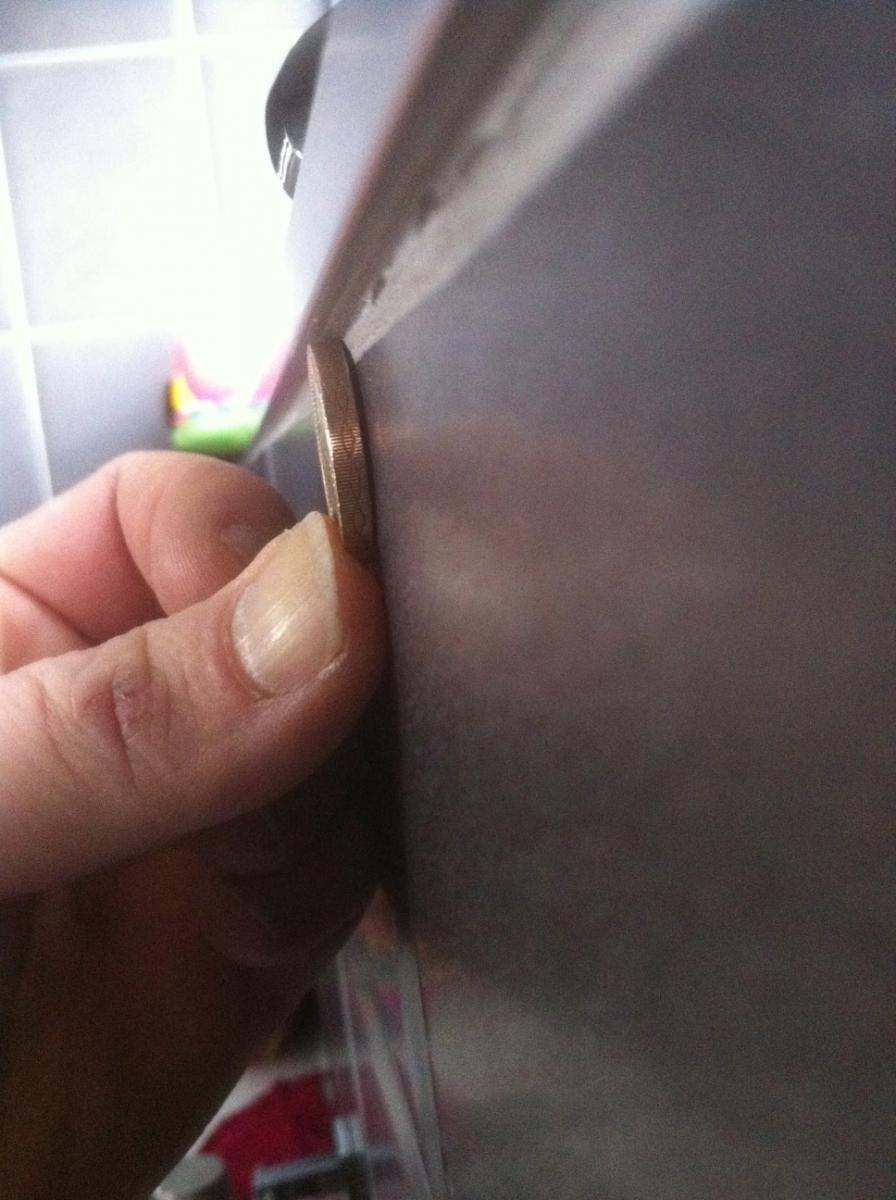

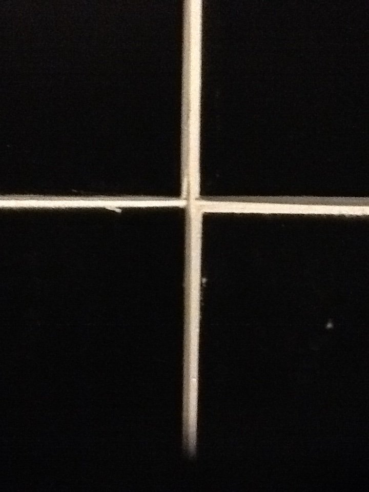

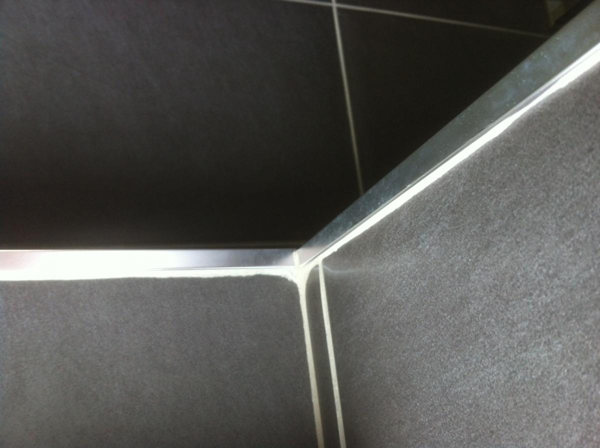

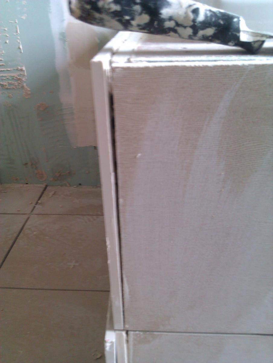

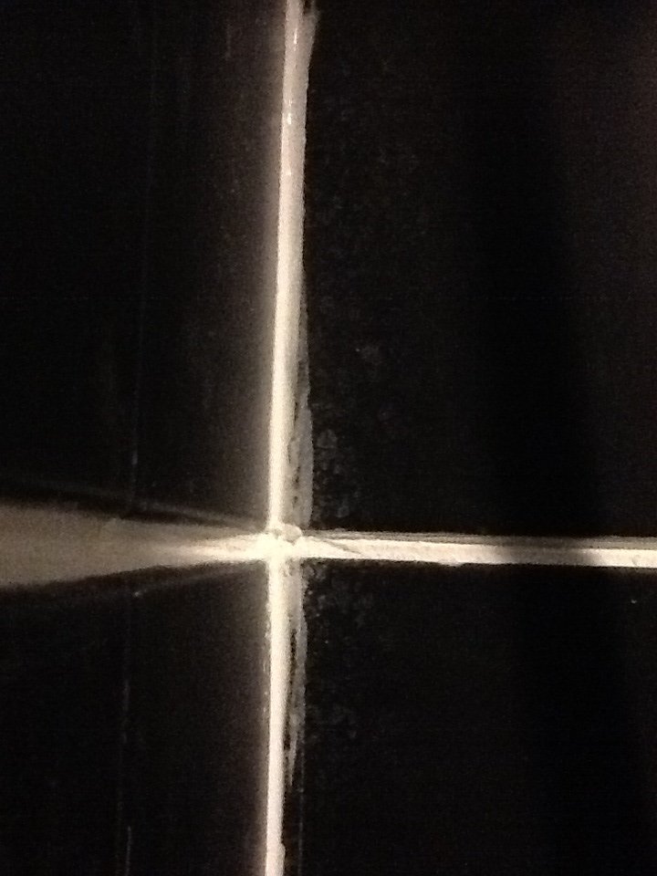

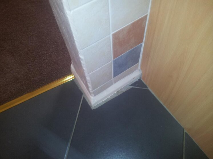

Following on from the previous bathroom floor, whilst I was at the customer i needed to use their bathroom. I couldn't resist taking these pics.
This was apparently done by a professional tiler and not a builder like the previous one
Enjoy.
Enjoy.
View attachment 51375View attachment 51376View attachment 51377View attachment 51378View attachment 51379View attachment 51380View attachment 51381View attachment 51382
That particular customer has had a rough old time with the bodgers!
This whole thread just makes you sigh in pain.
Poor customers, poor tilers who cant get work because there are cowboys doing cut price jobs.
Enjoy.

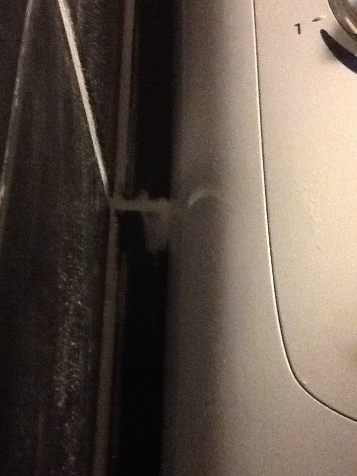

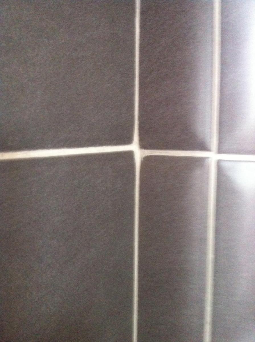

how is the grout cracking in the third pic along is that just down to a bad bedding?

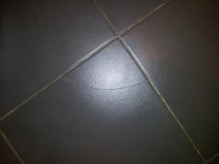

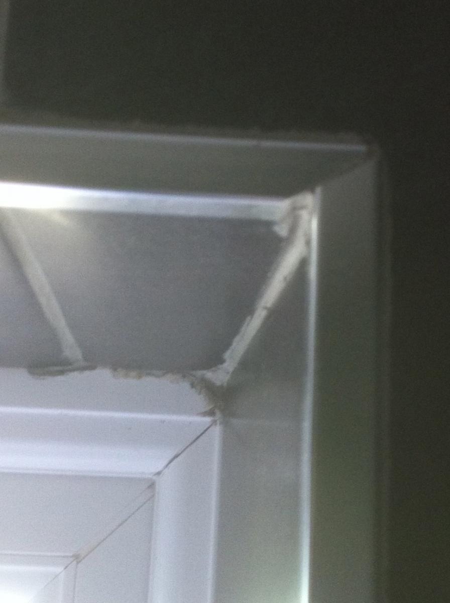

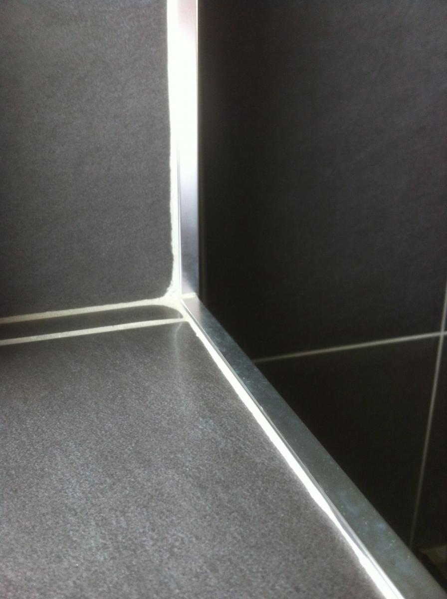

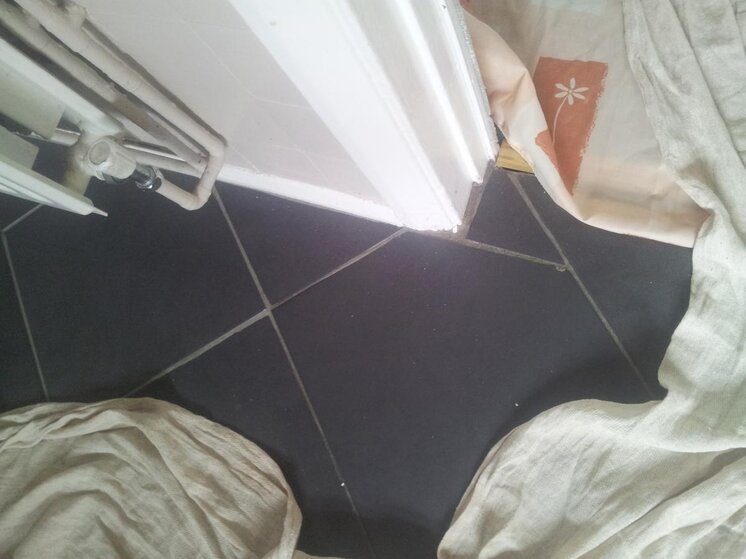

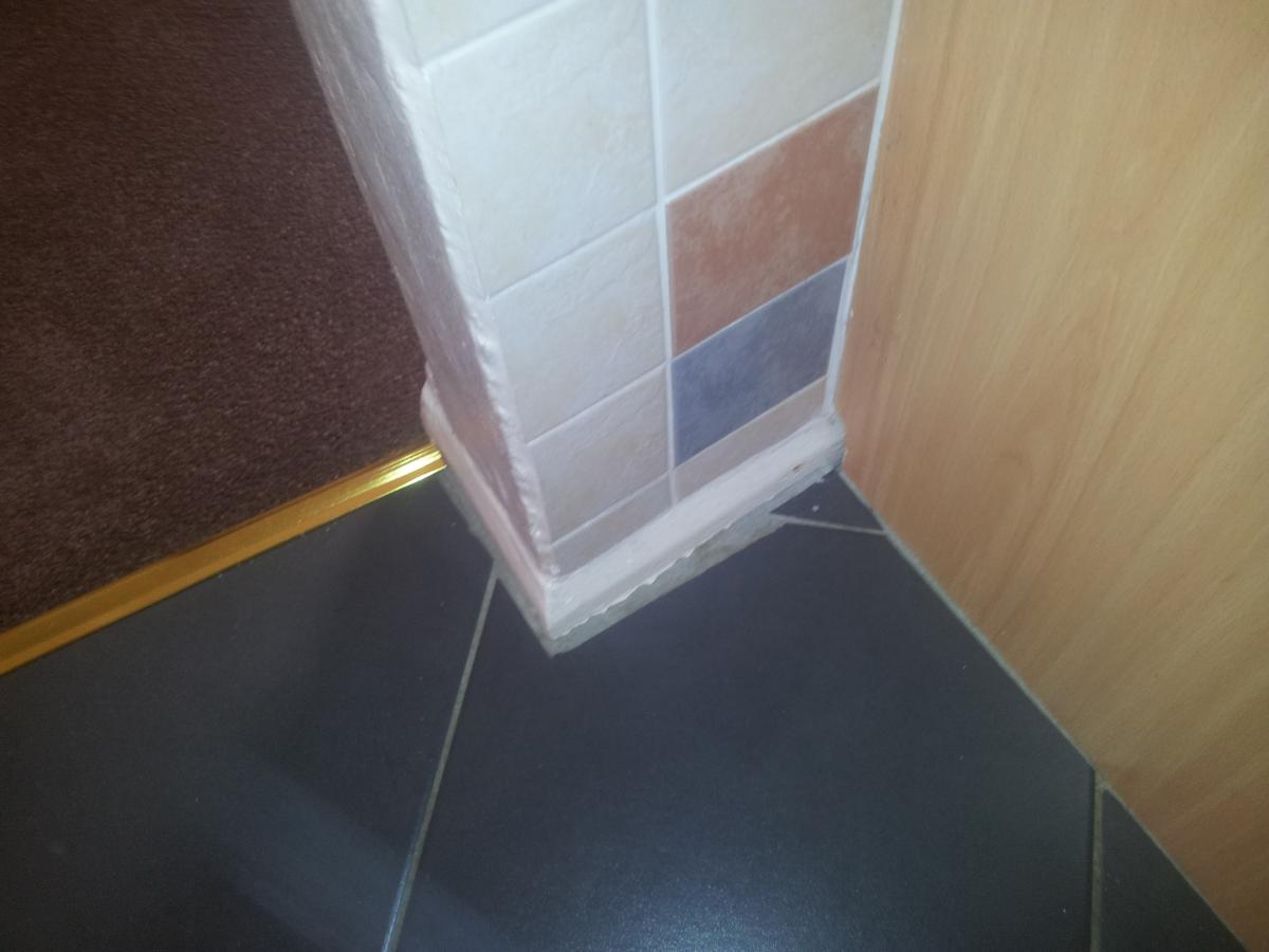

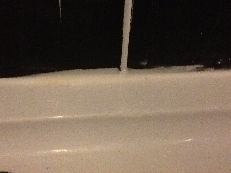

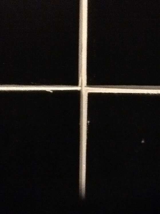

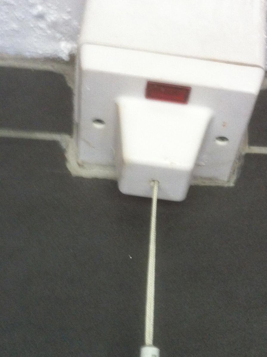

This is what I've just had done. Done by 2 builders/plumbers, I'm not sure what they 'specialise' in. Sent from a housing association.
Less than impressed. Now trying disguise it by using a dark grout. Ripping out the Silicon and going to get some black stuff.
