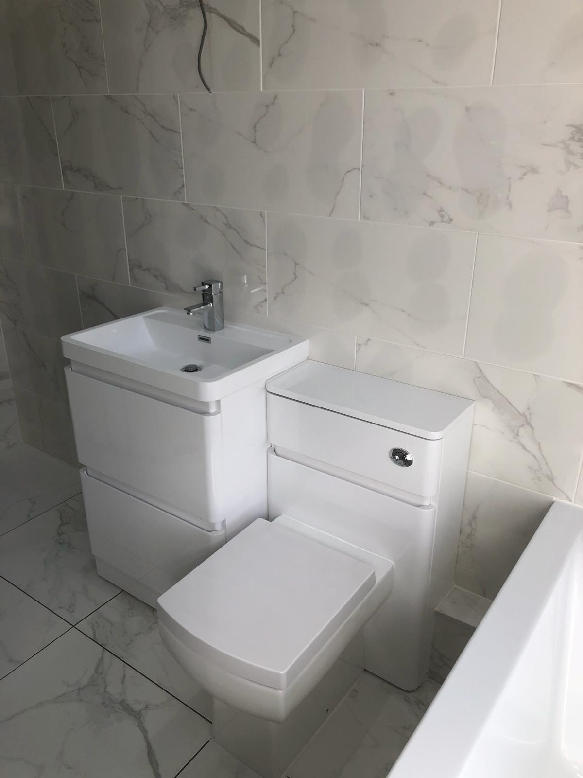

Wow what a mess!!
How did you end up paying 10k for that disaster?!

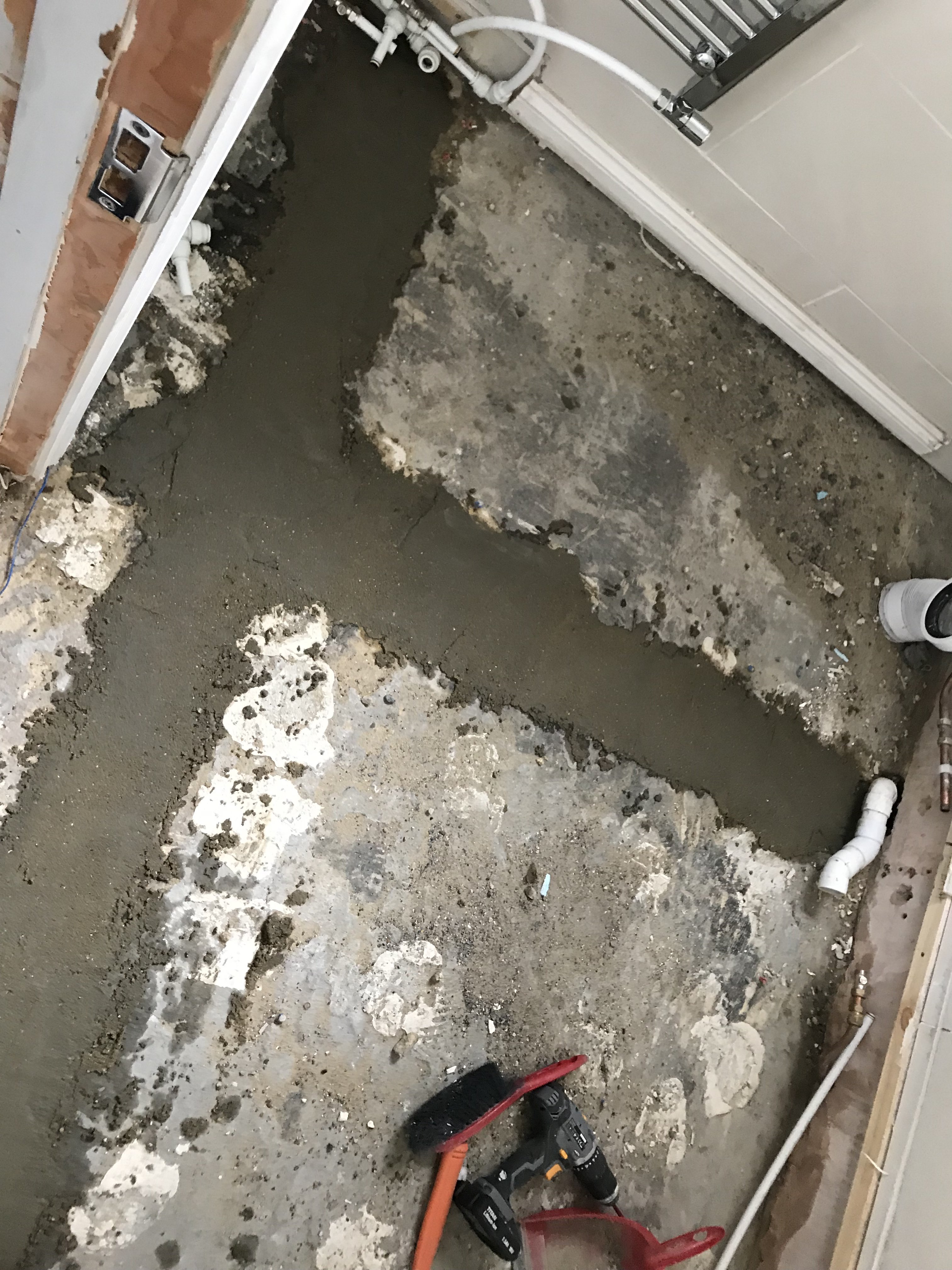

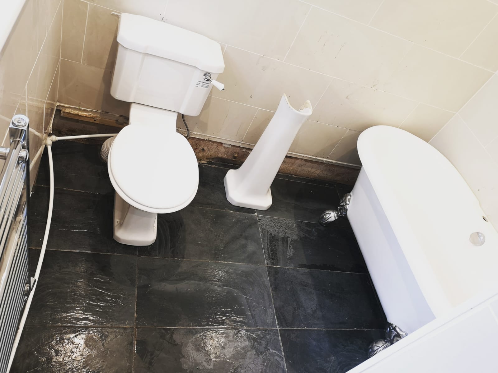

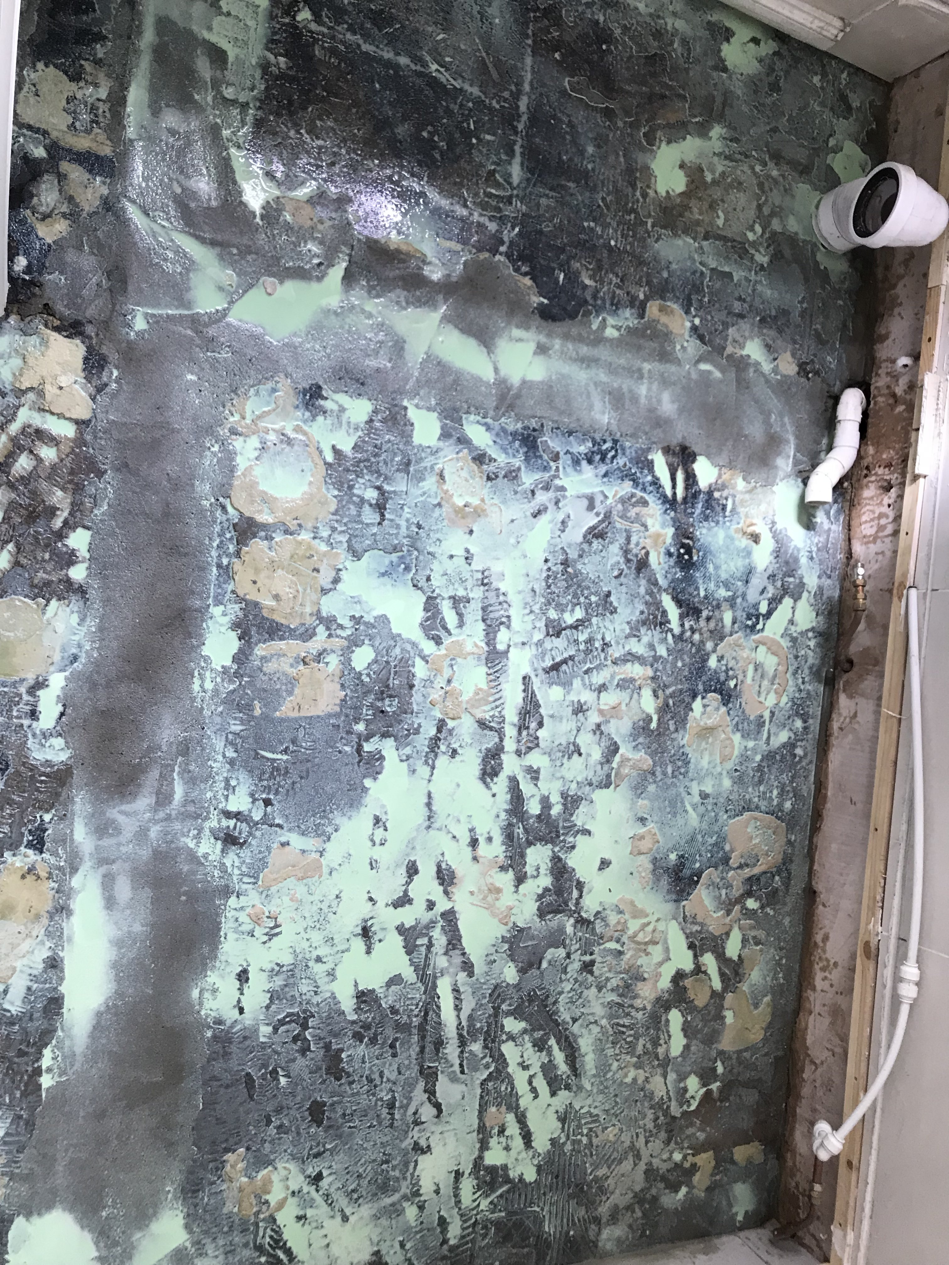

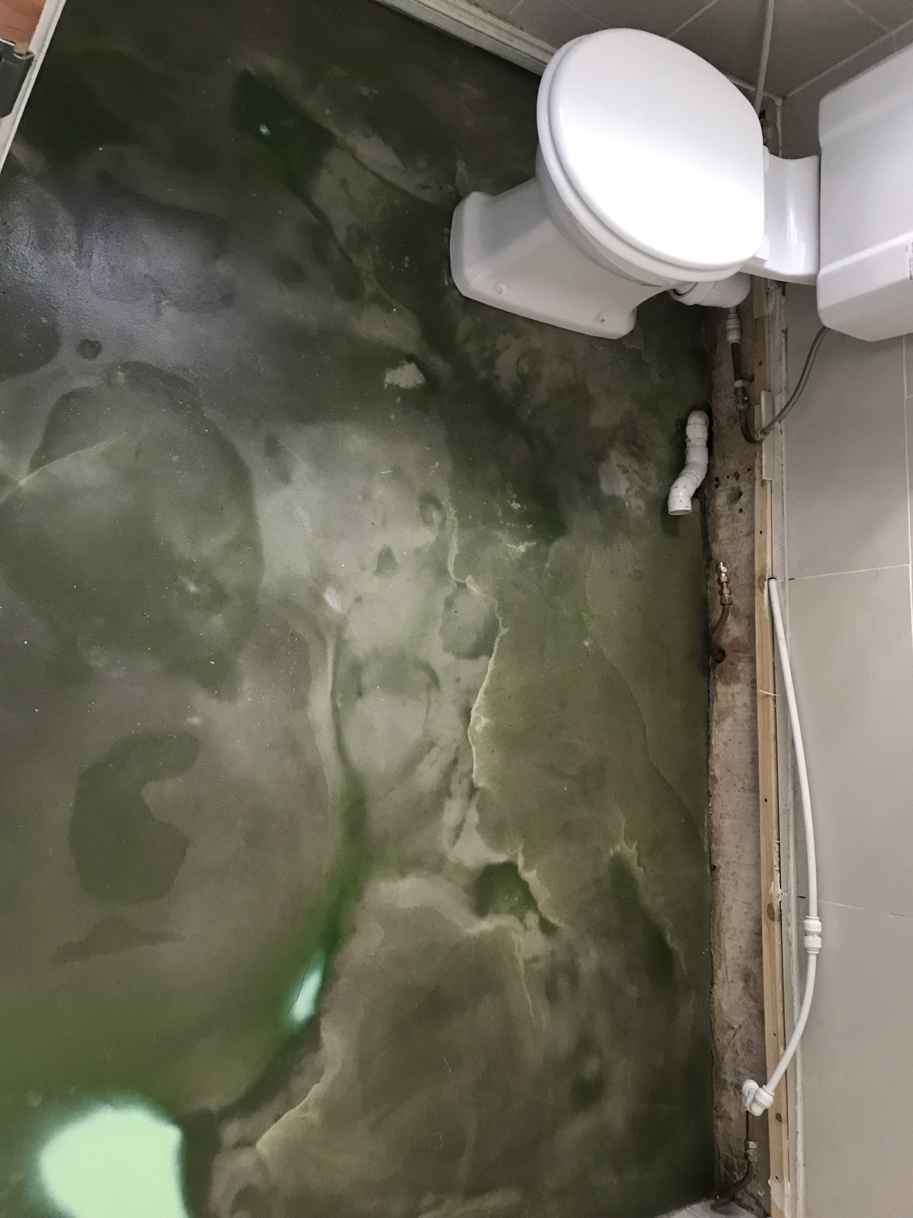

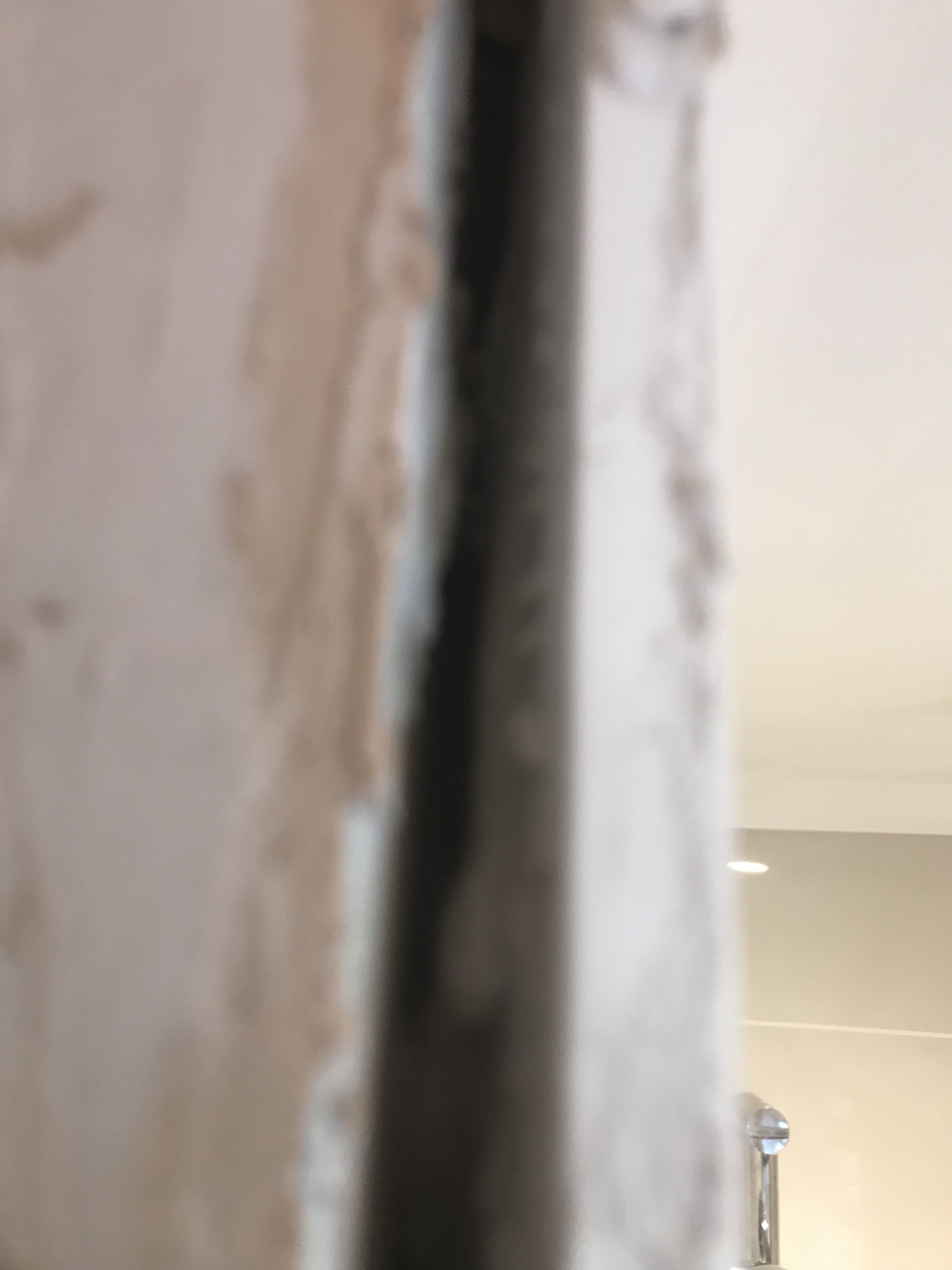

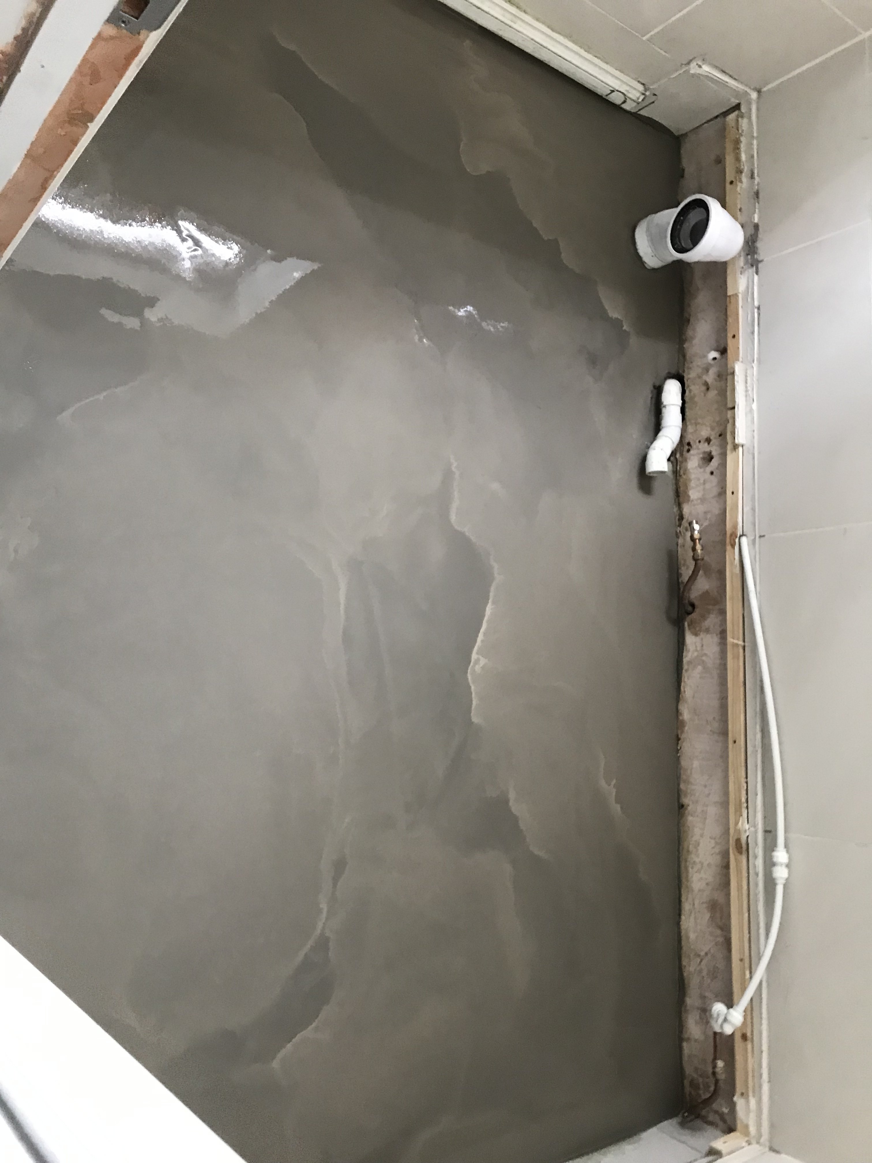

I paid then up then went down the route of trying to recover, lesson learnt. I’ve since acquired some tiling tools of my own as I can’t afford to hire another pro. I’ve skimmed the walls, concrete filled and levelled the floor, I chucked a cheapo tile floor down to practice, the floor was done without proper tilers tools and a stone and masonry disc on my angle grinder only. I’ve now acquired suitable tiling tools and am getting ready for the bathroom refit. Pictures below, I’ve also added a picture of what was under his tiles, great big voids.

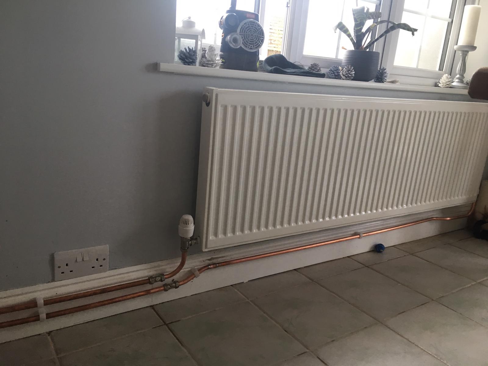

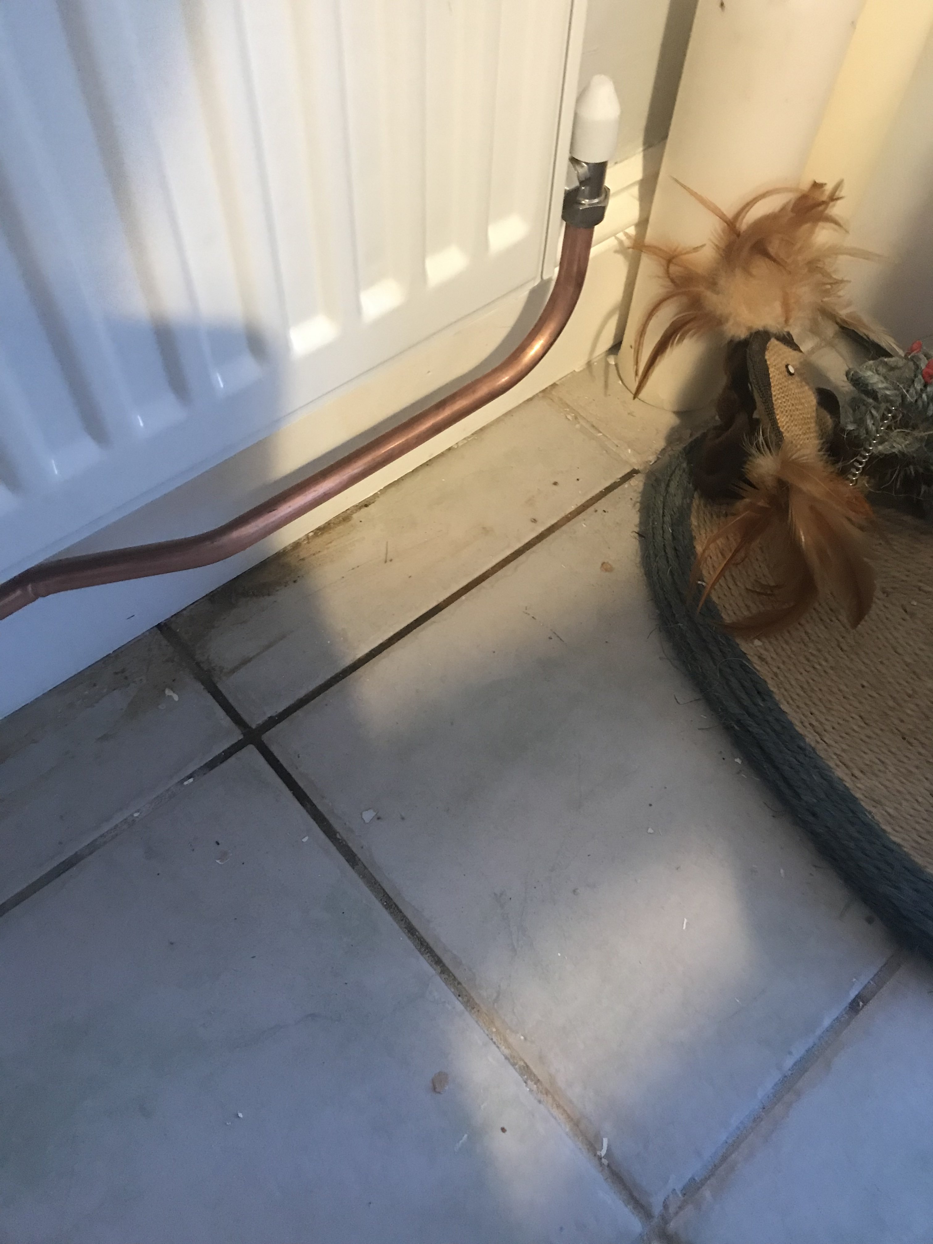

There will be easier plumbing based work that he’ll be working on and getting good scores, not that his plumbing was up to much, here’s a radiator on the other side of the bathroom wall he moved 😂
Love them pulled bends. 😂
Although I think copper is far too thin for pulling 90’s these days.
Oh dear, that’s not good. 😂

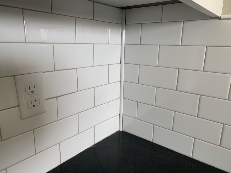

I am having a new house built by a commercial residential builder, and I am not happy with the tile work on the Kitchen backsplash. The workmanship is ugly to me, compared to other work I have had done on past houses and remodels. Am I being too picky, or is this bad workmanship? Should I expect more from a professional tile installer?
Below are photos of the work that I am not happy with.
Photo 1: Photo of an inside corner that is really ugly to me. I complained to the builder about this.
Photo 2: Photo of uneven grout lines and tile placement.
Photo 3: Photo of what the tile guy did to cover up the ugly corners in Photo 1 after I complained. Is this acceptable?
Am I out of line? Does this work represent acceptable professional workmanship?
Photo 1:
Photo 2:
Photo 3:
