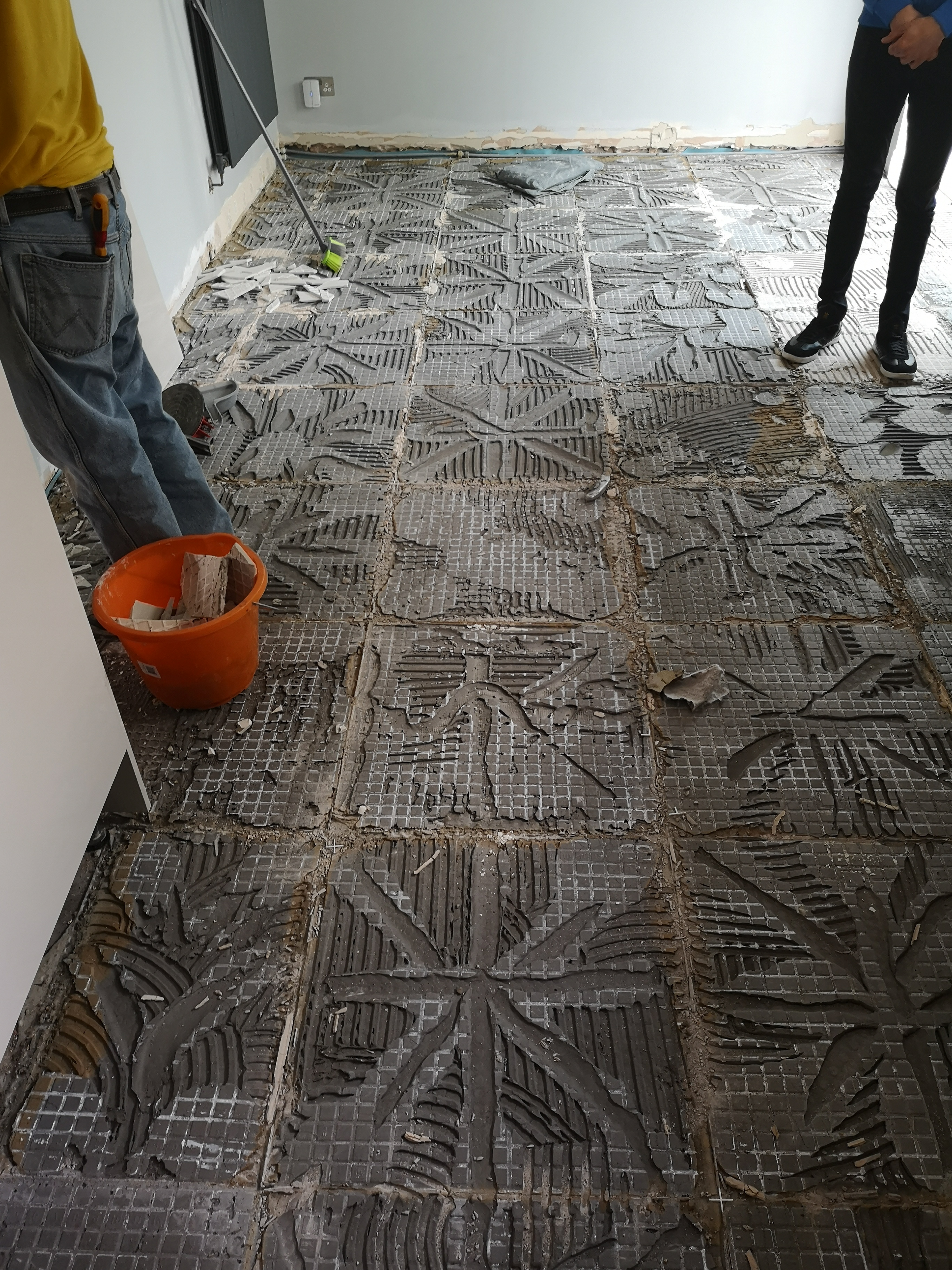

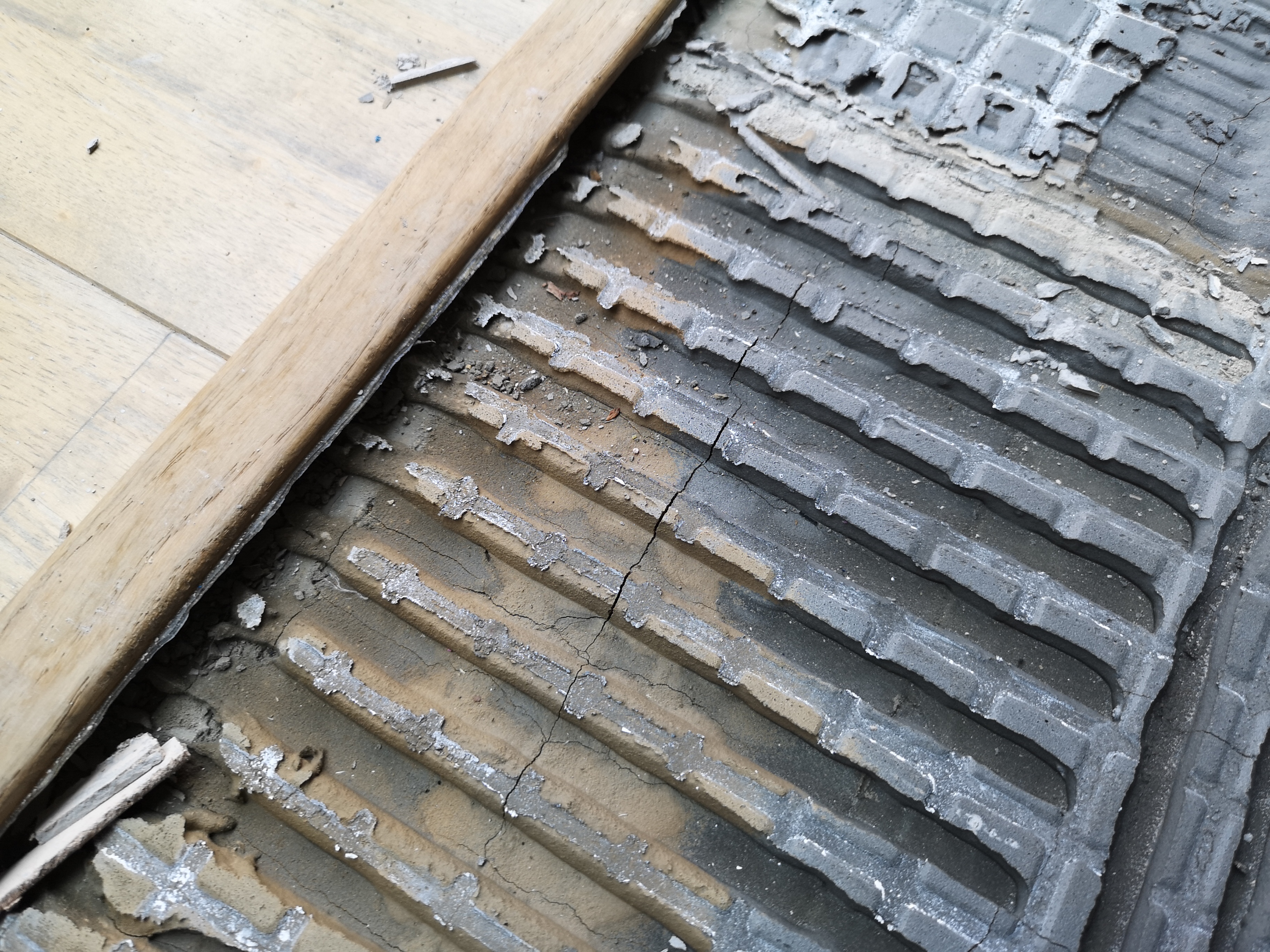

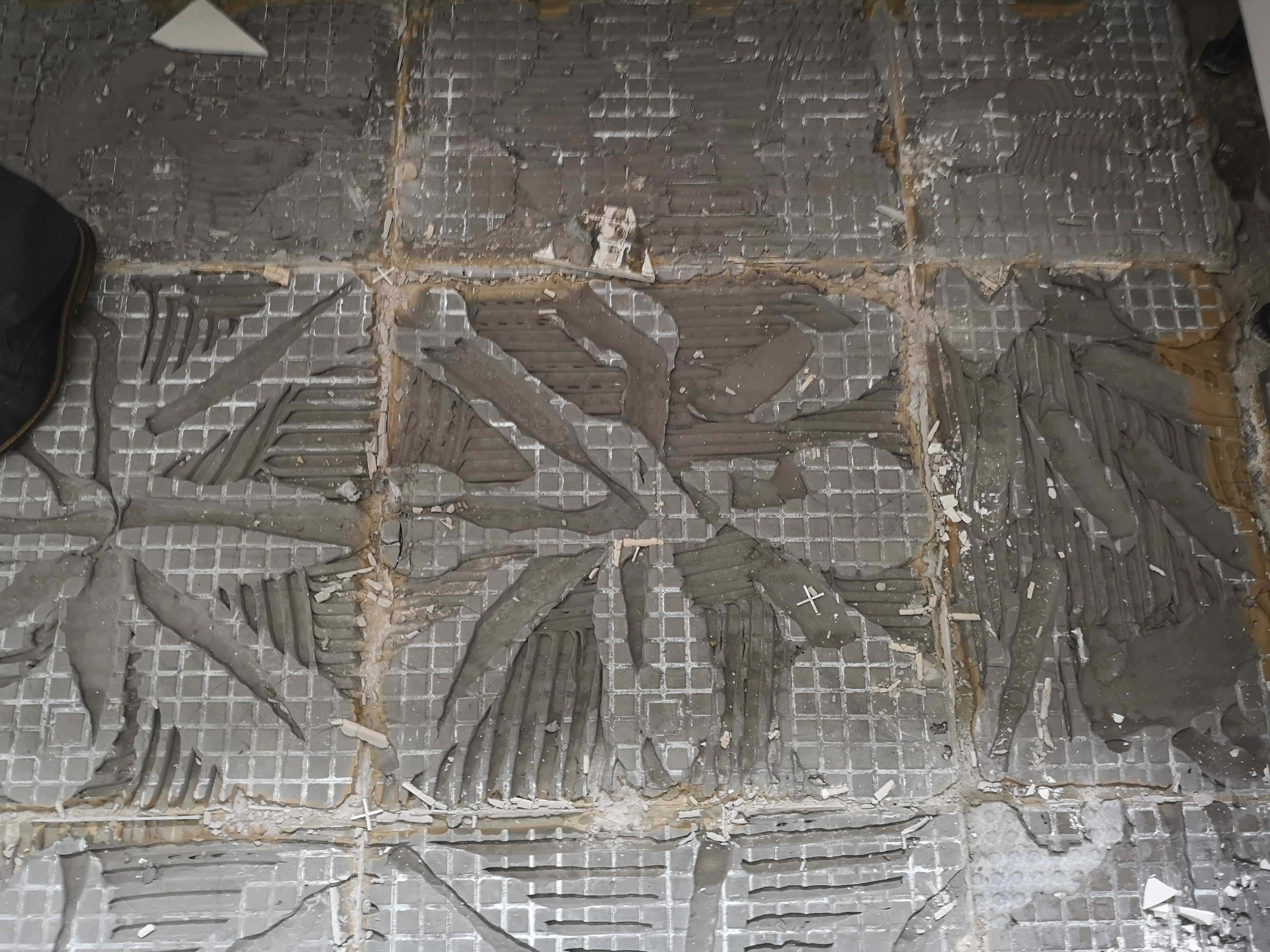

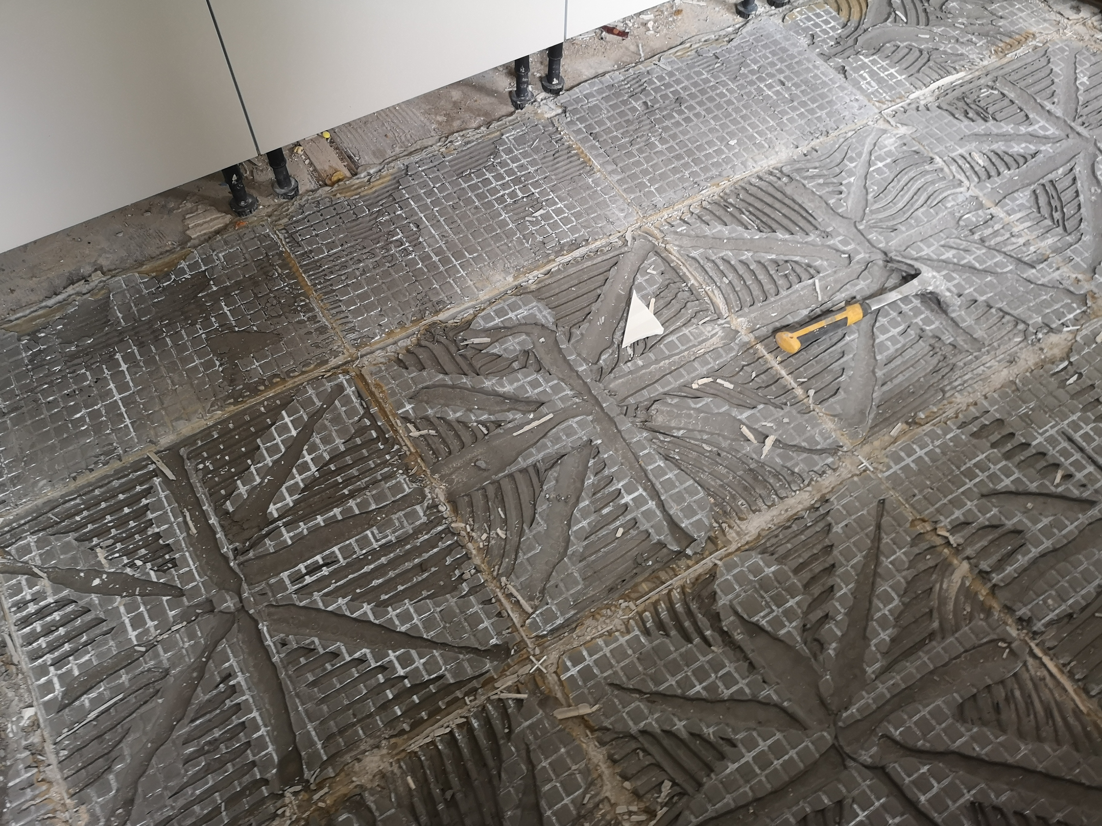

Customer, 60x60 porcelain, complained that the grout joints were cracking and when the tiler went back to do repairs, reckoned he could lift the tiles off the floor with his fingers. He said the tiles were loose as they were too dusty and that there was no written instruction telling him to clean the backs of the tiles before fixing (yeah, I laughed too). Yet when I was there, even though they were fairly easy to lift, still took a hammer and chisel to get them up. Although there was no back-spread, he had used a unique method of fixing...
So who has heard of the "union-jack" fixing method? Tiler of 42 years experience said it as if it was a well known and commonly used method!!! Todd from Ultra went to take a look. First glance after the tiles were lifted "What the..... what on earth is that?"
Other than the fixing method, the problem was that the floor was chipboard, no overlay other than Durabase, then this lot of adhesive. Couldn't see where it had been screwed down, but there was so much deflection in the floor, the adhesive was cracking, you could see it see-sawing as you walked on it and there was no chance it was ever going to survive. I recommended lifting the chipboard, adding noggins, laying a new subfloor such as 22mm NMP, or if 22m timber overboard it with Hardie.... but as I was leaving, the tiler said all he was going to do was self-level over the old adhesive and refit the tiles... He's going to try persuading the customer to take us to court for supplying faulty tiles. I wished him the best of luck.
IMG_20190708_091650.jpgIMG_20190708_092250.jpgIMG_20190708_092254.jpgIMG_20190708_092259.jpg
Union jack method...that's a new one, must be a new Great British Standard we haven't heard of :tearsofjoy: sounds like it could be floating chipboard 🙄

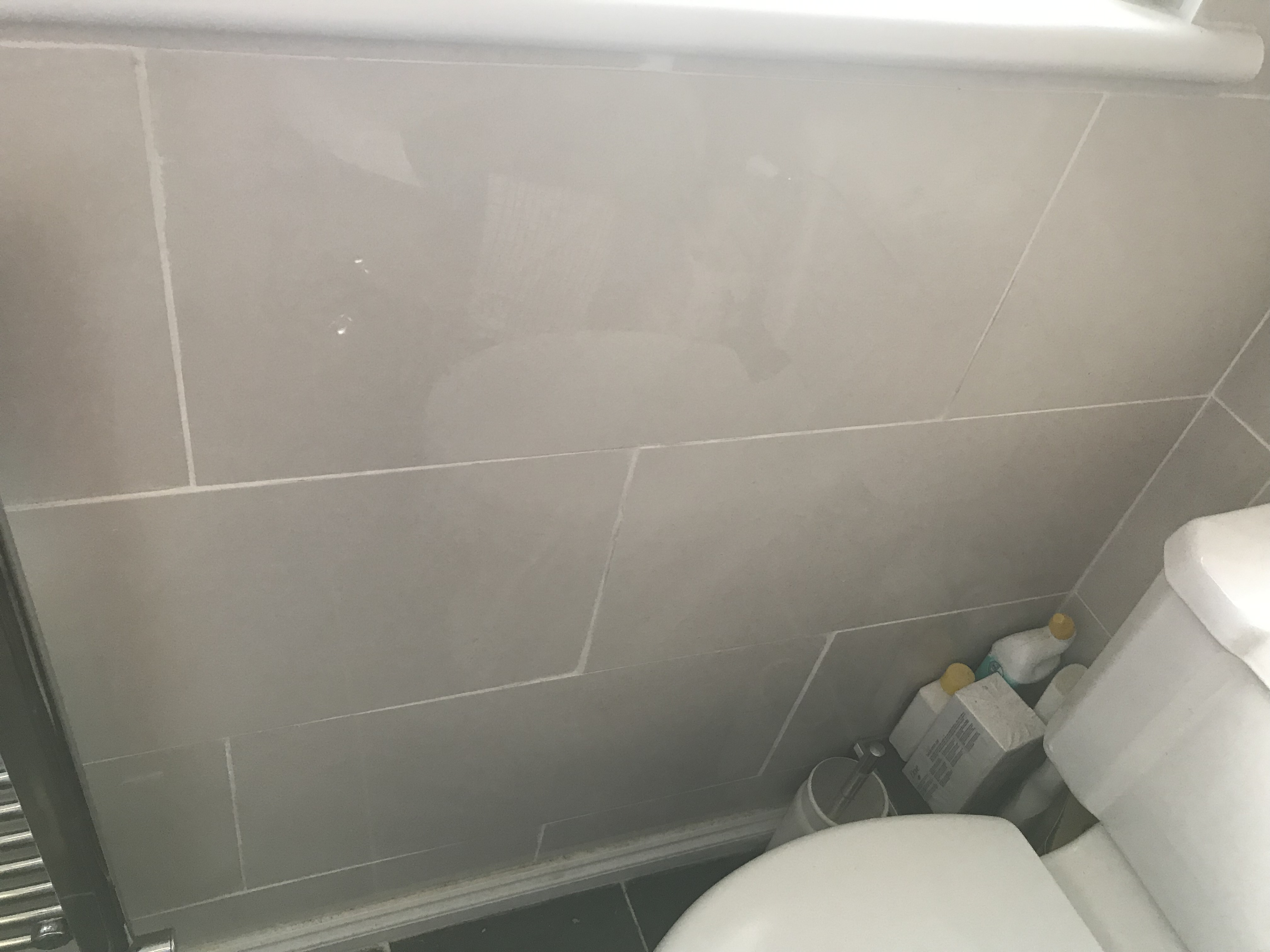

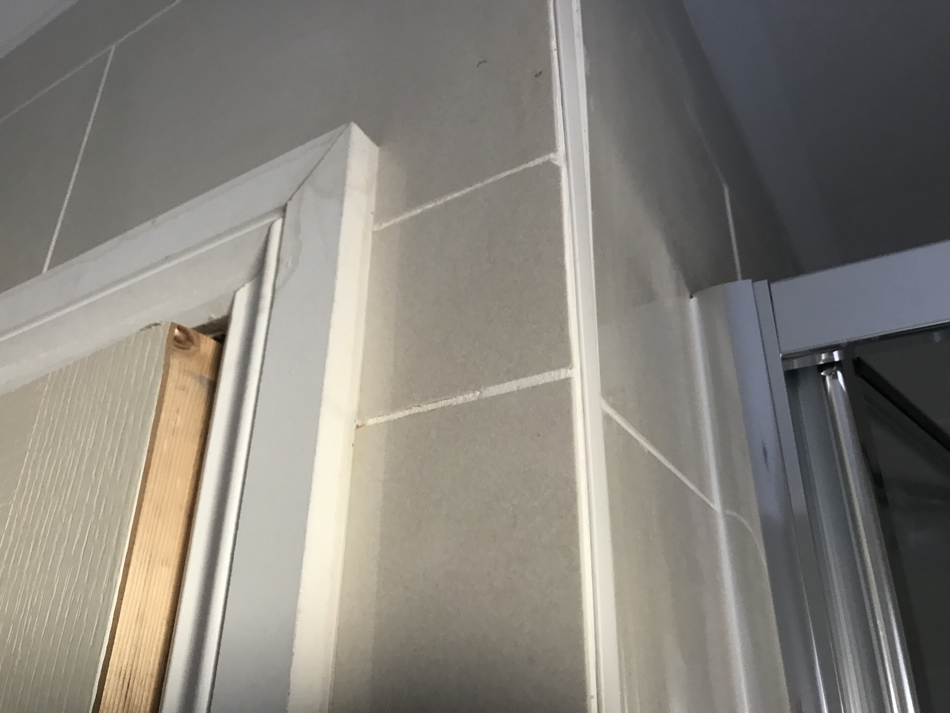

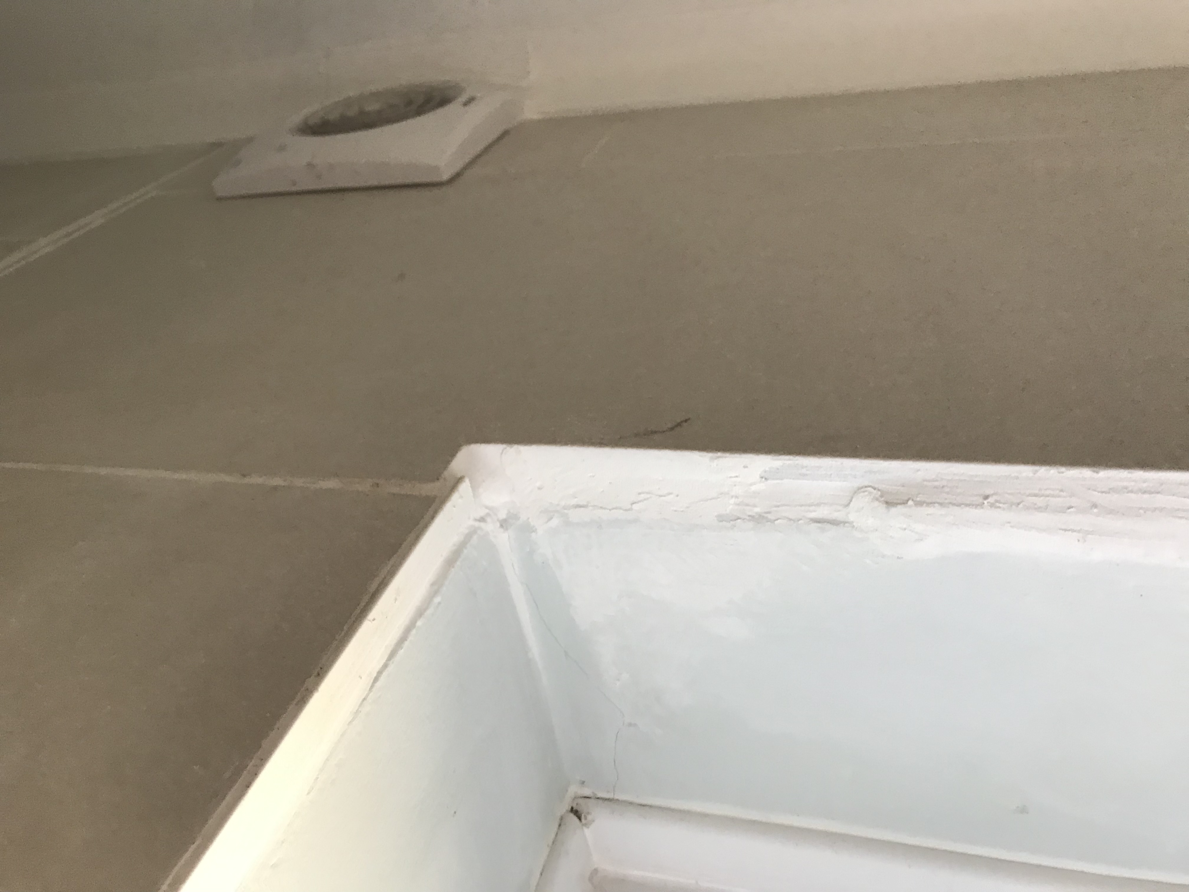

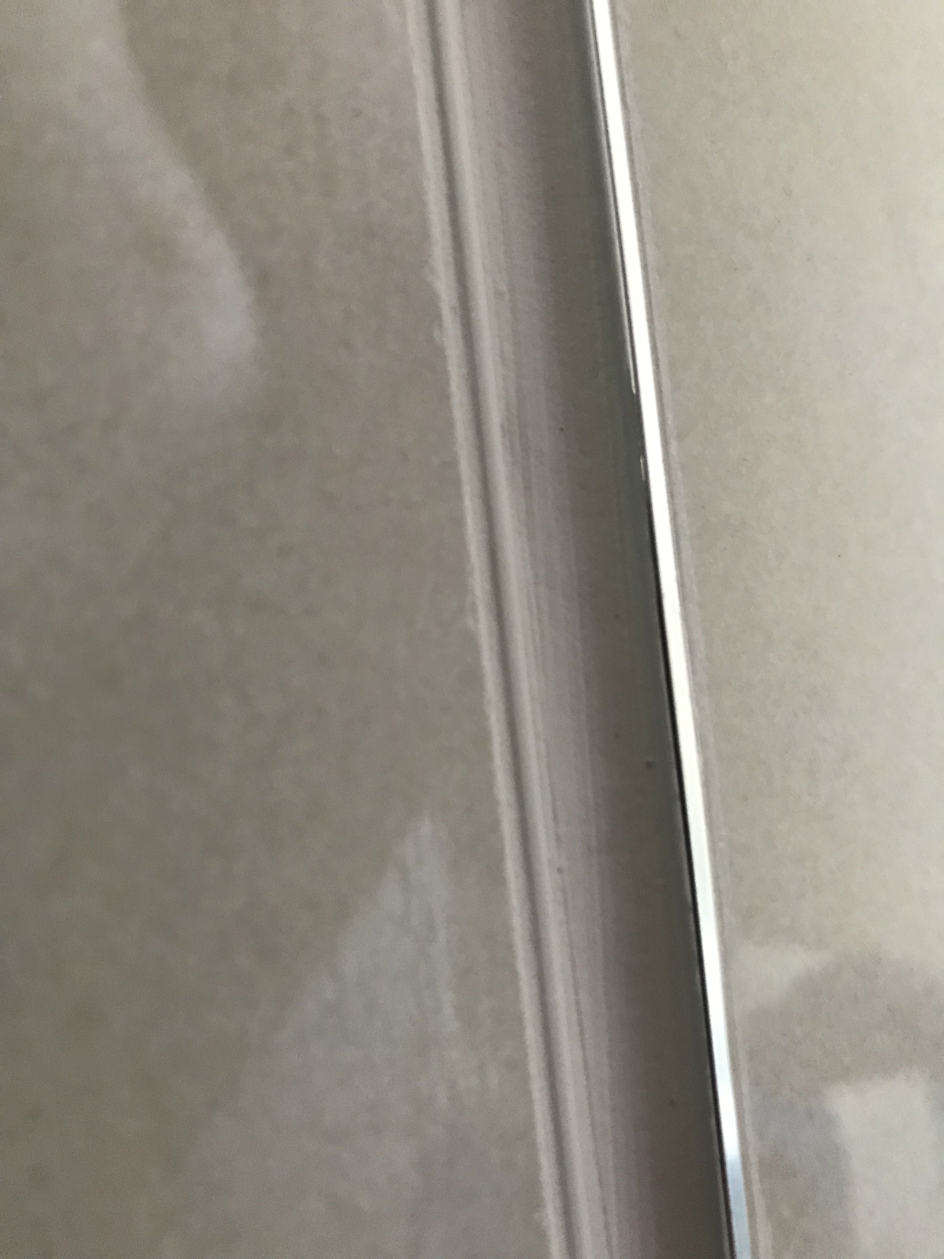

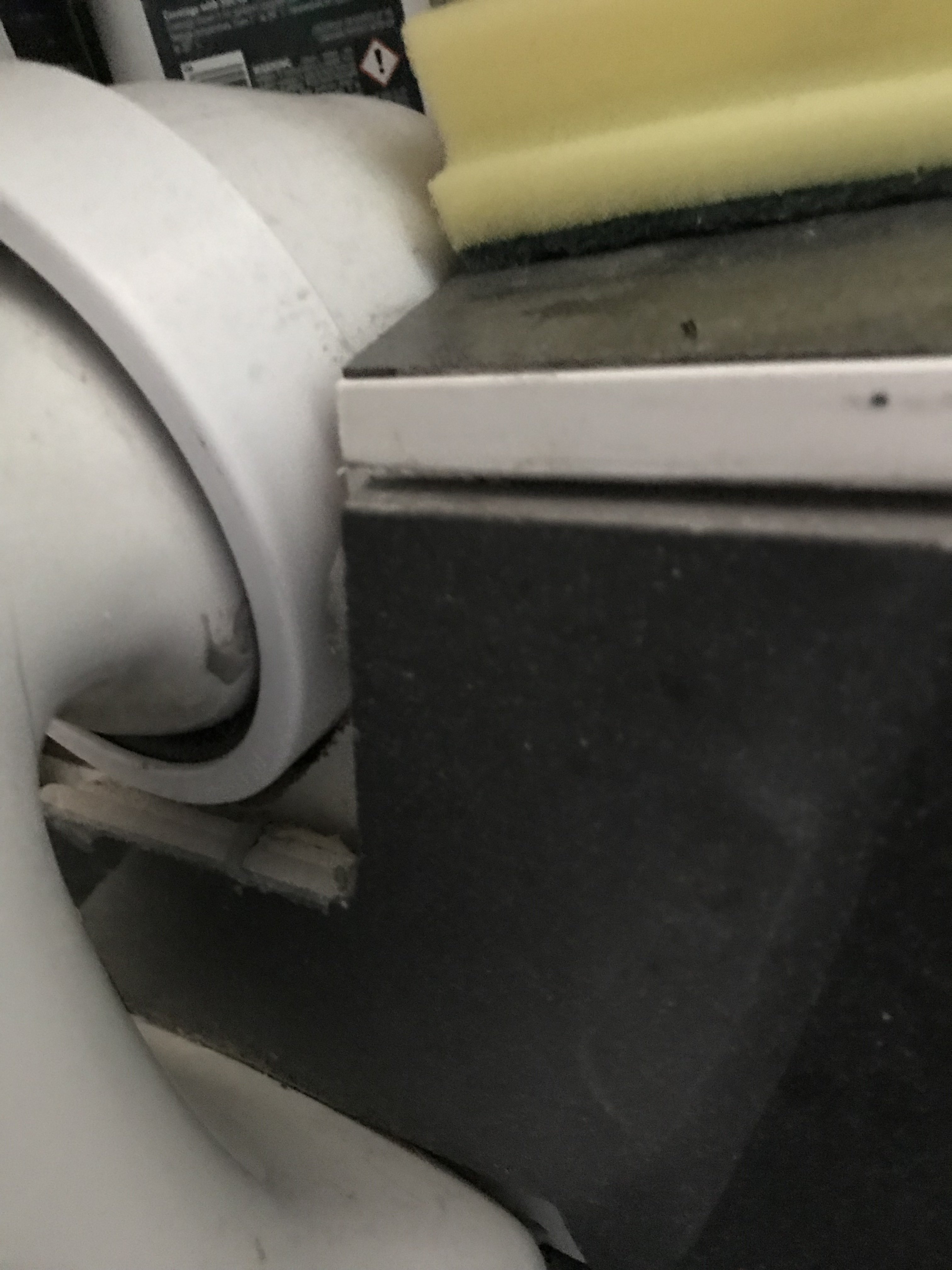

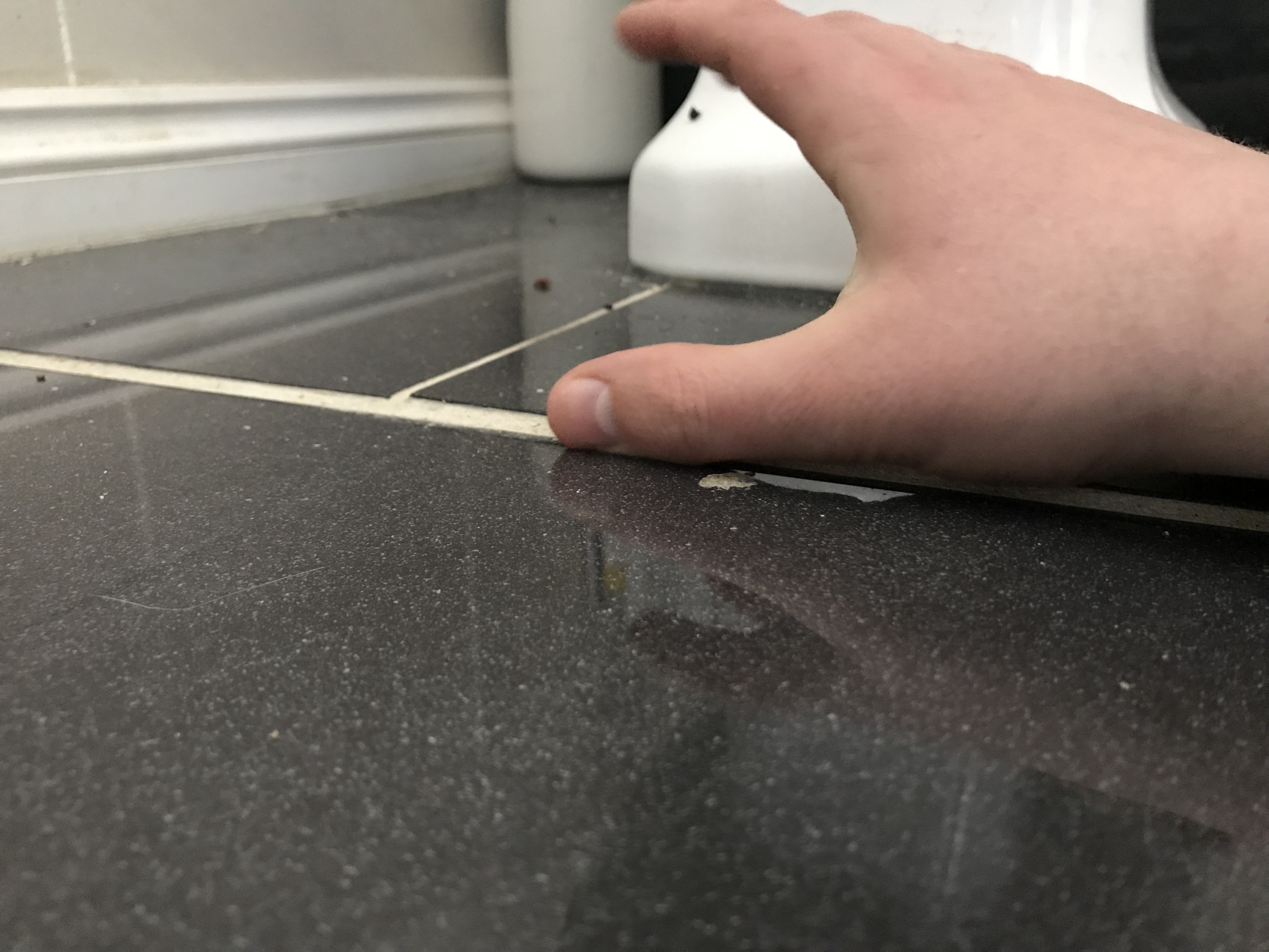

Hey guys,
we got our bathroom made by a professional company, do these results look OK to you? The floor tiles are standard 15x15 cm ones. It's not that bad on all places, but you find quite a few of these. Also, as you can see in the pictures, the sink is tilted, and the shelf has a gap at the lower edge (3 or 4 mm i think), since the wall does not seem to be that flat.
The floor tiles are out of square and it would be impossible to get them to be perfect.
The sink should be refixed level.
Although the is a bump on the wall behind the wall cupboard - a neat Silicon bead would hide the gap.

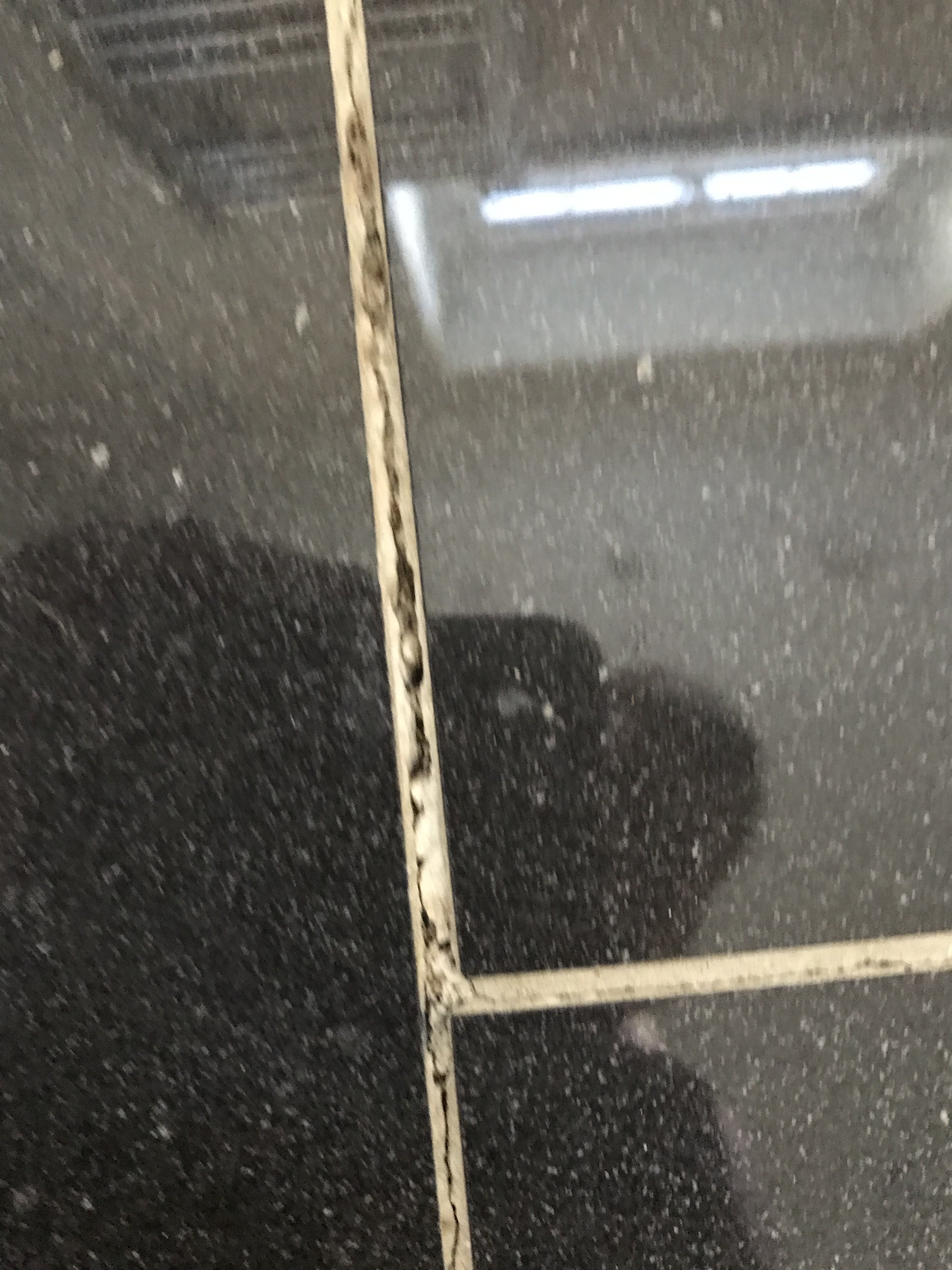

hm what exactly do you mean by "out of square"? Maybe the smartphone camera or the angle add some distortion to the images, but they are, as precisely as I can measure, perfectly square.
Also the one on the fourth image that is sticking out that much compared to the other ones, is that really normal?

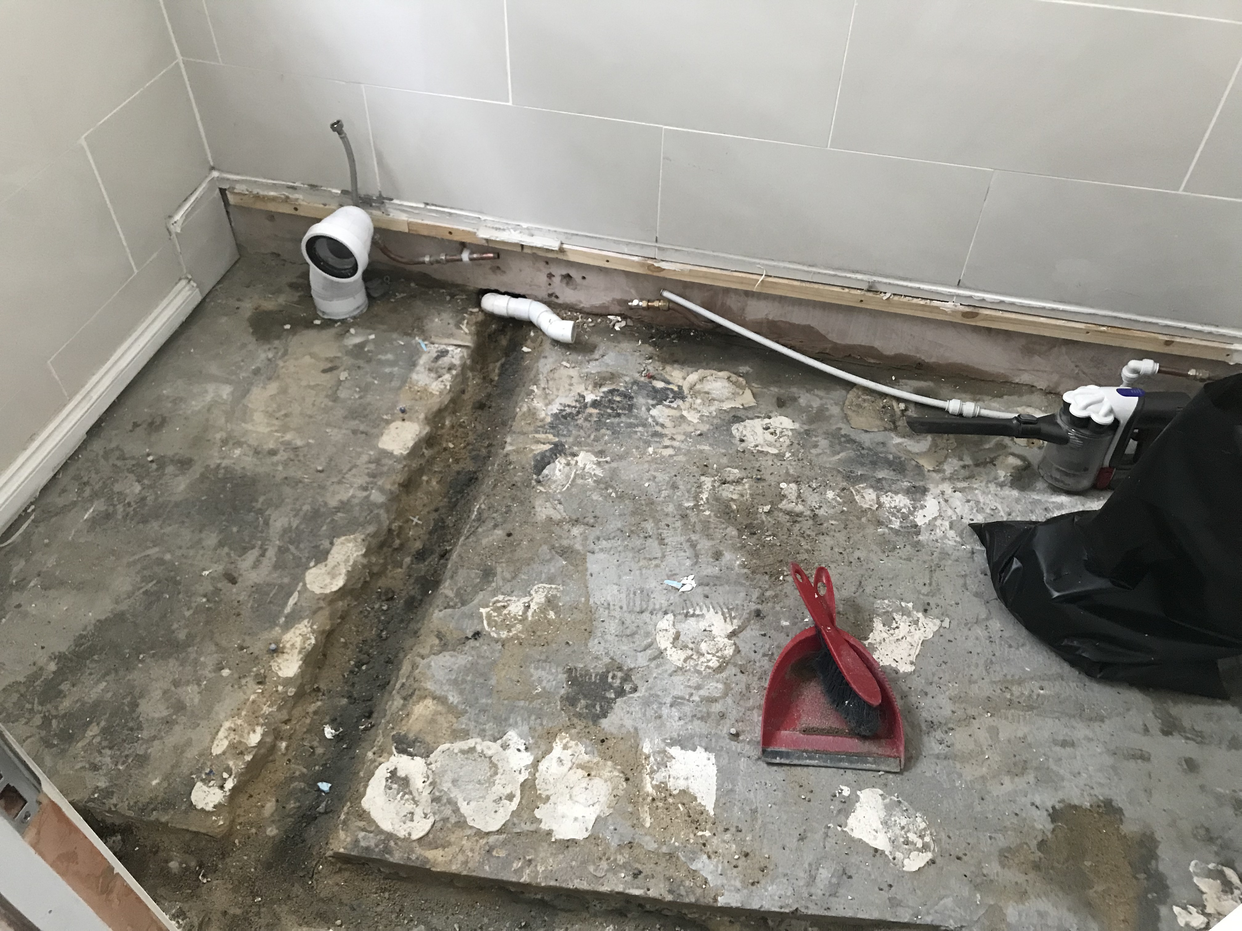

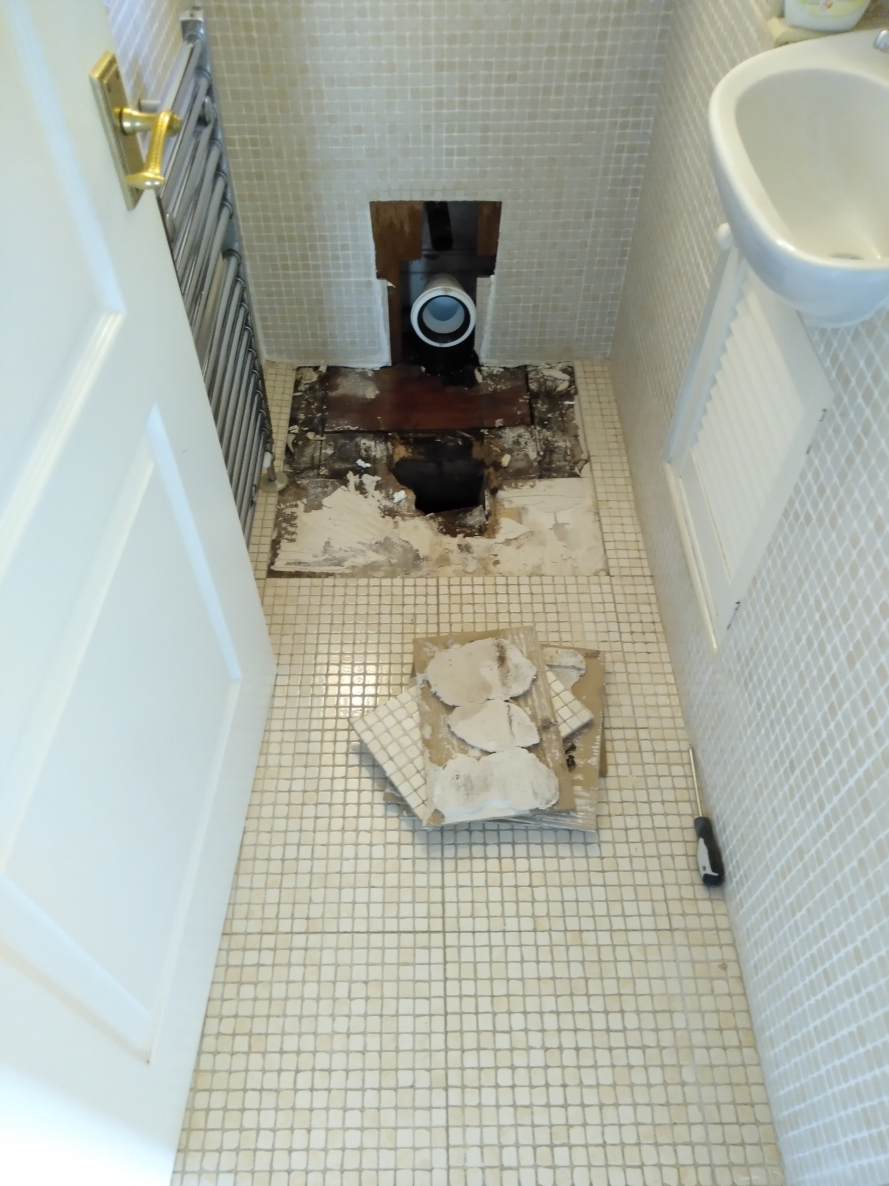

Mum on the phone.... "Andrew the toilet seems to have come a bit loose" ...understatement of the year mum, where's the floor gone!!
Now not to speak ill of the sadly departed but my old dad tiled this, found 6mm ply nailed down and dot and dabbed bucket addy from the guy that was incharge of sites building £1m buildings...what do the say about site managers, to be fair it's lasted 20 years somehow but bloody hell Dad :joycat:

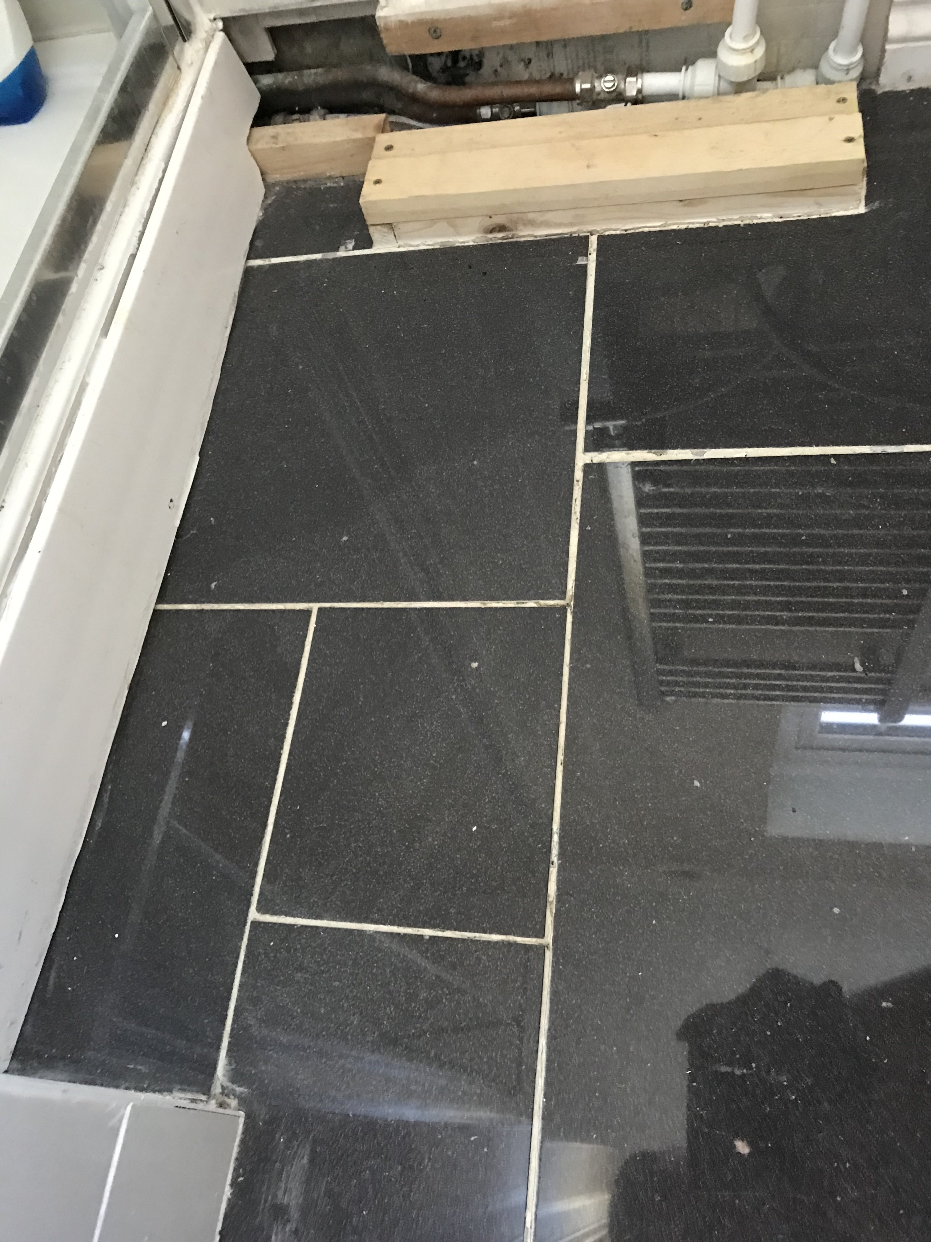

Hi all, first post, I was scammed by a 5* rated CheckaTw*t cowboy with 14 years in the tiling industry about a year ago. My pockets are now £10k lighter, I’ve had to rip it all out and am in the process of retiling. The cherry on top of the cake, he saw the door architrave that I had cut and installed to replace his poor effort which prevent the door from closing and stated he’d done a better job at that than he remembered.....Pictures below.
Wow what a mess!!
How did you end up paying 10k for that disaster?!
