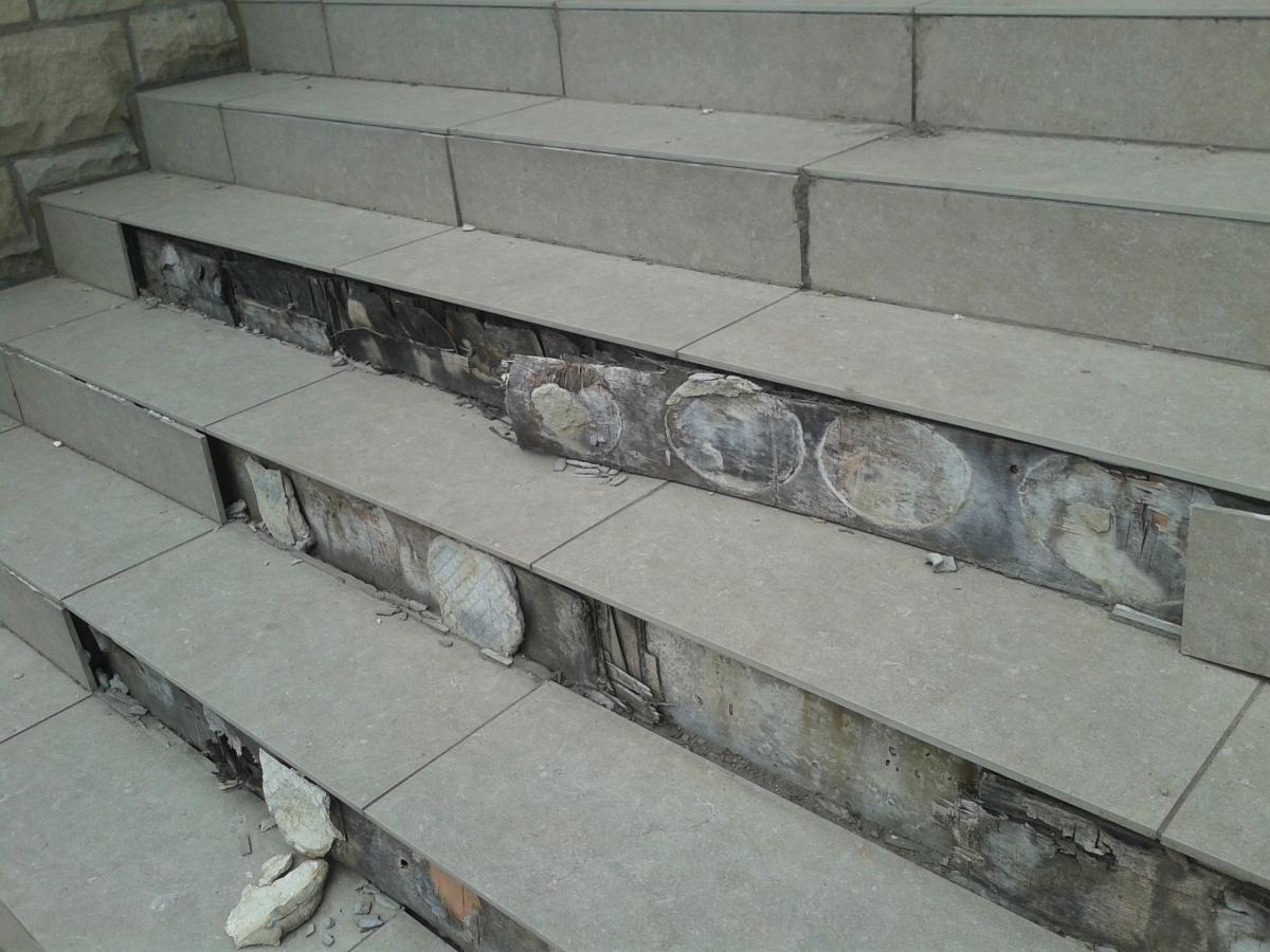

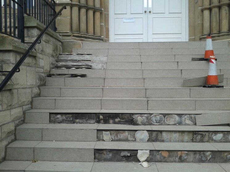

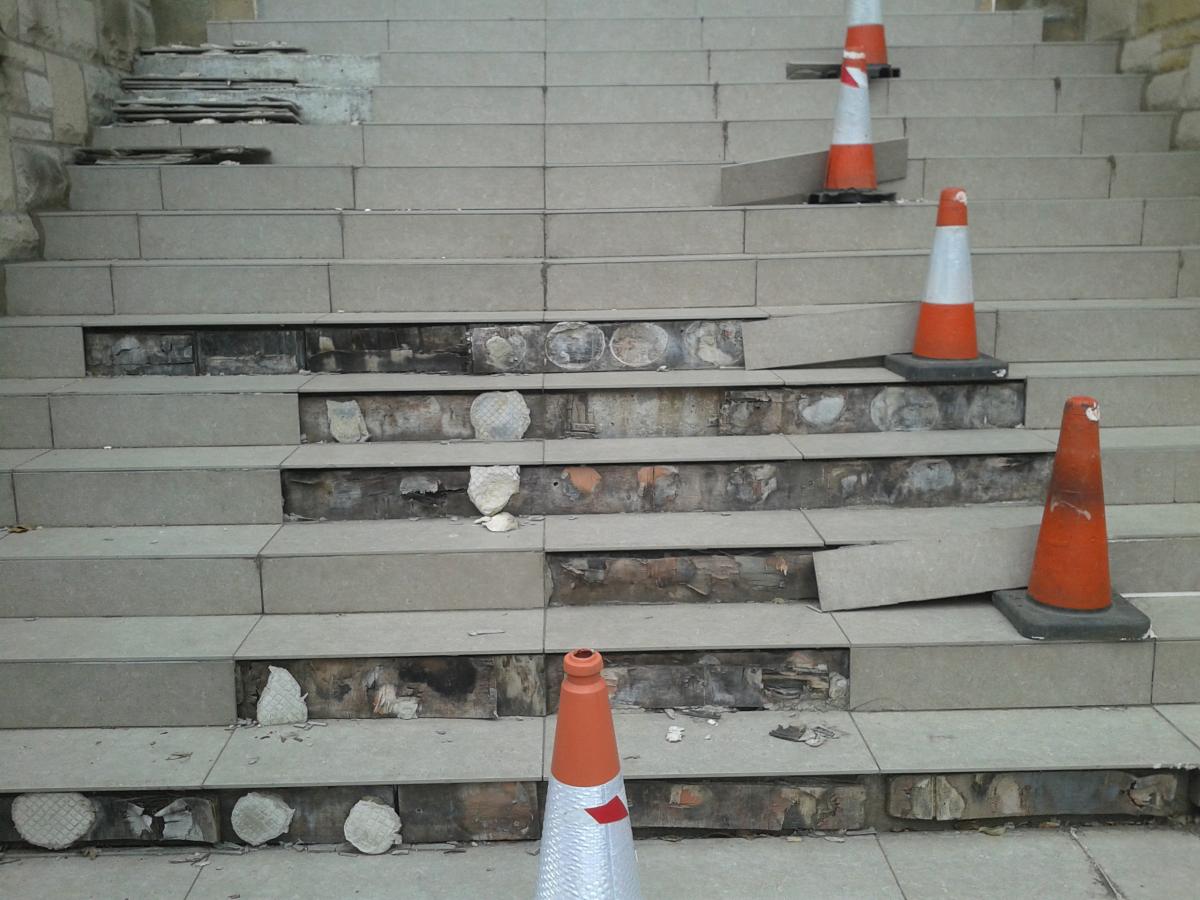

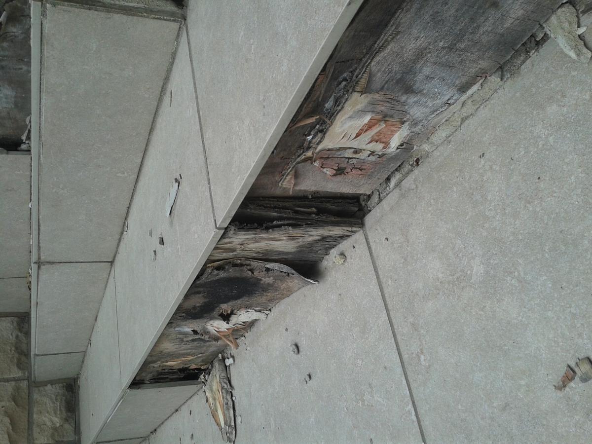

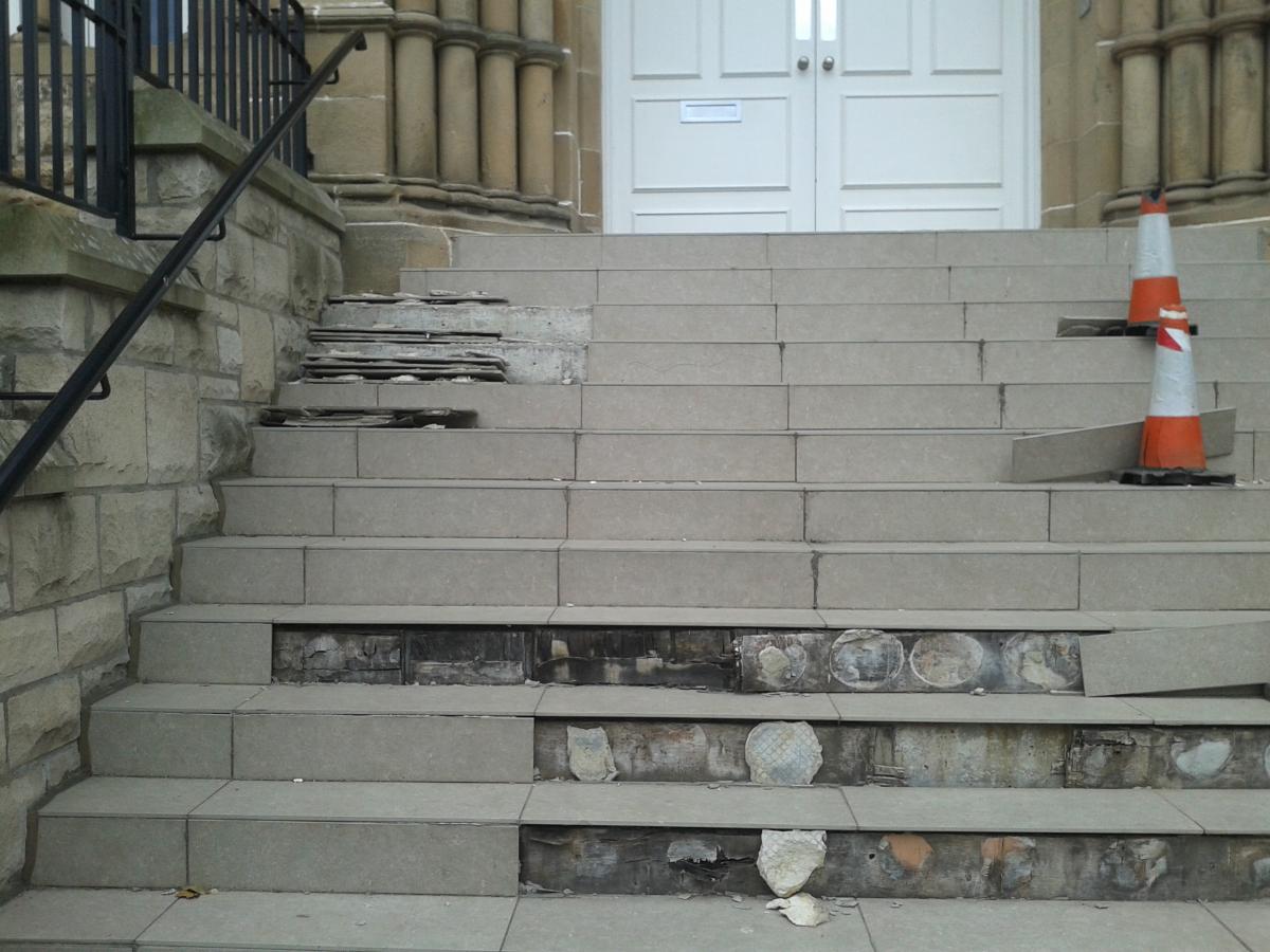

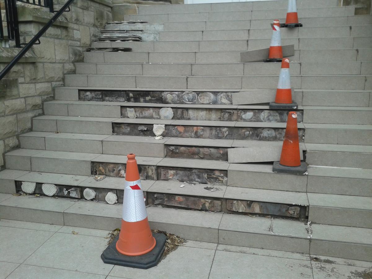

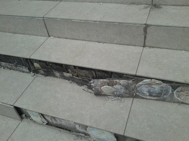

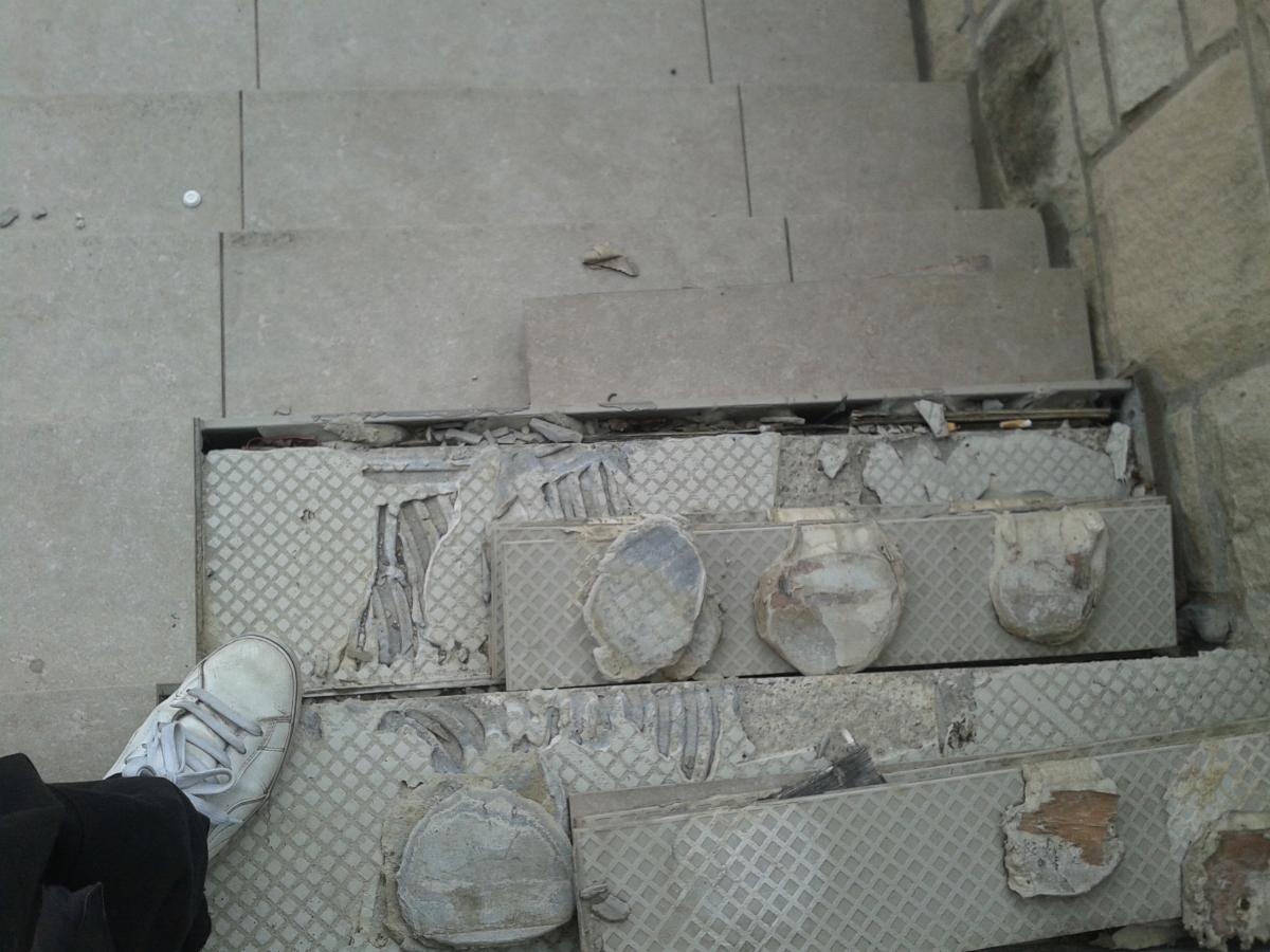

Poor workman ship ! This is one of the worst I've seen..... 20130613_125824.jpg 20130613_131958.jpg 20130613_132005.jpg 20130613_132019.jpg 20130613_132026.jpg 20130613_132042.jpg 20130613_132051.jpg This was a frontage to a museum that has been converted into flats. Steps have been off square so ply has been dot dabbed to square off then tiles dot dabbed onto ply !!!
Residents are now left to foot bill between them....I was asked if the loose tiles could be re seated pml..:incazzato: Builders :mad2:
Top quality work, why did they ever think that was going to work. It probably started to fail 1st time it rained or once the cheque had cleared. :incazzato:
Poor workman ship ! This is one of the worst I've seen.....View attachment 52485 View attachment 52486 View attachment 52487 View attachment 52488 View attachment 52489 View attachment 52490 View attachment 52491 This was a frontage to a museum that has been converted into flats. Steps have been off square so ply has been dot dabbed to square off then tiles dot dabbed onto ply !!!
Holy cow... that is as ruff as it gets..
Surprised somethink did'nt give way when they were walking down the steps, lawyers for you would have made a fortune.
I'll bet they dealt with the cheapest bidder though.
Always seems the same - take the cheapest quote and cry afterwards.

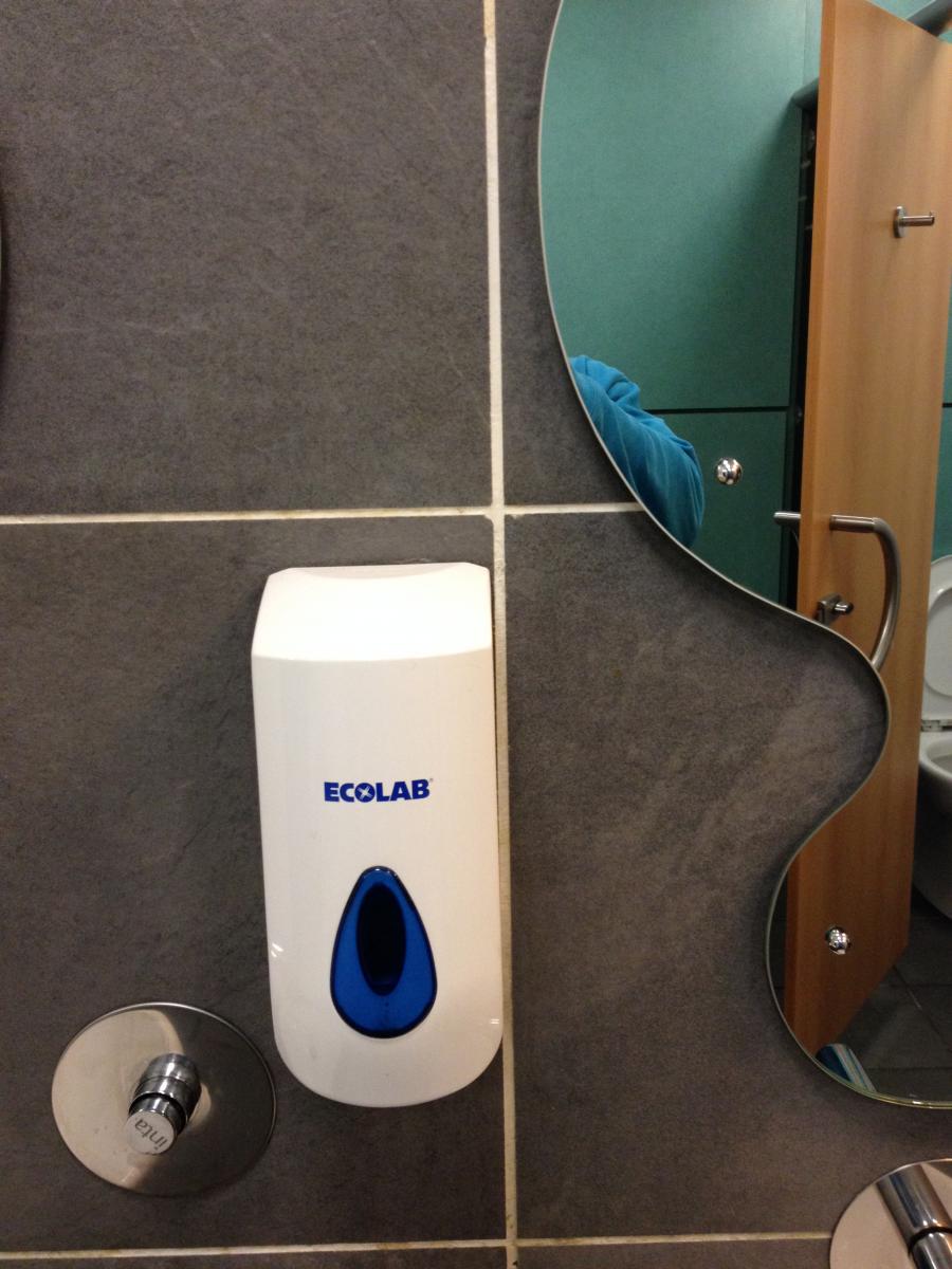

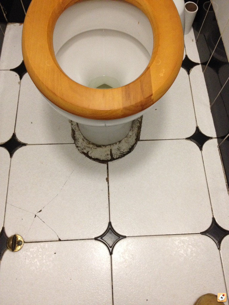

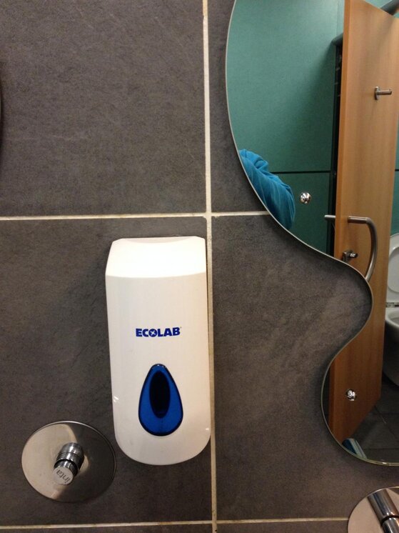

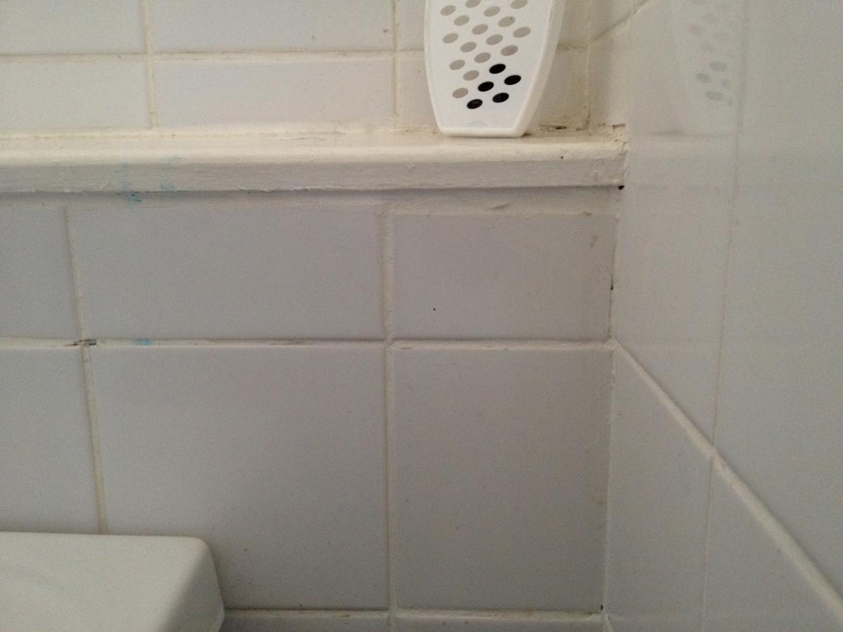

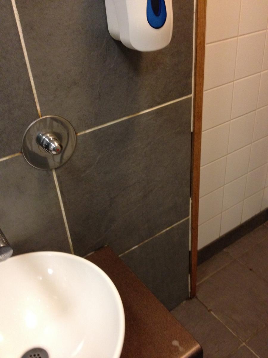

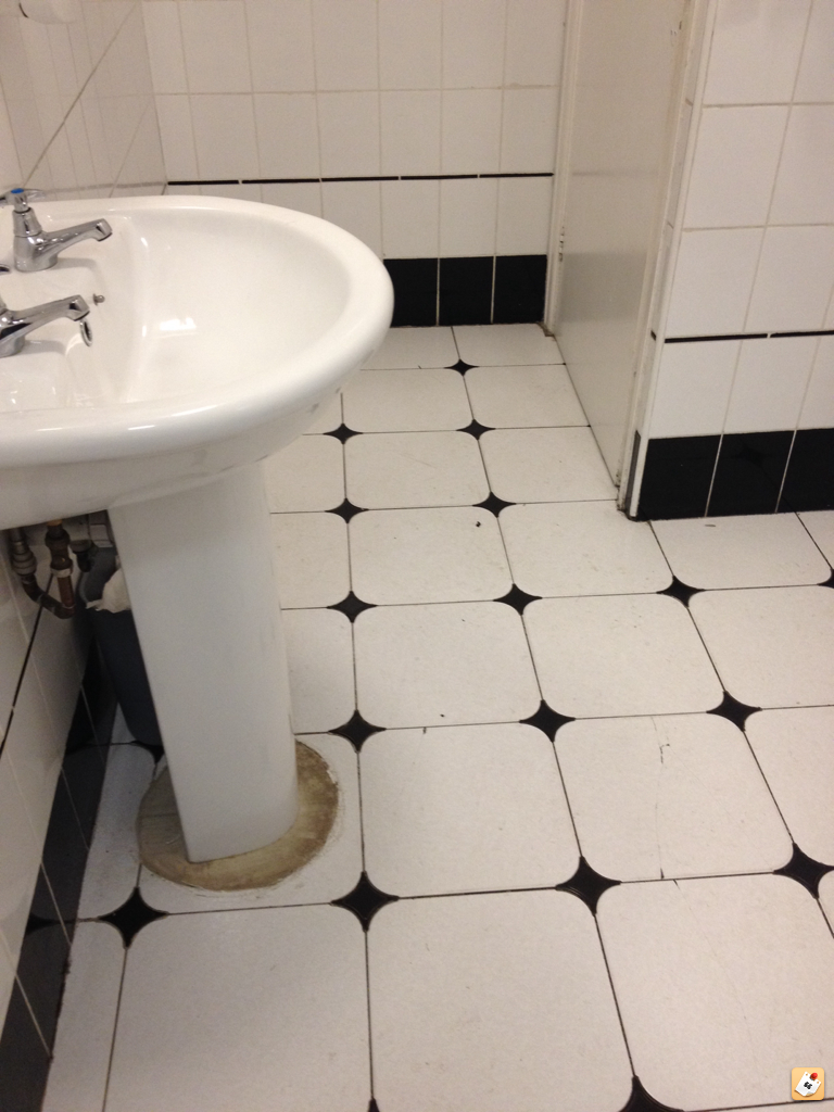

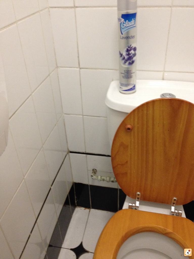

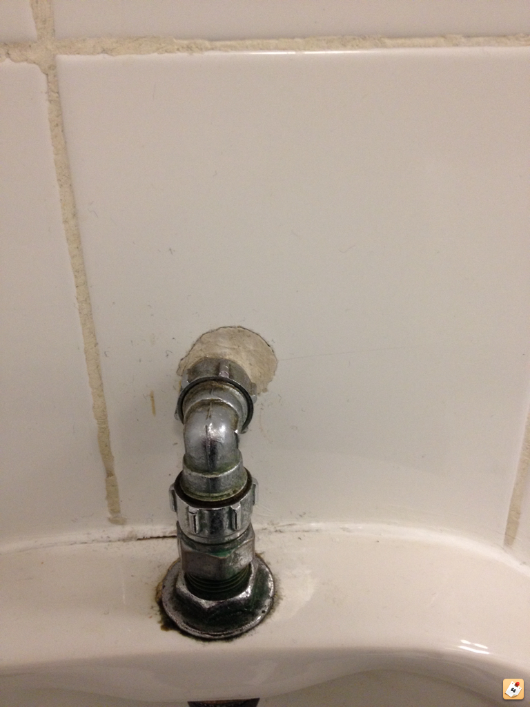

dam you got to one of my jobs was wondering how long it would take! haha man that is some serious cutting around the basins!

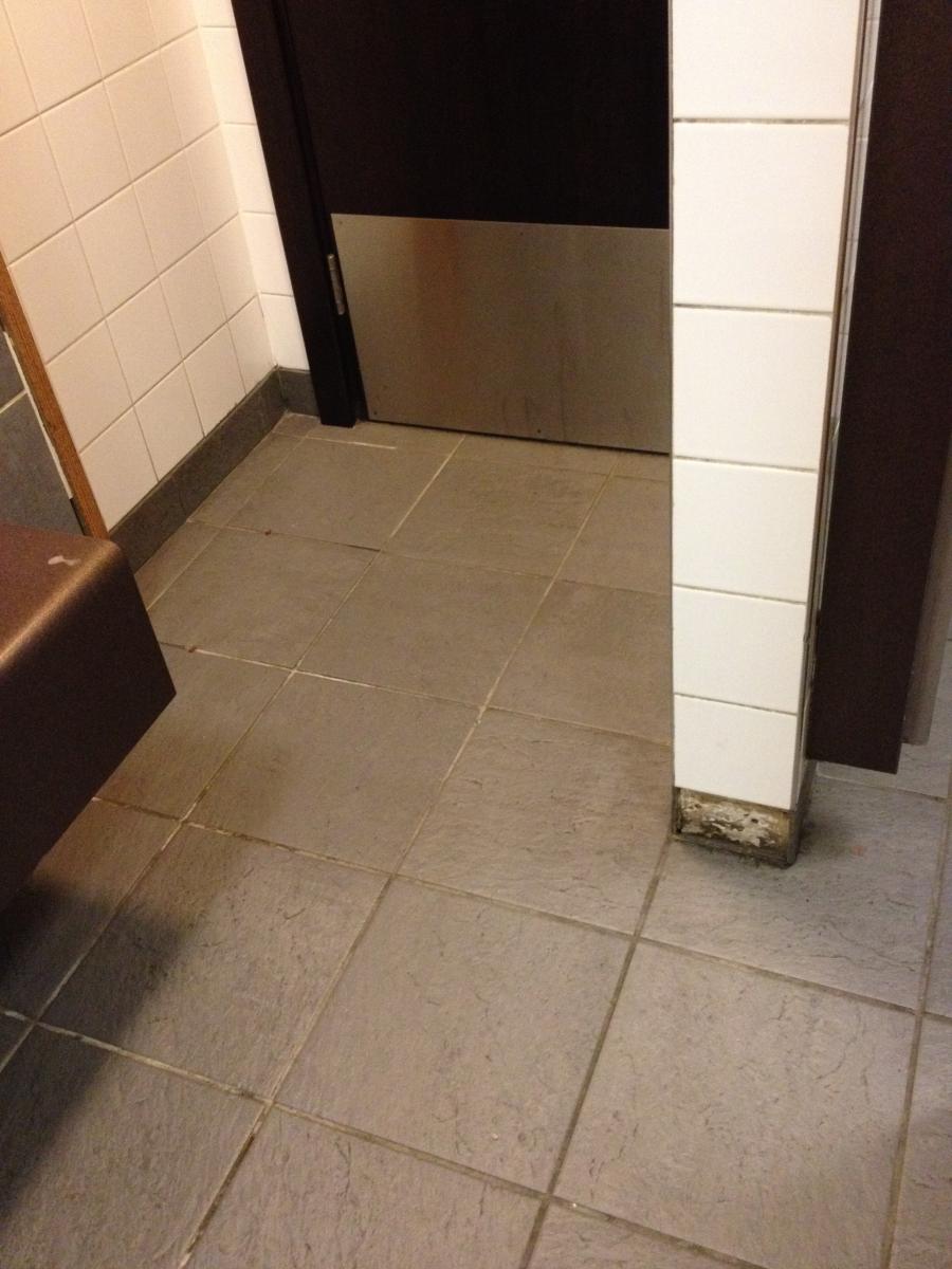

I've had some funny looks for taking photos in public toilets in the past, the women especially don't like it when you're doing it in their toilets :lol:

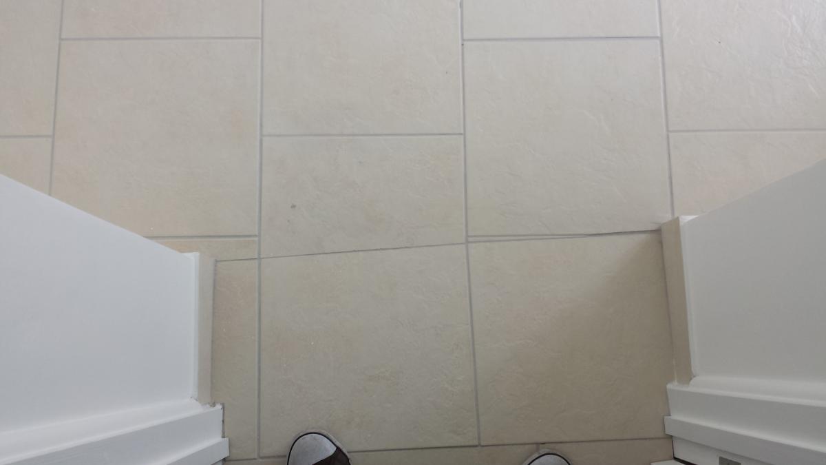

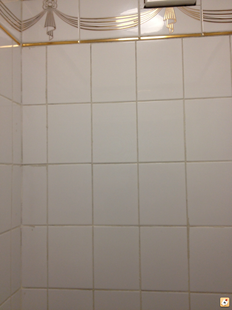

very poor it looks like it was a white grout originally or is that my eyes playing tricks lol? if so its just wrong on so many levels lol
