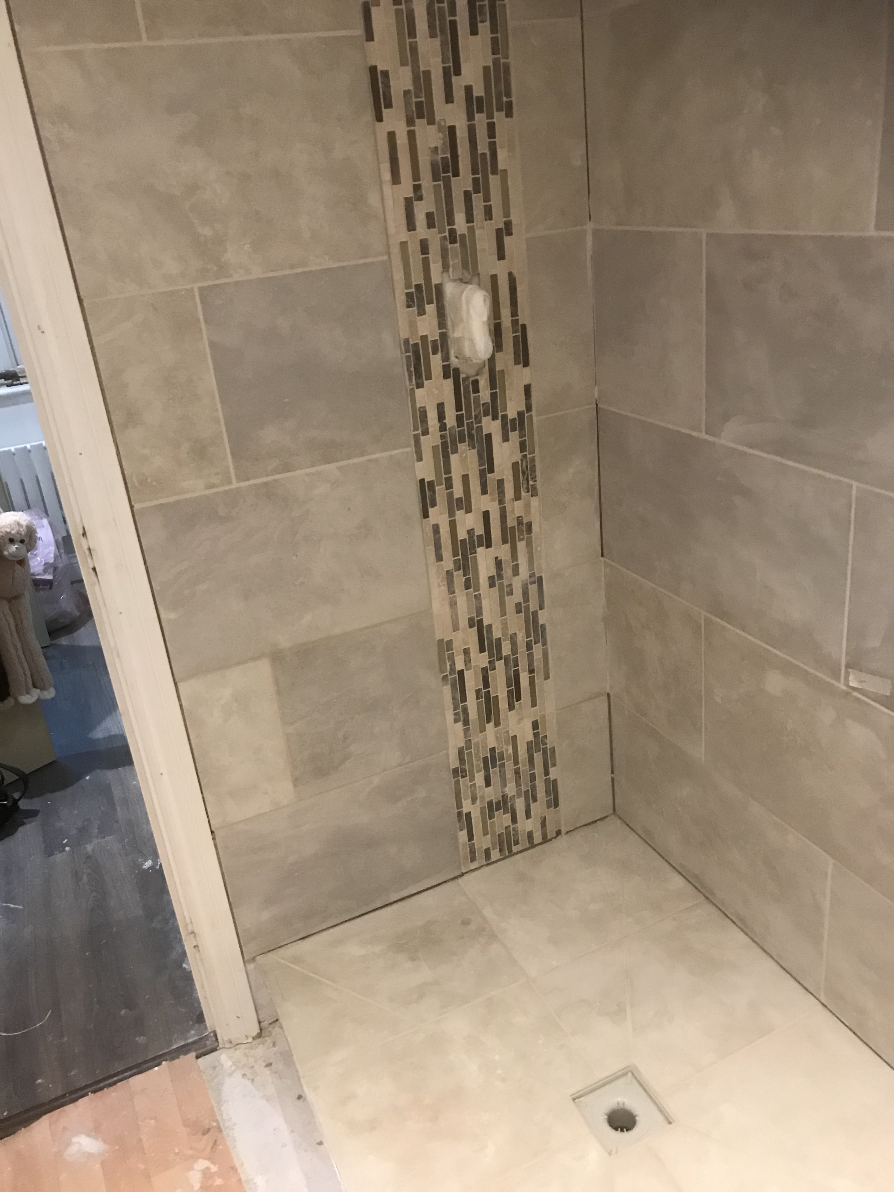

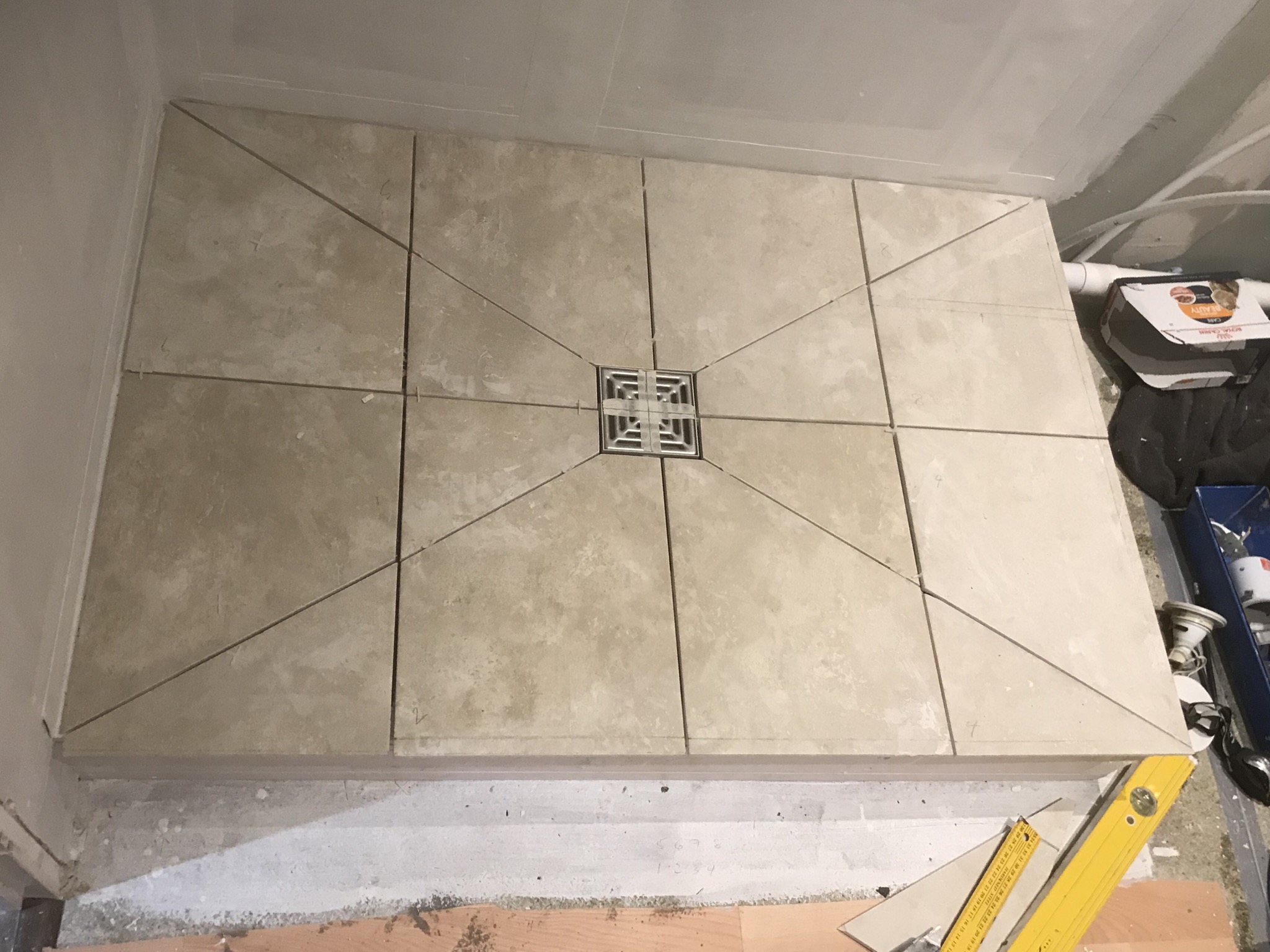

Hi all. I have just had my first attempt to cut the tiles for my raised wetroom floor. They are approx 600x300 porcelain tiles. I have a standard score and snap tile cutter and a cheap electric wet circular cutter from screwfix.
I have done an 'ok' job and one that I'd probably be ok with keeping and not redoing, but I'm still debating hiring a proper sliding one to get it better.
Anyway, my question. Edges. Obviously there is large grouting gaps, mine are 4mm in between full tiles, but what do I do to waterproof the angled cuts to accommodate the fall in the tray? I used the score and snap tool so even though they lay down and fit into one another perfectly, I'm worried about the obvious hairline gap.
What do the pros do?
What could I do?
Thanks. Steve.
Ps if you zoom in on the picture you'll see the lines I mean.

Diy'er here, when I asked about envelope cut spacing the answer was that the blade gap and an edge polish would be sufficient for grouting, given you've scored and snapped I guess you'll have to create bigger gap somehow, hopefully one of the big boy's will be along shortly with full answer.

I know what you mean, if I have to rent a big sliding cutter I will. However I have seen it done like this before, but just don't know what they did to fill the lines

Well I'm now looking at getting a diamond blade for my circular saw or rent a proper sliding cutter to can alter the groutline.
Are they ceramic tiles ?
As above really you need to cut with a diamond blade which removes a couple mm of material which then becomes your grout joint. You must have that Joint to grout otherwise you have no way of closing up the open joint you have made basically.
That's what I was worried about. Great just wasted a box of tiles. Lol. I was thinking about buying a diamond wheel for my skill/circular saw and using a straight jig. Would that work? Same principle as a proper skidy one.

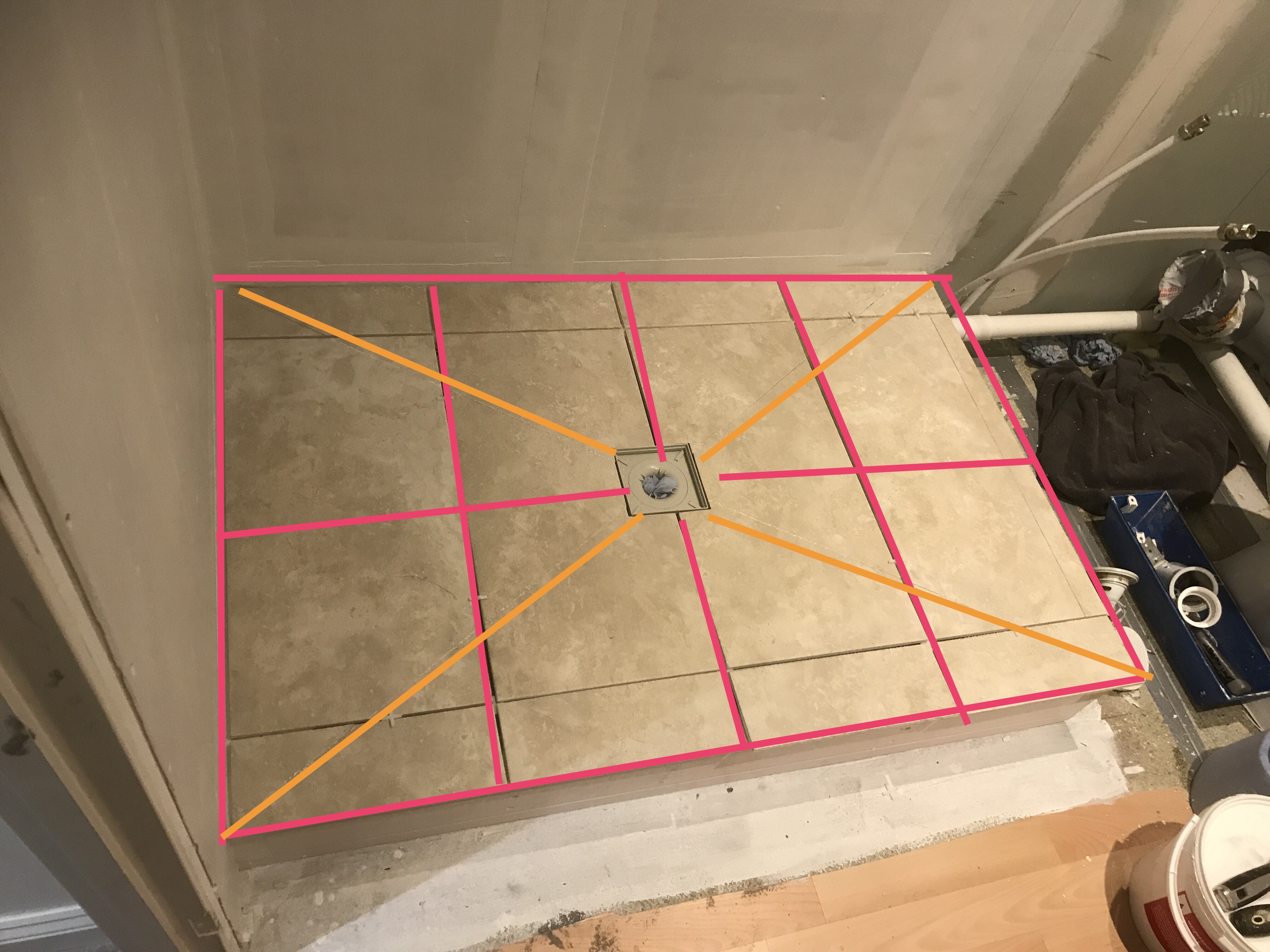

You haven't cut the envelope cuts in the right place anyway.
To get the falls correctly, you need to cut from the corner of the square drain, not to the centre of the drain plate. This so that the tiles will be flat all around the drain and not have lips.
Don't!!!! I realised that afterwards!! And I knew it had to go the the corners as I've watched videos of it being done. What a div. definitely going to do it again. Envelope to corners, 2-3mm grout lines and using a diamond blade circular saw.
Any other advice?

Mate that looks awesome. Thank you.
I plan on getting a diamond blade for my circular saw and making a jig up so it's a sort of diy sliding saw tile cutter. Think that'll work?

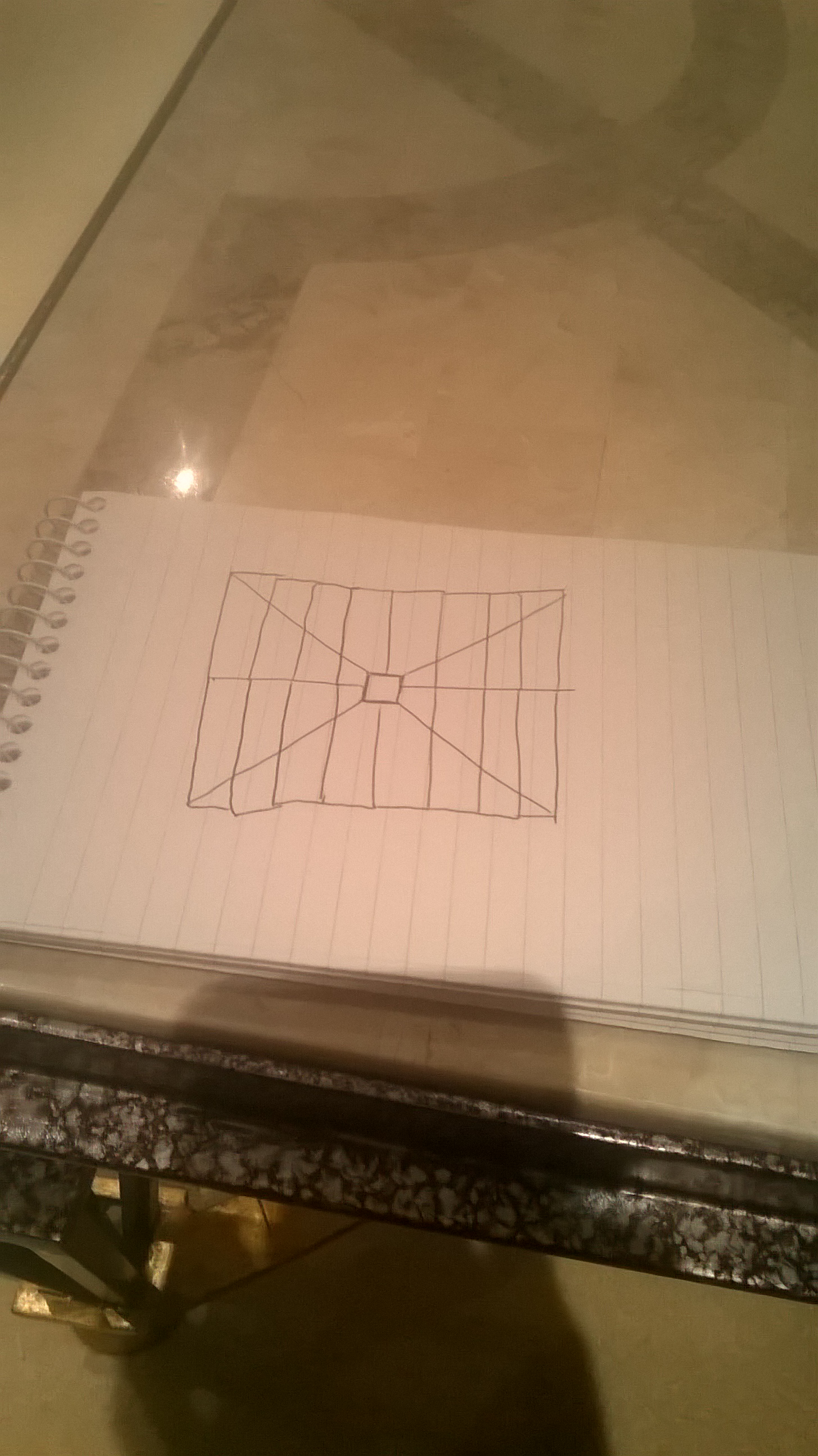

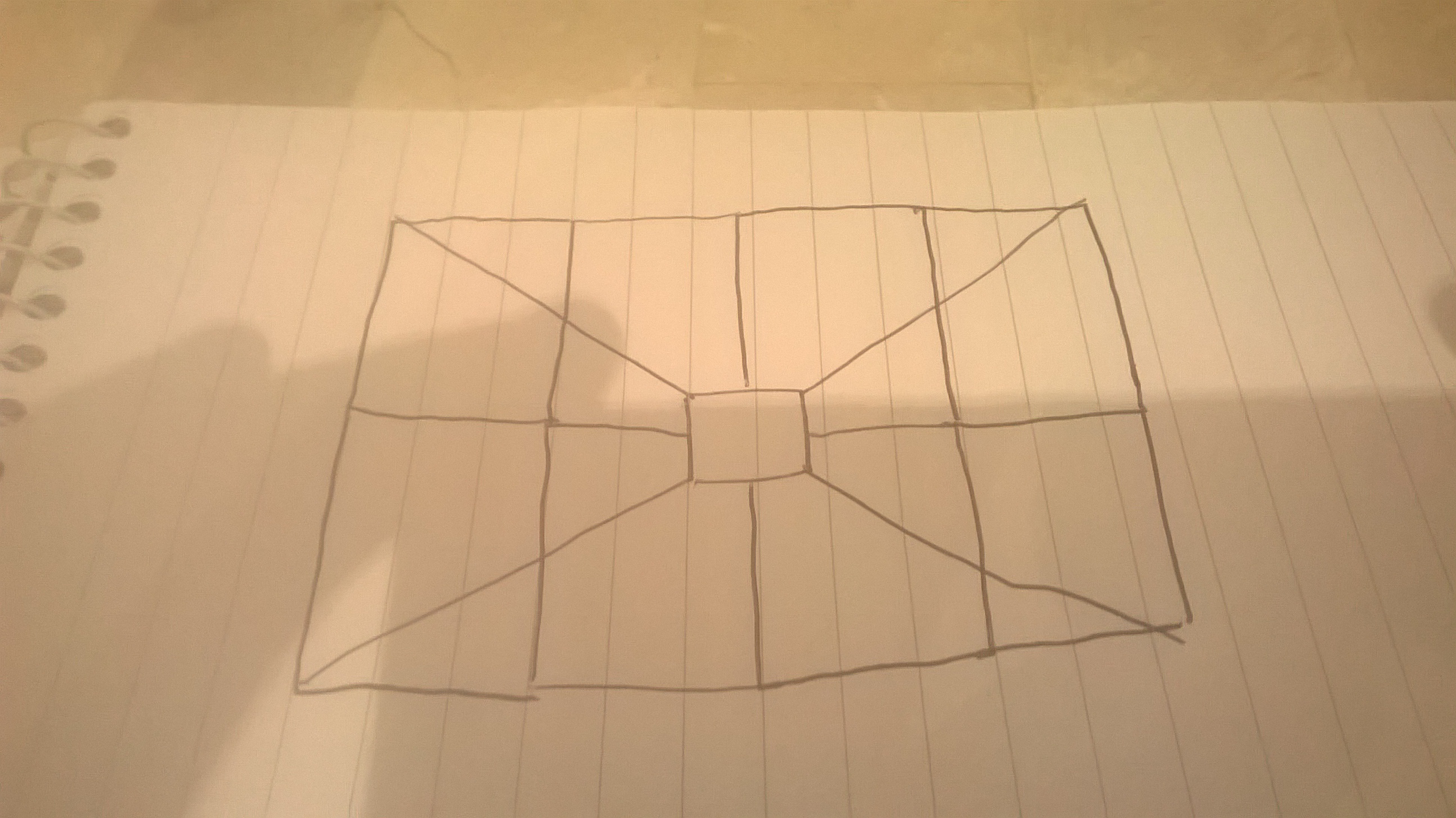

Why not run a groutline through the centre of the drain and get rid of those small cuts on both sides?
Edit..infact if you did that you could use your dry cutter for the envelope cuts and just open them up with a 2mm spacer :)
E
Essexsteve
I'm sure that is a fantastic idea however I have no idea what you mean. Lol. I'm sorry to take up your time but could you explain it a 'little simpler' for me? Thanks.
What small edges do you mean? And what do you mean by 'run groutline through the centre of the drain'?
