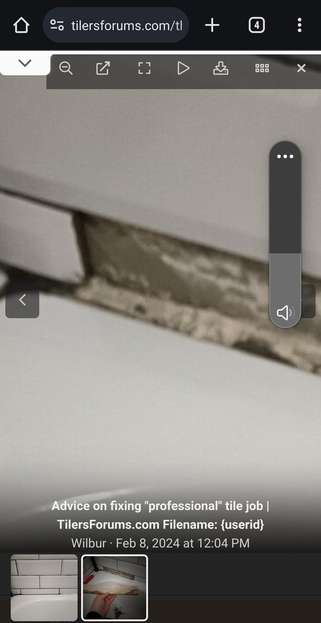

Hello, I'm just a home owner who doesn't have much experience with tiling but I'm looking for advice on fixing a few problems that a professional left me with. He of course has not responded to any messages.
Basically it turns out that he used the dot and dab method when retiling my bathroom last summer. I think this is the reason why two tiles have developed hairline cracks and one fell off the wall completely. I put the tile back on using a cheap "fix and grout" because I didn't want to buy a whole bag of regular tile adhesive, and I had some grout left over from the original job.
However I discovered that between the bathtub and the wall there is spray foam in the gap, topped with grout, and then silicone over that. I cut away the silicone and the grout where the tile fell off but I'm not sure if I can now just put silicone in the gap, or whether I should strip the whole wall and replace the silicone.
I don't really have the means or desire to redo the whole thing (that is why I hired someone after all) but I would like some advice on making it as good as I can and not have water seeping into the wall.

Welcome to the forum.
One thing to note with bathroom or shower tiling, is the water (whether condensing on the tiles or literally being sprayed on them) get into the back of the tiles by running down the tile face, then soaking into the incredibly porous grout, and then soaks into the adhesive (just as porous) then the plaster or plasterboard.
This then over time gets pulled by gravity to the bottom, and then it can 'blow' the adhesive on the bottom row of tiles because it has nowhere else to go.
So I'm afraid you'd be better pulling all the tiles off and using PVC sheeting if you're really tight on a budget. Or pull the tiles off, let it dry out and plasterboard, then tanking 'paint' (rubber/acrylic type not PVA-based anything!!) applying, a couple of layers of that. Then tile with cement-based adhesive, and cement-based grout. Then a 6mm bead of masking-tape-guided silicone just to finish off, for looks, it doesn't hold any water anywhere or stop any water getting anywhere (very common misconception).
That aside, it looks like you've got dispersion adhesive there so that'll keep getting re-wet by the above process.
You may try pulling the loose bottom couple of rows and use a cement-based adhesive and cement-based grout. It doesn't matter if that gets wet then. Although the water being there can be a problem long-term (damp and mold and that kinda stuff).
ps just reread your post and you've used tile and grout, which is neither good as a grout or adhesive, I don't know why manufacturers who lead the market in adhesive, still make such a product knowing it causes so many problems in wet areas.

No don't seal over it all, you want your grout to dry out, and dry the back of the tiles, which are dry biscuit so also soak in and hold moisture.
Use a cement based adhesive, small bag. Cement based grout, smallest bag. And save the bags under the bath behind the bath panel and they are there then for when the next ones blow. And they will.
But you do you matey. :) 😀
P.s. just zoomed in on that plasterboard and water ingress has taken place so that's lost its strength. Really could be a dangerous situation if the paper face on the plasterboard comes off with a big sheet of tiles and all the weight of the adhesive etc.
Be careful.

The tile to the left isn't fixed any more.
But I zoomed in to see if I'm seeing cement based adhesive (that's wet). But it could be plasterboard. (Thats wet).
You sure a pipe isn't leaking behind there somewhere?
