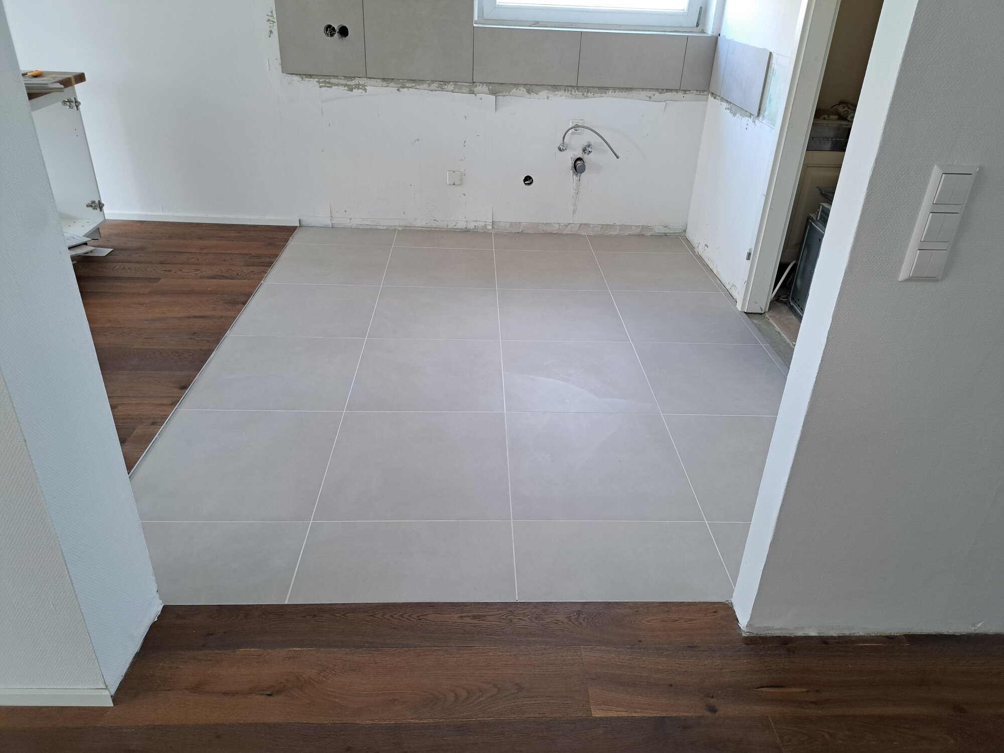

after tiling the kitchen area I did grouting but I am not happy with the results. The grout lines are too bright, almost white. Although I used almost dry sponge to wipe off the excess grout (with special rollers so I can get the water out), it seems that I managed to wash off pigments in the grout. I concluded this by taking a look on area on the edges where I somehow washed less so the color is not that bright. The grout is from german company called Schomburg (Crystal Plus).
I guess there is not much to do except take out all of the grout lines and grout again. I am not going to do this as a beginner, since I believe the results will look even worse (not sure if I can take out the grouts properly). I did the grouting yesterday (less than day ago).
Is there any other solution? Can the grout lines be painted or would it be possible to grout again (although

You can stain the grout any color you want, call your local tile supplier, they should sell grout stain
by the sounds of it you’ve used the wrong colour grout when grouts wet it is a different colour too when it drys that’s why a colour chart is good take an off cut of tile into your local tile shop and they can colour match it too your tile. If you wanna change it you can use a Stanley knife too scrape out the grout it’s best too do that now rather than later as it will still be soft. The longer you leave it the harder it will cure.
also the grout colour you’ve used is called porcelain white which says it in the name it’s a white grout a silver light grey from photos is what your after in my opinion.
