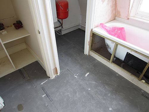

Well...its nice to know that there are people out there (still) skilled enough to cut by hand.....after all....its just a bit of string and some know how!!!!!!!!!
Evenin'........I must be getting old.........8 flights of steps to the top..........I am knackered!!!!!!!
here is a taste of whats going on!!!!!!

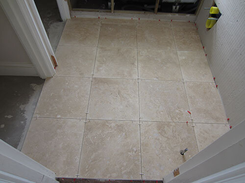

Yes it is Gary.....405x405x12mm........and it is as square as a donut!!!!!......and as solid as a feather!!!!!!...hehehehehehehhehheeeee......

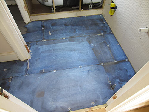

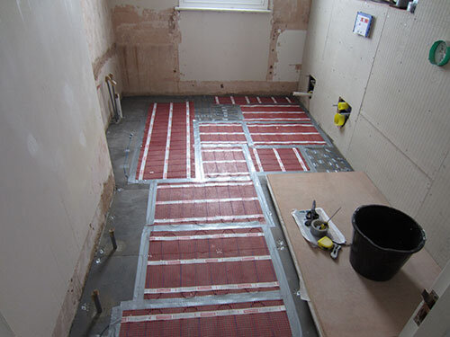

fitted an underfloor heating system in room 3 today:
Then I primed the heated area.....because the mats I have (Warm up)......refuse point blank to stick to the insulation board's!!!!!!
and even with the floor primed.....they still wont stick.....so I had to gaffer them also............I only ever have this problem with client supplied materials....the mats I purchase "Stick like s***).......oh well!

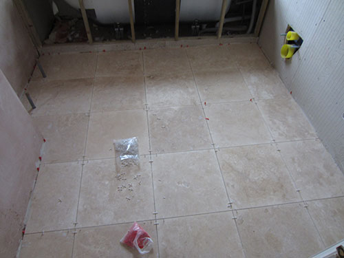

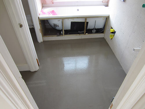

Its screeded in and ready to tile!!!!! yipee!........

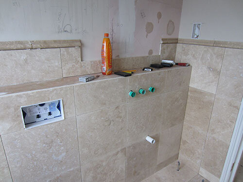

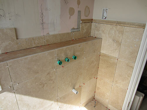

then I went back to room 1.......and the drawing's I had did not work out right (in the room)......they wanted a dado on the top of a boxing and around the perimiter.....no problem for me but the granite tops will have ended up sitting on the dado's........and that will look rubbish..................an hour and a half later we had a solution......and I had cut the bottom course of tiles twice now for "new" set out!!!!!!!............

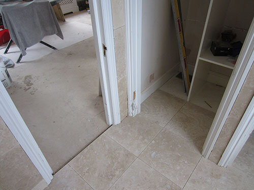

This was the last photo I took of the day........this travertine (and all the most recent travertine I have worked with for that matter!).....is out of square, full of holes in the backs and full of filler on the fronts............CRAP!
but dont worry mister owner of the Monsoon clothing brand......I will give you a silk purse out of a pig's ear!!!!!!........
