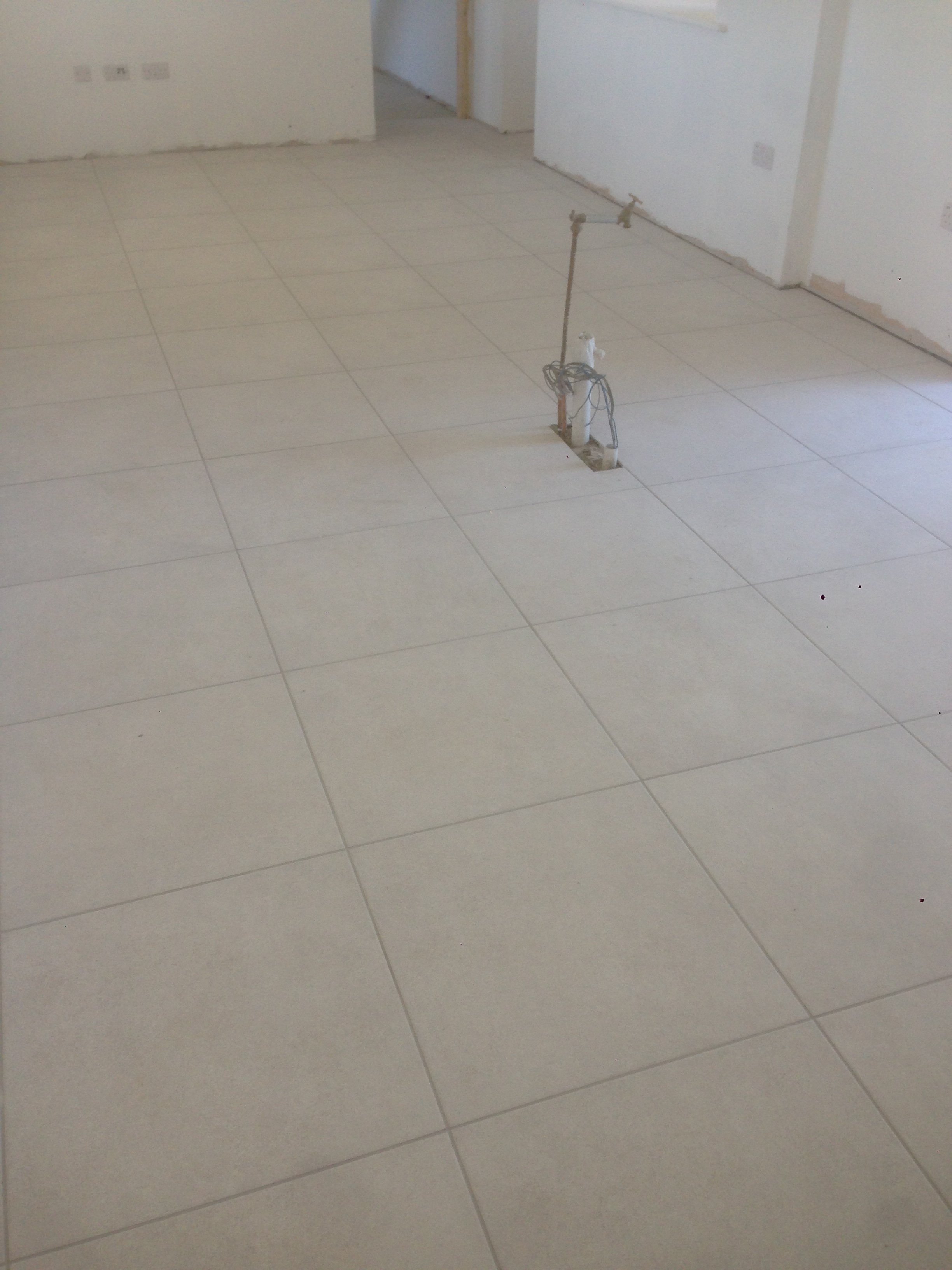

Alternatively, the grout was very wet or he over wet the floor when washing off the grout the first time. The replaced tile looks better with the darker grout as you can hardly see it but ideally you want to see so it matches the rest
Totally agree, I wish this was the colour we had for the rest of the floor, it's much whiter than we were expecting.
What is the colour stated on the grout bag?
The problem with the whiter grout line is that your eye is drawn to it and away from the tile, whereas the darker grout blends in to the tile colour and then you see the beauty of the tile
It's Grey and was the recommended by porcelnosa for the colour of tile we purchased.

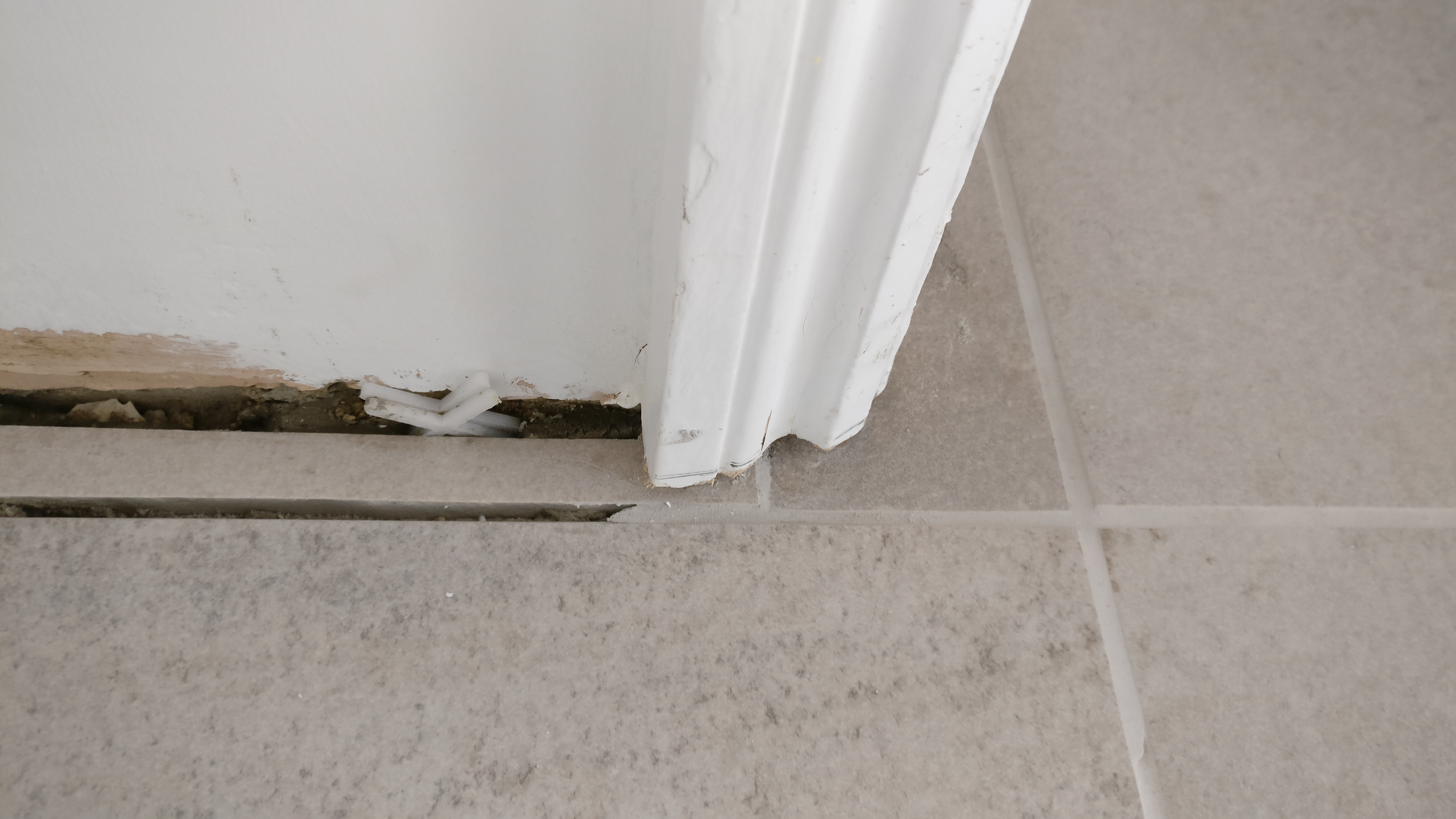

Xxxxx tried his best to rectify the situation with the tiles over the last two days but I'm afraid we are now left with some big gaps to fill in the architraves. I did manage to stop him before he cut anymore this short and as you can see from the pics we managed to get it right on a couple of them after some guidence regarding how the tiles should be fitted and insisting the wood was cut to the correct length.
1. On the architraves that have been cut too short, we will need joiner to replace these please. I did have a chat to the joiner and even he agreed cutting the architrave to lay the tile was fairly standard practice to create a clean finish nowadays.

Well if that is the case then the second grout is the right colour it should be when it's dry. As stated before there was definitely too much water used originally.
Not a perfect solution but you may be able to use a colour enhancer on the original grout. Does it go darker if you dampen it?
Yes it goes darker when wet. Is this a good sign that an enhancer can be used?

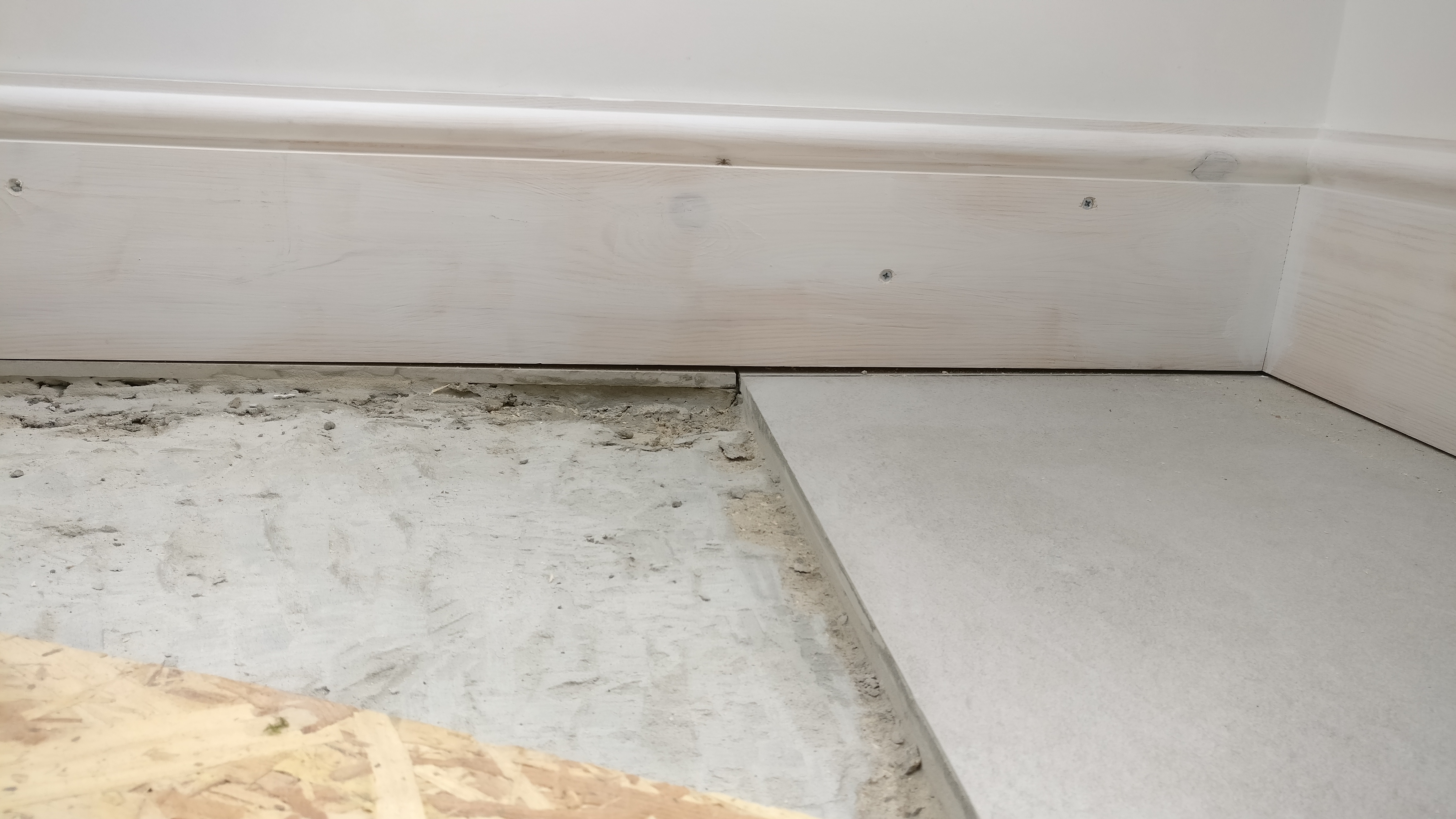

Here's a nice view of how much adhesive has been used. You can also note just one example of the varying levels we have now against the skirting. Bear in mind this was a brand new floor that should have been level.
No excuses now, I would insist that it comes up, levelled correctly, and re-tiled. Far easier to do it correctly in the first place!!!
