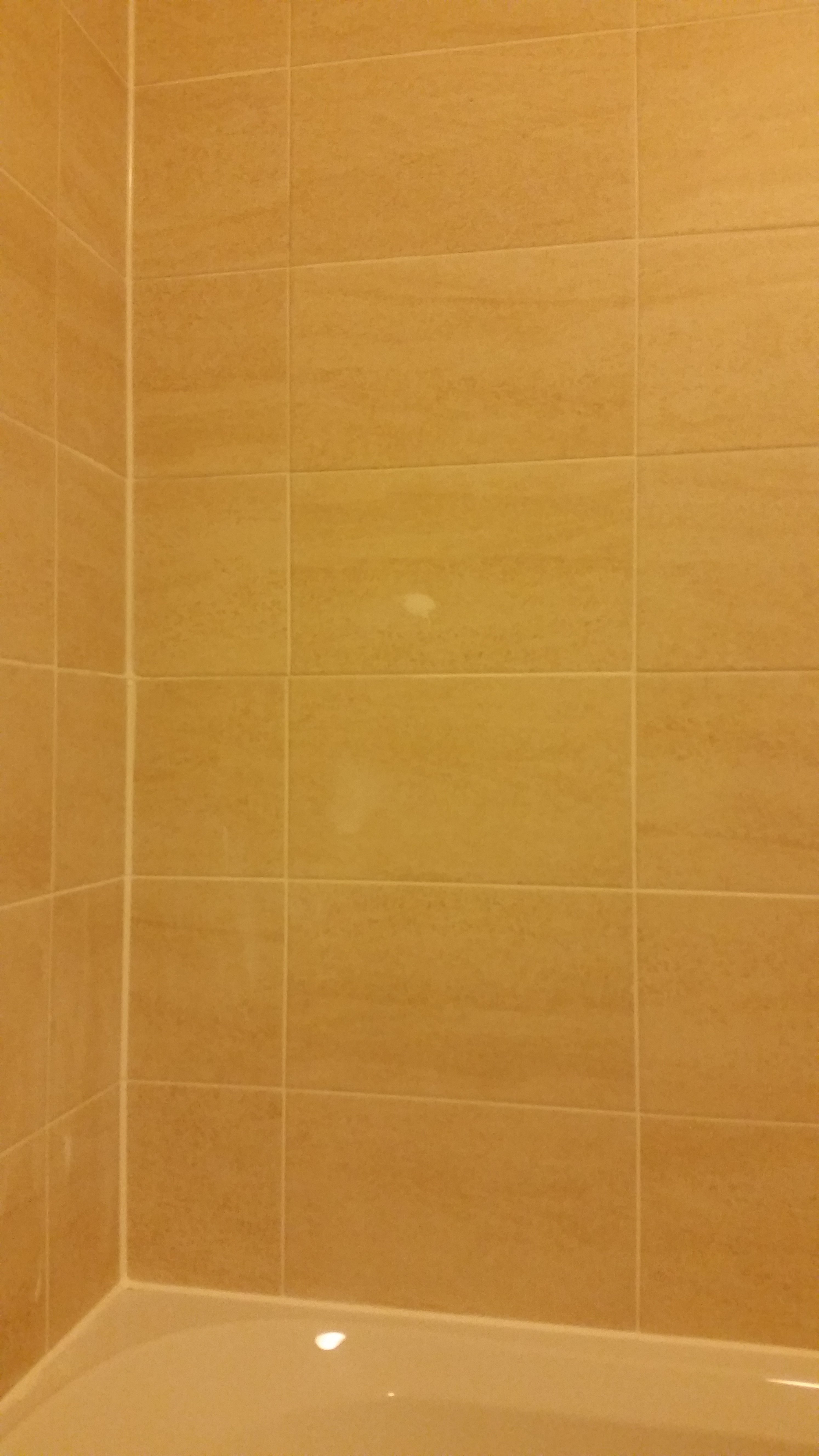

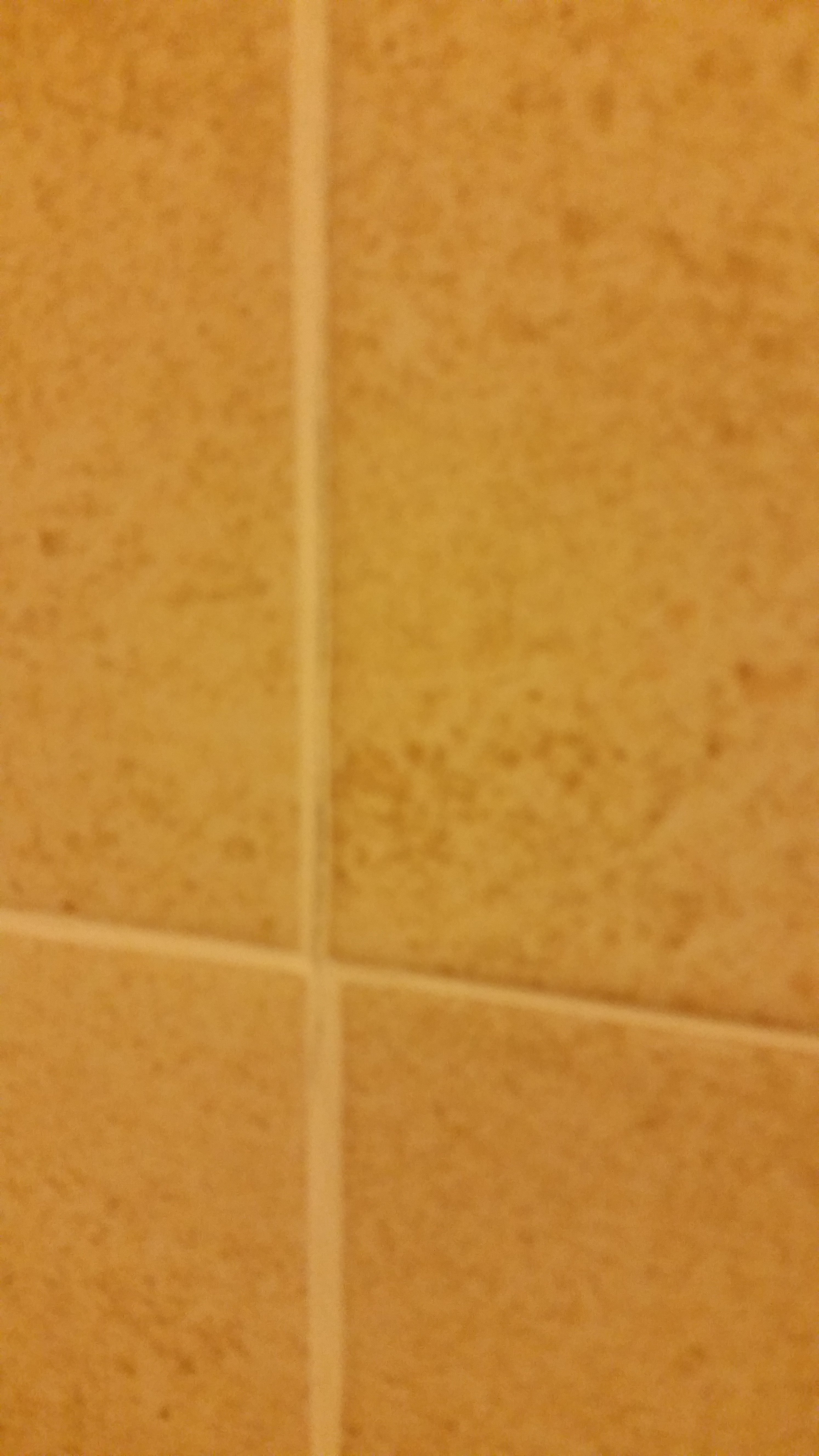

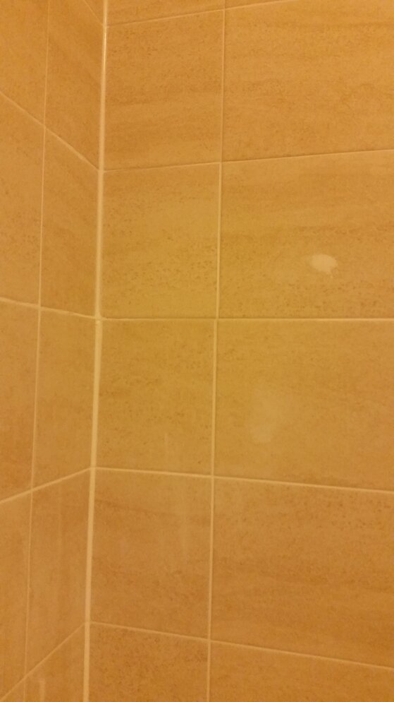

You can buy a small hand-held grout rake with removable blades....you need to scrape all the old grout out before it get re-grouted.
Other option is to borrow / hire / buy a FEIN multi-tool or similar, for which you can get a proper grout removing tool to remove it / it basically will work like a small angle-grinder (although it oscillates not completely spins) and it cuts out the old grout.
Not a pleasant job....
Next time its grouted, take their time, allow it to harden up a bit in the joint before wiping away with sponge and even longer before buffing residue off the face....

With regards to the tiling job, it isn't the worst I have seen but at the same time it isn't the best. Personally I think the grout has majorly let this one down. I prefer to wash the grout down and then give it a second wash as a lot of the time I feel polishing it with a cloth can wreck the grout joints.
Lastly before leaving a review I would offer the tiler the chance to fix. If he can't/ doesn't turn up to fix it. Then I believe you would be due a refund due to the poor workmanship.

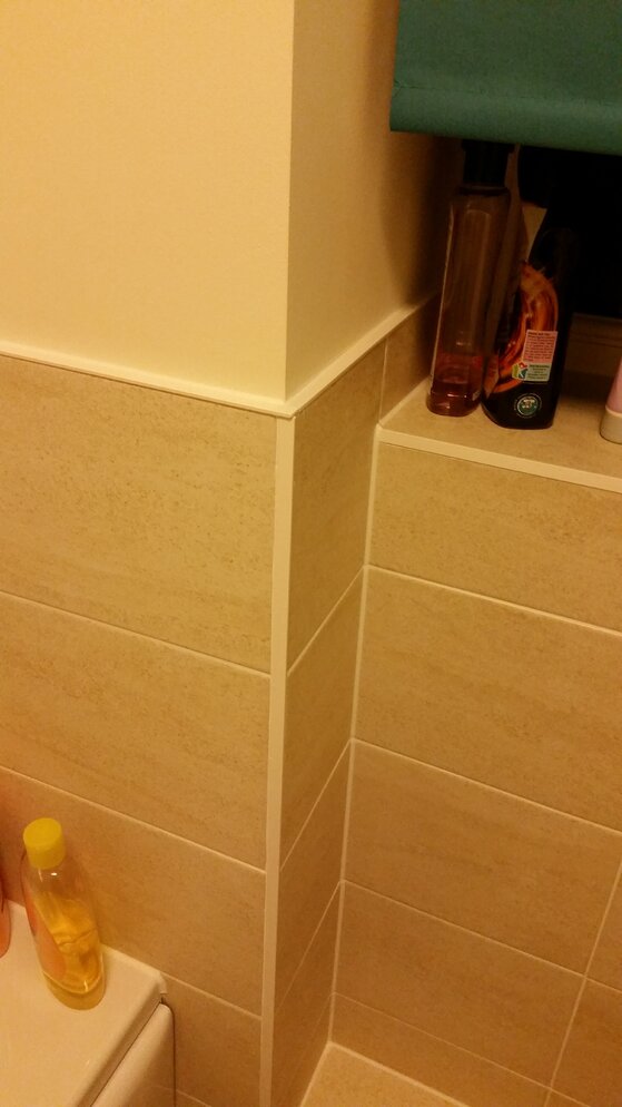

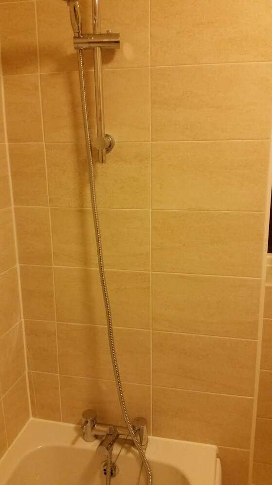

From the pictures you've posted it doesn't look great if it was my house they would be ripped off and done again
just my opinion for what its worth
it's not a terrible job, it looks rushed. maybe a little more time could have been taken..

I have checked with Porcelanosa, they confirmed to me that all the tile sizes are correct, email reply as bellow, can we say this is not the tile sizing issue now?
Hi Mr,
Many Thanks for sending the photos to me. Looking at the pictures, the tiles are all the correct size. This is a installation error. You can clearly see on the photos that the tiles have not been aligned properly as in some places the grout joint is smaller than in others, it appears the installer has not used the correct size tile spacers either. You can also see in the photos that the tiles have not been cut and finished correctly when meeting the ceiling as you can see where more filler has been needed.
I suggest you go back to your installer regarding this, as there is not a problem with the tiles, the problem lies with the installation.
