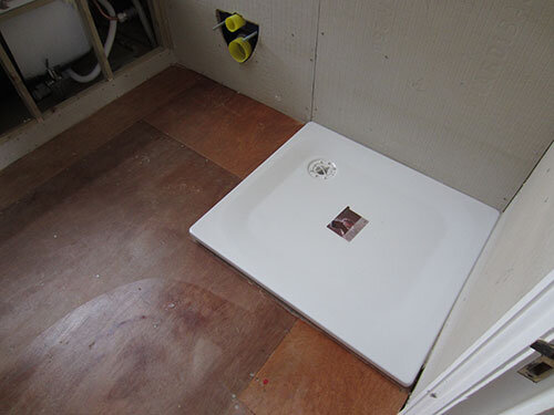

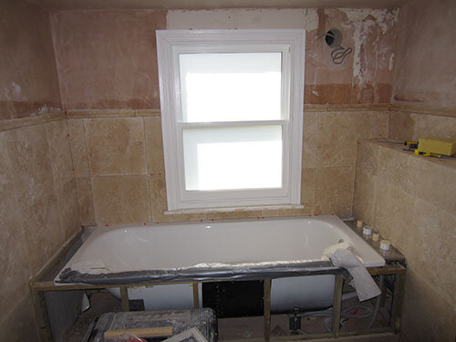

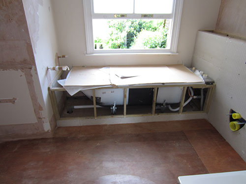

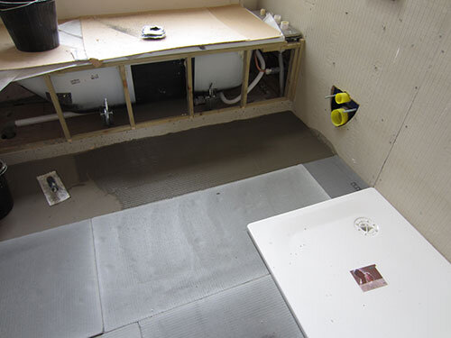

went into another bathroom today...........(its prepped and ready.....apparently!).........
this was a shell the last time I saw it!

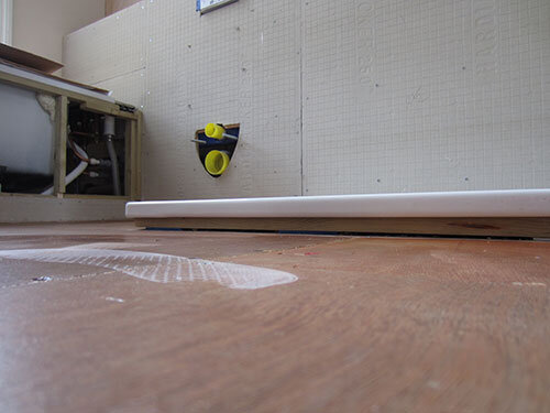

Looks reasonable dont it?.........hardibacker, new plaster work......a bit of paint here and ther but for a general builder....not bad........and then I noticed this:
and I immidiatly broke out the 8ft" level..........and guess what............the tray id as flat as a pancake....perfect!!!!!......but the floor is as flat as a camels back!!!!!!!!!!!!

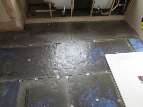

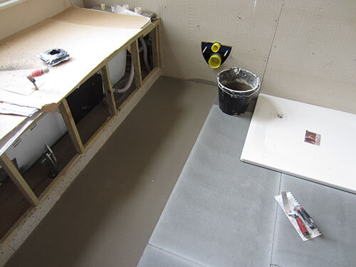

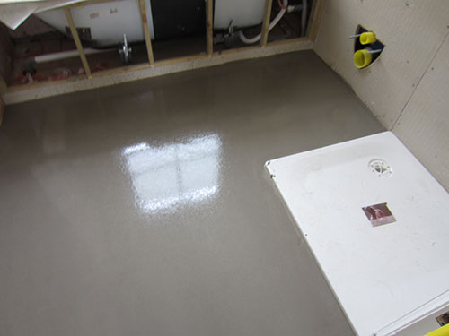

I went into melt down mode and assessed the situation......and decided to screed the floor first......(did not take any pictures...too busy f'n and jeff'n)......
but as you can see in the next shot the floor is latexed and I started to install the under floor heating system.........

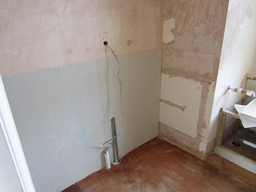

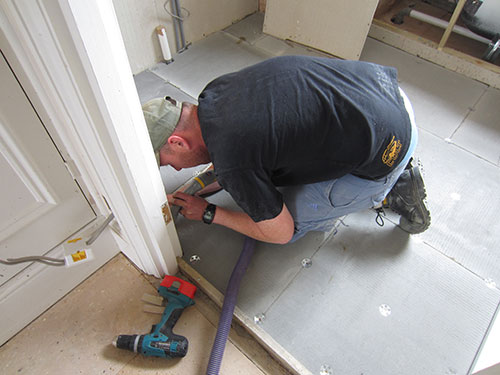

I got this installed and realised there is no "exit" point for the cold tail or the sensor for the heatmat, so grabbed the onsite electrician and asked him to help me out...........
we had a giggle about all electricians being really messy...leaving off cuts of pvc and timber shavings all over the place and walking away!!!!!..........he took the hint......and here is the proof:
so there you go......electricians can understand the sucky box with button...(vaccum cleaner)..........
after he had finished up I primed the floor ready to lay the heatmat (priming because warm up mats DONT stick to warm up boards!!!!!!

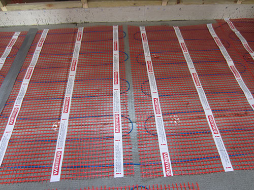

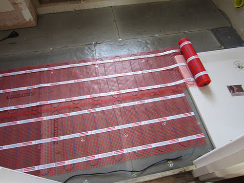

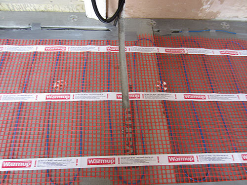

but today I am going to show you how we install an under floor heating system..........and here we go:
first of is.....make sure your mat will fit.......measure the area and DEDUCT 10% (as a rule of thumb!) from the whole area and round DOWNWARD.....
so if you have 4.6m2.....less 10%= 4.14 = (rounded down) 4.0m2 mat......
install the mat in neat runs and onto stage two.....

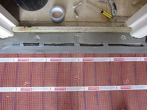

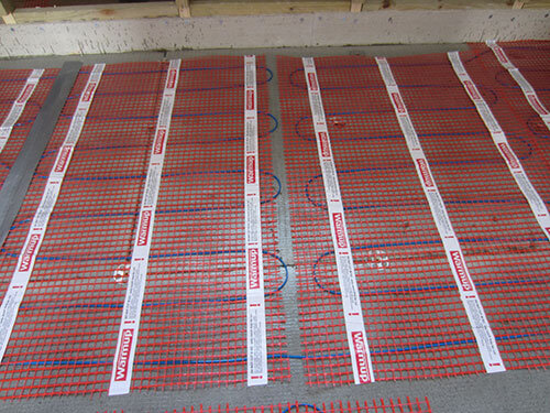

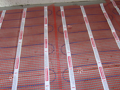

On some heatmats.......(these are warm up).......there will be some overlap of mesh.....(keep the heat wire at least 40mm apart from each other!)......like this...
on the heatmat I supply and fit thsi is never a problem on on warm up mats it is a constant issue....the answer is to take your time and trim it back!!!!
Like this: (and it will also give you the ability to apply gaffer tape across two runs and have them BOTH stuck to the floor!....warm up mat's dont stick very well IMO!)

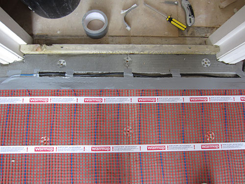

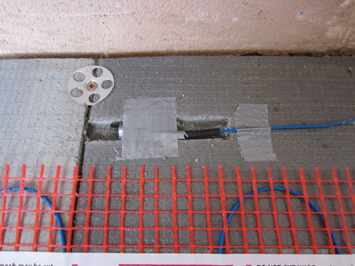

If you need to bury tour "Cold Tail"......its the same procedure as the "end"........

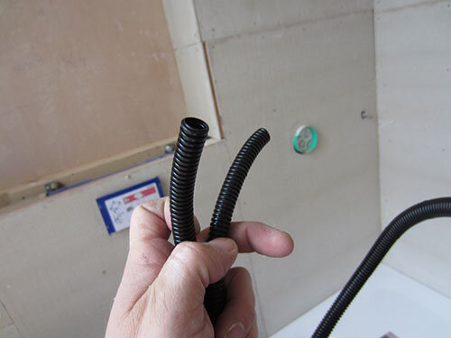

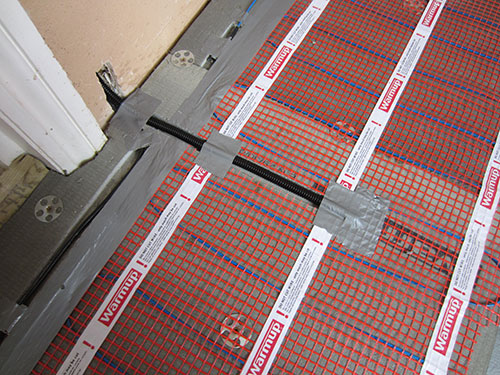

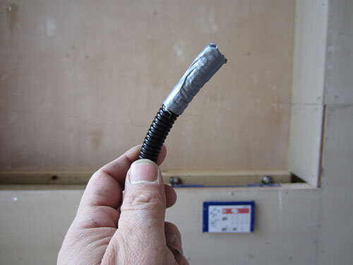

This little bit of tube most people often overlook......but it is the most important part of the installation......Because:
1. it is the most difficult to fit.
2. it is vital piece of futureproofing your underfloor heating install........
there are no guarentees without this tube!!!!!!!!!!!!
it needs to be cut to a length that will reach 50% into a heatwire run and up to your RCD....
in this case I needed to tape up the end......some manafacturer's proivide rubber bungs!.......

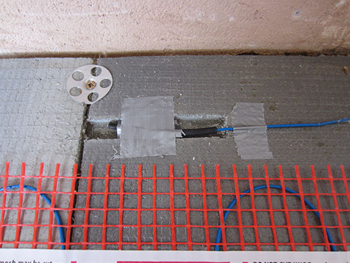

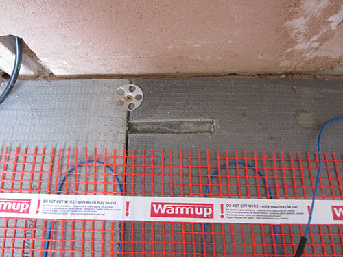

cut a channel in the floor and.......
stick it in.....
if your floor temp sensor ever fails you will be able to feed in a new one without having to damage the floor.................BONUS!
Finally coat with a cover of latex screed...this will encapsulate the heat wire and provide maximum heat spread from the wire.....as there will be no voids!!!
