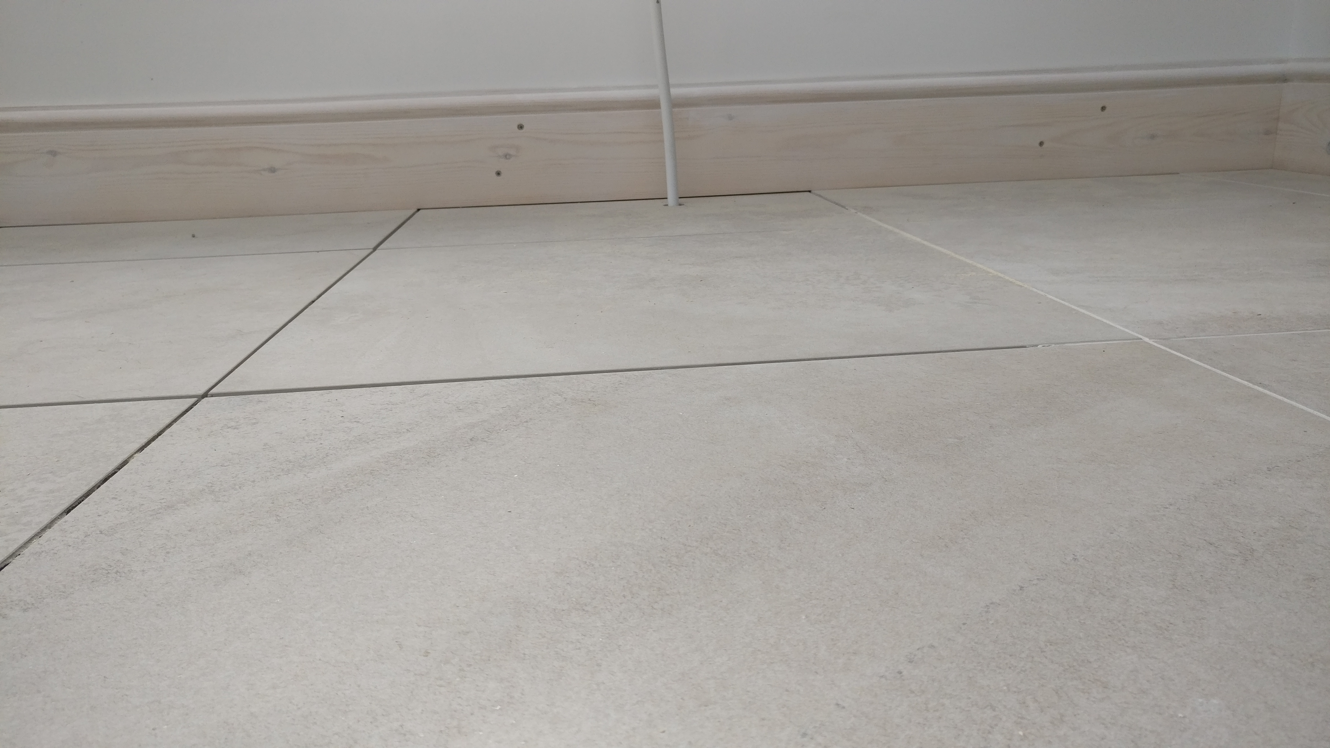

Has an expert done this job?
I dont consider myself an expert but i have done loads of tiling in 35yrs in the building trade and i would certainly do a better job than that.
Here's a nice view of how much adhesive has been used. You can also note just one example of the varying levels we have now against the skirting. Bear in mind this was a brand new floor that should have been level.
No excuses now, I would insist that it comes up, levelled correctly, and re-tiled. Far easier to do it correctly in the first place!!!
