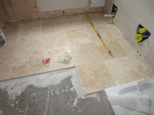

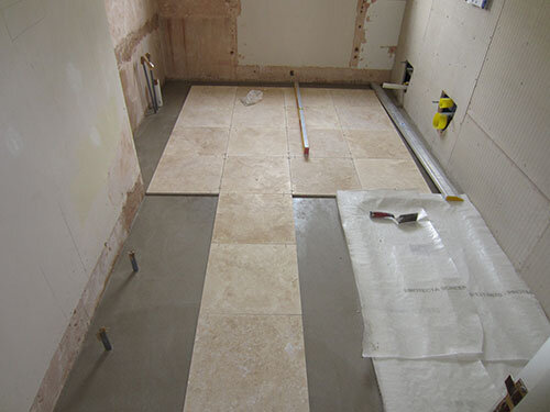

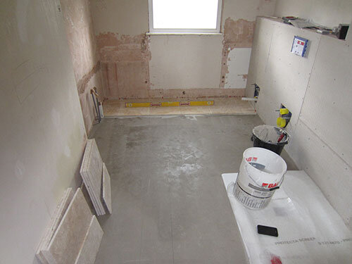

but my day started with a dry lay.........

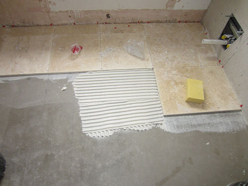

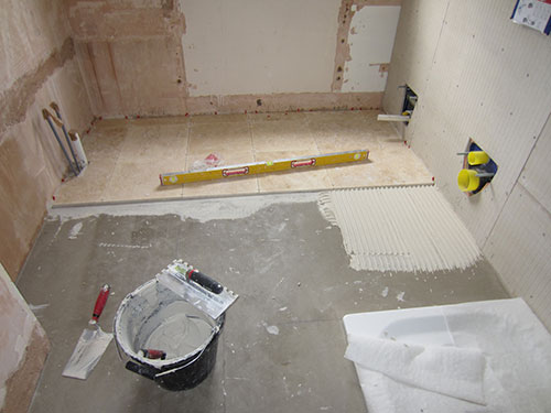

after working it all out I moved on to sticking!!!!!

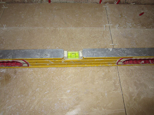

I have busted out with a 15 x 15 mm square notch trowel.........no real reason over my latex floor.....but I am not a fan of my 20 x 10 mm round notch......and I dont know why.......personal preference?

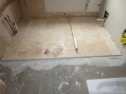

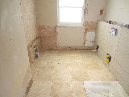

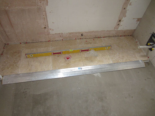

Managed to drop in the floor in this room and clean up the other two rooms ready for grout and seal.........
