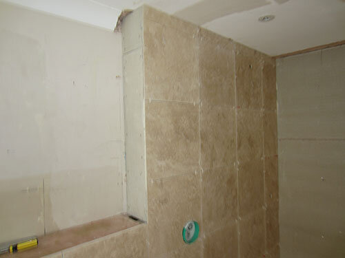

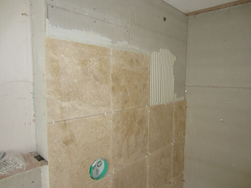

after adjusting all the boxing (in the picture below) yesterday......today I started to tile it....
I carried on using my 15x15mm square notch because the wall is not perfectly level....nor is it flat!!!!!!
and that dont help when the customers want mitred edges etc............Builders EH?
starting to look like a bathroom!!!!

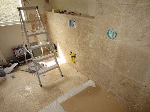

because the architects drawings wanted 3 whole tiles from the floor and then the baden/dado.....but that could not cover the boxings that had been build by the builder and it left horrible cuts all over the place.....
the main one being where the boxing is......so i split it so that there is half tile on the face of the boxing and half tile on the wall behind (making it a whole tile visually).....and then the baden/dado.....
like this one in another room:
hope that helps Tony
