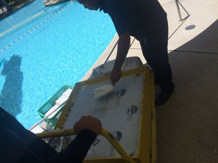

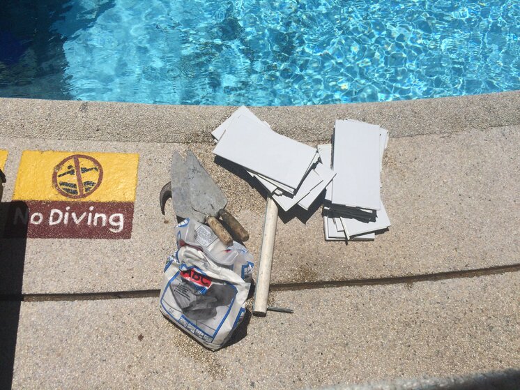

:cool:Just watching these fellas repairing the tiles in the pool... Interesting way they deal with it..Just used white cement mixed with white grout, knocked up with pool water..but it seems as small repair has turned into a major..Now they have released a few tiles .. more are coming up... know how that feels!!

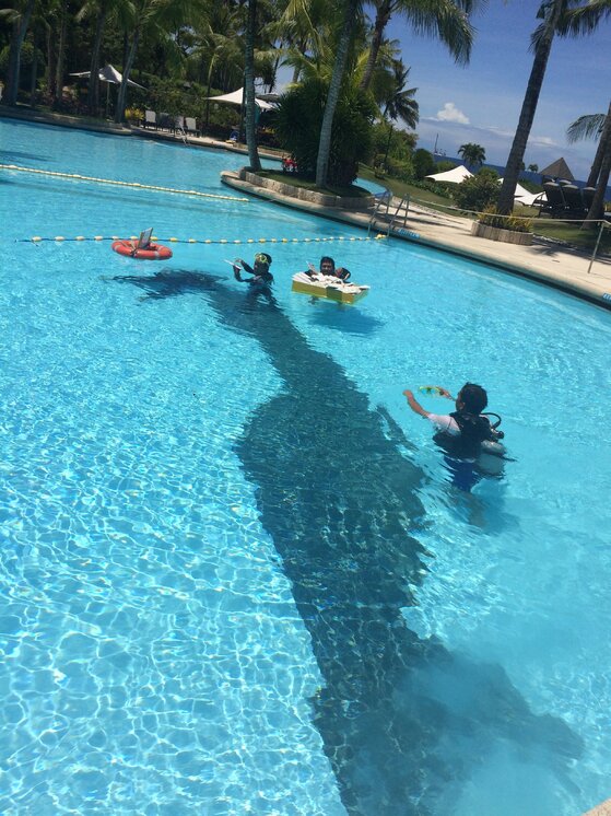

As you can see ... what they do is knock up neat cement/ grout... butter up Tile and then with scuba gear.. just take buttered Tile down ( not much of it seems to emulsify) )..and bang it in place... weight of water holds it in place... cement goes off under water.. job done....

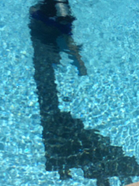

I as watching carefully .. The tiles ( 8x4) were coming up either in a few pieces or whole , they were picking the old residue grout and adhesive up with their hands... There was a bit of "clouding " as they were re-installing ... but I imagine the filtration system will eventually take care of that..I too thought it was a bizarre way of dealing with it... But it must be a tried and tested way and work...
