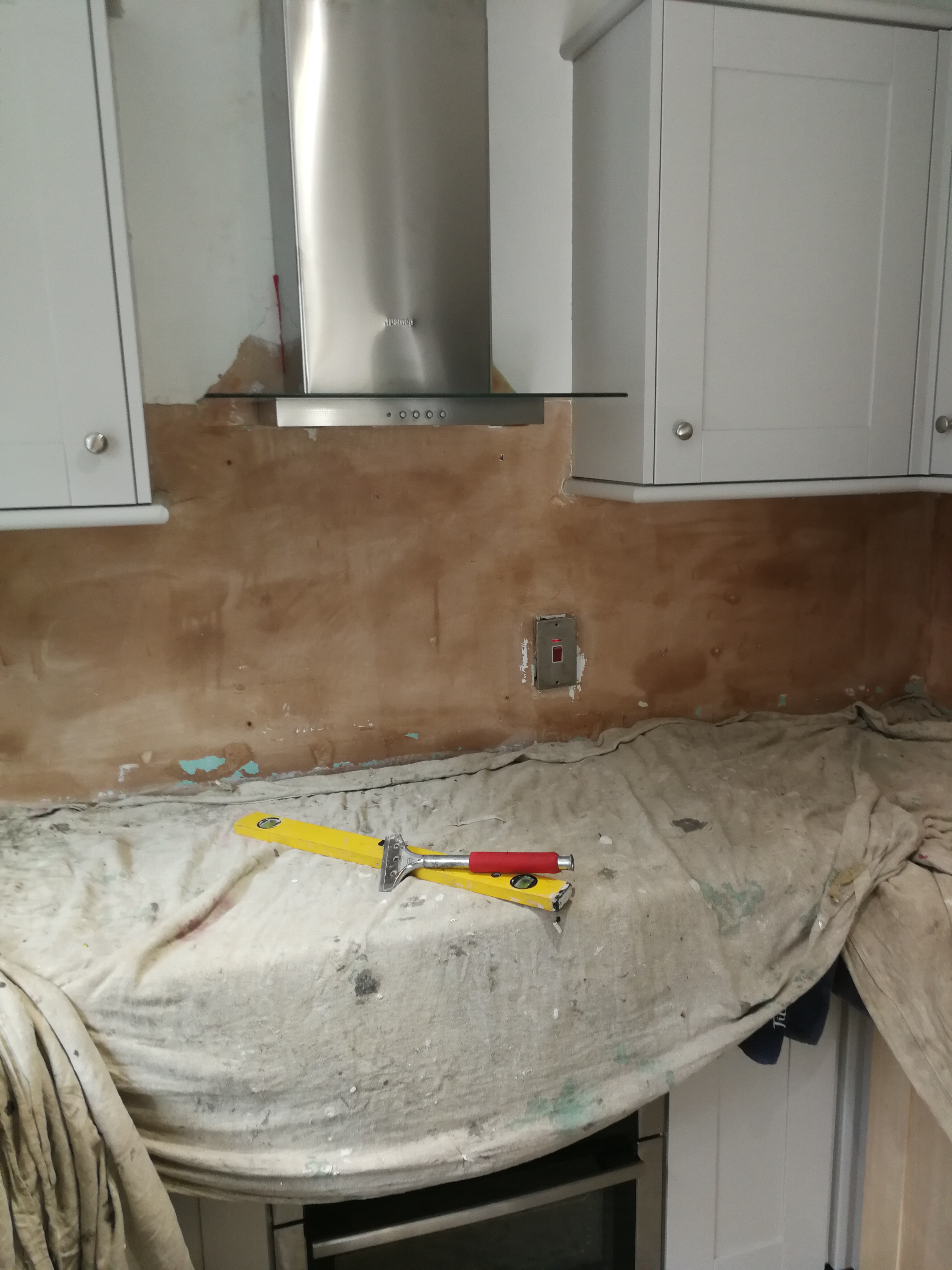

The one good thing about the guy doing it badly is that, despite being up for a week, Andy managed to get most of the tiles off just by flicking them with a screwdriver as the adhesive still hadn't really set and crumbled under a bit of finger pressure. The guy also hadn't prepped at all so the underlying paint was coming off in sheets like paper.

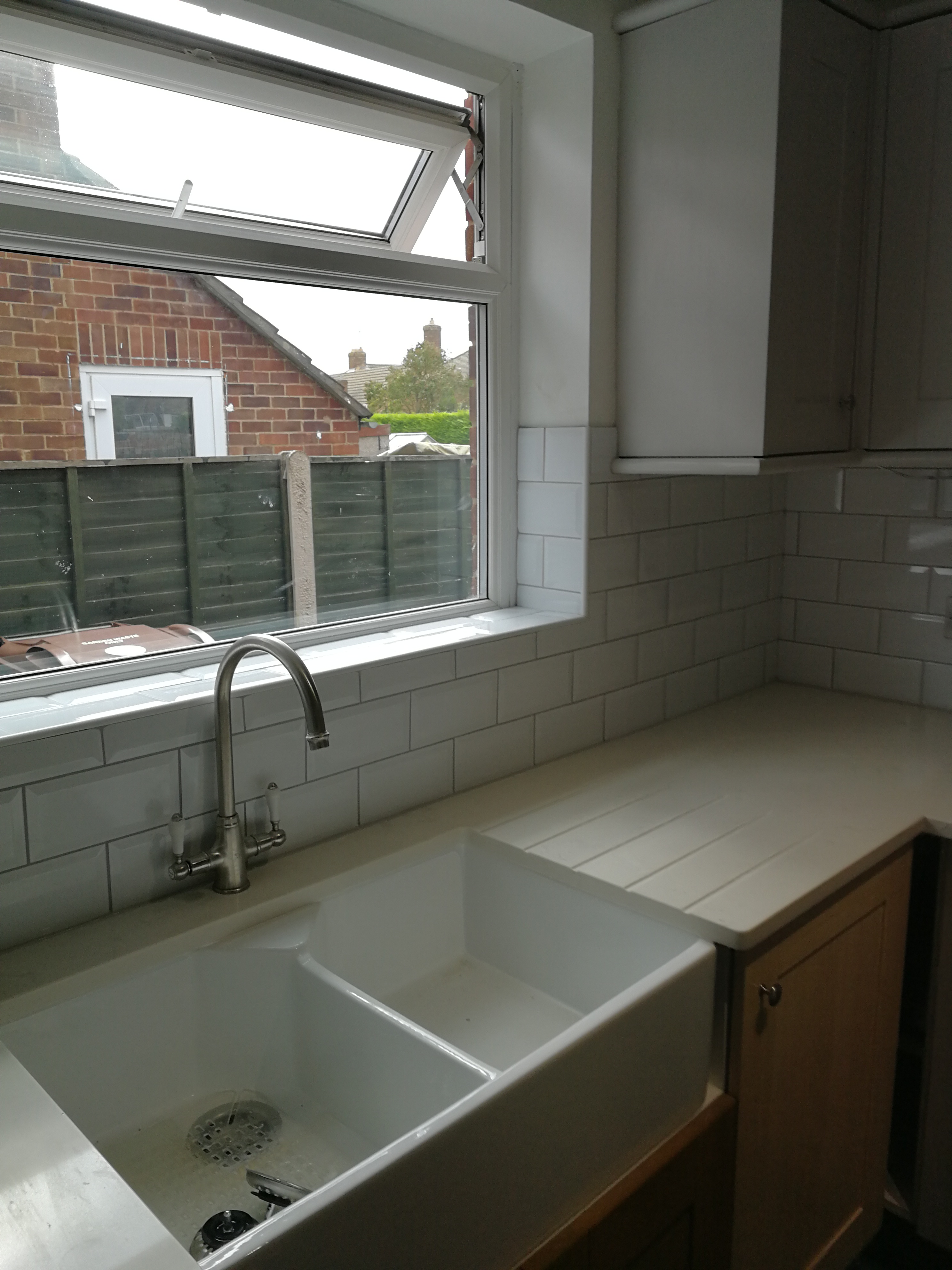

I took a few pics...
As you can see they didn't take much getting off as he tiled onto the paint .
Once fully stripped back and the walls primed, I was able to re-tile.
All in all a nice job done for a lovely couple that deserved better than to be ripped off by some cowboy...!

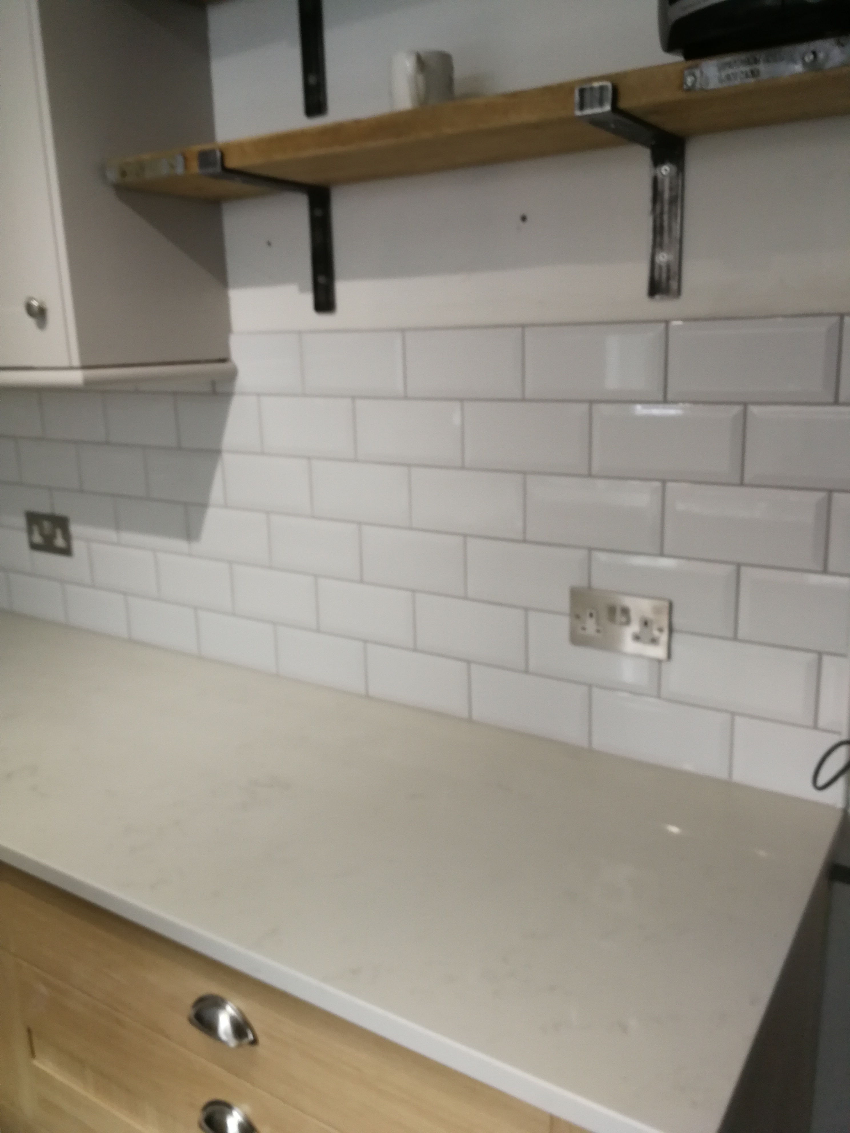

If you look at the photos ray you will see a full tile to the right wall, centralising at the cooker area would create a very small slither in the corner, I assume Andy had to make an executive decision
He phoned and gave me the choice as a courtesy, but clearly this is the better option rather than tiny tiles.
if you take a center line you have two ways to tile from it
1 full tile from the line
2 move the centre line a quarter of the distance of the tile lenght
so 200mm tile you move your centre line 50 mm this will give you equal cuts on ether side but on separate courses

Off setting the hob was a compromise to avoid slithers, which with grey grout looks awful..( check the original pics)..
But what do I know, I'm just a tiler...😉
if that was my walls i would prefer to have 2 small slithers than the centre piece of the work the focal point out of alignment you can always hide the slithers behind some pots etc you can never hide the focal point.
did you try measuring it 50mm to the left or right of centre another way you could of disguised it is by having the 2nd course as the 1st this would of taken the line of the hob away from the 1st course line.
