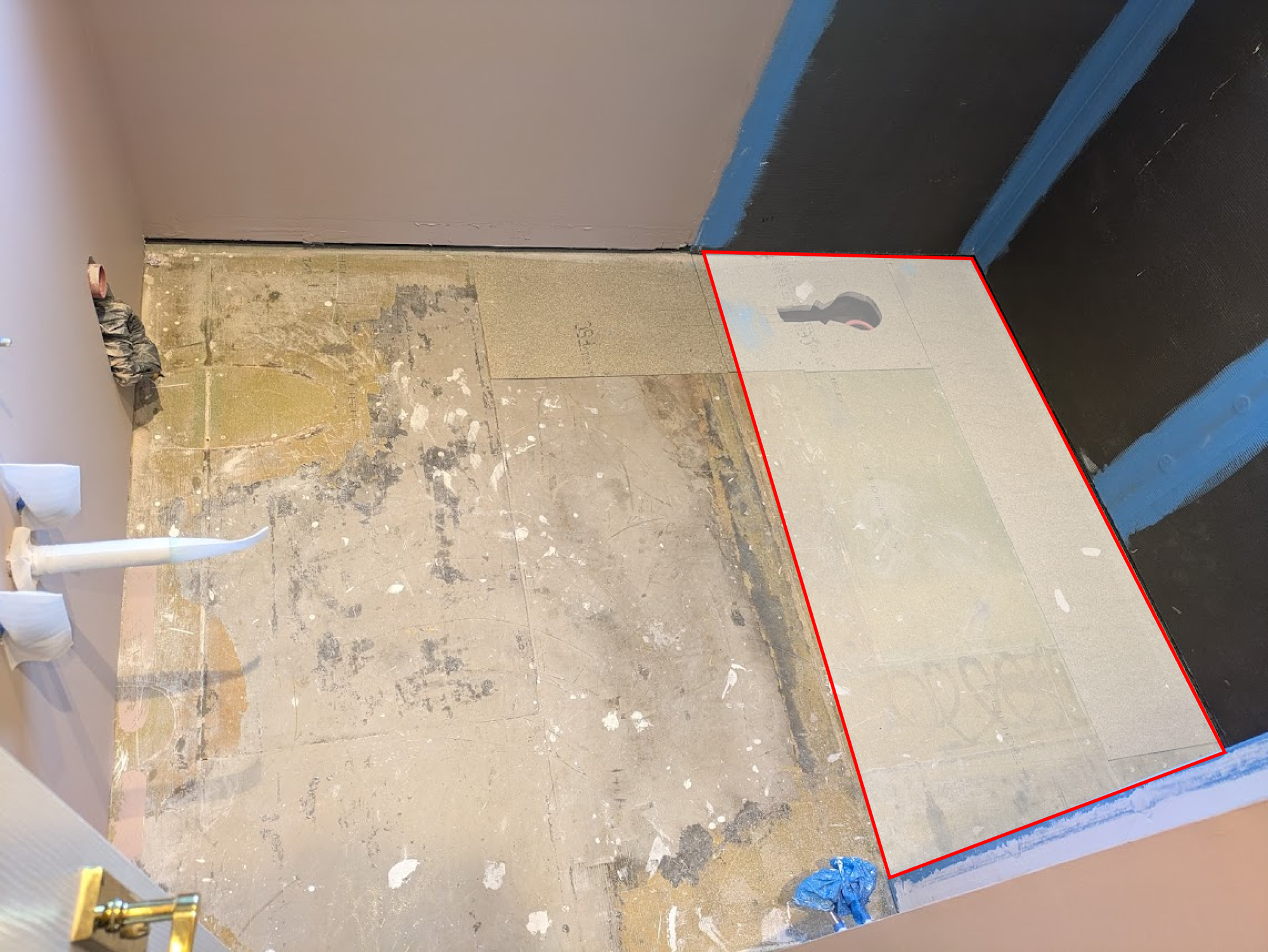

I'm an enthusiastic DIY'er (first time poster) who has been slowly chipping away at an en-suite bathroom renovation for a few months. Last night I went to install the shower tray (1600 x 900) and I realised that the floor by the drain end was about 10mm higher than the floor at the other end. This slope continues across the whole room. I've concluded that the best solution to this problem is to use some self levelling compound as not only will this level the shower tray but it should help get a better finish on the floor which is being tiled with 1200mm wood plank porcelain tiles.

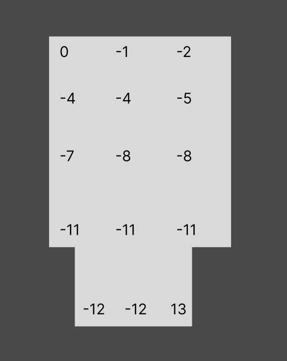

As you can see in the photo, the floor is 22mm chipboard which is glued down in the older parts and screwed where I have replaced some boards. I've measured about 20 places across the floor using a laser level and I think the worst dip is about 13mm by the door. It also looks like a previous owner has already used some kind of leveller in the central part of the floor.

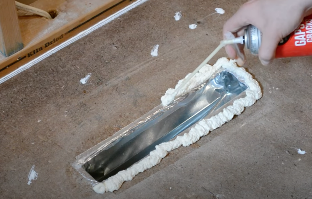

Just to clarify, I was only going to use the expanding foam to do a small border on the chipboard around the outside of the waste hole to stop all the leveller pouring down into the ceiling below. I was going to remove 95% of it once the leveller had dried. I wasn't planning on putting it anywhere near the trap/pipework.

The house is fairly young (2008) and the joists are I-Beams that continue beyond far where I can see under built in wardrobes and other bedrooms/bathrooms. I don't really know what the old screeding is about but it appears to be just a thin smear that you can see though in several places. I don't think there was a major dip or anything.
The floor is pretty flat its just not level. There is a gradual slope from the window to the door rather than any dramatic drops in one place. The joists are running left to right. The floor feels solid to walk on and I can't see any evidence of movement (although I'm not too sure what I'd be looking for).

I think for the sake of 10mm I'd tile the floor flat but not try to get it perfectly level. If it's 13mm over 3m that's not that much per meter and could be gotten around by tiling the high end first and bringing it up say half the amount using the adhesive (sticking with the thickness range of whatever brand you end up with) and you'd find the 7mm isn't a problem really as long as the rest of the tiling is spot on.

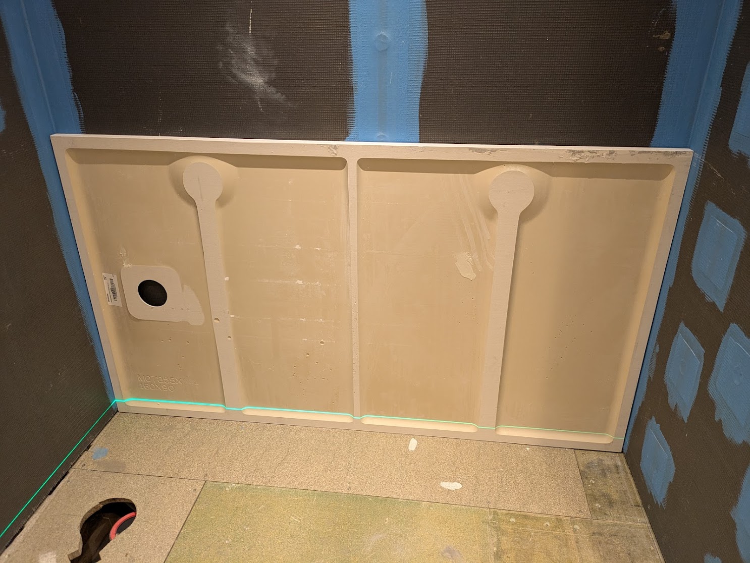

I didn't actually know the floor wasn't flat until I put a spirit level on the shower tray.
Purely in an aesthetic sense, a subtly out-of-level floor doesn't really bother me. If there wasn't a shower tray involved I would probably just leave it as it is. Unfortunately gravity insists that I do find a way to level the shower tray, and once thats flat, having it gradually emerge out of the tiled floor along its length might look a bit wild. I like the idea of lessening the effect with extra adhesive though. 👍
I'm assuming the tray is pretty unforgiving when it comes to being off level. Although I don't remember having any problems with the old shower tray which was siliconed down to the same bit of floor.
Perhaps there is a way to shim the shower tray. The instructions say to stick it down with silicon and large portions of it are not in contact with the floor already.

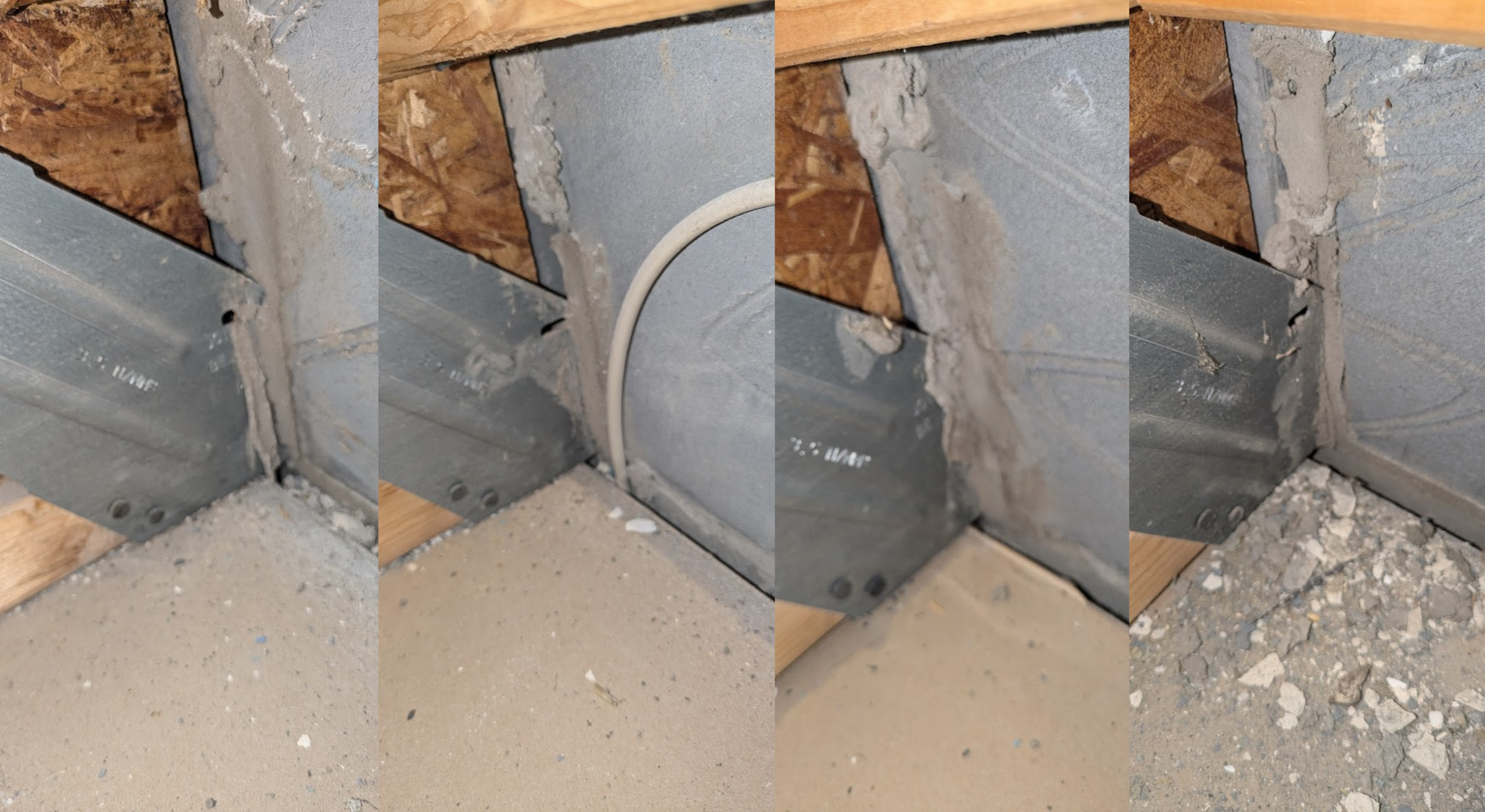

I lifted the board and had a look at where the first four joists join the wall. All have steel brackets sandwiched between two blocks and supported by the block on the row below. All the brackets are cemented in and I can't see anything that looks off/cracked/broken/wrong (not that I am an expert on construction by any means!).
I put a level on the joists and the third one seemed a little high. Perhaps it was built on a Friday afternoon. 🙂
It's been pointed up more at some point by the looks of the newer darker cement but doesn't look cracked so id guess somebody clocked a slope, checked, and just thought they'd at least lock it in again. If that was the case it's clearly been stuck the same for however long.
I'd even say there's more on the left and there is less new as it goes to the right there in the pics. So perhaps dropped flat at least (not one on it's own which may bounce). May have even had a bit of deflection (vertical movement) and they solidified it in the down position.
I'd be fine with that as long as it doesn't bounce at all.
