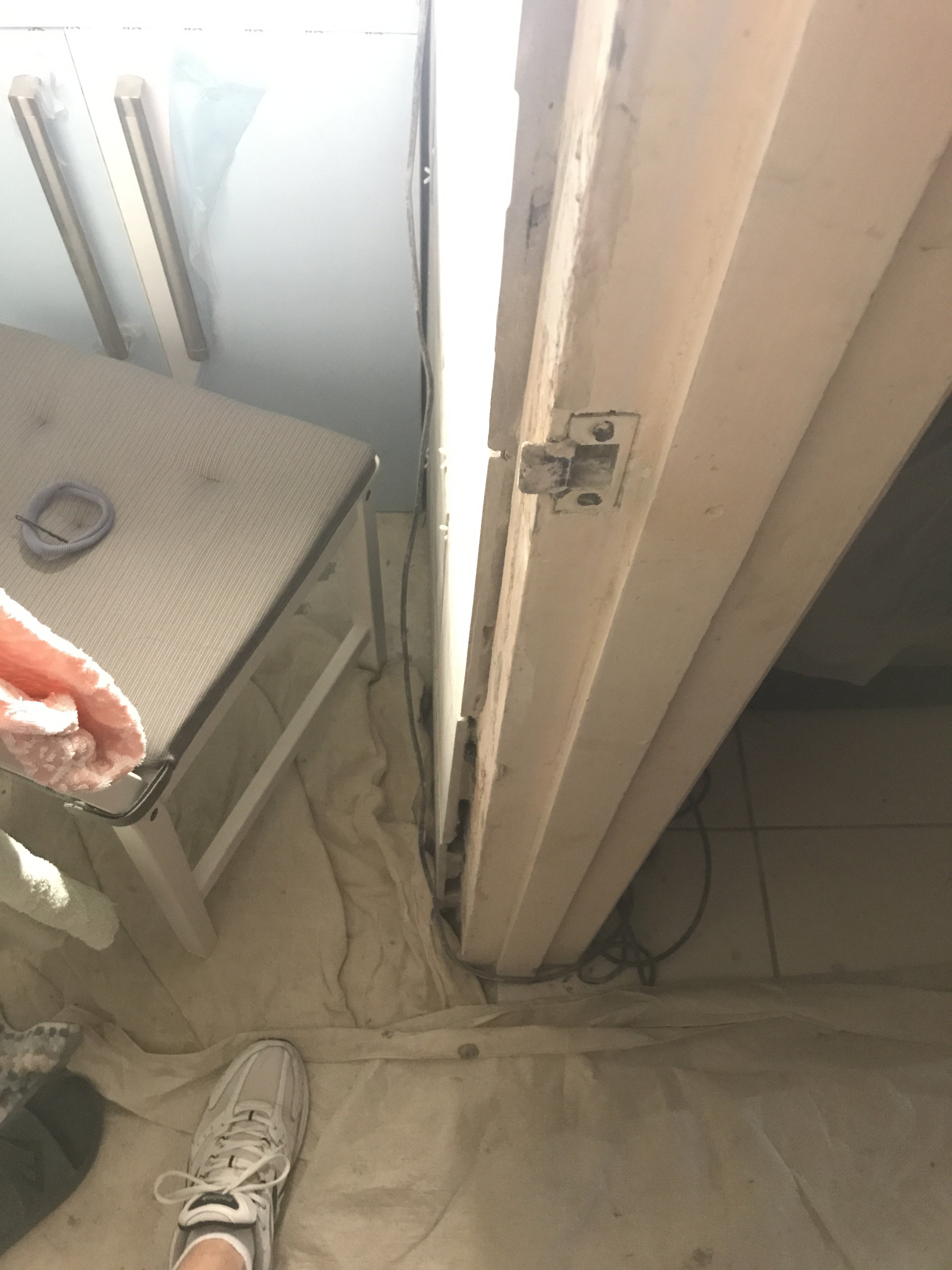

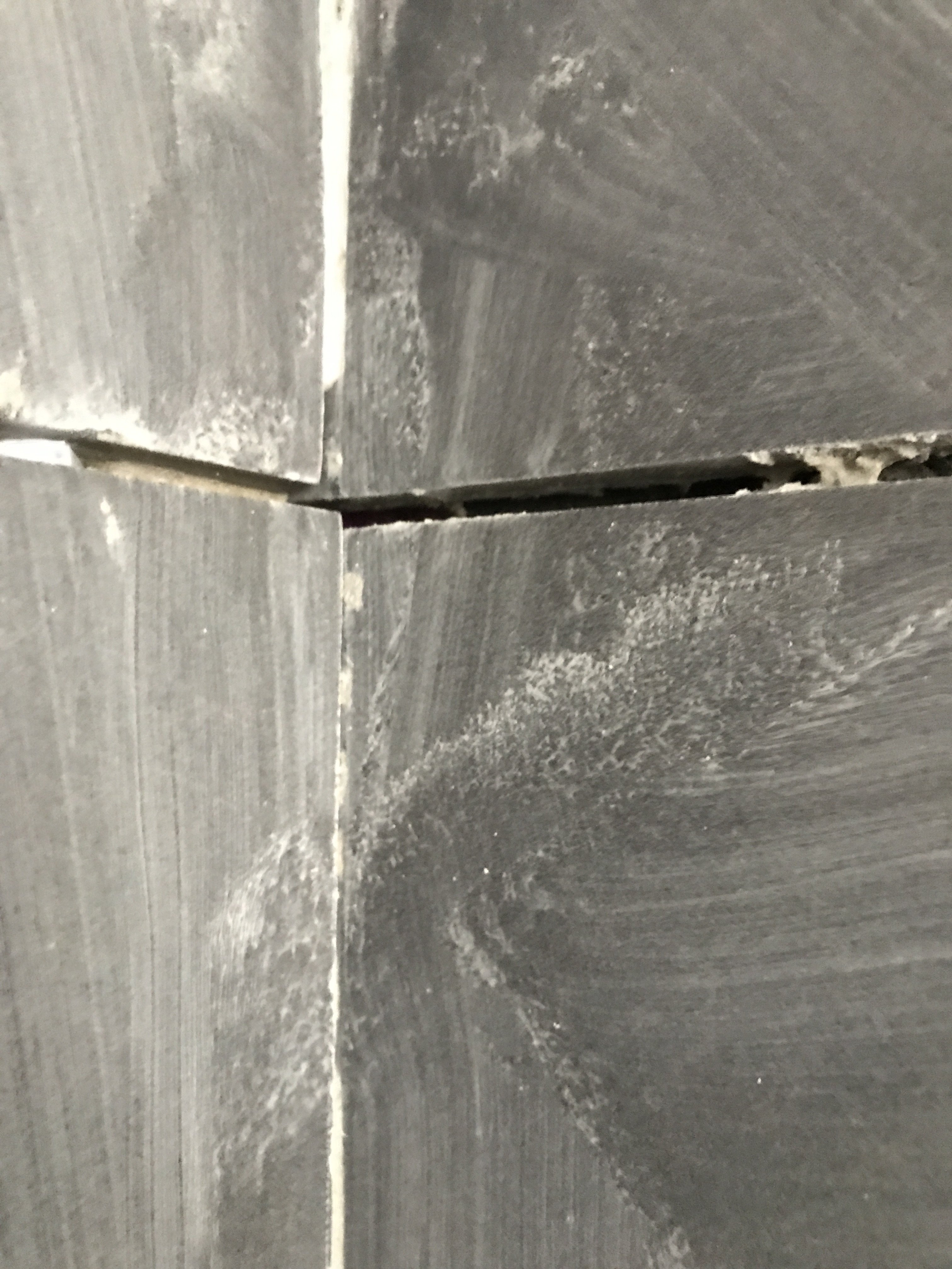

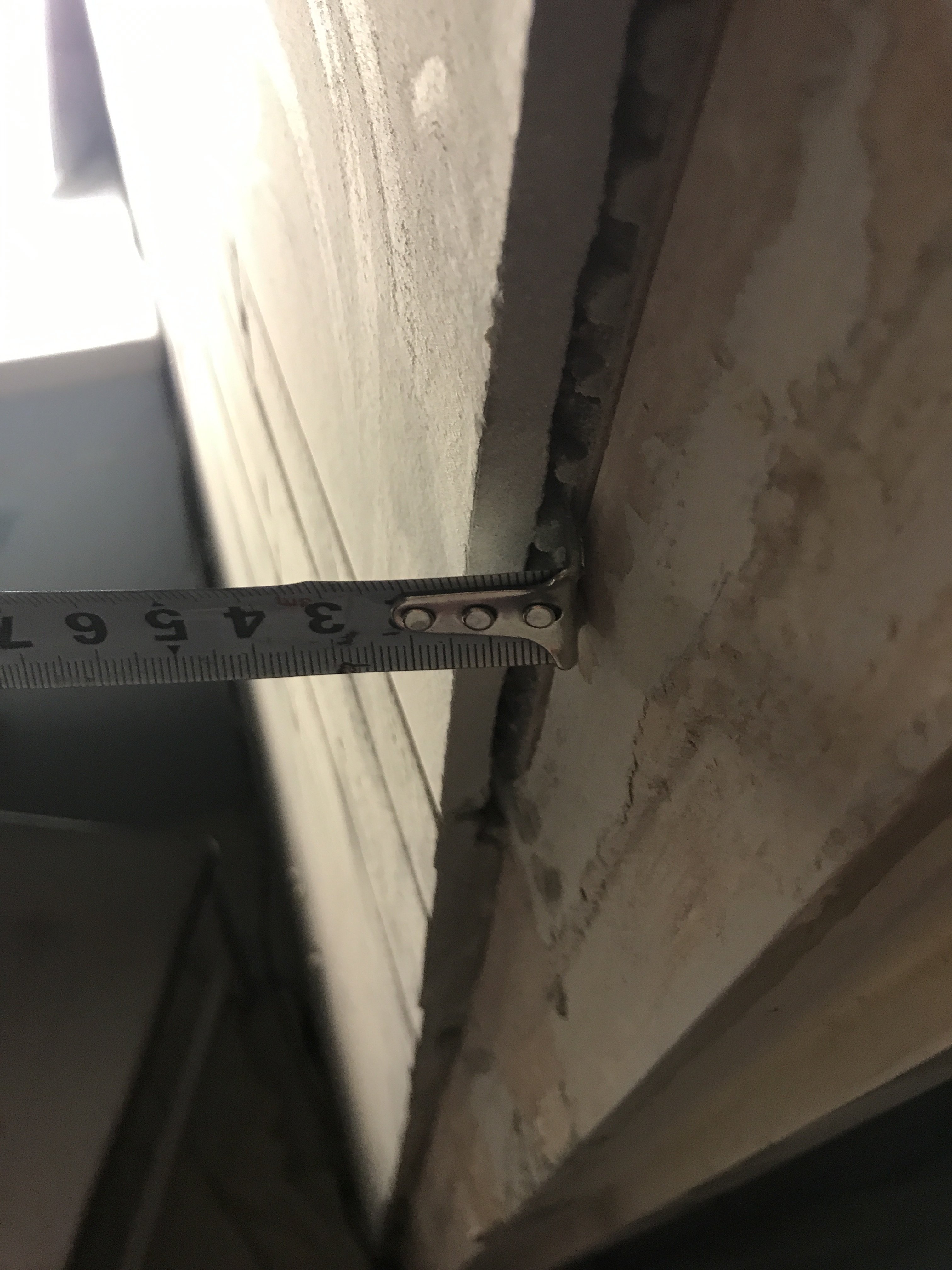

Hi all,
I've got someone doing my bathroom and yesterday they finished tiling. I've been going through the result and I'm not impressed with the quality.
Can you have a look and tell me if I'm too picky?
My issues:
- Some of the tiles are chipped (average sized finger for scale)
- In the far areas (far corner and top edge) they're not cut off straight.
- You can see one that's glued with a lot of adhesive and that changed the line on the wall.
- In a corner they don't match the height.
I've seen a lot of comments around how the grout will fix things. Would that apply to me? Would these issues be less visible through grouting? We are looking at a light grout (silver/ light grey).

Indeed there is George.
Lippage is measurable in relation to the joint width, but like all facts and figures they often escape us at that very moment in time when they are needed most. So I'm unable to quote exact requirements, however, I'm sure it's about 1mm in a 3mm joint width or close to those figures.
Flatness of finished areas should not exceed
+/- 3mm in 2Lm in any given direction. (That one I recall).

Here's the result. There's still some work to be done and he'll be back next week to rectify.
Couple of questions:
- Plenty of places where the adhesive wasn't cleaned properly and it's sticking out through the grout. How acceptable is this? Is there any tolerance for this that the trade allows?
- Two chips that I could see. Is there an acceptable number of chips per square meter that the industry allows?
- You can't clearly see it in pictures but some of the tiles are not level. This is why I was asking about lippage.
- You can see the shower line where tiles don't merge straight. With grout it looks better compared with the initial photos I posted.
What's reasonable for me to request without being a nitpicker?

Safe to say that myself and probably every other tiler on this forum wouldn't leave a grouted finish like that with remnants of adhesive left all over the place. I clean my grout joints as I go before the adhesive sets. Anything missed is removed before grout is applied. Not acceptable in my frame of reference.
The Silicon work is questionable and the fact that some of the crosshairs on the grout lines are several millimetres out is again not acceptable.
If you're handing over cash for a job you should only be doing so when you are 100% satisfied. Imo it's not nitpicking at all. You wouldn't pay full price for a car that had a big scratch down the side of it.
Id give him the opportunity to rectify everything that's needing fixed if he refuses then I wouldn't be paying full price. Have a tiler quote for remedial works and deduct from final bill. Furnish him with invoice from tiler and deducted payment. Fair terms in my book.
@georgechi - Tiling is a finishing trade and as such the tolerances are strict.
As previously advised and to answer your Thread title - Acceptable tiling? - NO!
A decent Clerk of Works would condem most of your highlighted concerns so don't worry about trying to find standards of acceptance.
If it's chipped, it should be out.
If it's not level, it should be out.
If adhesive shows through grout, it should be removed.
If there are holes in grout, they should be filled.
Etc.
There are too many Jacks who think they can tile, but we are only looking at the surface! What preparation was done? What tanking around shower? What adhesive? Did he tile straight onto the plaster and how long had it been dry?

View attachment 91620 View attachment 91621 View attachment 91622 View attachment 91623 View attachment 91624 View attachment 91625 View attachment 91626 View attachment 91627 View attachment 91628
uncalibrated slate tiles not the best to buy i personally wouldn,t have taken the job on
looks like your tiler should buy a level next must have put the cut edge as the leading edge.live and learn they say atb in getting it resolved
Wow mate that really is poor job,hope you get it all sorted and get the job rectified. But I guess it does pose the question would you get a tiler to build a house? I wouldn't be able to sleep at night if I left a job like that.
