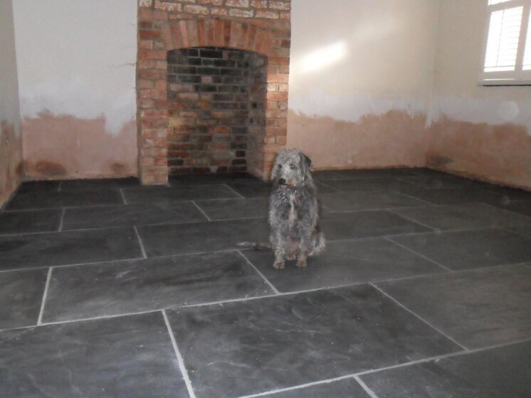

Just an update -- and thanks for all the replies! I did in the end get it done by a pro (specialist in natural stone!), and I'm glad I did. Two big blokes, and it was still a job for them to lift these bloody things (18 mm thick slabs!) into position. They wore out three cutting blades doing it...
Looks fantastic too.
Well done Fluffy. Not being funny, sensible choice in the end and you're obviously very pleased with the result. Just goes to show in the long run the professionals are worth the money.

Dog added for scale!
