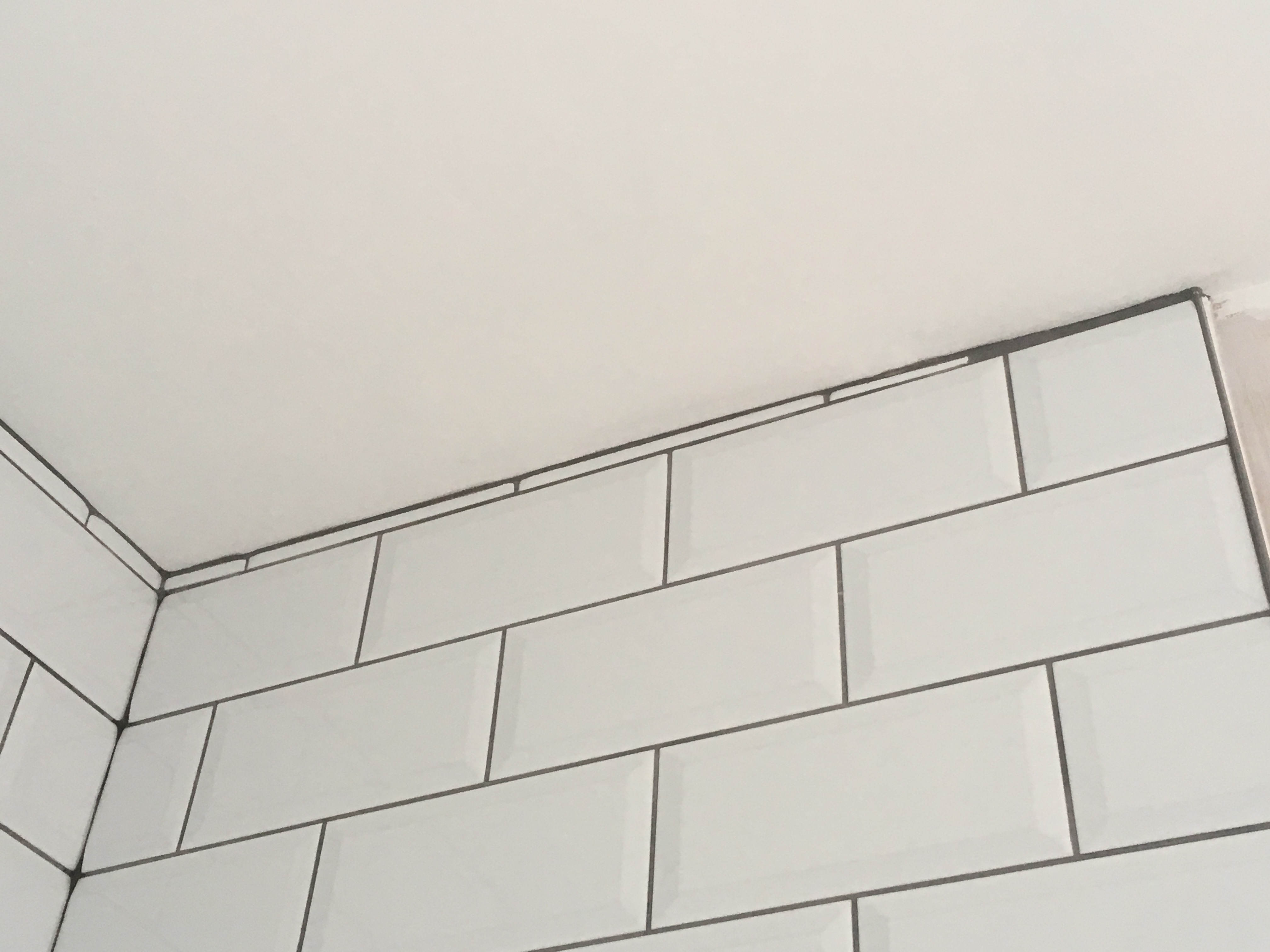

Hello I am currently in dispute with Wickes bathroom installation as they have fitted my wall tiles and I have cut slivers as the last course where the wall meets the ceiling. They blamed it on an uneven ceiling however I have argued that regardless of the uneven ceiling the last course cuts should have been larger and would have been if the area had been set out and measured correctly. Suggesting that if the first course (at the bath) was cut the last course cut would have been larger and better in appearance. They said that British standards state the the first course at the bath must be a full tile. I cannot find this BS and the only one I can find is one that states cuts should be kept to a minimum and be as large as possible. Who is right here and do you agree this is a poor quality install?

It's not great to be honest, but it's serviceable and fit for purpose.
Whilst it could look better, legally there's probably not a great deal you can do about it. As all the law will look at is if the install has been done and is fit for purpose.
It's unfortunate that a contrasting grout has been chosen as this highlights the problem further.
If it bothers you that much I'd be inclined to fit a small cove or similar to the ceiling to disguise the problem.
Thanks for your honesty, is it law to start with a full tile as they have stated?
British standards aren't regulations but guidelines. It is in those guidelines to waterproof wet areas though and I'd wager they haven't. Throw that back at them. The threat of posting all over social media usually works with big firms too. Good luck

Unfortunately setting out issue...Not really much can be done other than add a small cove detail
Or remove top course and slither/ introduce a listello border then larger cut... or .... rip out and start again
The darker grout does emphasise it
Have definitely seen worse

Said I have tiled an awful lot of bathrooms where I haven't tiled a whole tile of the bath , and yes do not get confused as to what british standards are they are a code of good practice and not even building regs .
And yes they should of siliconed the corner where the tiles meet also have they siliconed next to the bath
They have white siliconed the tile/ bath join however it seems to be peeling away a little. There is translucent Silicon in the corners however one side seems to be yellowing?
It's no good siliconing over grout in the corners, this joint is meant to be free of grout and adhesive, this is a movement joint , British standards therefore they should know this (hint of sarcasm ) . I would of done that in a colour match Silicon but that would be more expensive that generic cheapo Silicon .
Cheers this for the info this is a great help!
Depending on how the room sets out determins whether you have full tiles on the bath or not. You usually dont because baths are rarely set level lol. Nobody bothered setting out that room and theyve been found out. Theyre talking bollards
Yes they have! Just need to get them (wickes) to listen now 🙂
Am I the only one who thinks the ceiling should be level? Why spend all that money and have a poor finish?
I did have the ceiling walls skimmed and wasn’t aware that it wasn’t level until that was another excuse given by the installer. I did ask why he didn’t tell me at time of skimming he said he didn’t know. If I had known I would have rectified that. Ignorance on my part.
