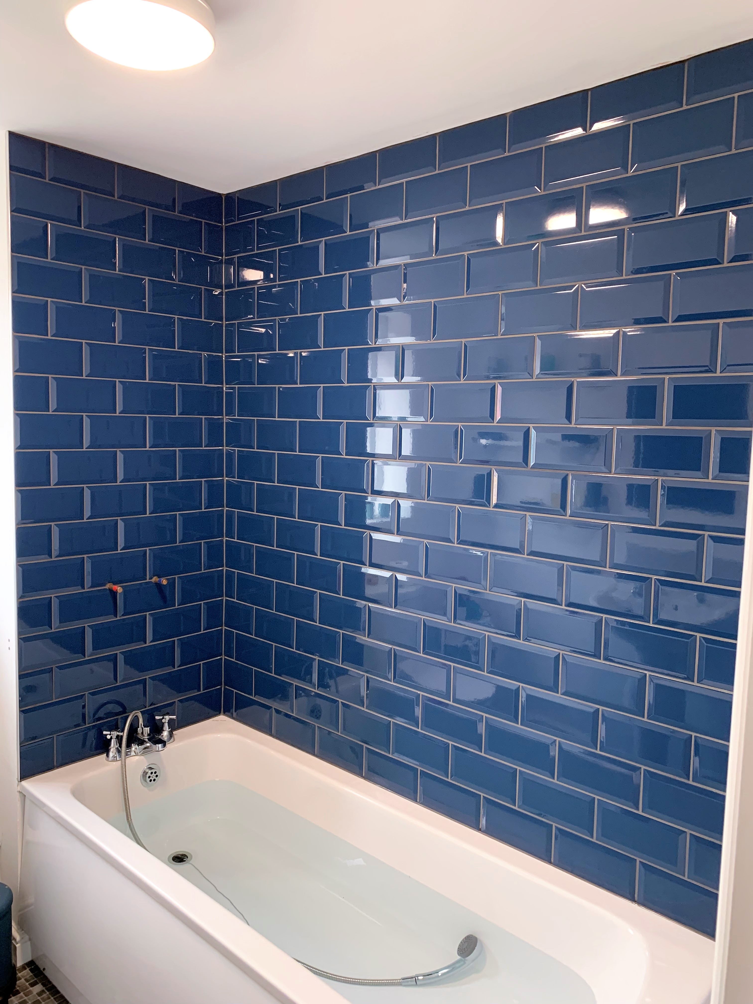

Metros look smart, but they are usually cheap , bent and sizey , I’ve just done 60m2 of them, bit bigger, 30x10cm, Johnson’s very own wicks shi it , bent , curled in at corners and sizey , they can run off a mountain side for all I care 🙂
What grout did you use ??....🙂
Setting out is all to ****. Most good tilers would plan it so no small slithers are evident. Occasionally this cannot be avoided if you have large areas with lots of undulating levels to take into account. However, i haven't had a job in the last 2 decades where i had small slithers like this. Personally i would have gone 30% cuts on the bath and this would have resulted in an acceptable, but not perfect solution. I get many baths that are not straight anyway, and have to cut the row above bath to suit.
BTW, i used to tile for fitters from wickes and always the standard is awful. Also no decent tiler would work for the rates that wickes allow for. When i was doing kitchens, they allowed £25-£30 per metre on 4 metre splashes!
How can we as tilers do a quality job on those rates? Unless of course i am ridiculously slow.....

Glad you got a good result.
I did this one the other day. Set out with 2mm spacers (my 1st choice for metros) but would have ended up with raking slithers disappearing to nothing at the ceiling - exactly like what you've been left with.
Lost 16mm at the top by swapping to a 3mm spacer.
It's not rocket science. Nice to see a customer taking no crap!

I think you're being over critical, you chose the worst grout possible for those tiles, and it's shown up in the ceiling. I've seen worse.
Are there other walls done, around a window maybe, to see what cut would have bee left on the head/sill?
That sliver (I wouldn't even call it that, I've done smaller cuts) wouldn't have looked so bad if the ceiling was level.
Simple solution, take light fitting down, over board, skim, paint, refit light. Kill 2 birds with one stone, small cut disappears and you won't notice the cocked up ceiling.

i dont think its a must to start with full tile if you have done your calculation as an installer they should have raised the first tile to a certain height so that they will cut small out of the last tile on top the cutting one will not be visible then the off cut will finally transfer to the base to avoid this kind of situation.
[automerge]1571143463[/automerge]
if your wall is not plum you can centralize your work by mark out the center of your wall make it your start point so that you can transfer your off cut to the corner of the wall,
if you wall is not flat why not ask the client to pay for re-plastering or re- rendering of the wall.
They just went full tile ,could of set out differently,ive dropped a few ceilings when they were so far out
Any good tiler would check the bath for level before even fixing a full tile off it in the first place! Make a gauge rod with tiles and joint (cant go wrong) mark a datum then using gauge rod to see if acceptable cut to ceiling at all points if not centre the wall vertically or centre centre tile to give best cuts. obviously too late now as tiler has tiled the room. Best easiest option is to maybe add another skin or 2 of plaster board to ceiling to eliminate the small cuts, or coving as someone suggested although not a conventional finish in a bathroom.

Just an update to say we won our case in full against this builder and the judge found the tiling to be below standard and awarded us all our money back.
600 rectified tiles? Most definitely needs a tile leveling system for a superior finish. The reason he used 7mm grout lines was an attempt to limit lipage. 2mm grout lines (max3) with zero lipage should have been the goal
