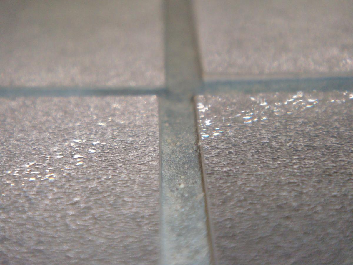

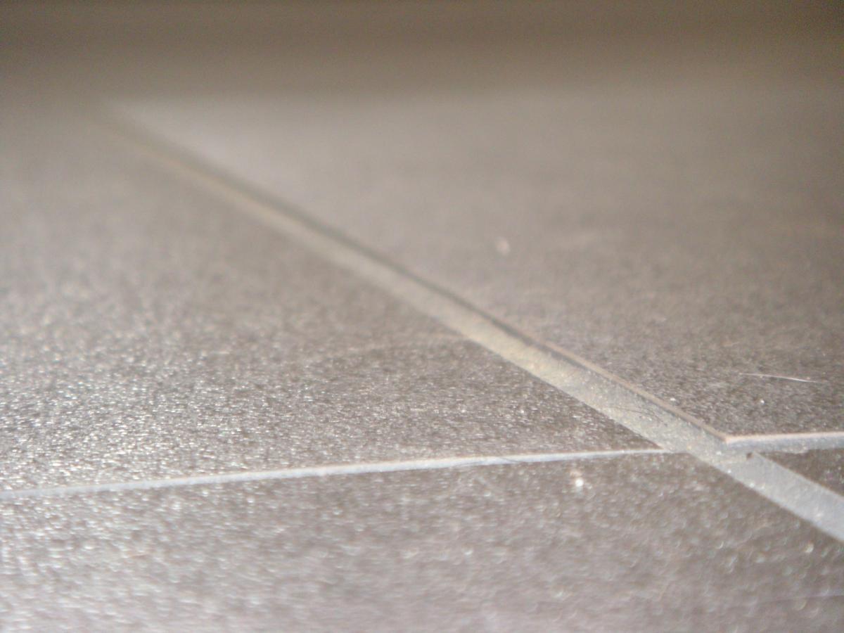

Here are a couple more pictures of different areas. Would like opinions on depth of grout too, this problem wasn't immediately that obvious, bearing in mind that this is a new house build and therefore a bit of a building site still when the floor was laid. The problem soon became apparent when the floor was washed for the first time and we realised the mop didn't reach the grout, and putting more water on meant it collected and sat in the grout line Lippage 3.jpg
I should add that this floor is 67m2 and we have paid REMOVED for the tiler, including adhesives and grouts, so this was not done on the cheap.
You do take good close up photos :thumbsup:, but I would like to see an overall photo of the floor . Grout will always have a slight dip, but I do feel that this is excessive. As stated before I would be concerned about the joints not lining up...were there any tile size issues ?
Also in one of the photos it looks as if the tile on the left is higher than the tile on the right.
Yes the tile on the left is much higher, and this was a new floor so there are no issues with levels. If there was an issue with tile sizes it has never been mentioned at any time, and since the tiler has given multiple reasons for the condition of the floor I think this would have been first on the list. I realise now that I need to get some overall shots of the floor, I thought I had some but the three or four I thought I had turned out to have a dirty great doberman hogging the camera! (not so hot on the long shots then?)
personally tiles with rectified edges need a 2-3mm maximum joint. The flatness of the substrate is essential when using rectified edges on floor and walls to achieve that look of being one.
You say you have a doberman Jackie........not that I'm insinuating he should be kept on a lead or anything...
dosnt look to good from the close up pics, shame you already paid the person, i wonder if the floor is miles off square aswell that wouldnt help the size of the joints either, im amazad at how many bad jobs there is out there in the world of tiling
