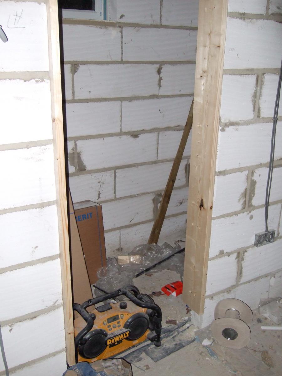

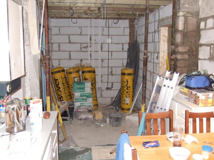

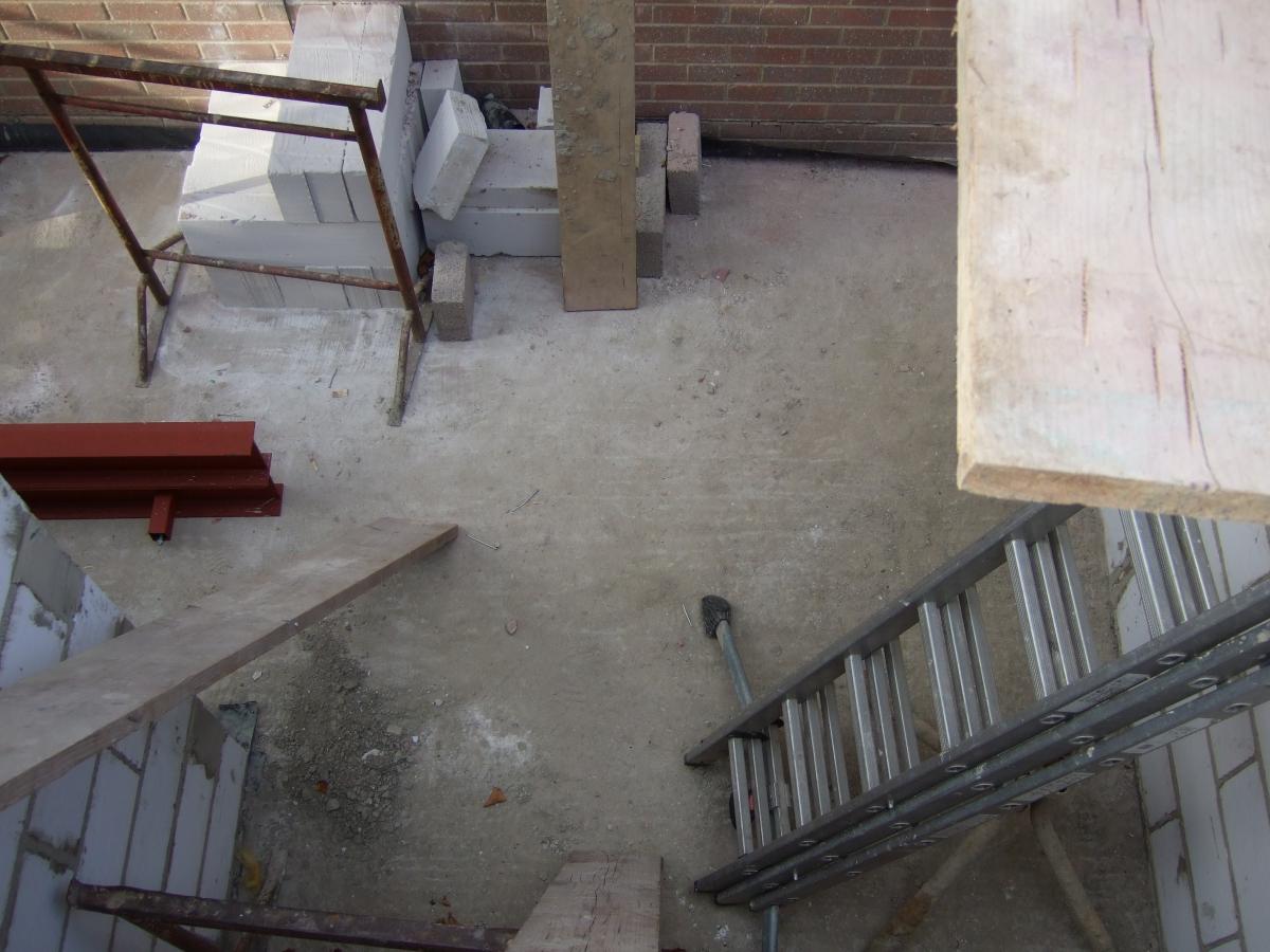

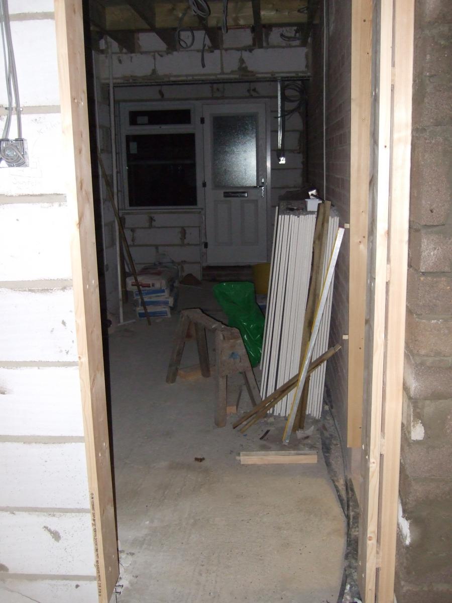

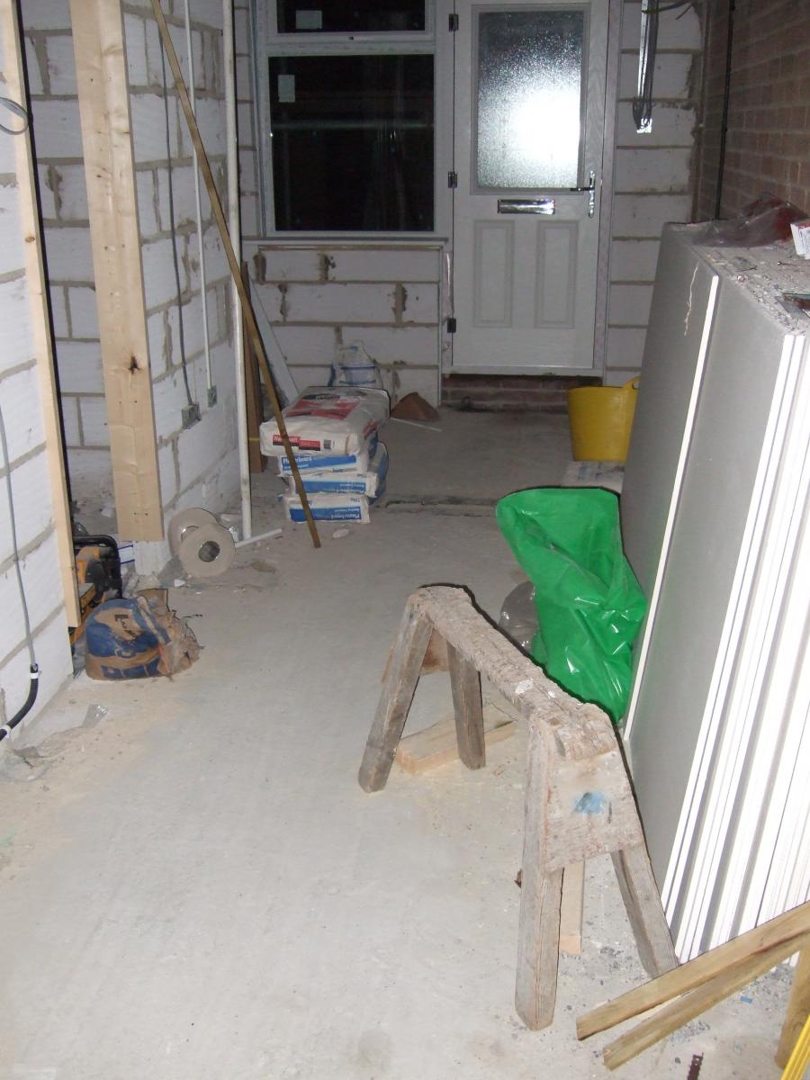

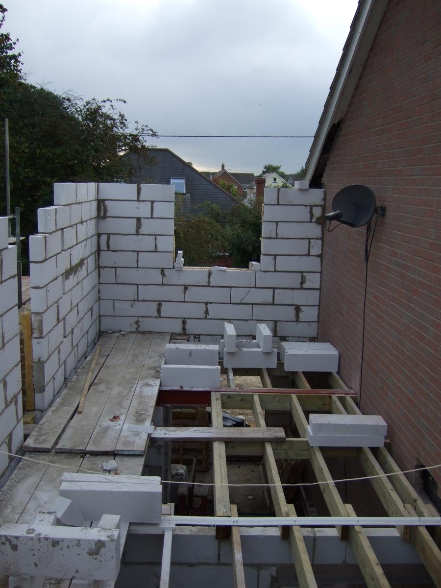

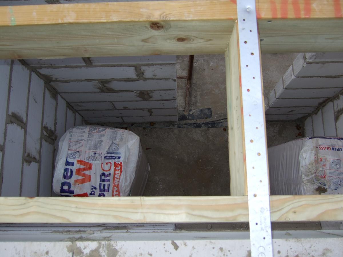

OK. Here's a few pictures to to illustrate the job. The work is more advanced than the pictures might suggest but, unfortunately, I don't have any later photos which are relevant to this thread.
The first picture shows the downstairs cloakroom. It's 2m x 0.8m and around 2.4m high. Clearly, the photo is taken from above. The second picture shows a part of the hallway which will also be tiled on the floor. The final picture shows the upstairs bathroom. It's at the far end of building and starts directly after the red RSJ. It's about 2m x 3m and 2.4m high and is located above the downstairs cloak so that it can share the same stench pipe.

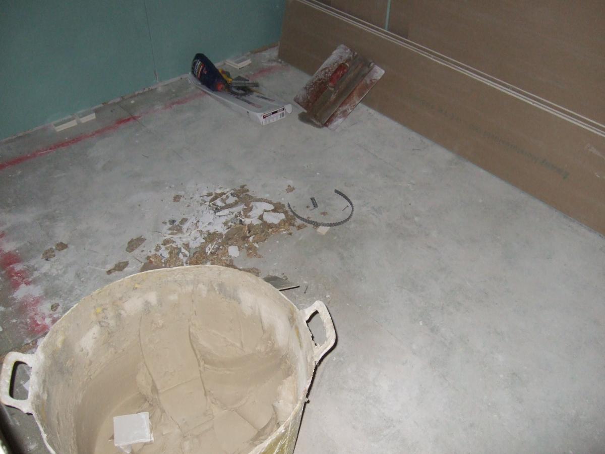

OK. Some more up to date photos taken this evening
DSCF7567.jpg Looking from the kitchen into the dining room. This whole area will be tiled. Hopefully, you can see the door liner on the right. This leads to the hall.
DSCF7571.jpg Looking through from the dining room into the hall. To the left is where the stairs are going in. This whole area will be tiled.
DSCF7573.jpg The stairs will go here. They're being fitted tomorrow.
DSCF7572.jpg Here's another picture of the hall. You'll notice a door liner on the left. This leads into the downstairs cloakroom.
DSCF7575.jpgHere's the downstairs cloakroom. The floor and walls will be tiled.

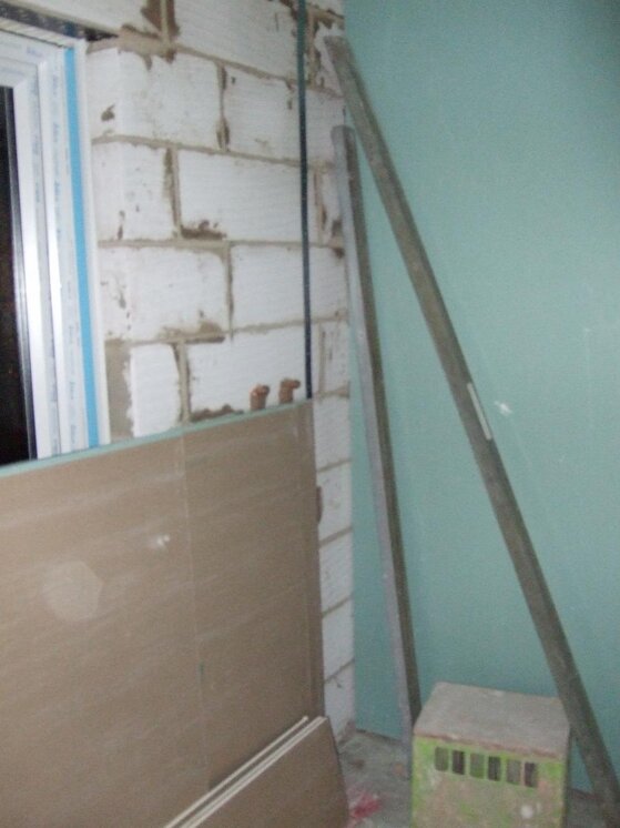

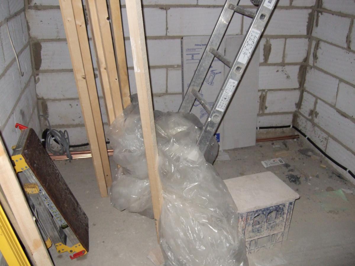

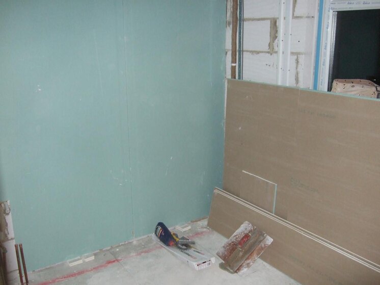

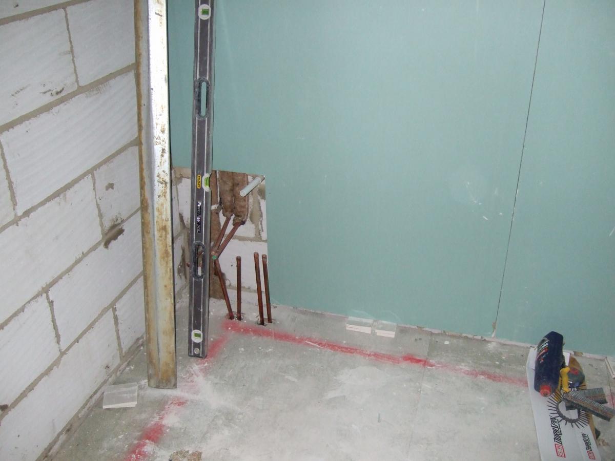

The next few photos show the upstairs bathroom with the green board on some of the walls and the moisture proof chip board on the floor. The NMP has yet to go down on the floor.
I've surveyed the walls with a straight end and it seems they are each flat but there's an angle at the join of the boards i.e. they are not true with each other. I'm going to speak with the plasterer tomorrow but I suspect they would ordinarily take this lack of trueness out with the skim coat. It looks like I'm going to have to take it out with adhesive, possibly applying a scratch coat?
I'll see if he can do better on the remaining bathroom walls.

Are you saying when you offer up the straight edge to the two moisture resistant boards there is a V shaped hollow? Is it just in the middle (tapered edges) or accross the whole boards?
I've done my fair share of plastering and never not got two boards flat with each other when dot & dabbing.
Edit: Ah my 100th post, nearly catching up to you Dave!
I've had a word with the plasterer and, using one of his long straight edges, the boards are almost perfectly flat. I told him "spot on" would be adequate ;-)
