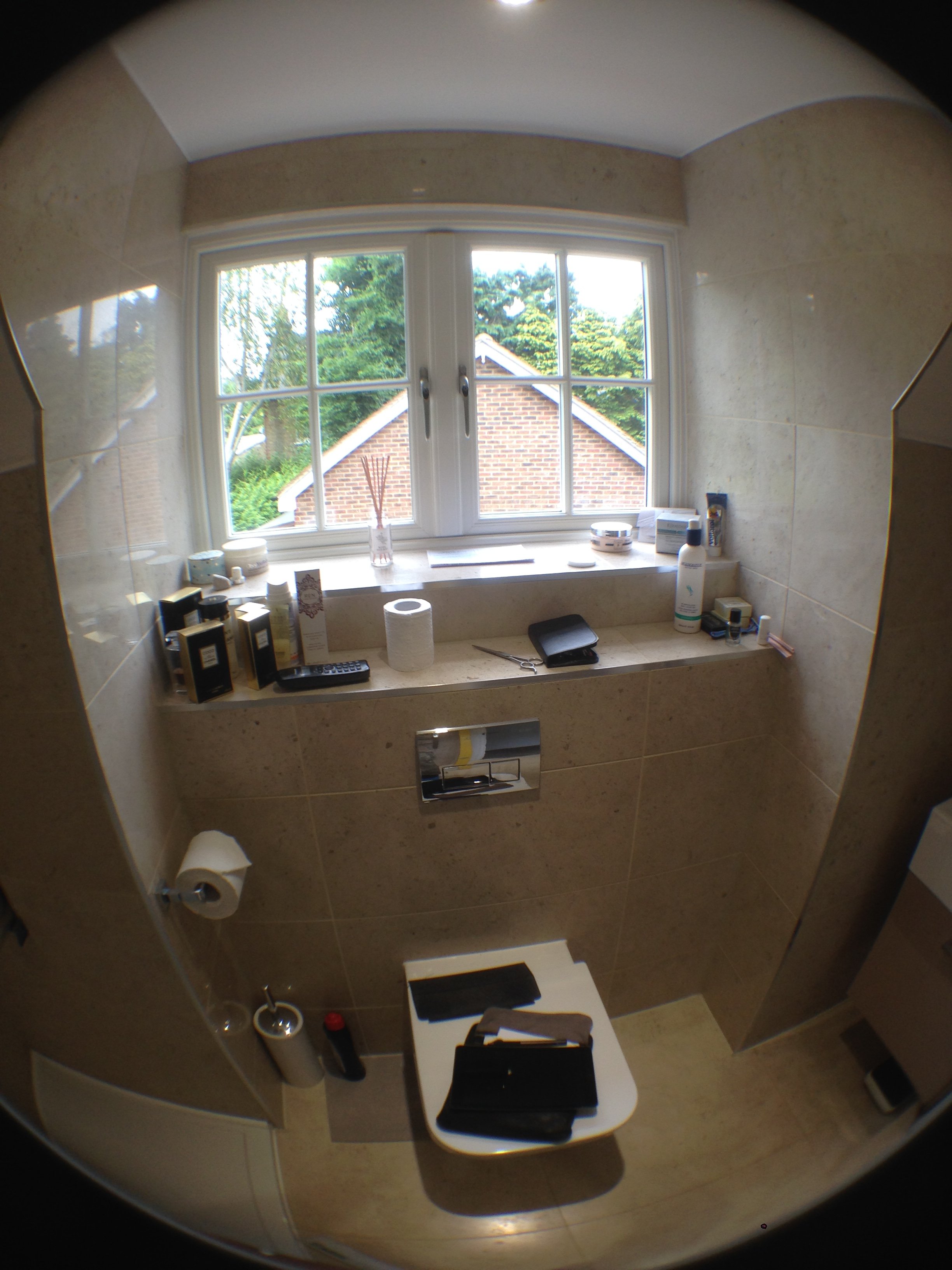

This is what they wanted ripping out!

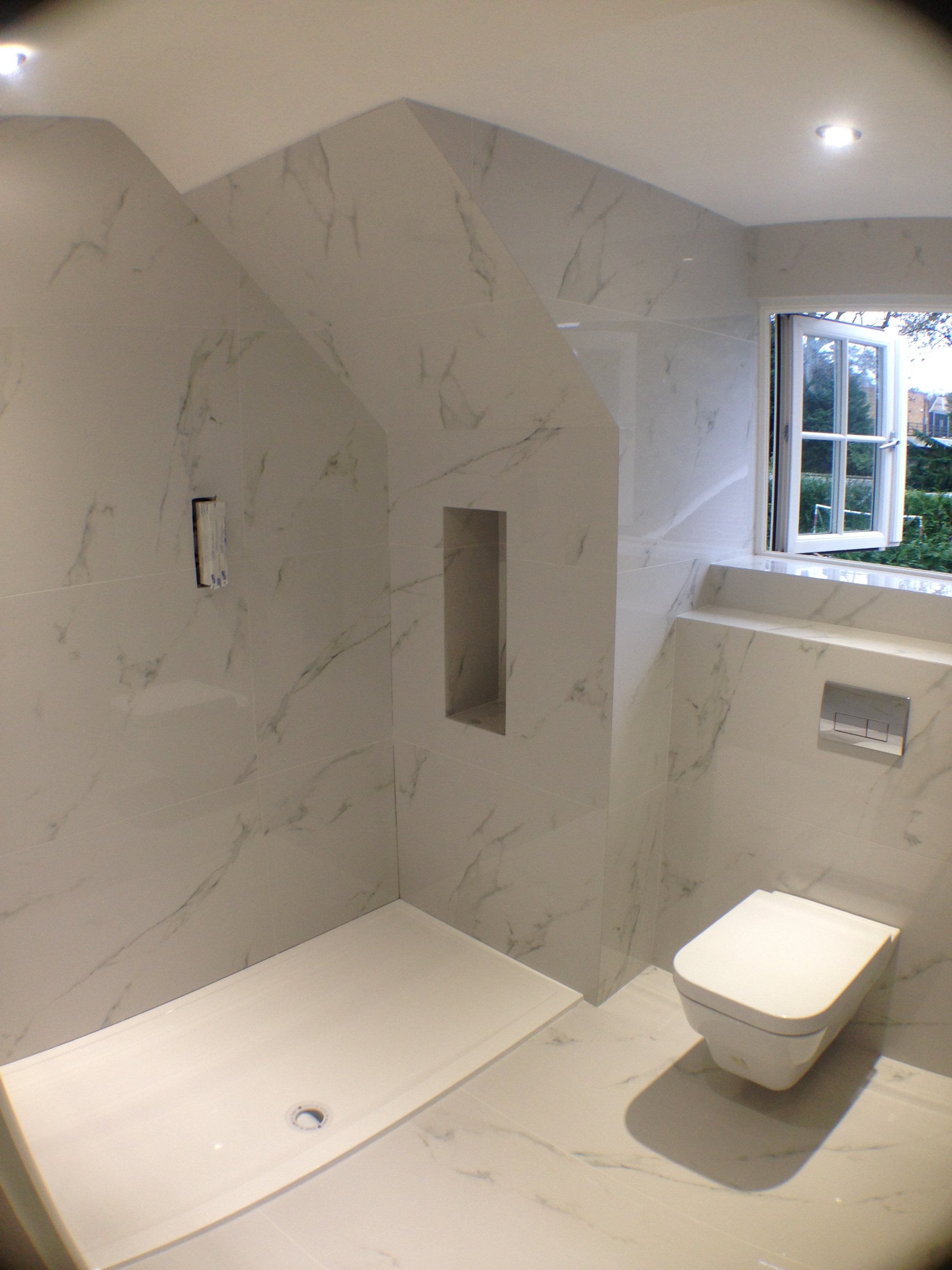

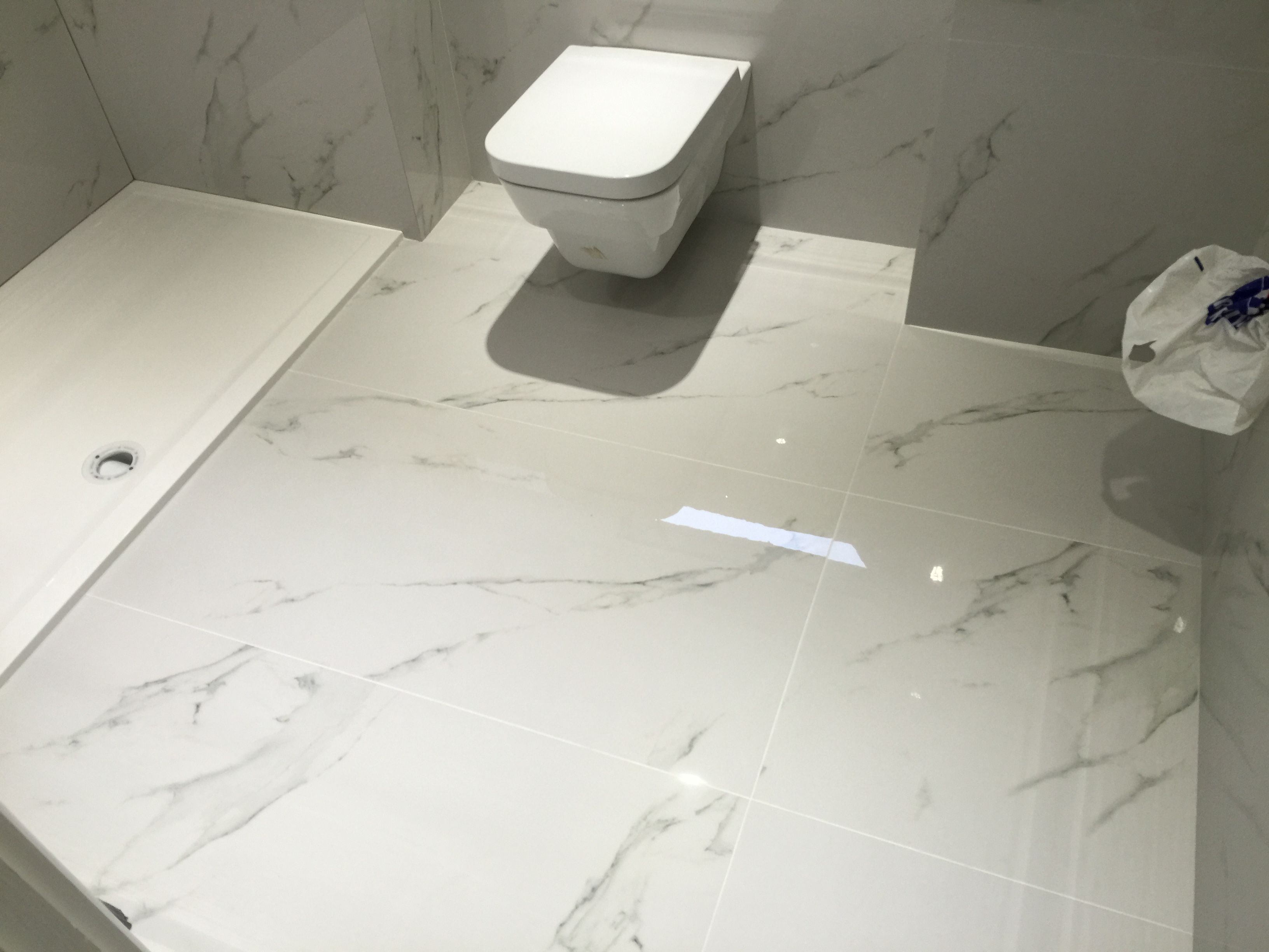

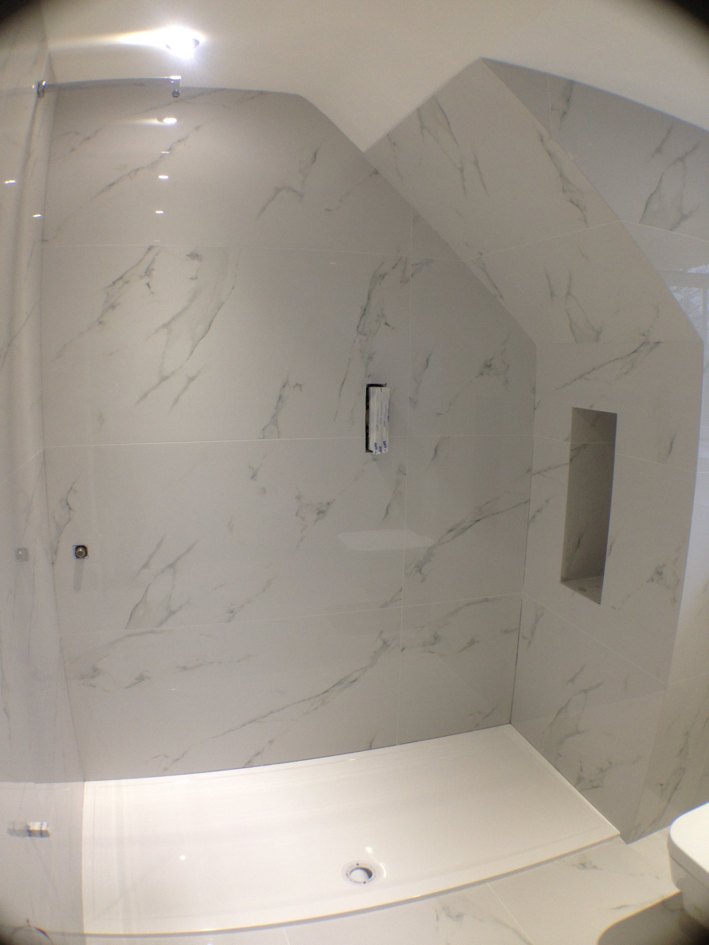

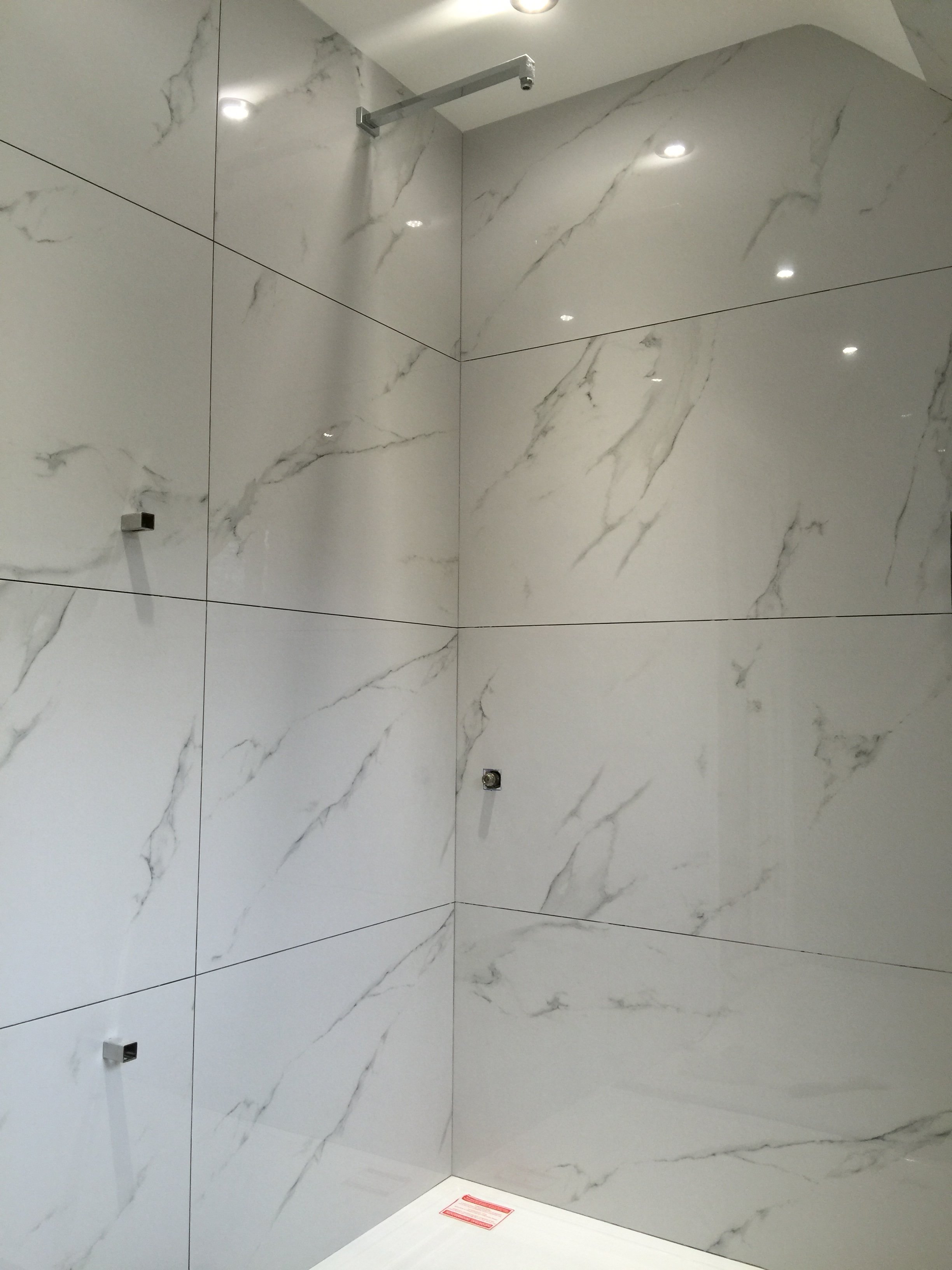

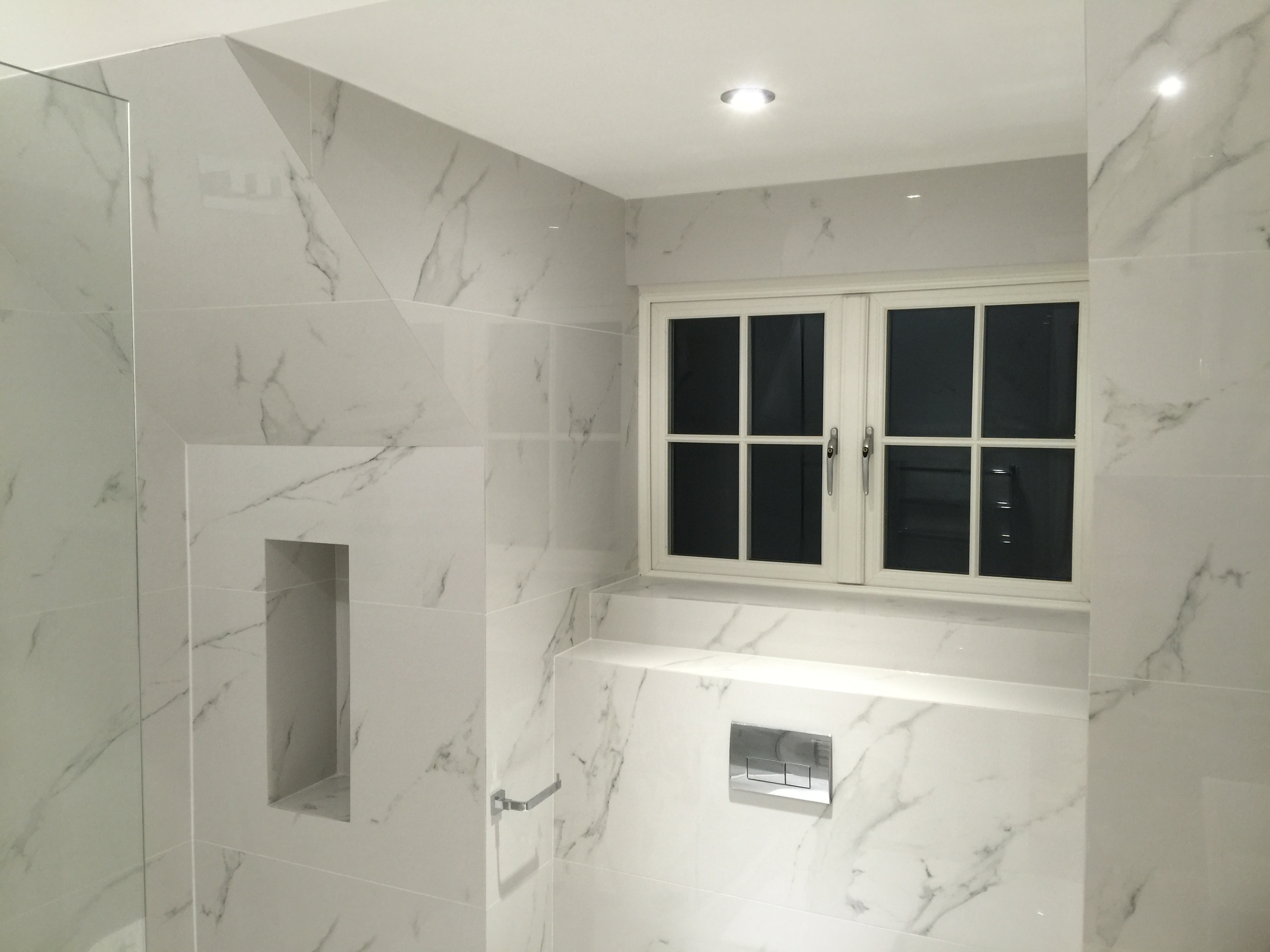

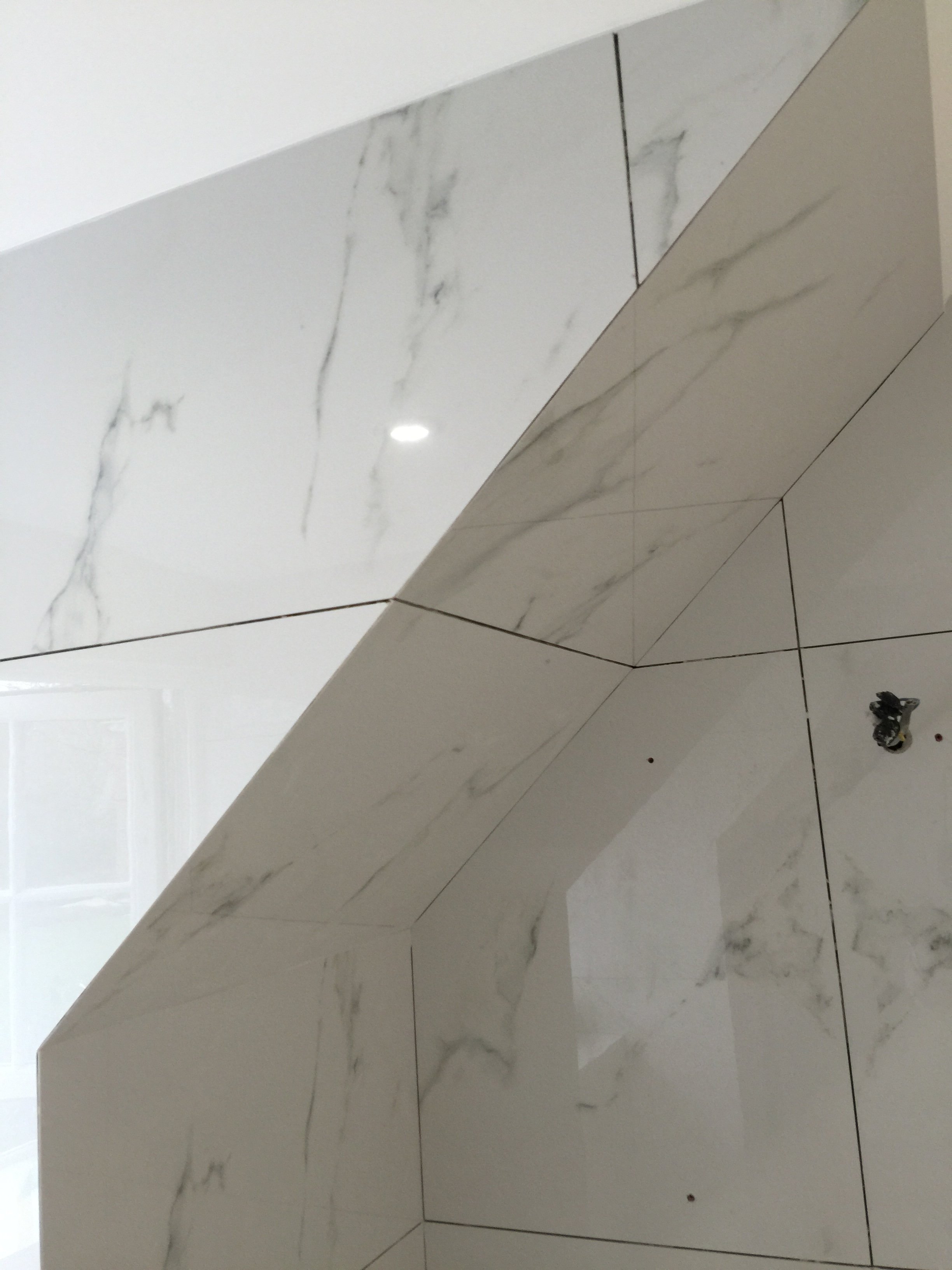

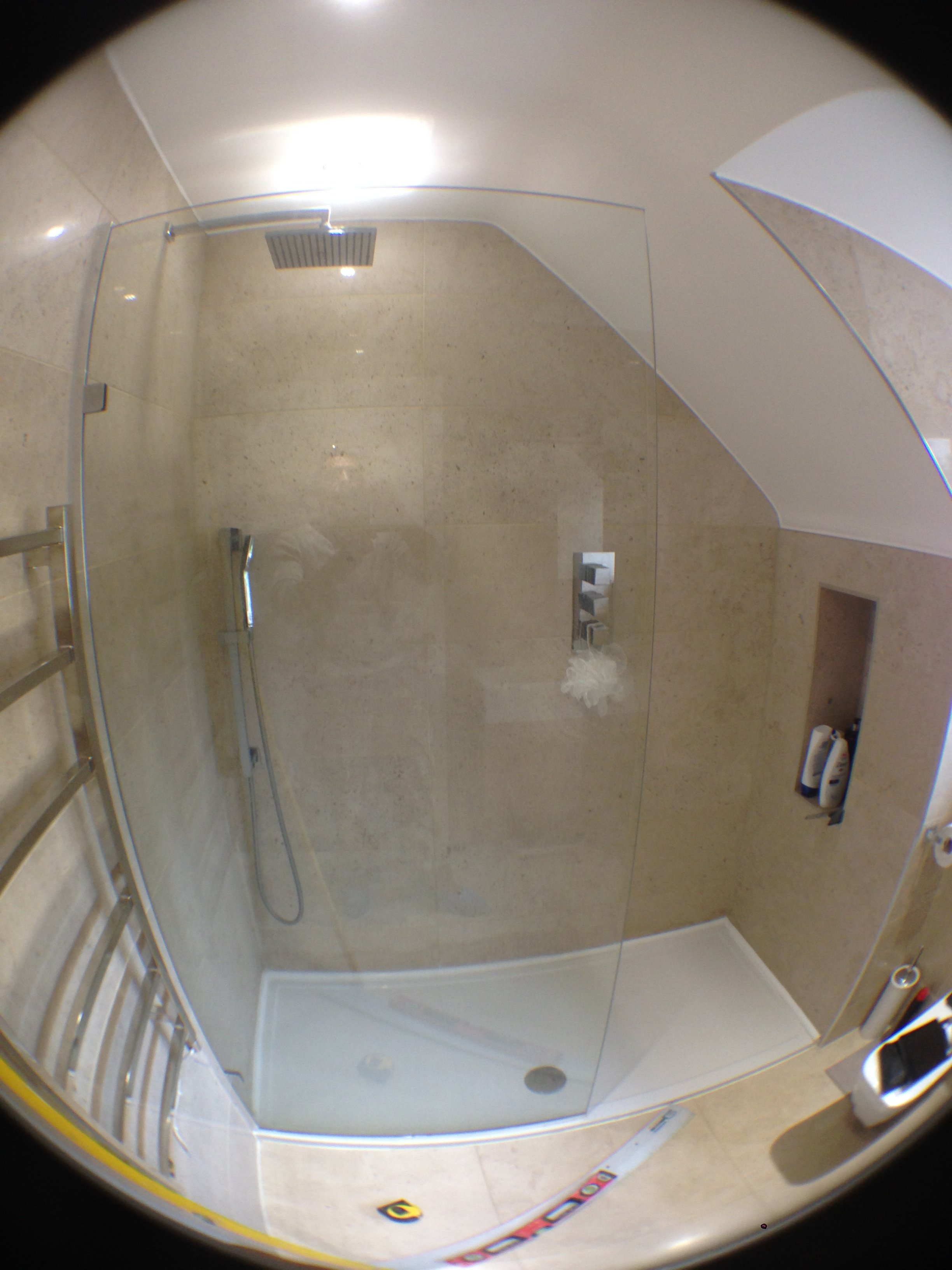

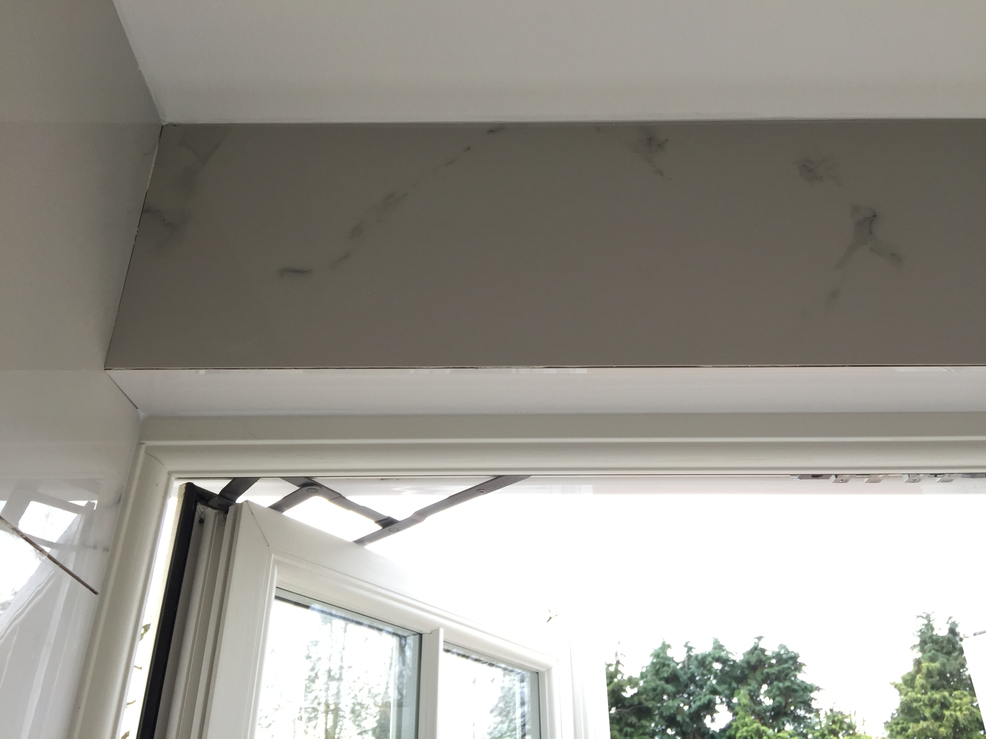

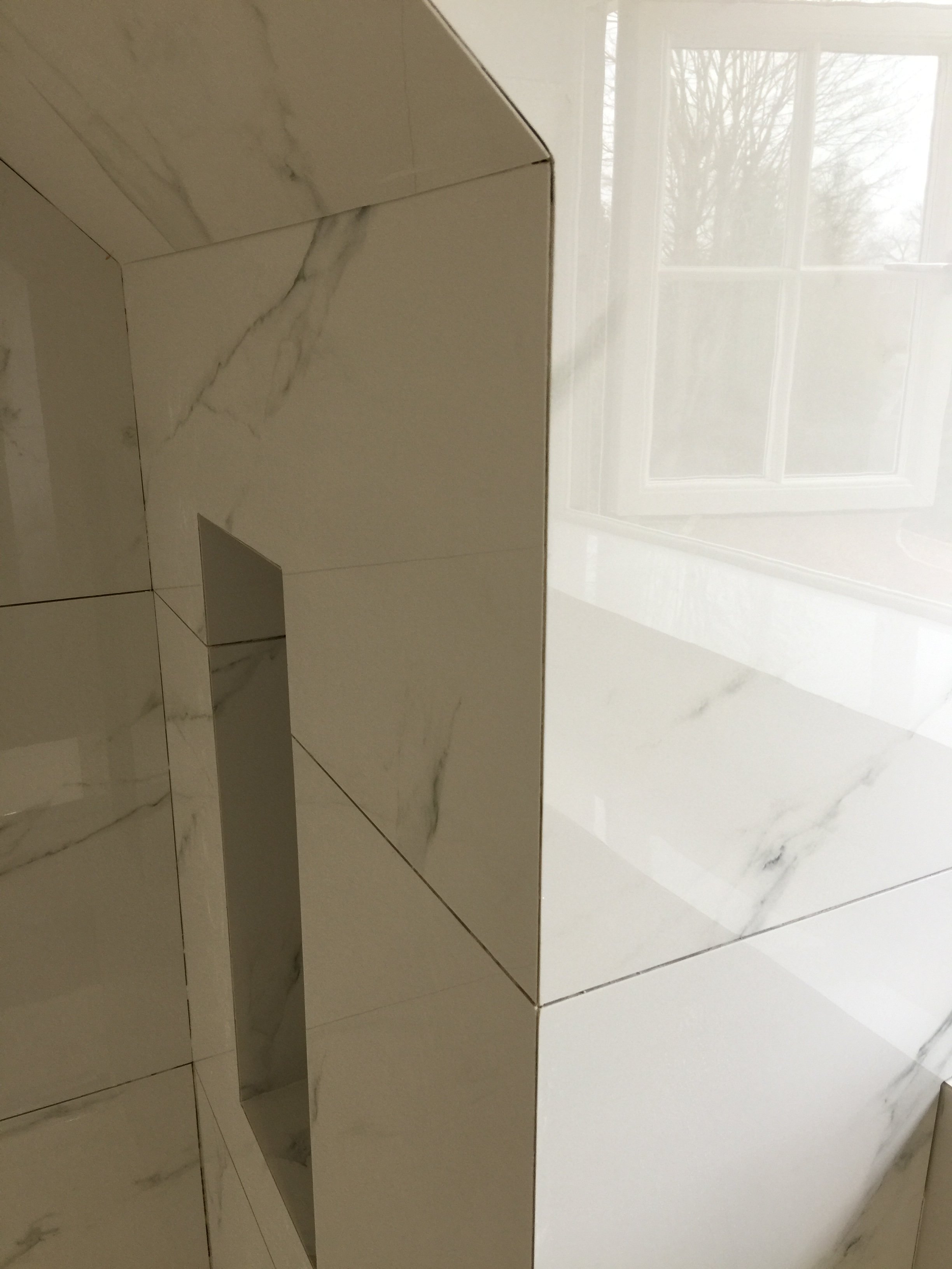

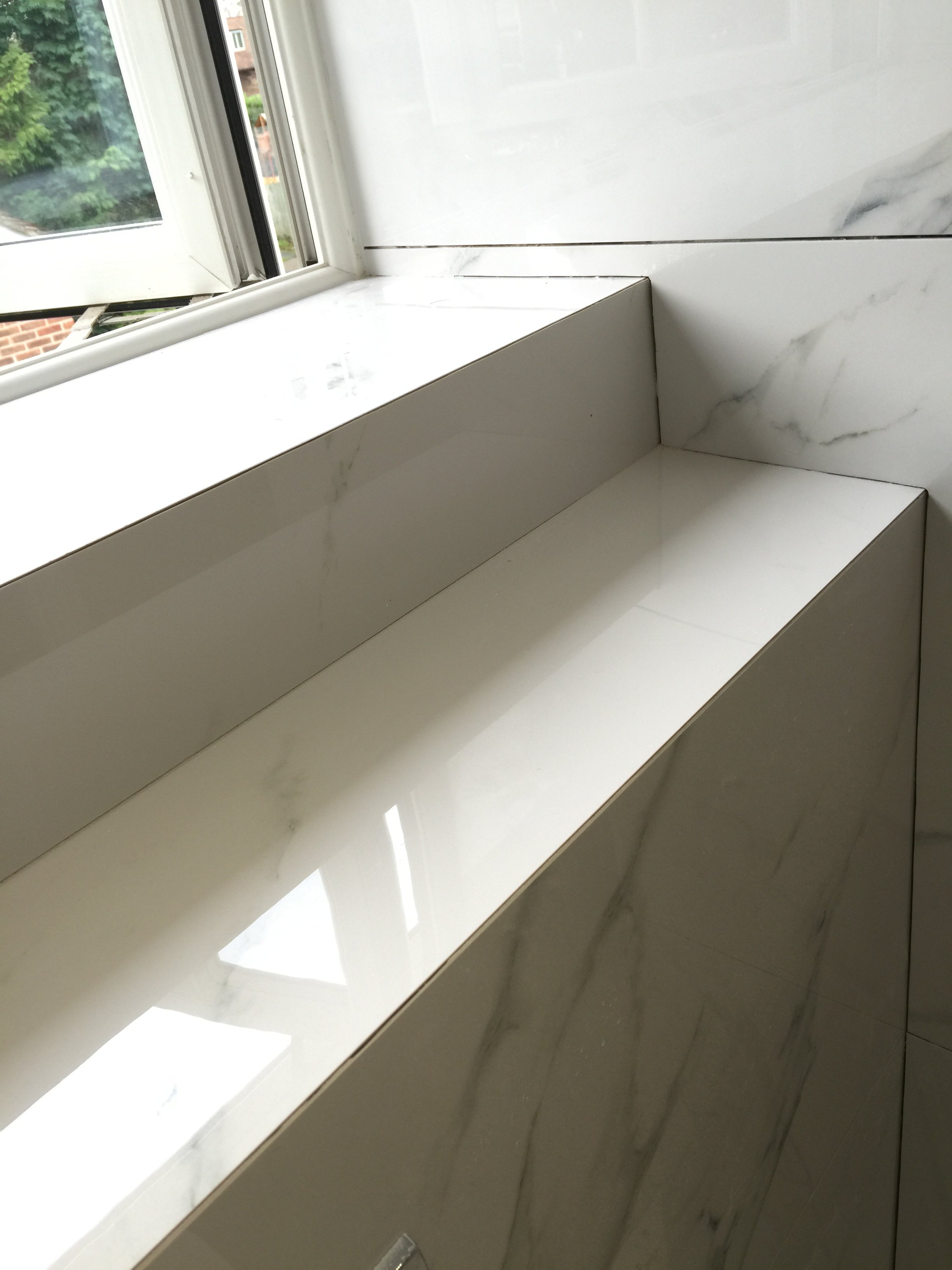

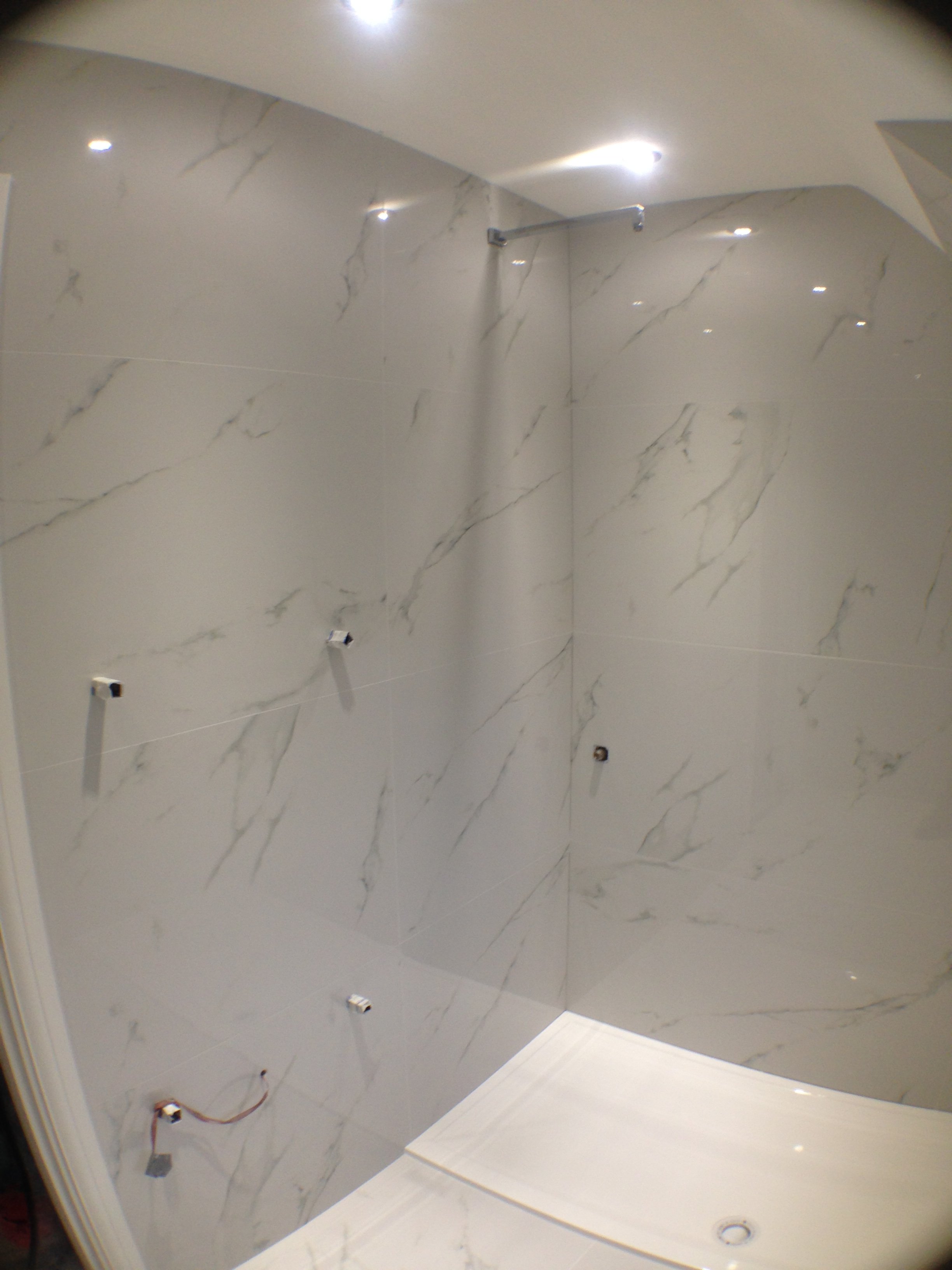

So remedials out of the way I began to transform their bathroom in to this!

Top quality installation Marc. A nice tricky job, their's nothing like going in at the deep end. 🙂
I admire your work Steve, so thank you, that's very kind of u to say.
But you're right there, it was in at deep end a bit!
However, it's the best way to learn, eh! 😉
