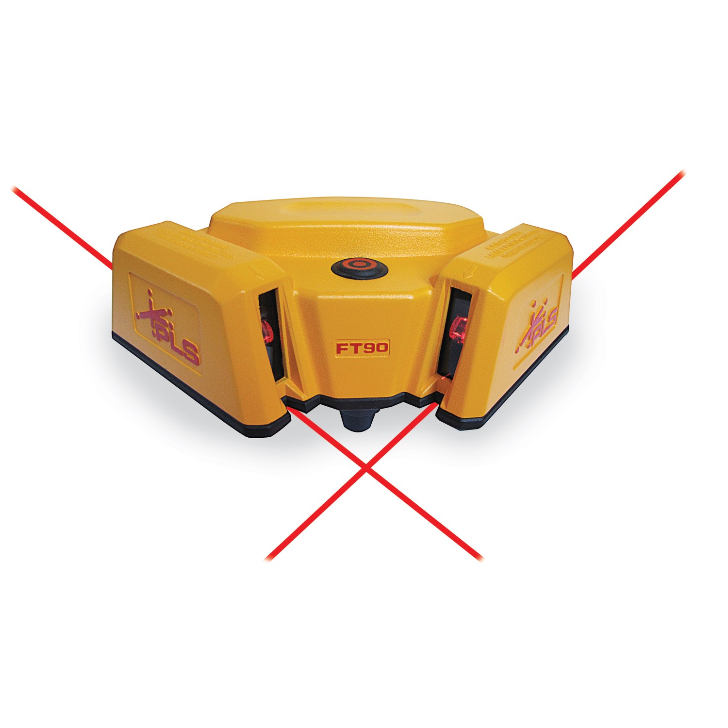

The best floor laser is the PLS FT90
It has four beams and is made of cast metal, totally worth its weight. And it weighs a lot. 🙂
@Pro Tiler Tools have a flex floor laser which is identical. We all know Flex tools are excellent. Have no reason to believe this is any less than the PLS.
Flex ALC 2-F Floor Laying Laser 393.673 D | Buy Bosch Tiling Lasers, Lasers for Tiling, Laser Levels, Rotary Lasers Online from Pro Tiler Tools - http://www.protilertools.co.uk/bosch-tiling-lasers-lasers-for-tiling-laser-levels-rotary-lasers/43106/flex-alc-2-f-floor-laying-laser-393673-d

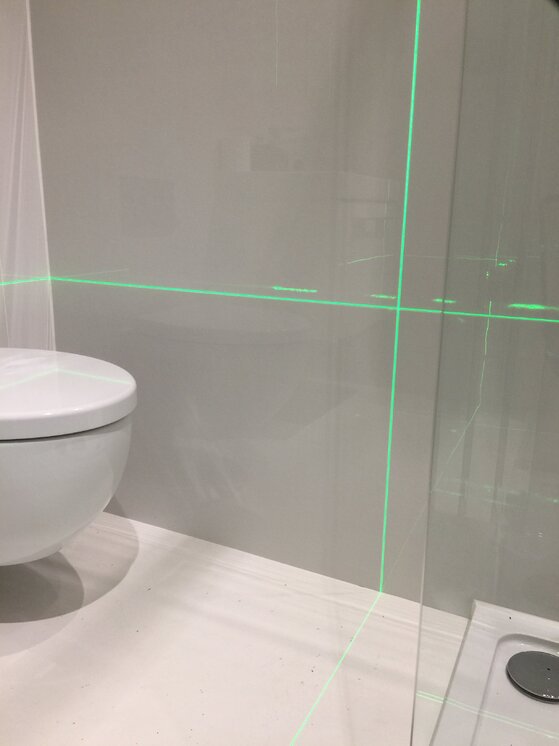

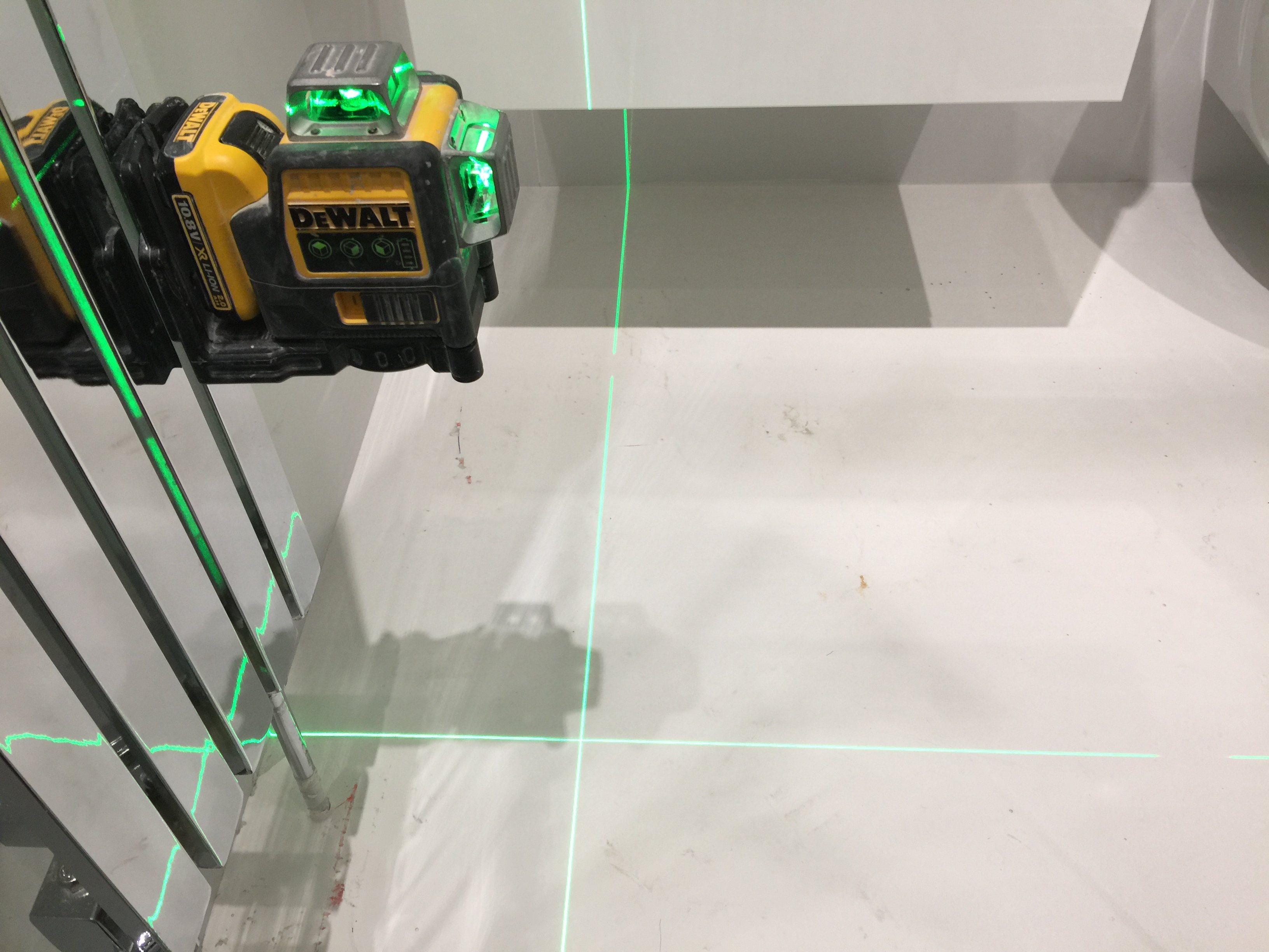

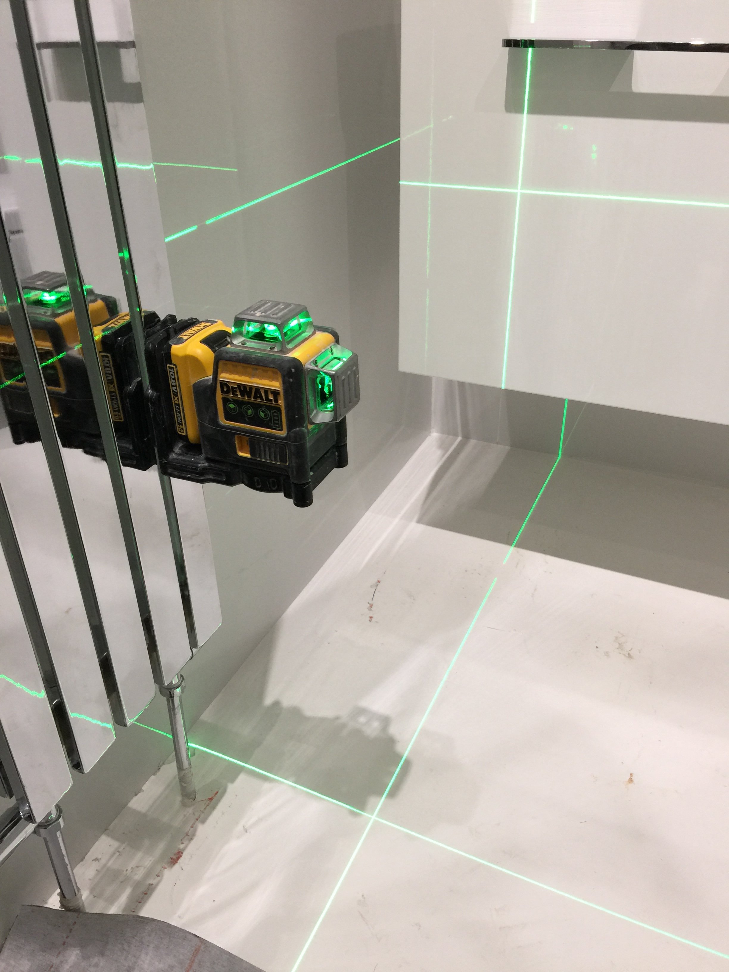

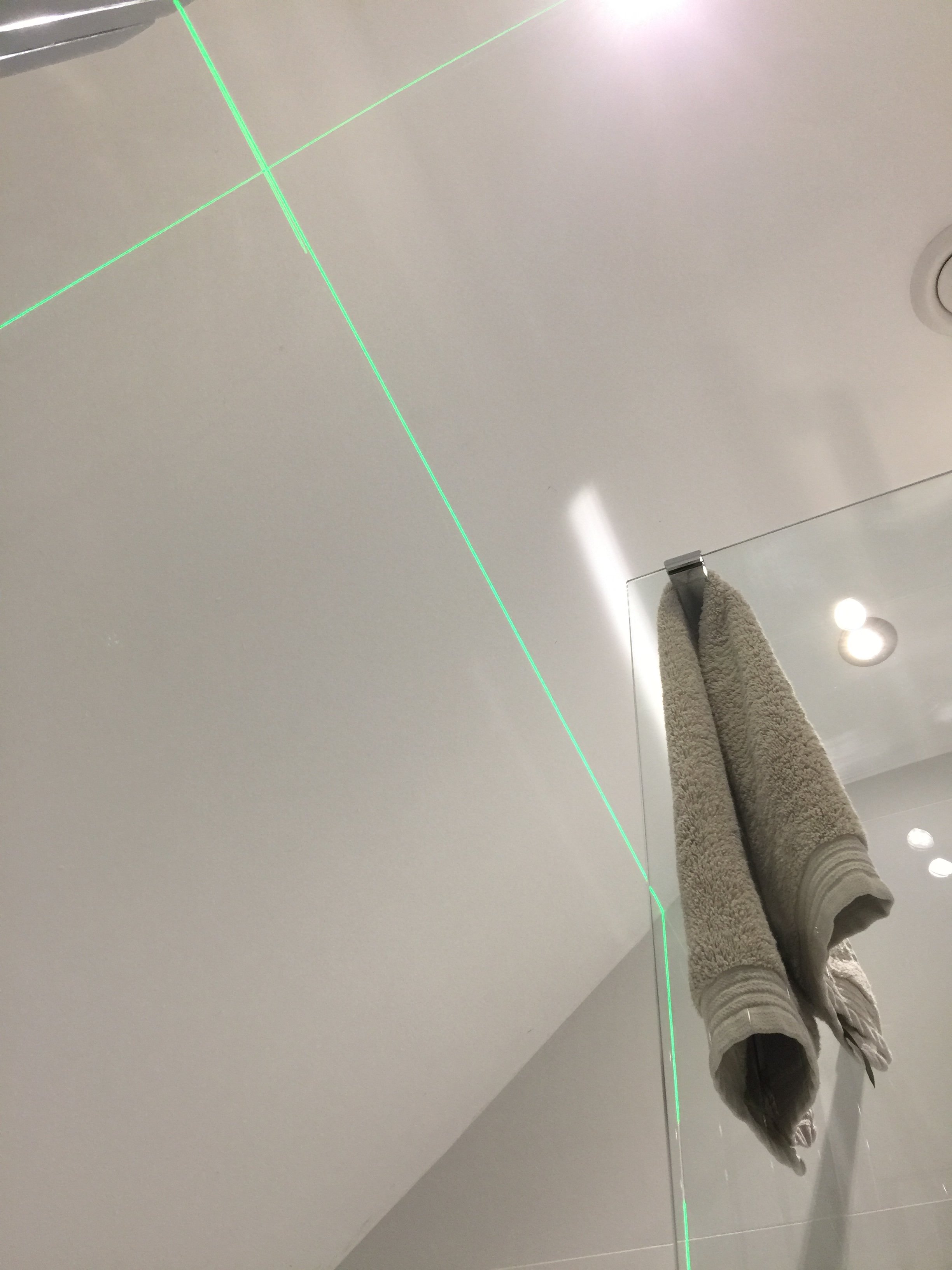

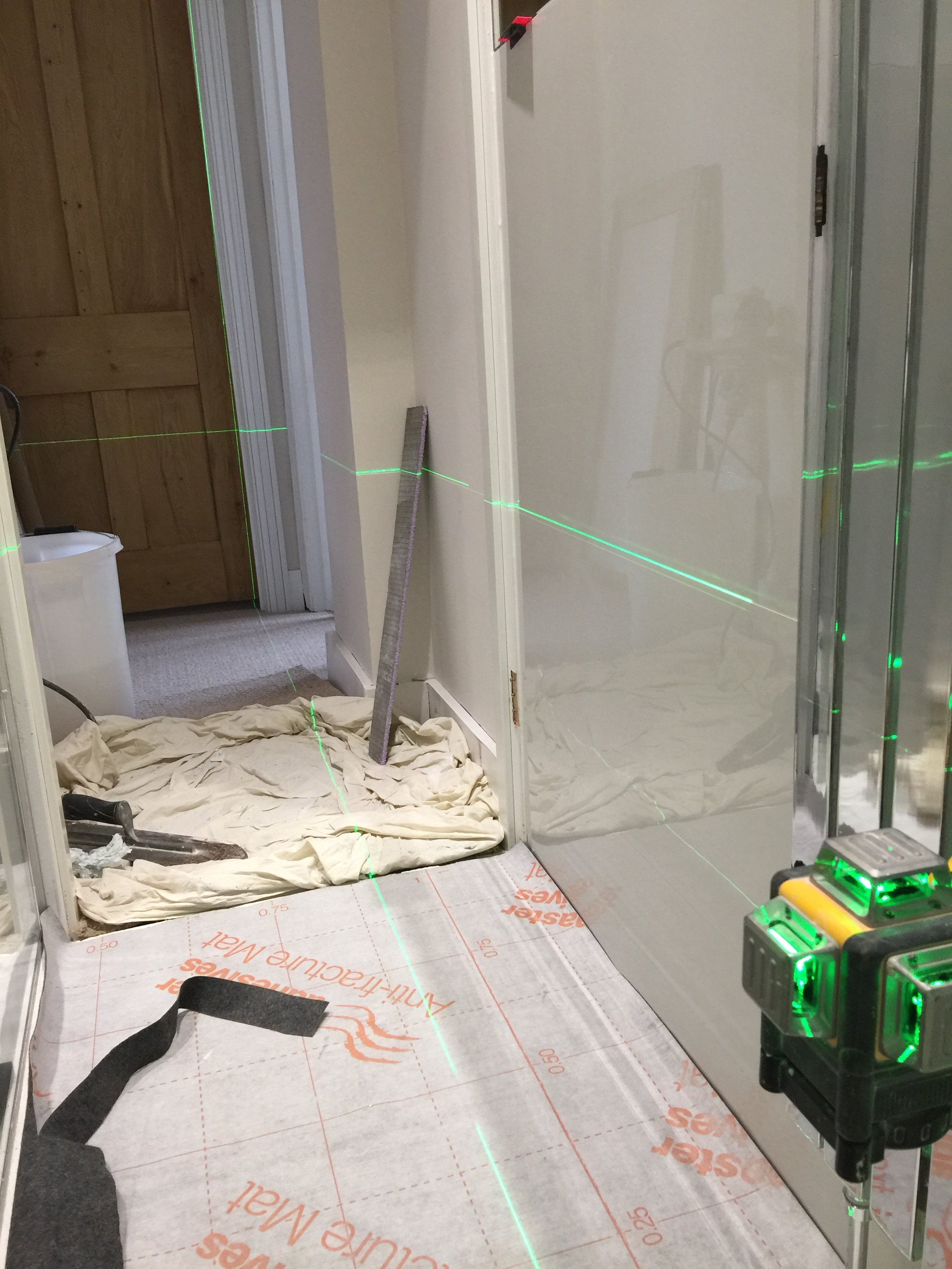

Just for you Andy @Localtiler,
There are some reflections because of shower glass and highly polished rad, but it'll give you an idea of how it works.
If you look carefully the main cross hairs follow the joint vertical and horizontal.
The weird image is the line going up and over ceiling, and the long shot down corridor, if you expand you'll see the vertical line in the door jamb.
So last placed in one location it covers all surfaces. No separate wall or floor laser.
And tbh if you buy good quality separate items, the multibeam is just a bit more than the two put together.

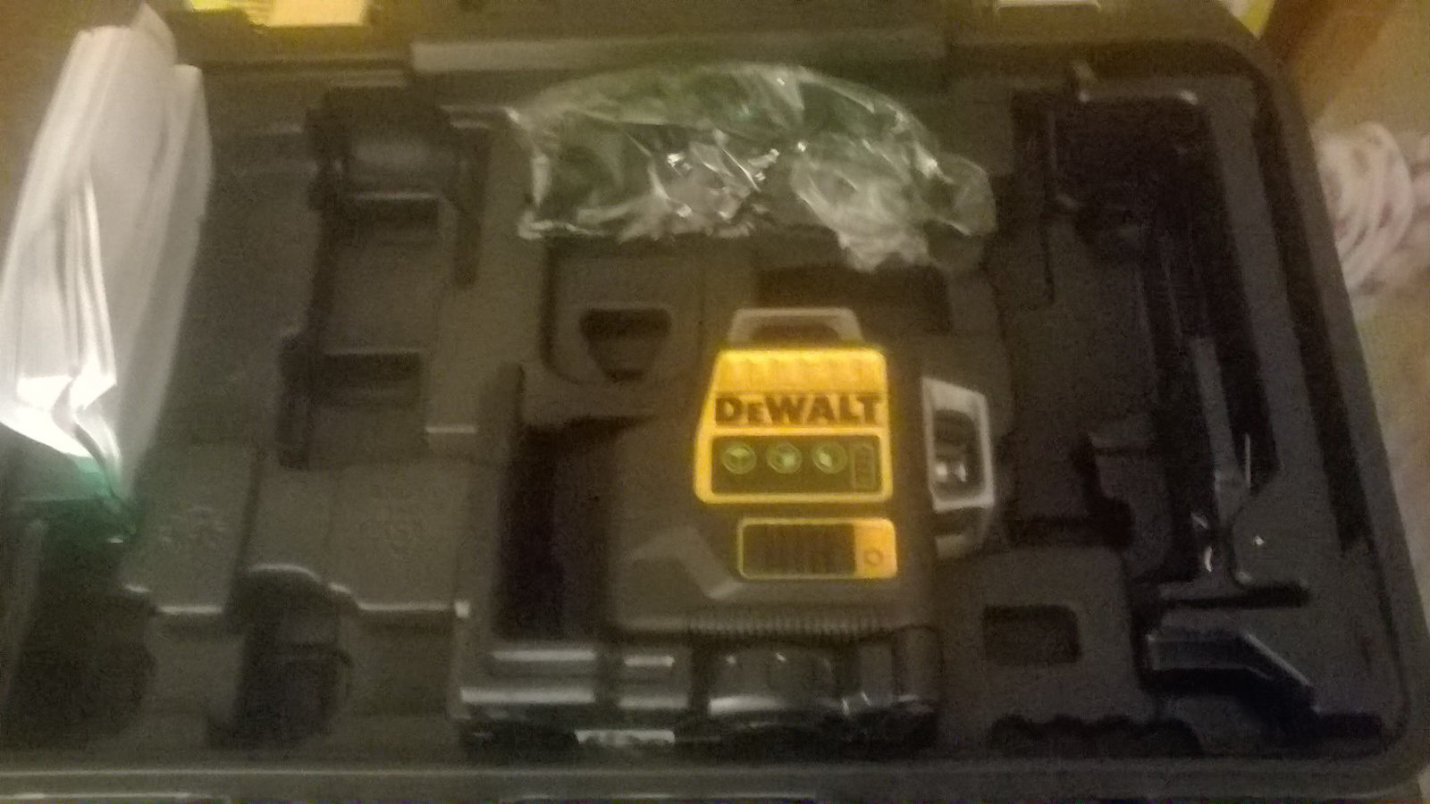

after a quick charge and mess around the only negative(very slight) is it doesn't have a fine tune for vertical beam like my dw089k did. the positives are everything else!
to add to this it doesn't swivel super easily like the dw089k which makes fine adjustments easier

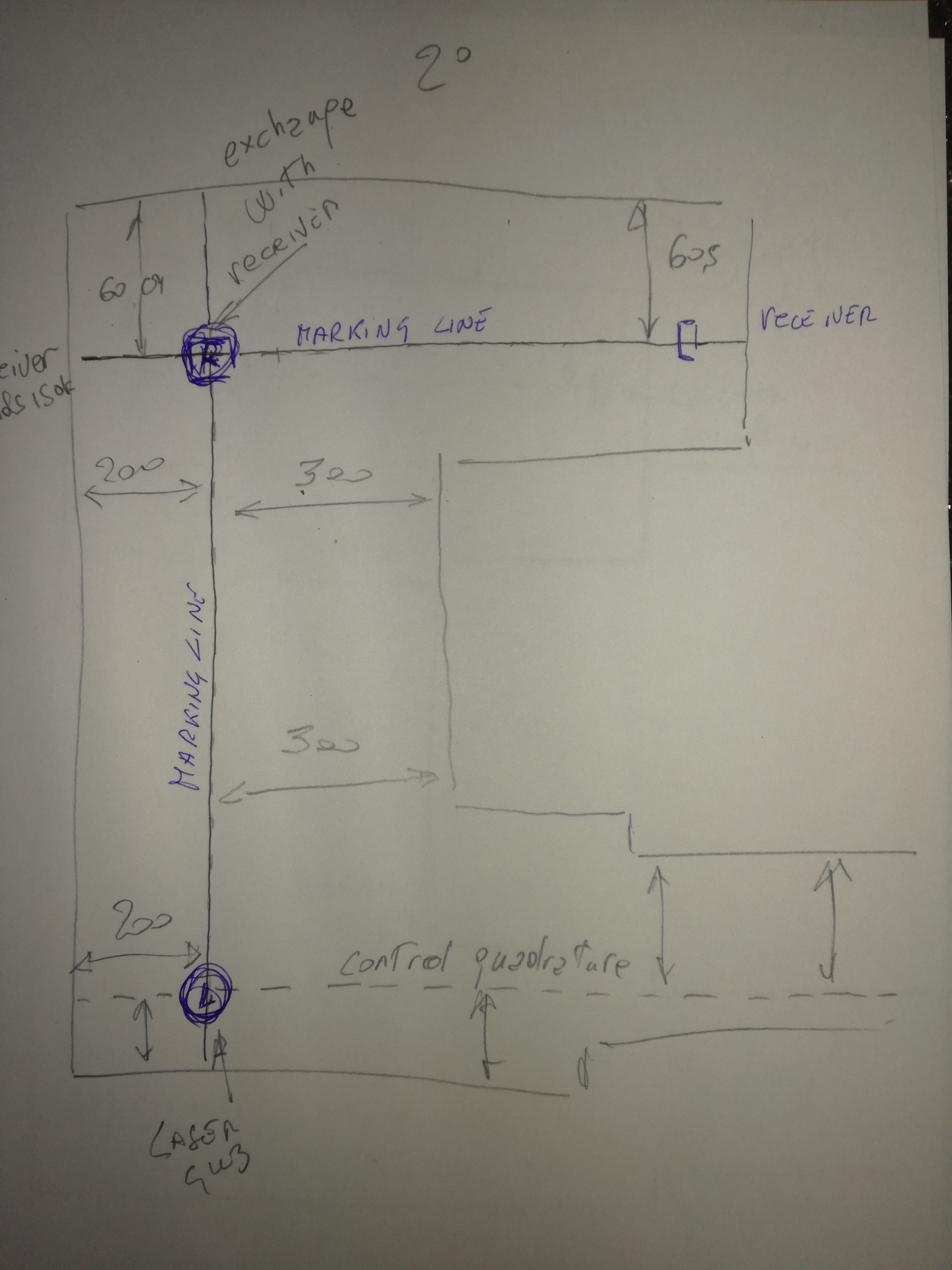

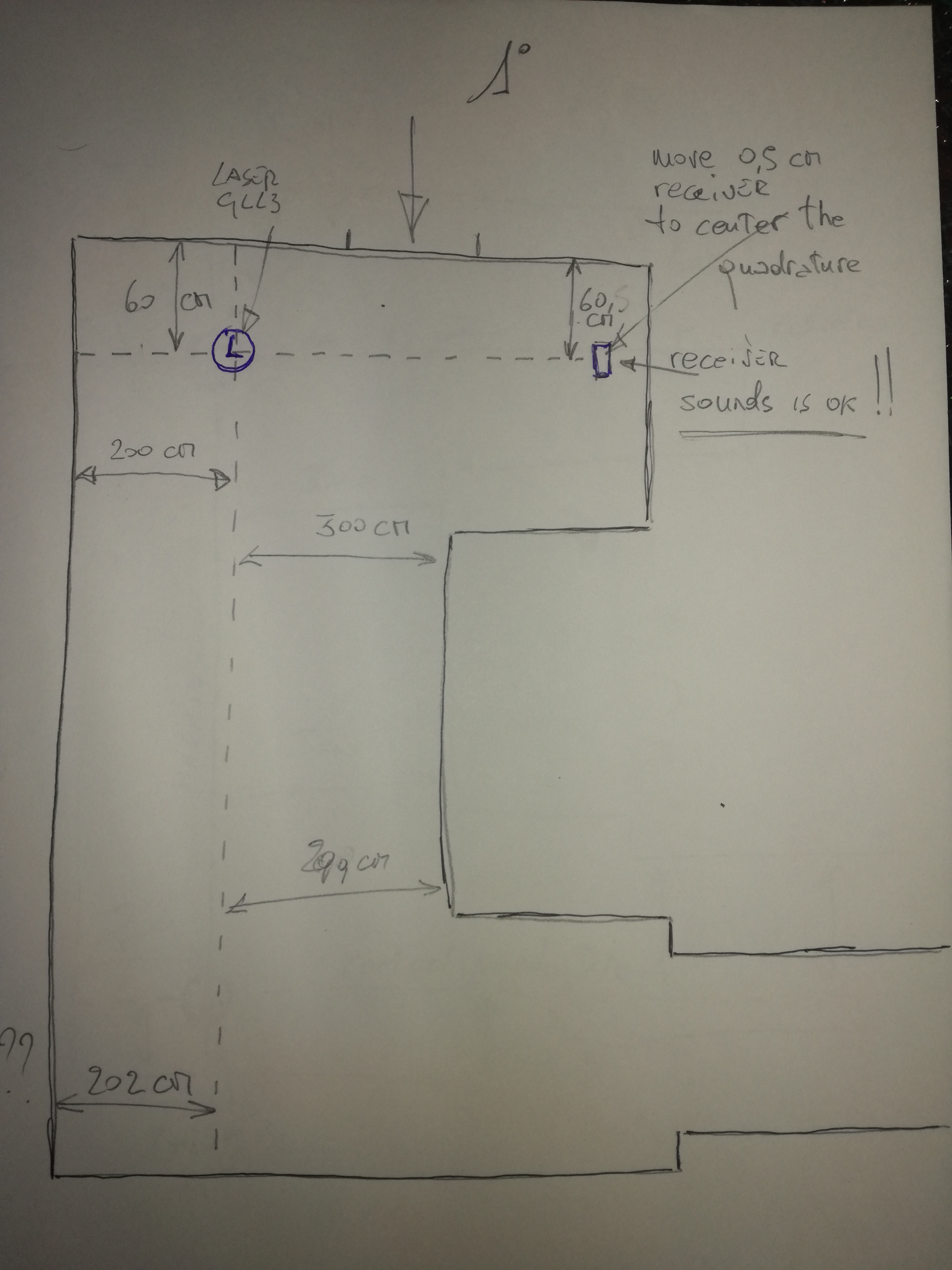

put beforehand,I like to explore. I do not want to teach anything to anyone, I just wanted to share the function of the receiver coupled to the laser, this is to avoid making 100 steps before starting work. It only takes 5 minutes to understand the squaring not only one room, but all the rooms to be laid.
excuse the drawings, but I just woke up from nap. 🙂
receiver with or without the function is the same.
with the receiver it is only faster and more accurate.
I posted the drawings, because I saw that no one use the receiver.
I always thought that the receiver, only served to the walls, in large distances, then one day I tried to put it on the floor, and surprise I saw that it worked, working alone, becomes very useful.
