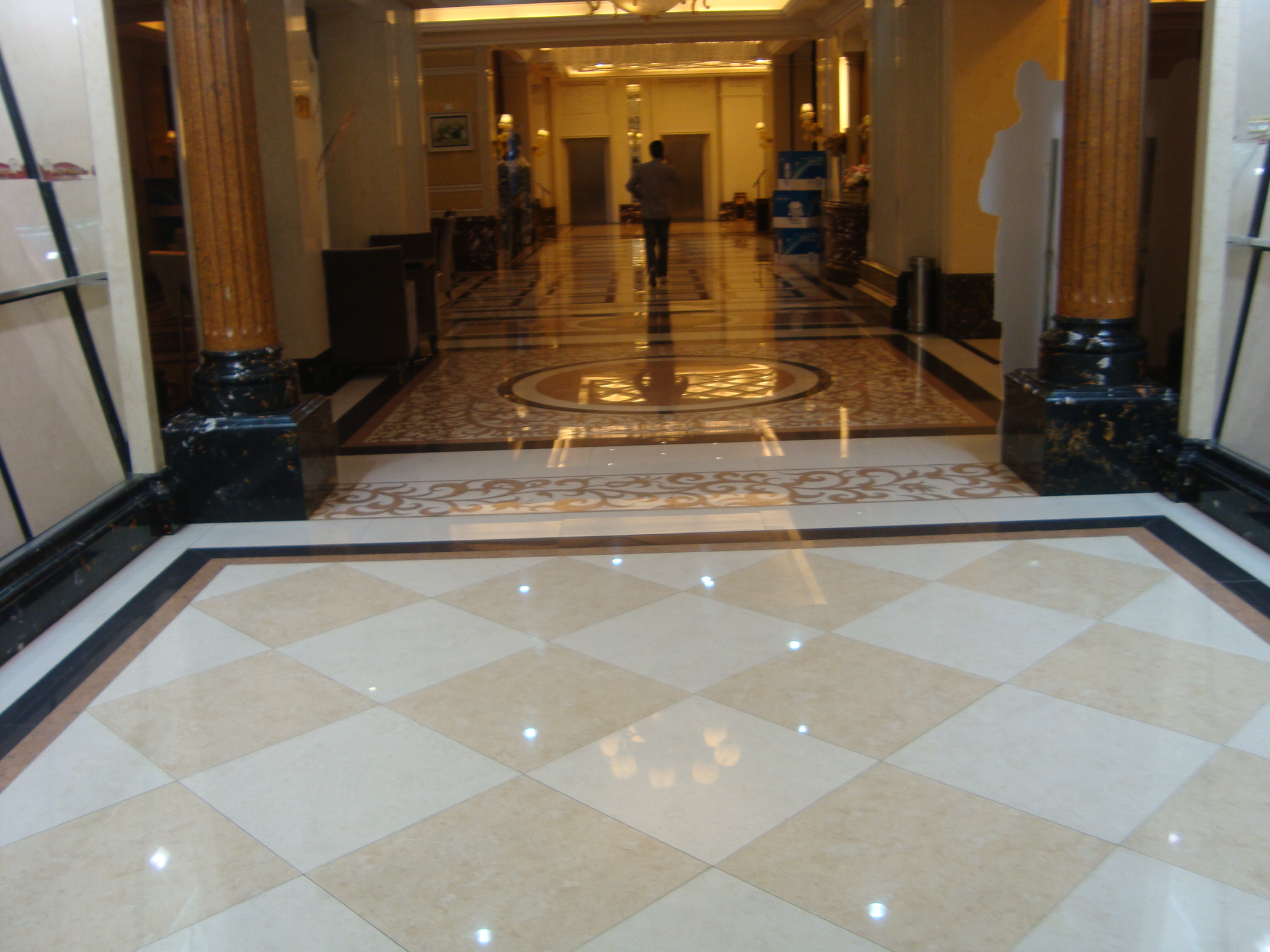

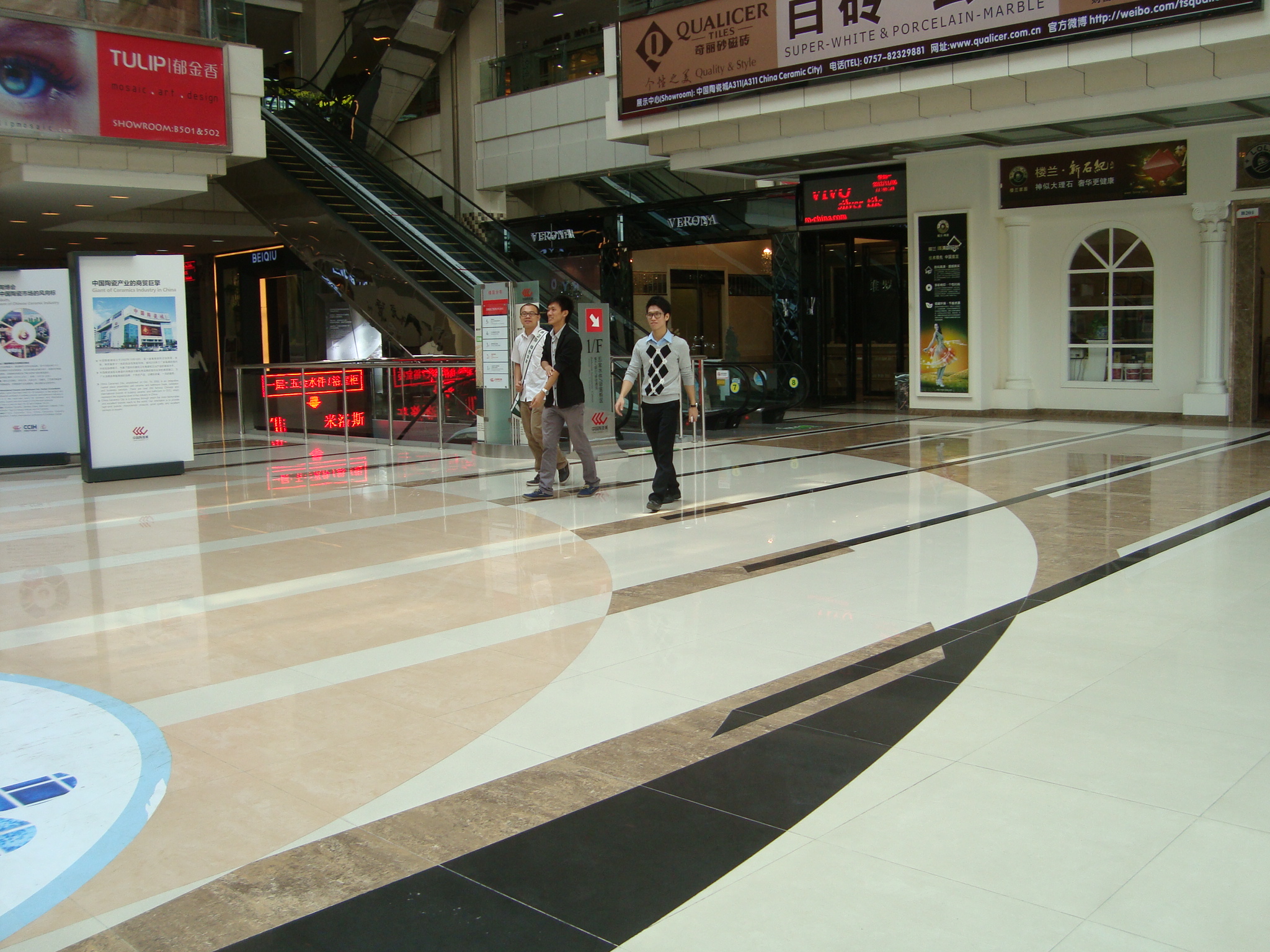

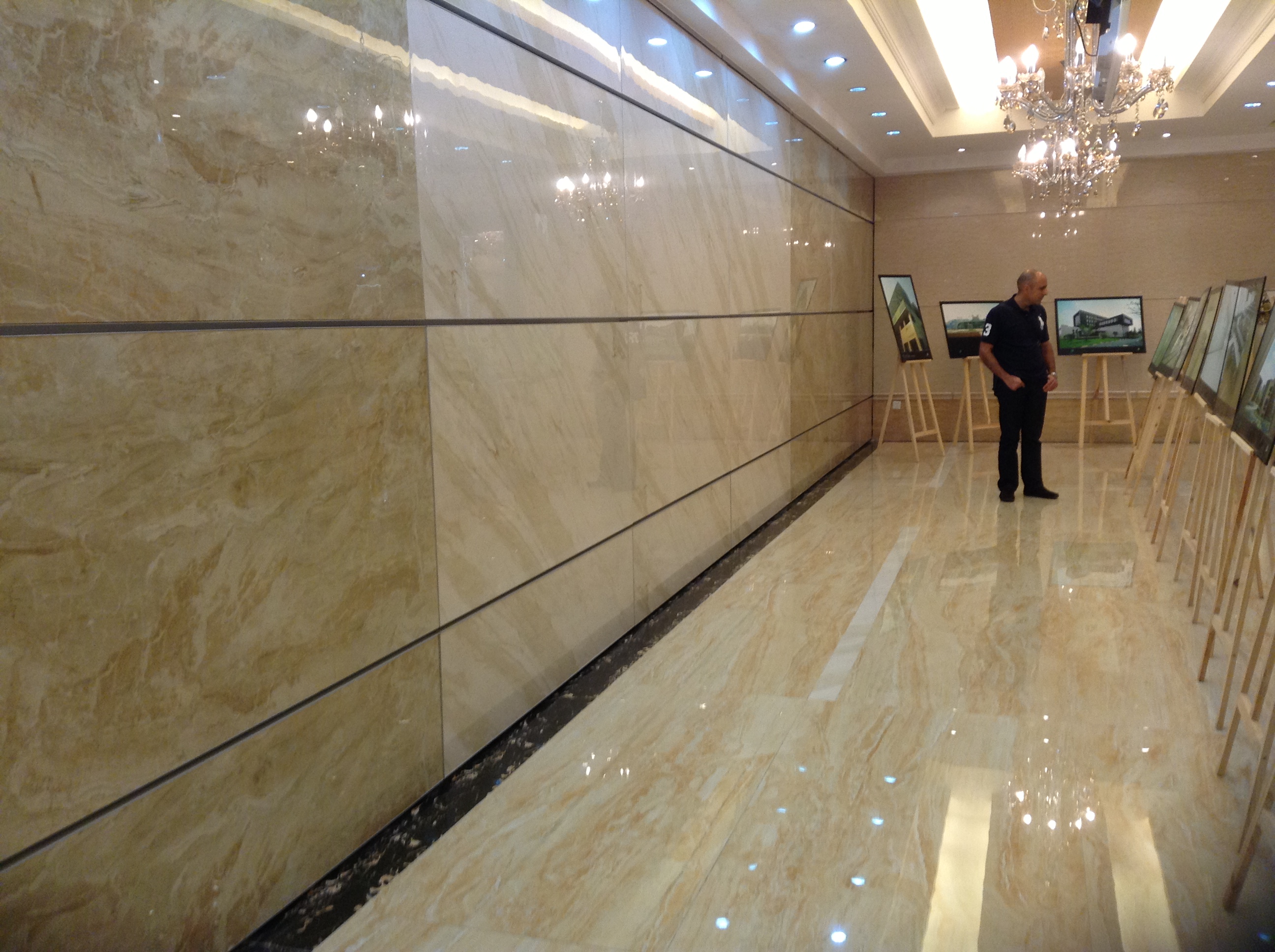

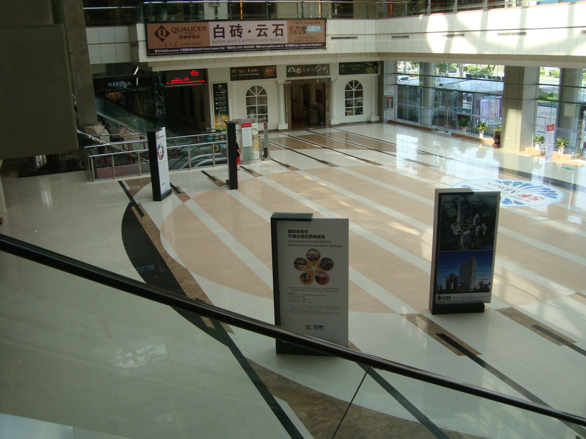

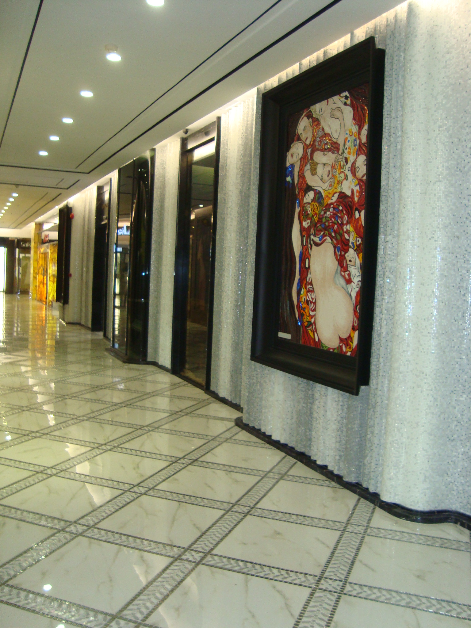

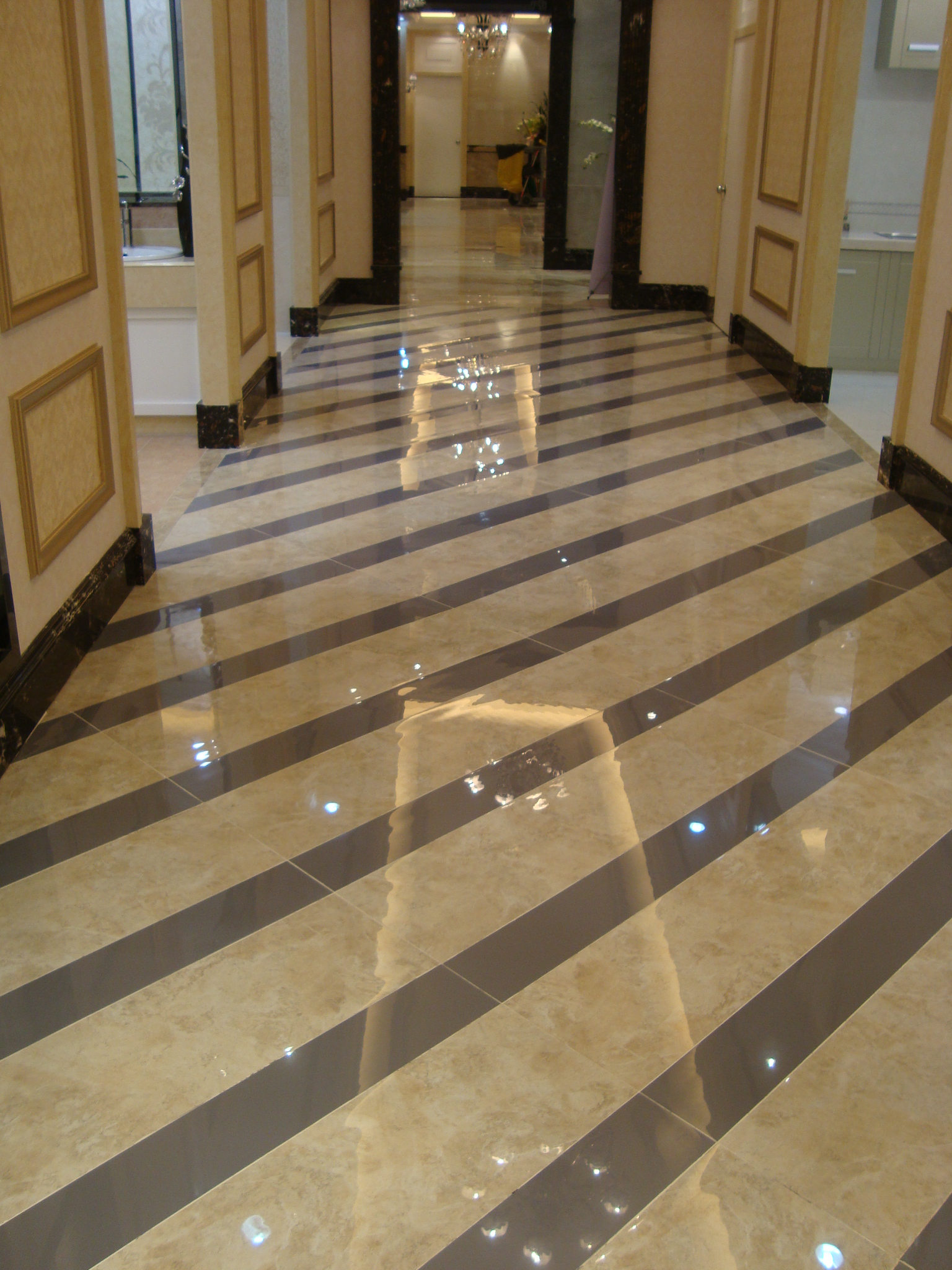

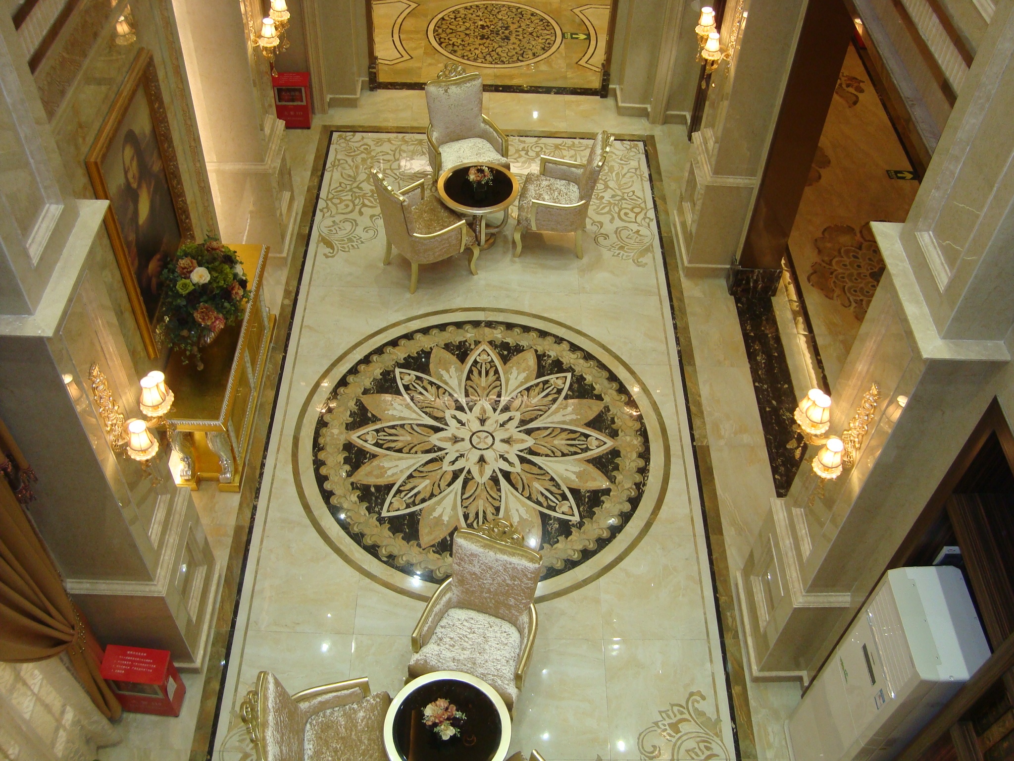

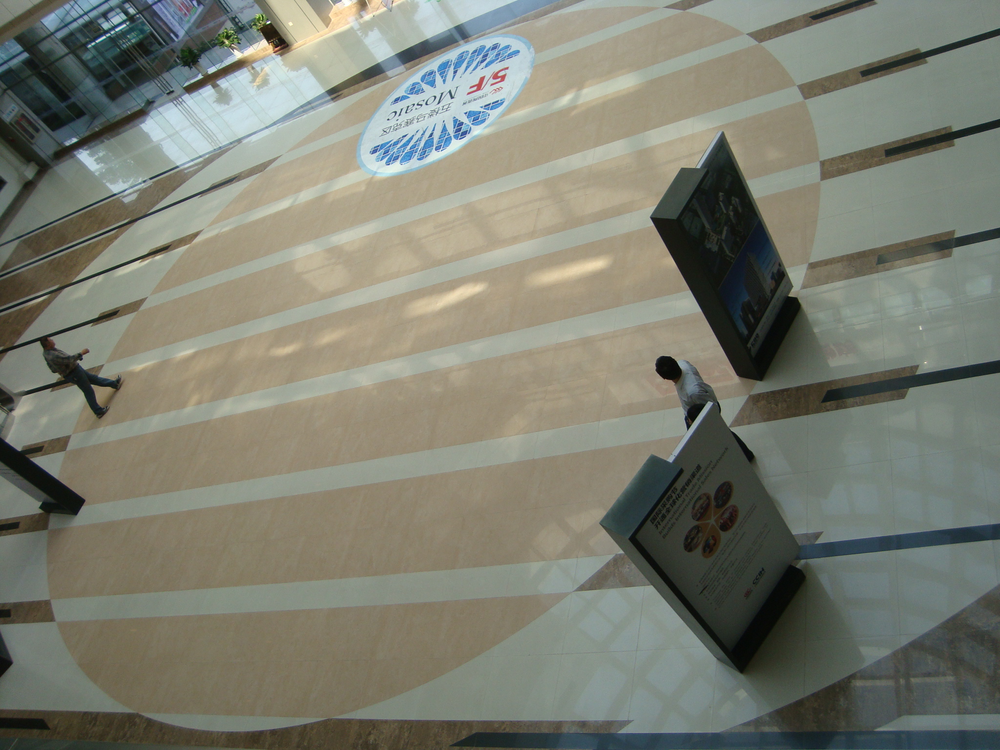

well the day i start to believe i cant learn more about fixing tiles from around the world oh my god i must be italian heres a few pics from china fixed in s/c and they fix a mosaic or two my god they must be rubbish
View attachment 79505 View attachment 79506 View attachment 79507 View attachment 79508 View attachment 79509 View attachment 79510 View attachment 79511 View attachment 79512 View attachment 79513
do not worry, do not fret, because I believe that you did not understand the translation (google traslade ...).
I know that there are such things in China, the TV also comes in italy 🙂
(as I understand) you Ray say that these works (pictures) are made with s & c?
until the measures are s & C?
you believe (again as I understand) that these jobs done with s & c. I am better than with glue?
else, I was saying that the installation of tiles made by the Chinese. (there is nothing to learn). Chinese do not work ....
now conclude that the speech is better, unfortunately the language I can not understand all the words, and then it is useless to argue.
thank you

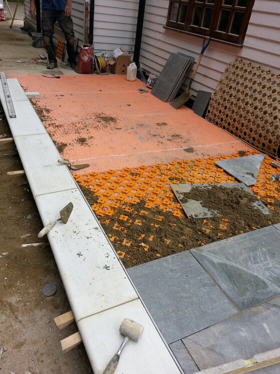

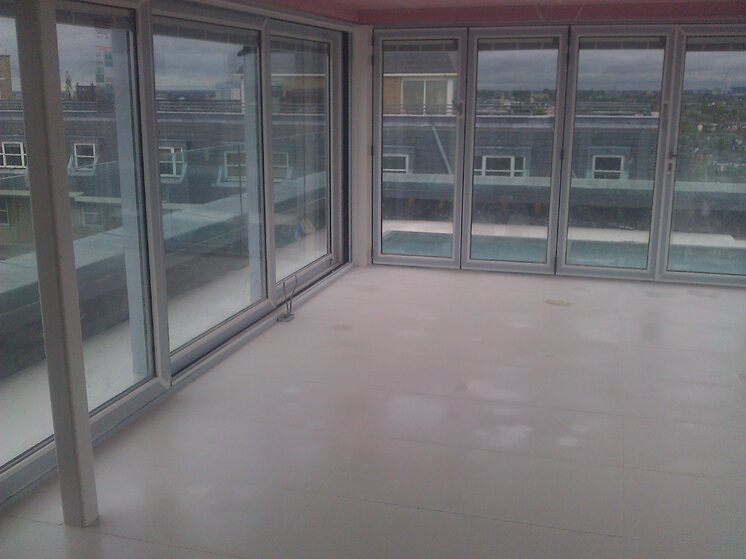

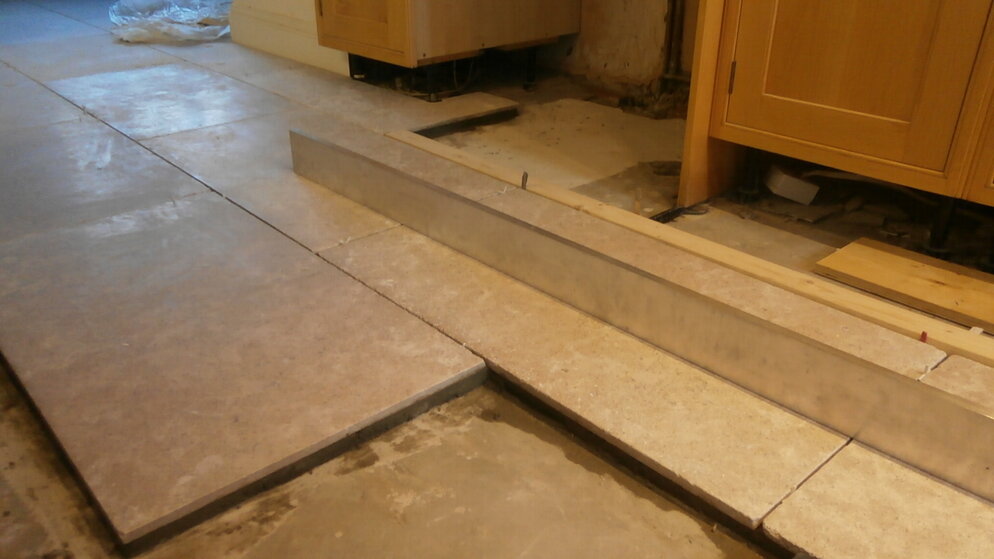

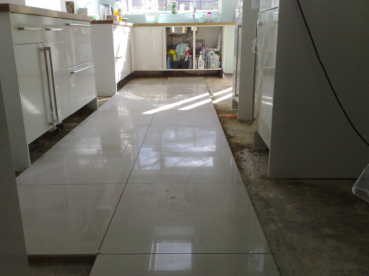

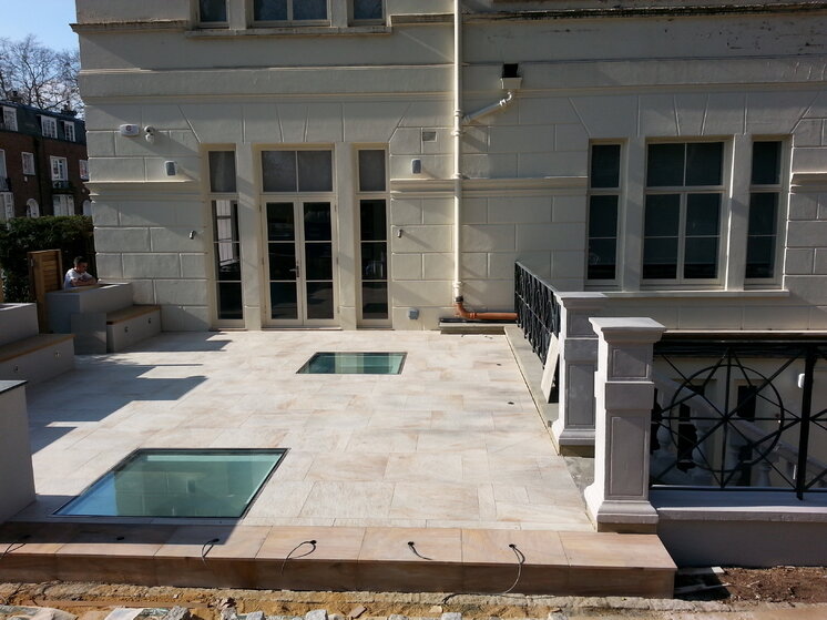

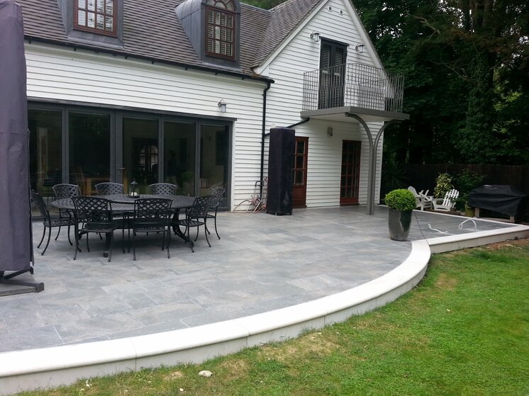

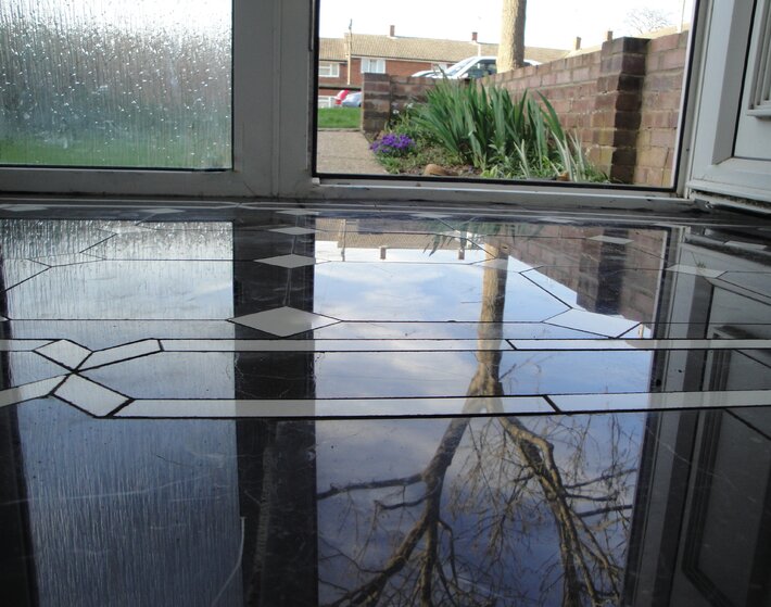

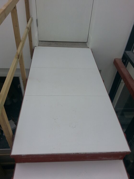

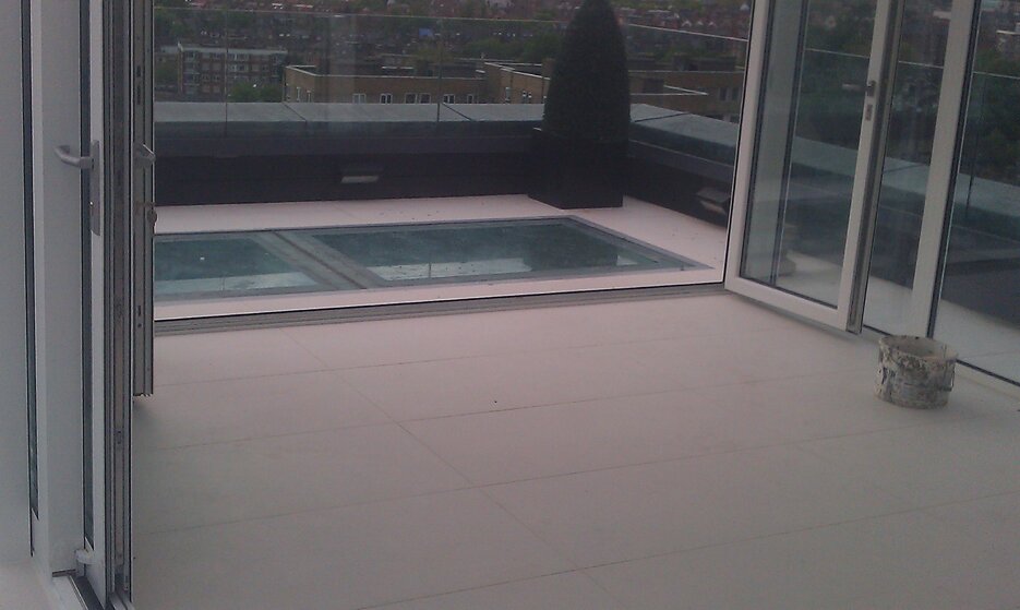

we do a few floors each year laid in sand and cement here are few recentish ones, great way of laying tiles and its more widely used than you might think even these days

if you are pleased with our customers are happy with your work. all is ok.
probably my idea of perfection is different than yours,
now no longer I answer to this trend, otherwise I will raise your blood pressure. lol
its time to get over the romans there long gone we have to look to the lay brothers that took tiling to the next level .blood pressure .in your dreams land of the fiat .but joint tiling .more bent tiles than you can shake a stick at .lol i do all day .how you get away with
Gary - why was Beko-tec drain matting specc'd there? And was it on top of Troba-plus?
Just curious!

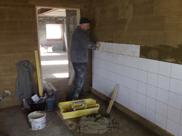

QUOTE="GaryTheTiler, post: 801673, member: 4720"]laundry room in an old peoples home , plasterers left the walls in scratch coat so I decided to fit the tiles the old fashioned way , hadnt done it for several years so wanted a bit of practice[/QUOTE] you do realise that you've made removing them at some possible future date, rather a headache for someone don't you?!

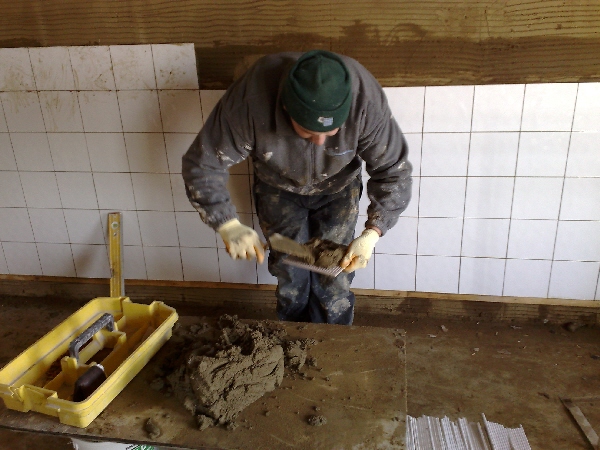

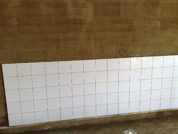

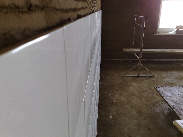

you can do wall tiling with sand and cement too there are several different methods thin and thick bedding
here is the thick bed or hand fixing method as it is sometimes called
View attachment 79660 View attachment 79661 View attachment 79662 View attachment 79663
This takes me back, soaking the tiles in a bin full of water over night, getting them out and stacking them to drain in the morning ready for fixing. Great job for the winter months, I can still feel the chilblains now :coldsweat:
That pic brings back memories of labouring on the old boys when i was a kid i hated getting the tiles from the bottom of the bouch, come to think of it i hated every thing about S&C work lol
you do realise that you've made removing them at some possible future date, rather a headache for someone don't you?![/QUOTE]
Like s..t to a blanket lol
