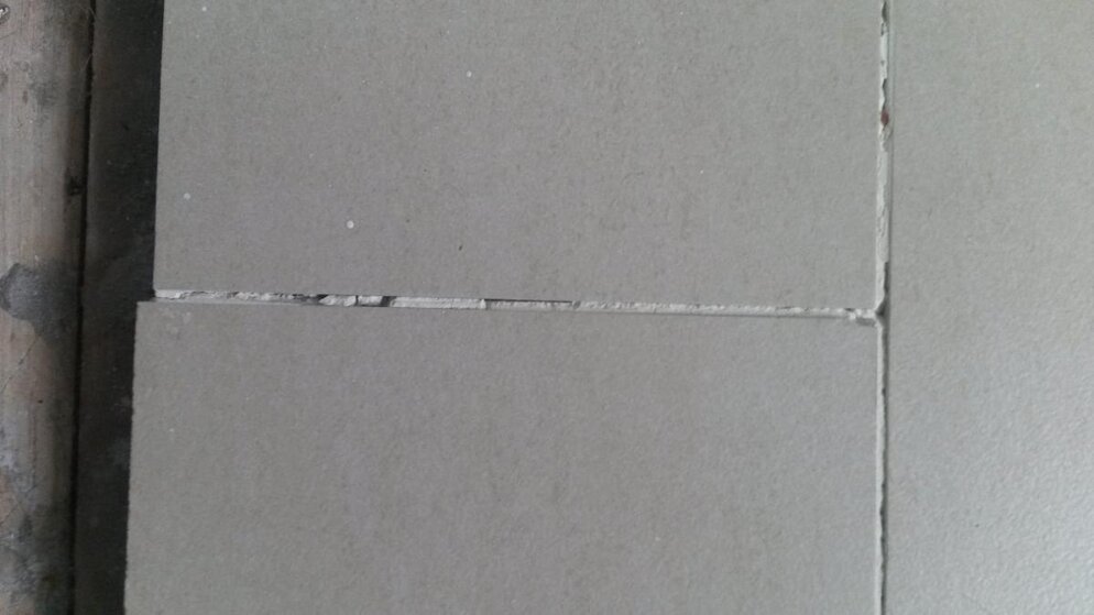

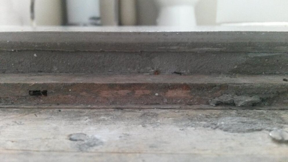

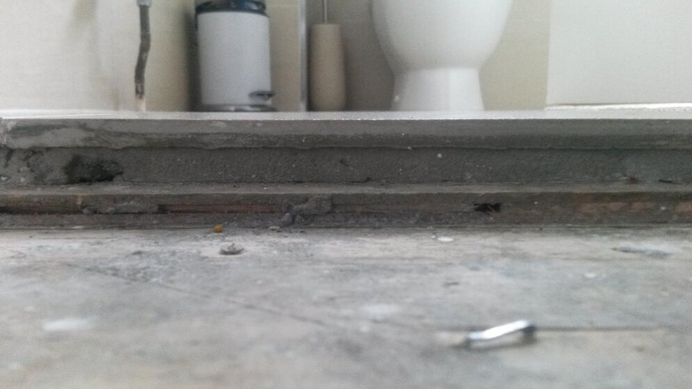

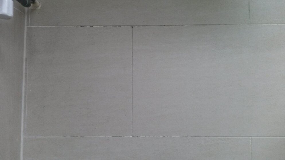

Hi Bex ,from looking at the photos ,regardless of using top grade grout if they did, the tiles look loose ,the best grout in the world wouldn't be able to sort that,so what you have too look at is getting the lot taken up and redone properly, re-grouting is not going to sort out the problem.
Who done the prep work ? the builder or the tiler ? or where they one in the same?.
Unfortunately it appears there is no quick fix am afraid.

The thing is bex is the fact that they done all the work so he is responsible for prep, he cant blame the substrate as it was his job to make sure it was sound before he tiled it, dont let him fob you off,i'll guarantee if you put a suction cup on one of those floor tiles they will lift straight out as it appears the grout is the only thing holding them in place,where in the uk are you am sure one of the lads off the forum local too you ,would pop round and give you advice.
