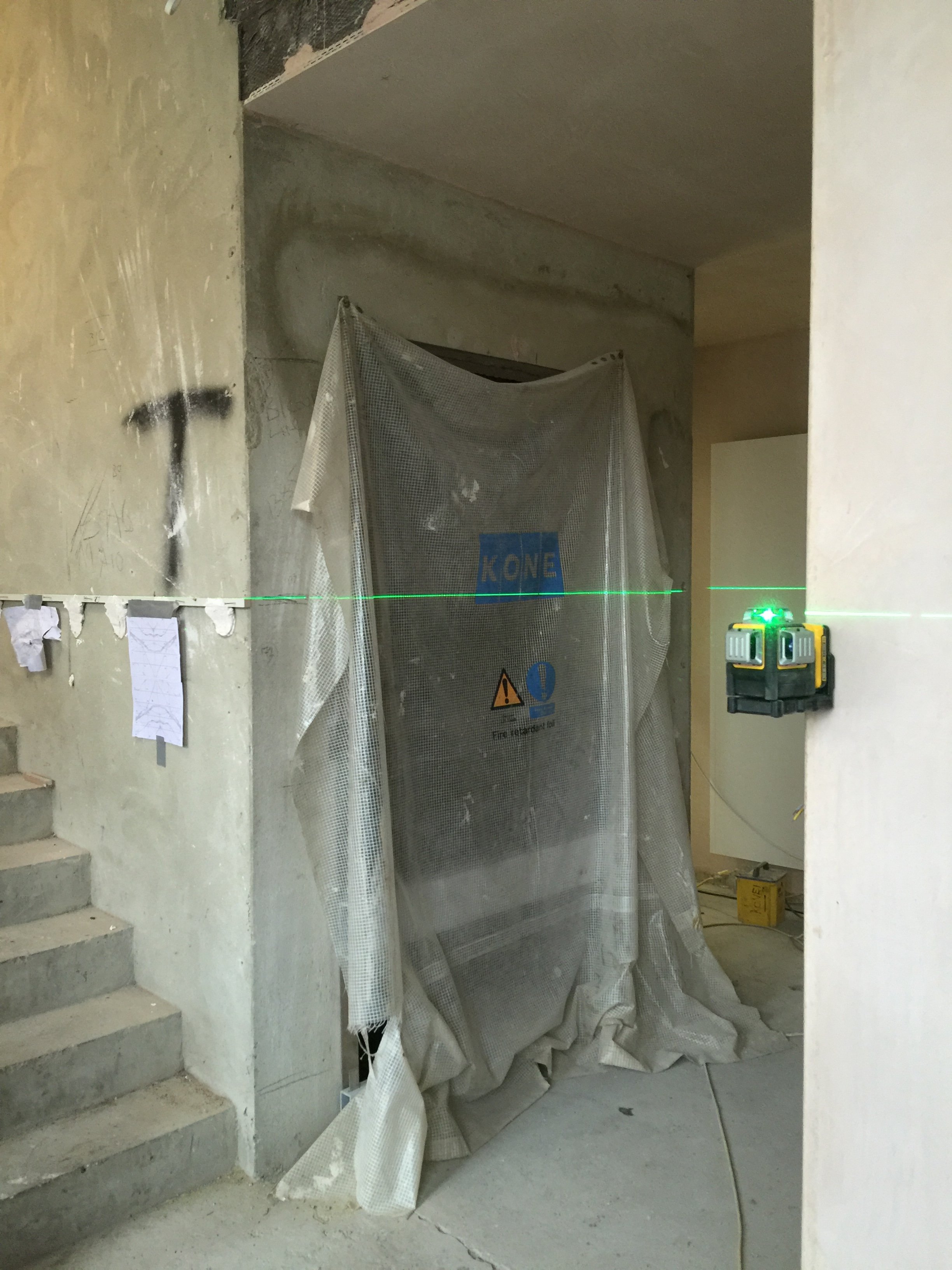

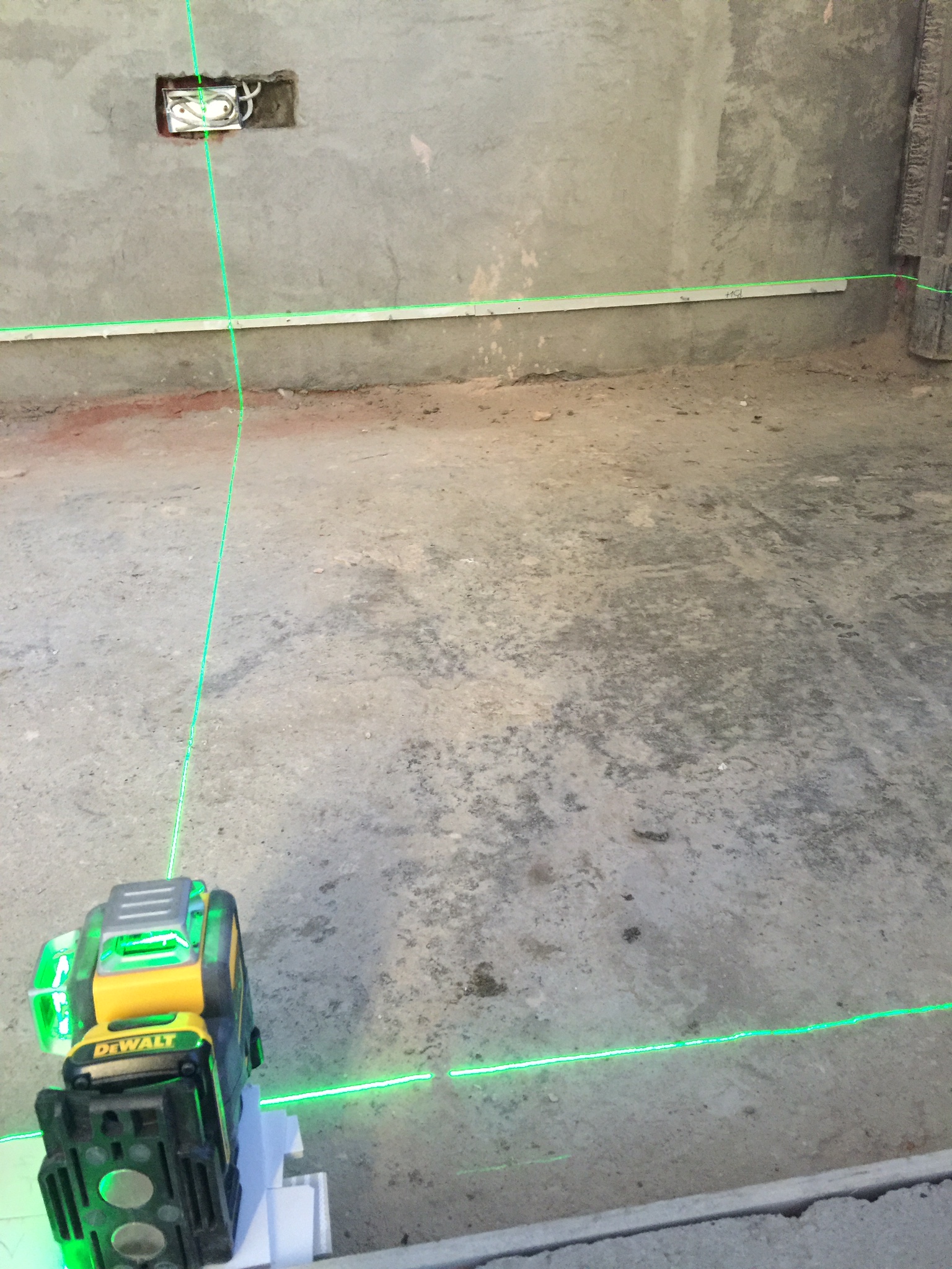

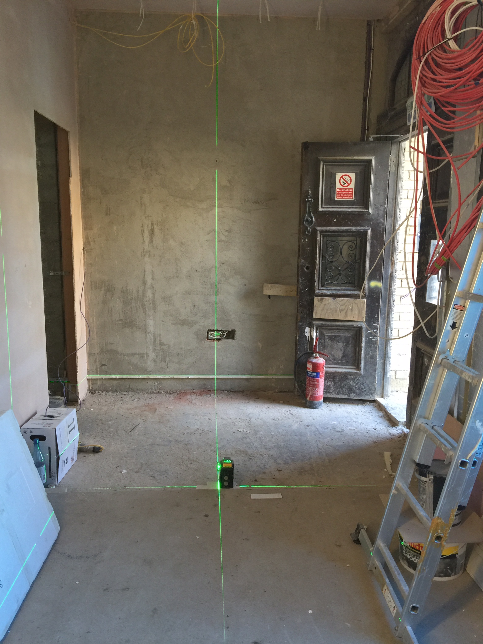

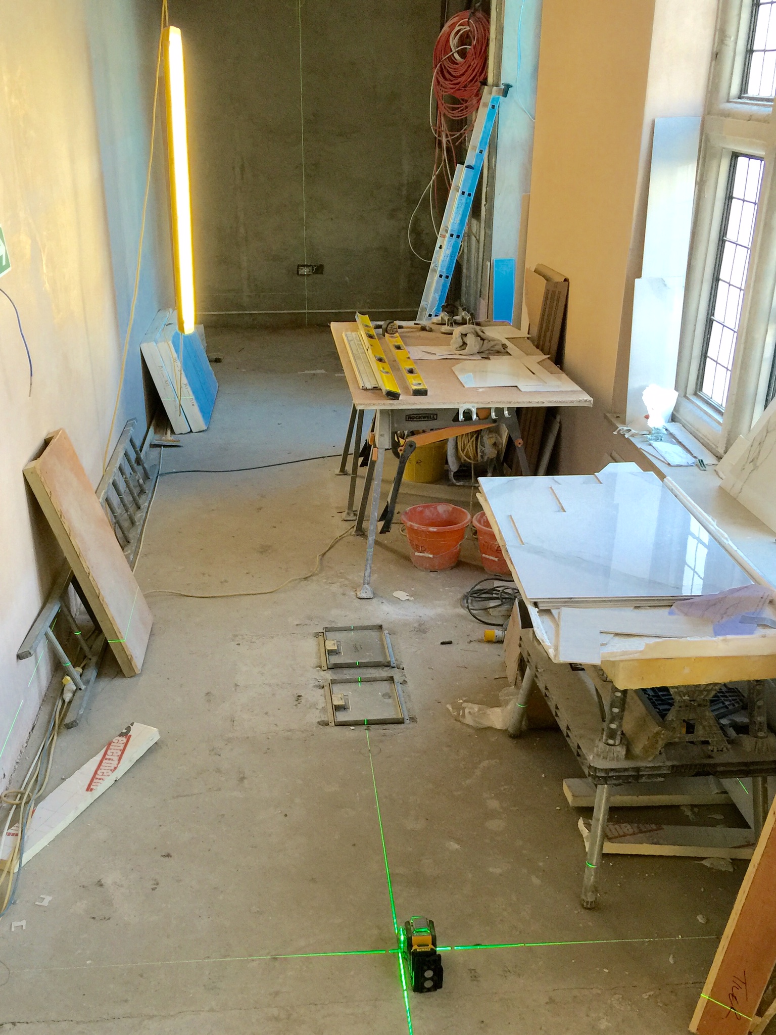

I have one and I love it, but I haven’t needed to use it at 30m. Perhaps 10m is the furthest and it was fine for that. It’s so versatile.
Worth the £400 plus then mate? If you was using in an average size bathroom what’s the green beam like for thickness?
BB2ED6B4-2A19-4662-A926-1920322F0821.jpeg 135A7477-D1A1-4BD9-875F-3A1CEA7C9DE6.jpeg CCAD8952-01B7-41C6-8A30-0A31E4ABD626.jpeg 608BC9CC-557F-4B10-8055-C1F9E58AA1B2.jpeg B0BB71B9-72B4-496F-B1B4-5A09D09D0855.jpeg 6E100B85-7FE8-4463-A249-798D0121B5D0.jpeg FA1F70EB-3BEC-48DC-8370-E7FBBF99276E.jpeg
