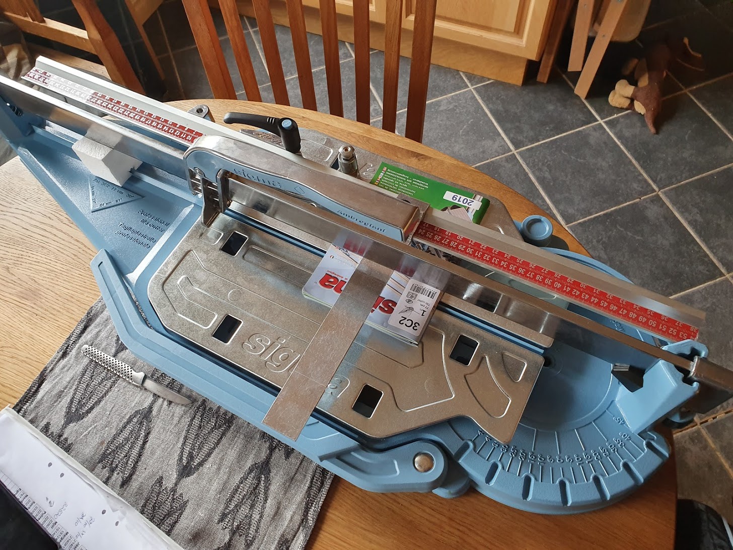

Just wanted to thank everyone for the help in deciding. Thought I would post what I ended up getting for future thread/readers etc.
In the end I went to the store to get a new one and after some deciding back and fourth I went with the Sigma 3C2. Both the Sigma and Montolit seemed about as good as the other.
One of the things that decided was the availability of spare parts. Here in sweden at least, it seems much easier to get Sigma parts and it is far more common.
The last straw was that all the scoring wheels was stolen on the 2 montolit tile cutters they had left in the store. Due to the quick release function of the wheel some must have taken the opportunity to quickly and tool-less remove them and put them in their pocket... So then I would have had to buy a spare wheel online from another store. So that made the choice easy.
