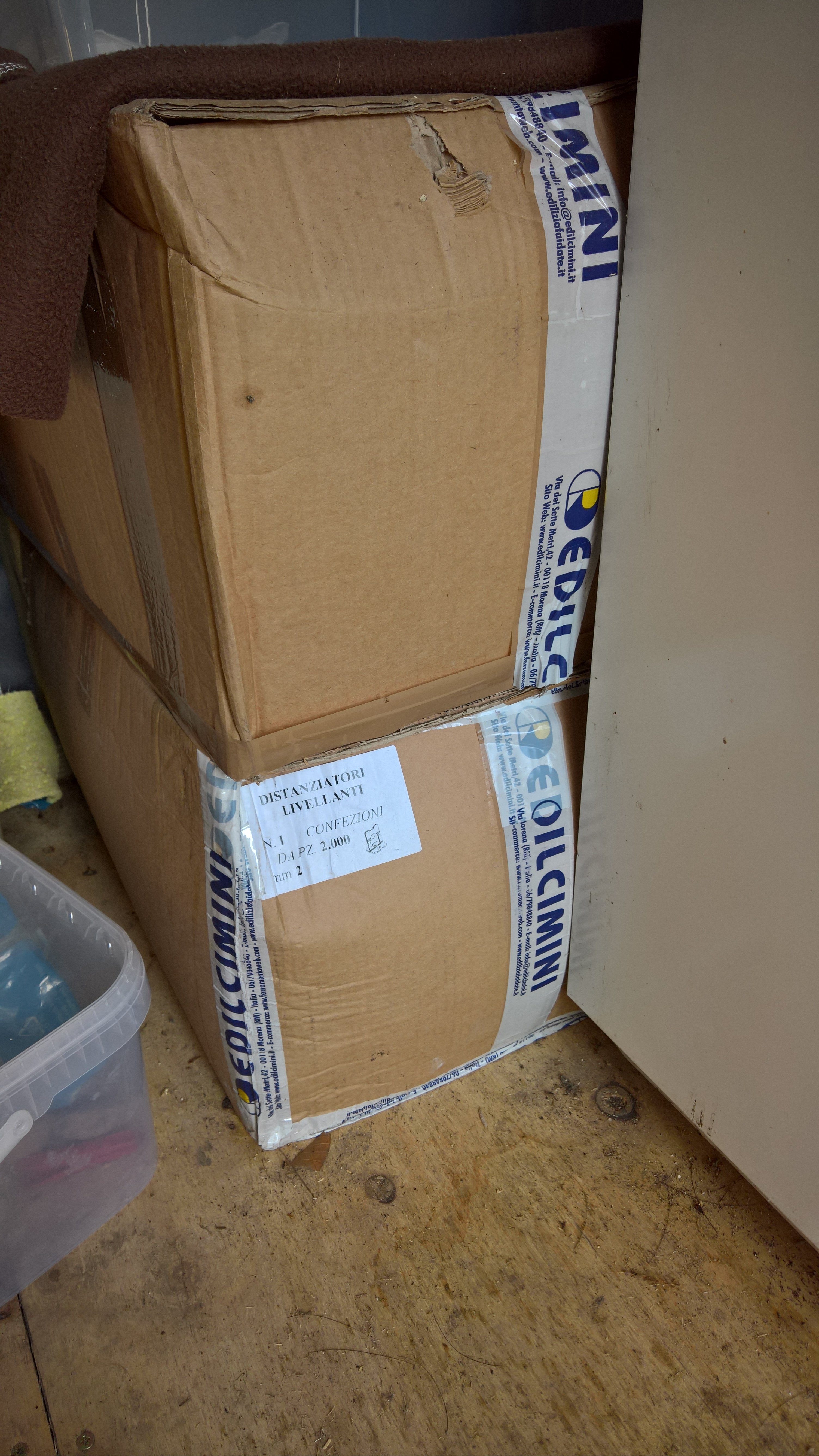

Where are you guys getting clips from now after @JulianSidney bought all the ferramenta ones?
I'm still fine thanks, may be my fault though:( recommended them to some lads at my local ctd, think they all bought some, sorry :)
J
J Sid
that's service.....
