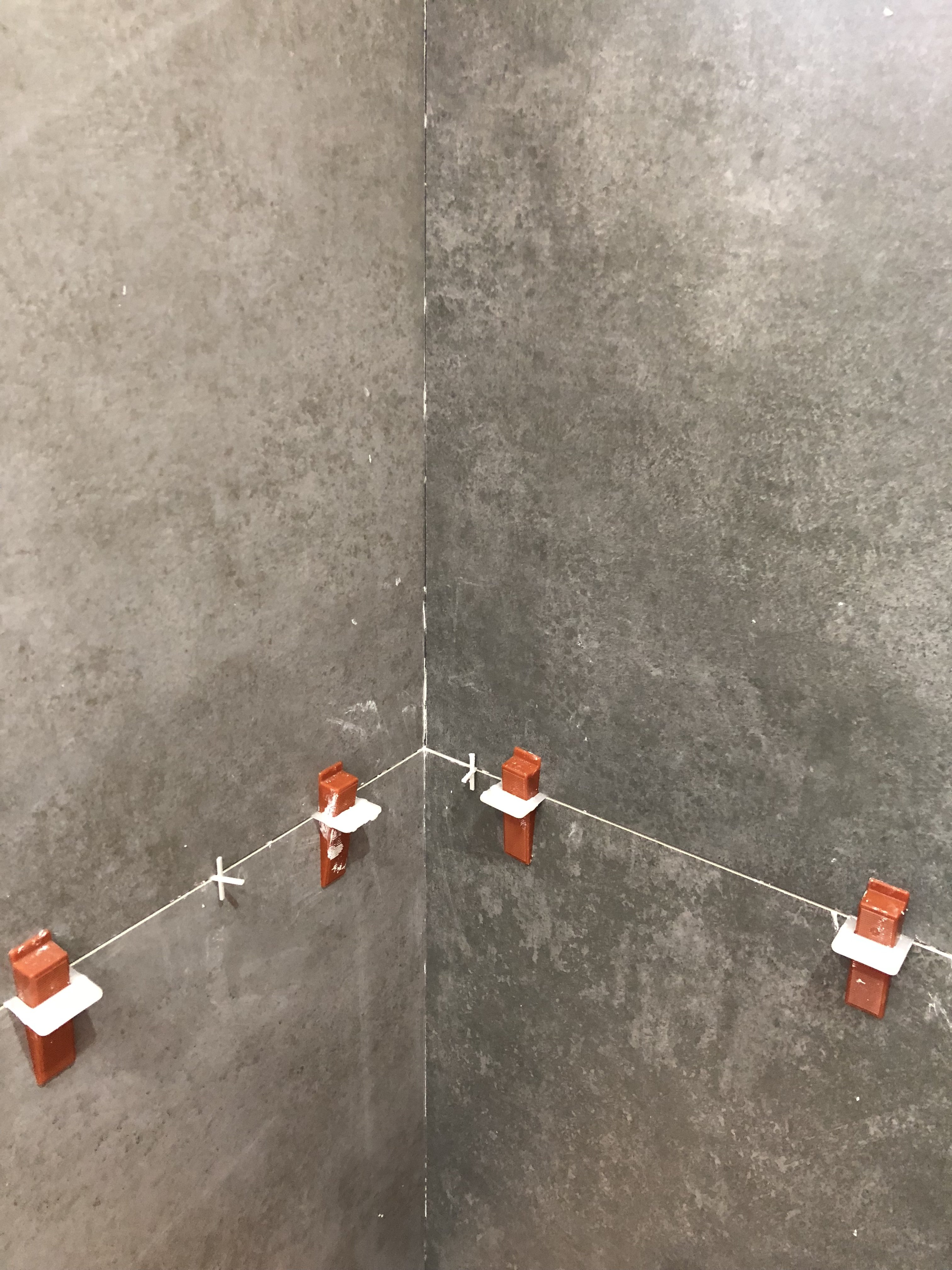

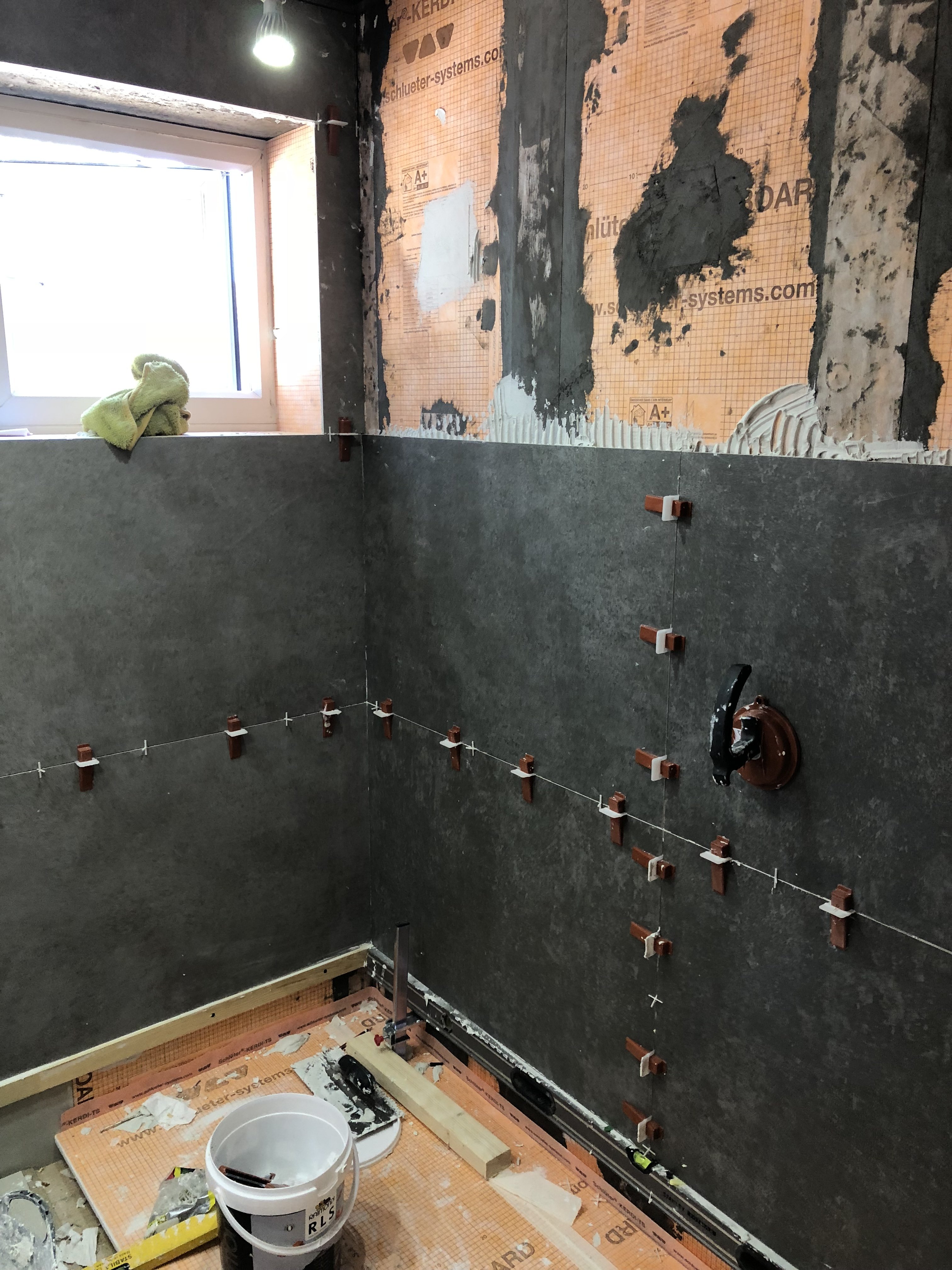

Getting there 😀
John..
Good work 🙂
Make sure you clip those speedfit pipes down so they dont bang around under sudden pressure changes. If that happens when its all boarded & tiled it will drive you mad!
