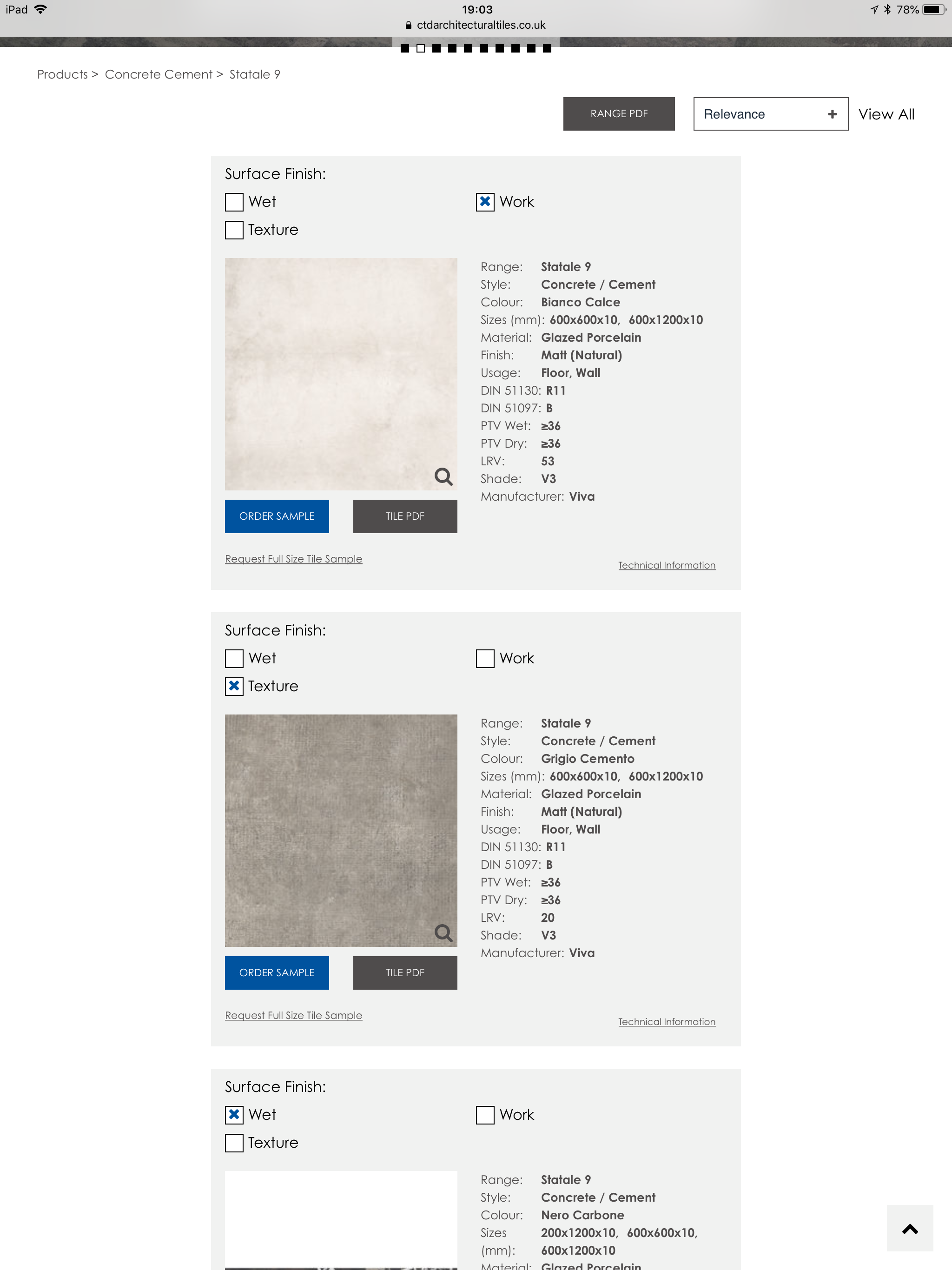

There was only 2 company’s I could find that supplied the concrete panels. One sent samples but said they can’t be used in wet areas. The other company said there’s can, but didn’t bother sending samples🙁
I can’t start tiling yet as I’m still waiting for the vanity unit to arrive, then hopefully I will have samples for the Porcel-thin tiles.
