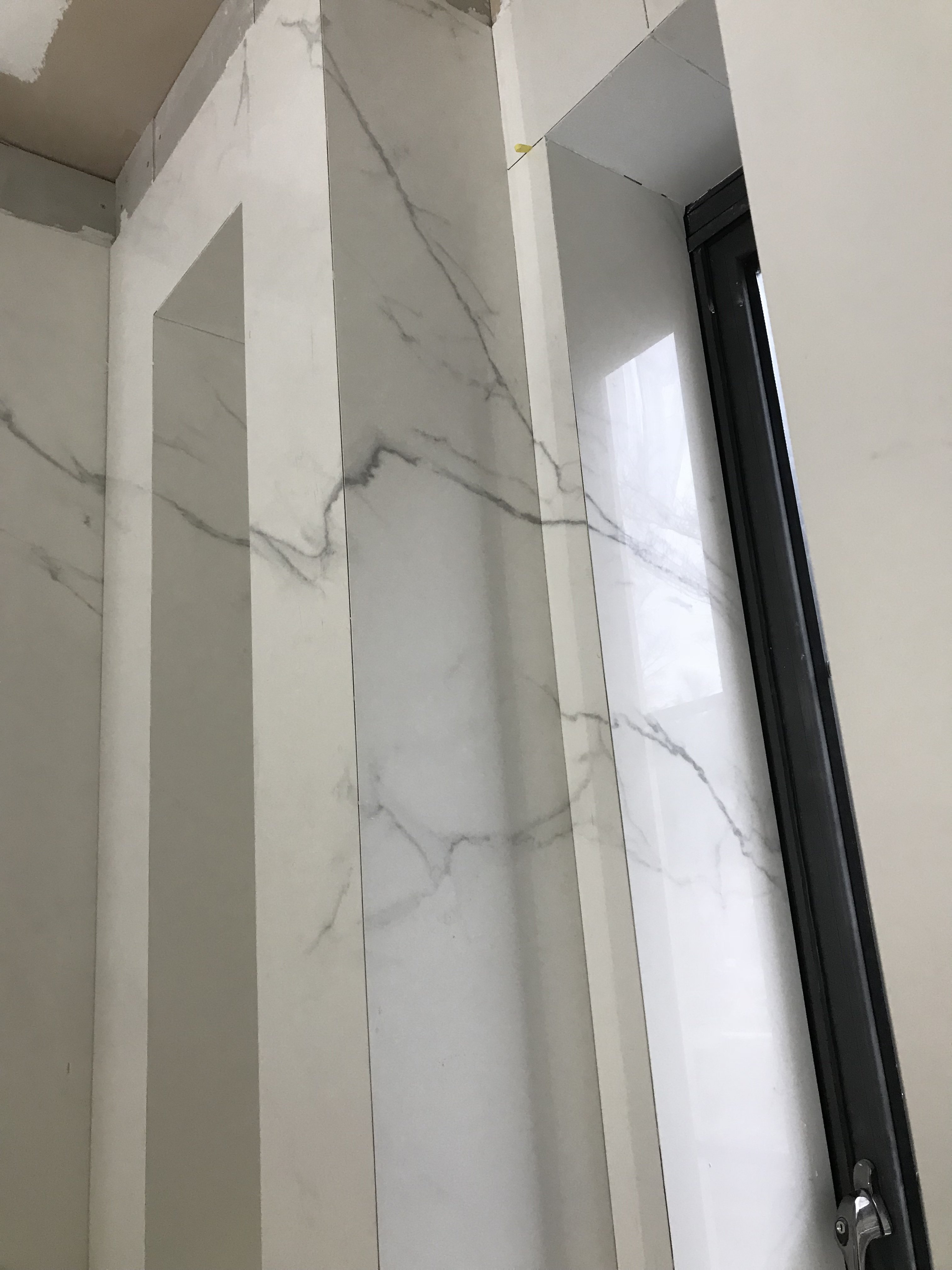

This is what I do on a day to day basis.
C4F1BEDB-56A9-4A5F-807C-61A4068B4C7D.jpeg B5B0103A-F557-488A-A095-3CF2D40C82BE.jpeg
