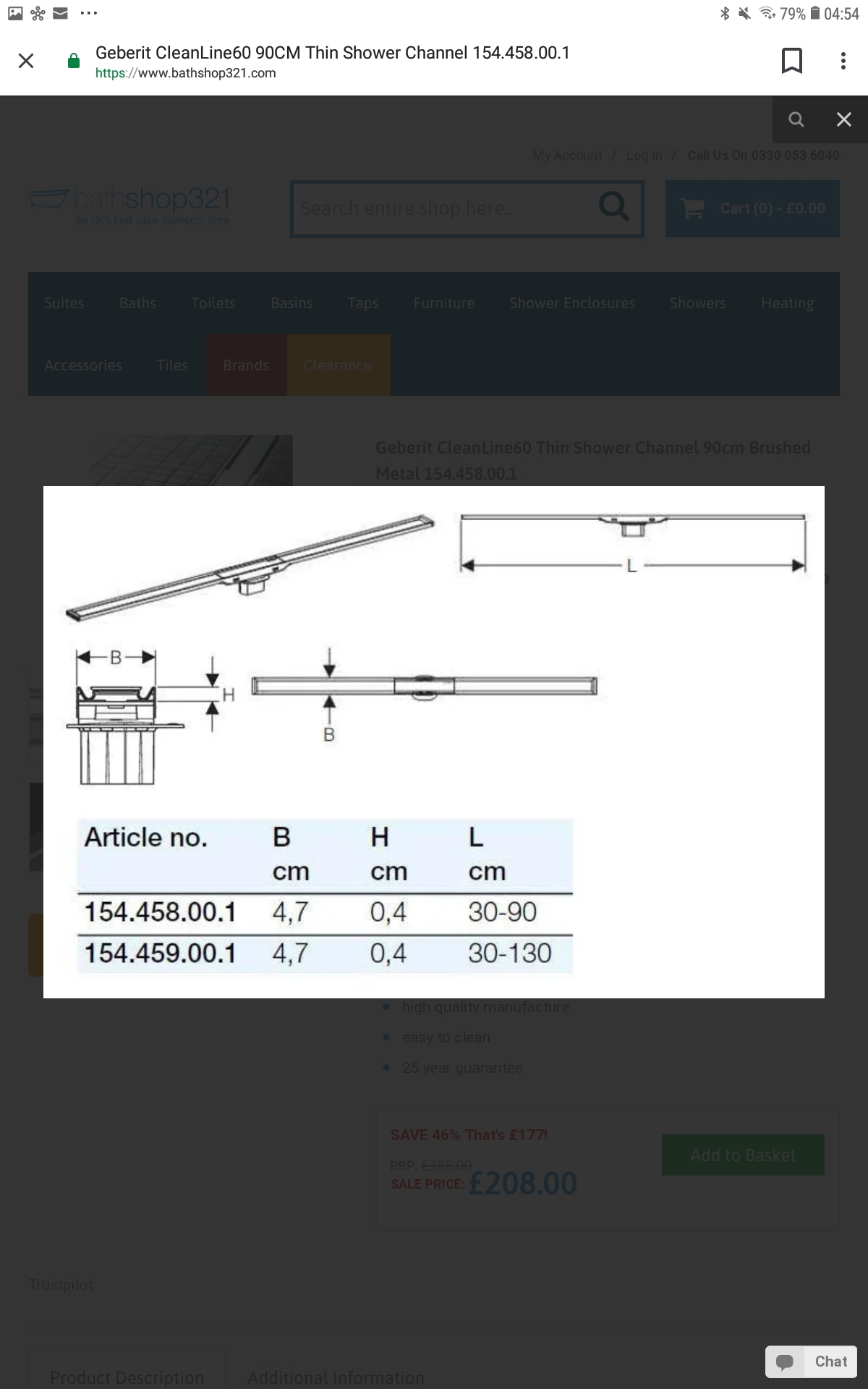

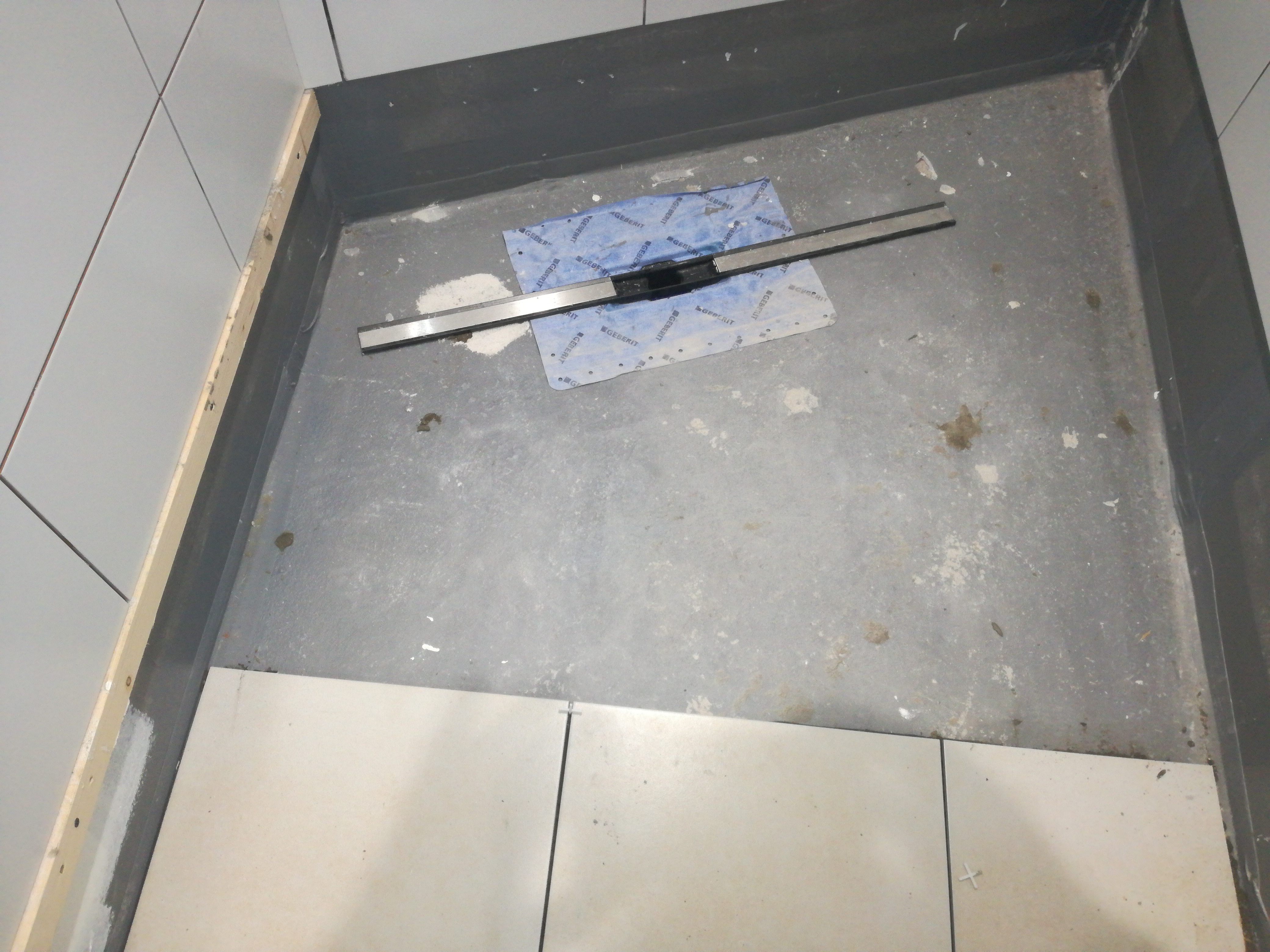

Membrane is not stuck yet but the drain is causing problems as is not centreFirst impressions it doesn't look great but its tanked and maybe it is right but you really need to look up the geberit system and do some research . That membrane looks like it could be stuck better and maybe the drain height may need altering .
Thanks for the reply jrctiling , its gonna be a great FridayI've done loads of drains that are not where I want them for one reason or another . Customers choice if it can be moved do they want the delay or you just tile it .
Not going to look pretty but its a bit late to alter it now surley would of been better use a different gully and cut the tiles to fall to it rather than use a linear just my opinion . Kop
Its the most unusual and challenging piece of crap I've had to deal with in a long time.It would appear looking at it and the sequencing that the drain finishing unit is a interference fit, i.e that the wetbase and waterproof cloth patch do the work and the drain slides into a o-ring system, check this out to see. It is a strange type drain though. Ask the supplier for a square grate to improve the look. Personal choice but it just looks wrong from here. Back away its a trap spring to mind.

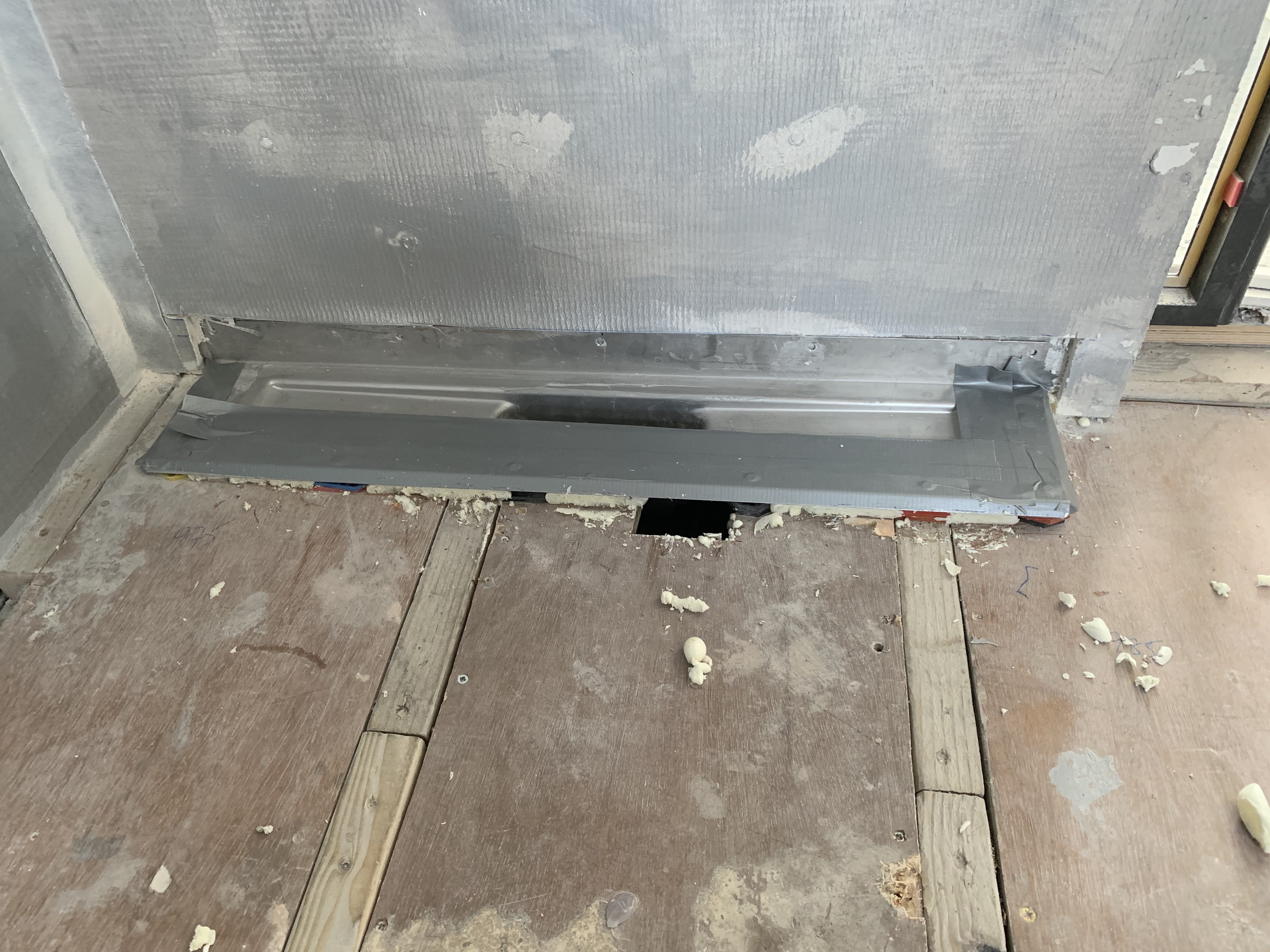

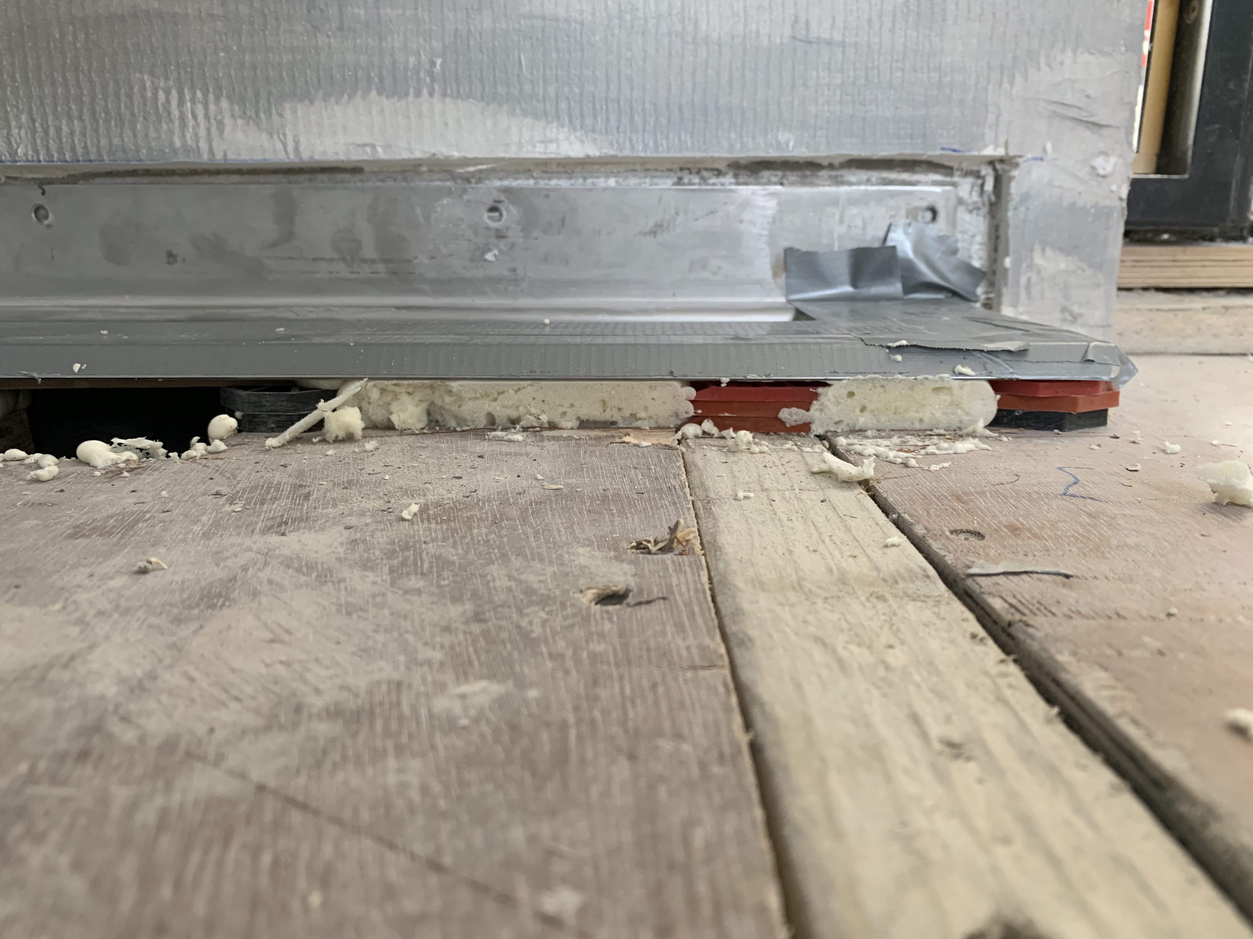

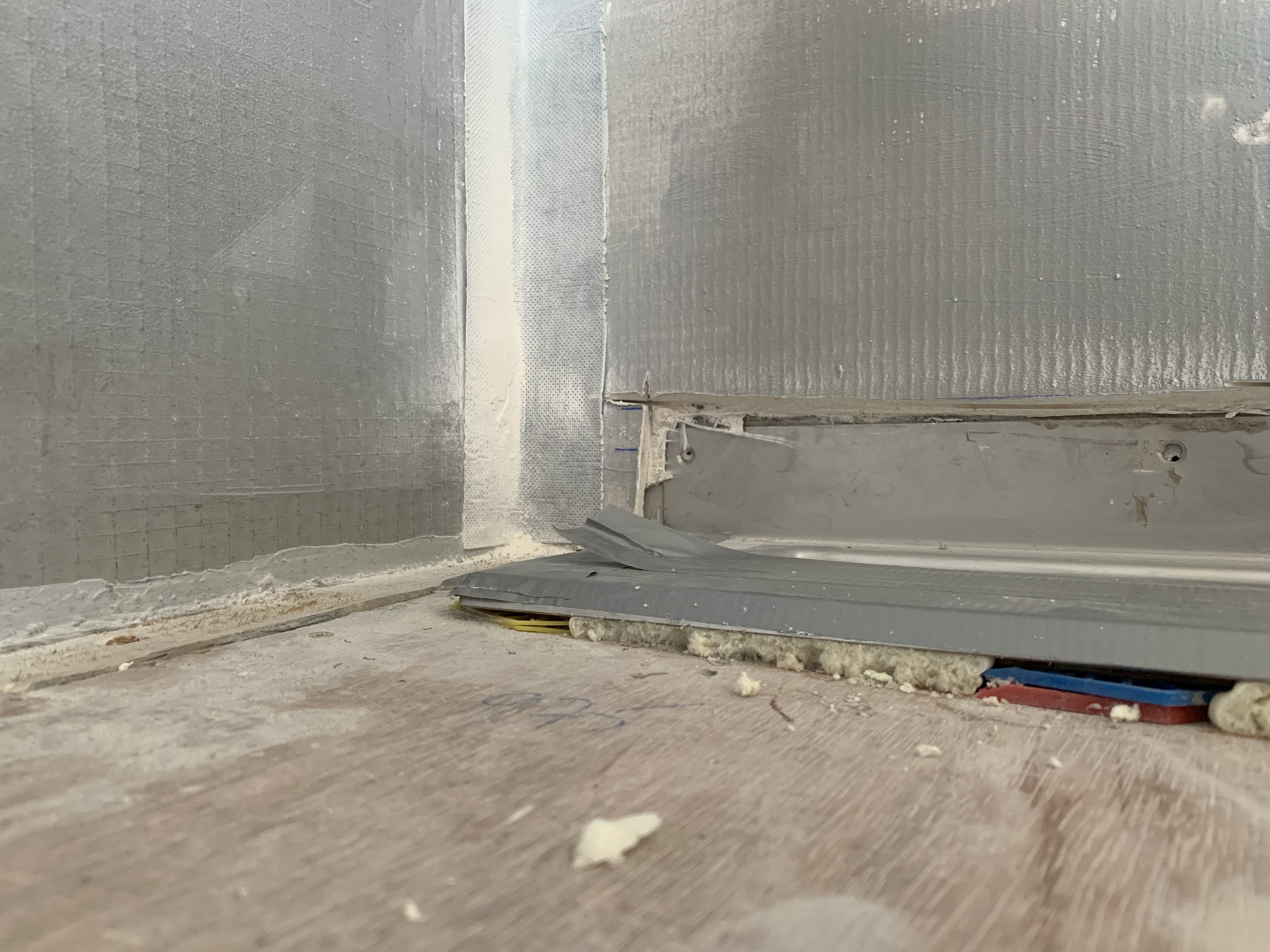

Customer is happy with a couple of envelope cut but ill need a lot of themYou think you got problems? 😀
And this is supposed to be for thin tile haha
View attachment 107262View attachment 107263View attachment 107264
And you can’t do your shower without envelope cuts.
Not possible.
Unless it’s mosaic, or gulley goes full width.
Well at least you can take it out and fix itYou think you got problems? 😀
Not possible.
