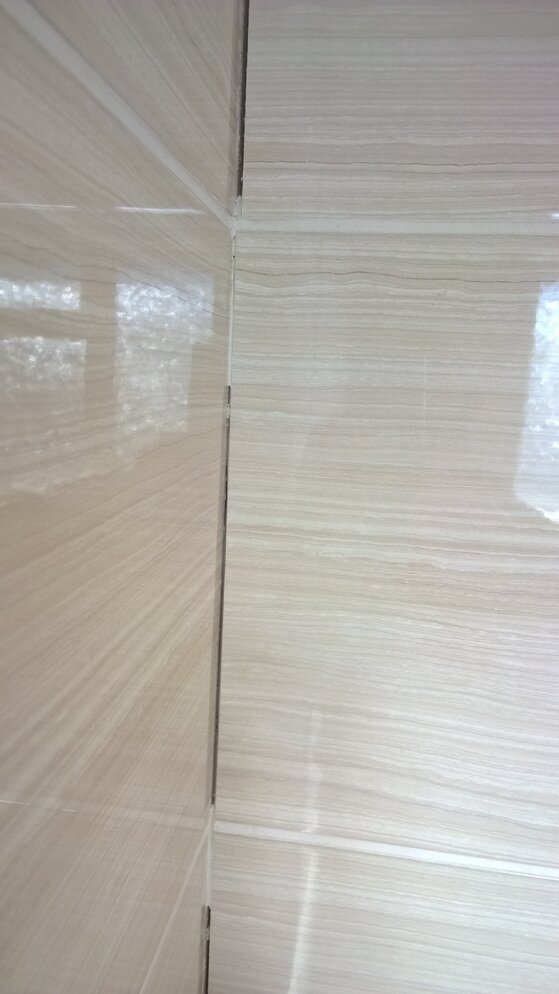

I hate to add more fuel to the fire too... but in my other bathroom it's grouted into the corners and has cracked (I didn't tile this one). See pic.
