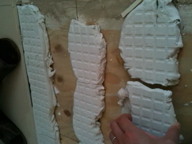

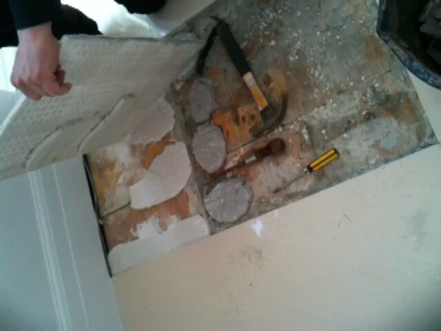

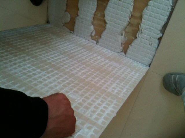

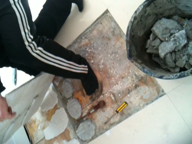

Doug, when they fixed a row of 8 tiles last month we only lost one tile - the one they had to crack. With the rest, the adhesive did NOT stick to the back of the tiles. No cleaning was required. The adhesive bearly stuck to the plywood either. I just used my hand to gently push it and it came unstuck. No tools required. I captured this on my phone if you would like a look. Did the adhesive dry too fast? We only gave it about a week before the ufh was turned on. The builders told me a couple of day was sufficient. I now know it should have been at least two weeks.

ive a feeling they used dispersion as they are obviously clueless when it comes to tiling:yikes:

Re reading the facts as printed it would seem as though the tiles have not stuck to the plywood. It could be due to the pva adhesive,the adhesive type, dust on floor/back of tile and certainly the dot and dab method of fixing. If it is only 18mm plywood fixed direct to the joists and tiled direct to this - as previously stated - a deflection issue may be the cause. Is there any cracks appearing at 120cm widths or just loose tiles and is the grout cracking out of the joints?

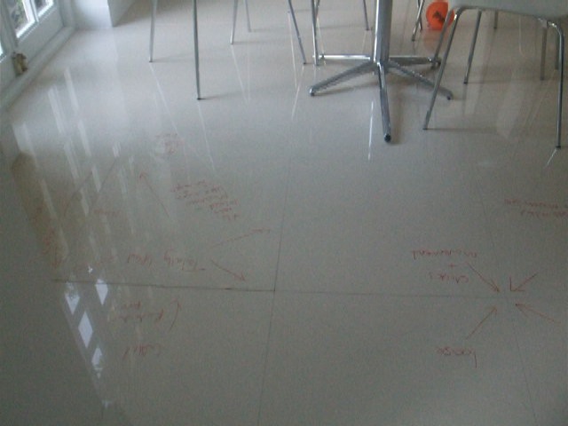

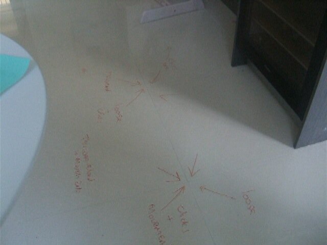

TJ - there are no cracks in the tiles. In many places, the grout has cracked or seem to be stuck to one side only. I DON'T ' think the grout (Mapei utracolor plus) was a flexible one so this is expected given flexing in the floor. In some area its whole groups of tiles together - in others 120-180cms width.
Looking at some pictures, it seems to me the tiles that have lifted the most have been where two sheets of plys meet. It seems to affect the whole row of tile. Tiles adjacent to these are less affected.

Any sign of any pics?

Here are some pics extracted from video clips. They don't really show the gravity of the problem but it gives you an idea. The white adhesive is the original. The grey is their first attempt to fix 2 two tiles back in April. And yes, I could remove the adhesive just by pushing it with my fingers - no tools required.

Hold on tight.....you're about to be besieged with posts expressing complete horror. That's not just shoddy, it's incompetence at it's extreme.
