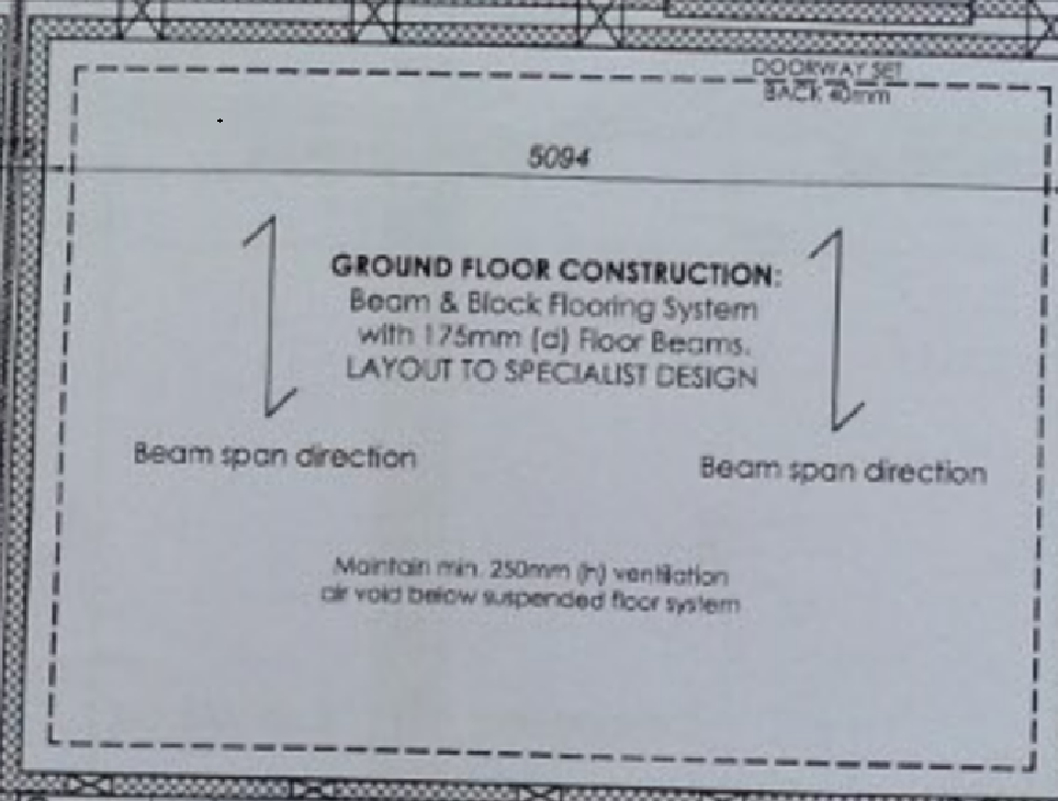

I have an extra question to go with those in my original post. Can I use adhesive directly on top of the concrete (or maybe it is screed) floor?

10 year old house block and beam with cement screed.
Are there any cracks in the sub floor?

Yep, block and beam. And what looks like screed (with no cracks)
