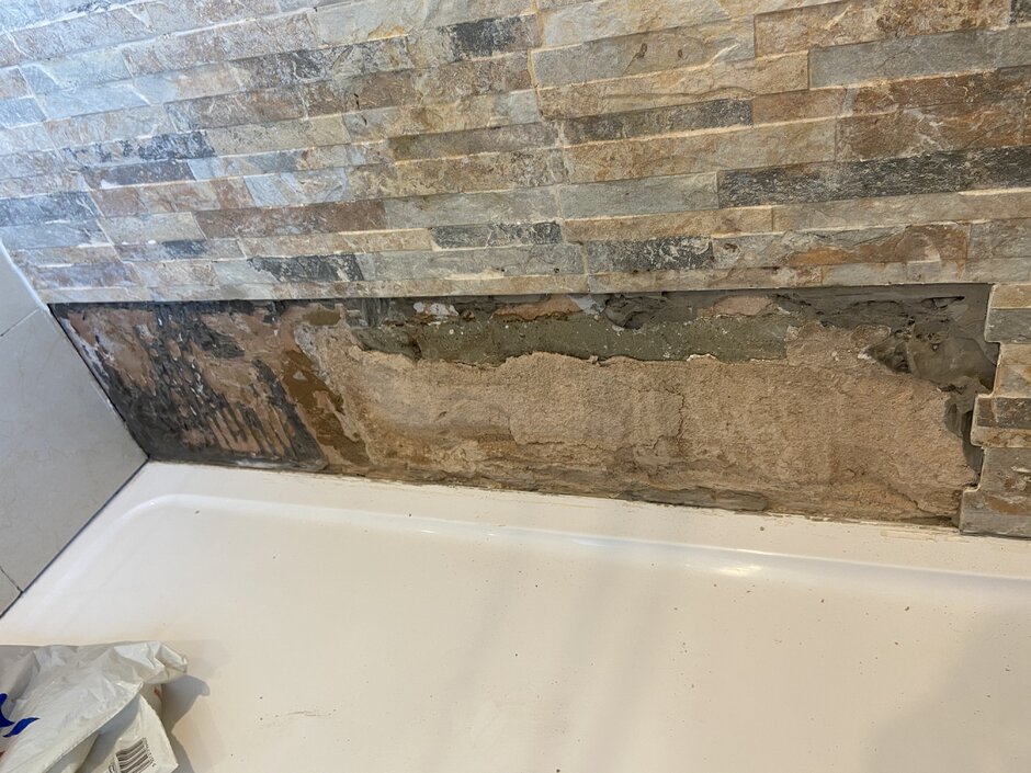

That’s knackered tbh , even got black mould growing, been a lot of water ingress.Hi, a few tiles keep falling off in the shower enclosure.
Any tips on the best material to use to replace the plaster. Pink area in the middle.
Thinking sand and cement (4/1 parts) or aquapanel piece screwed in.
