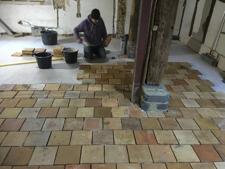

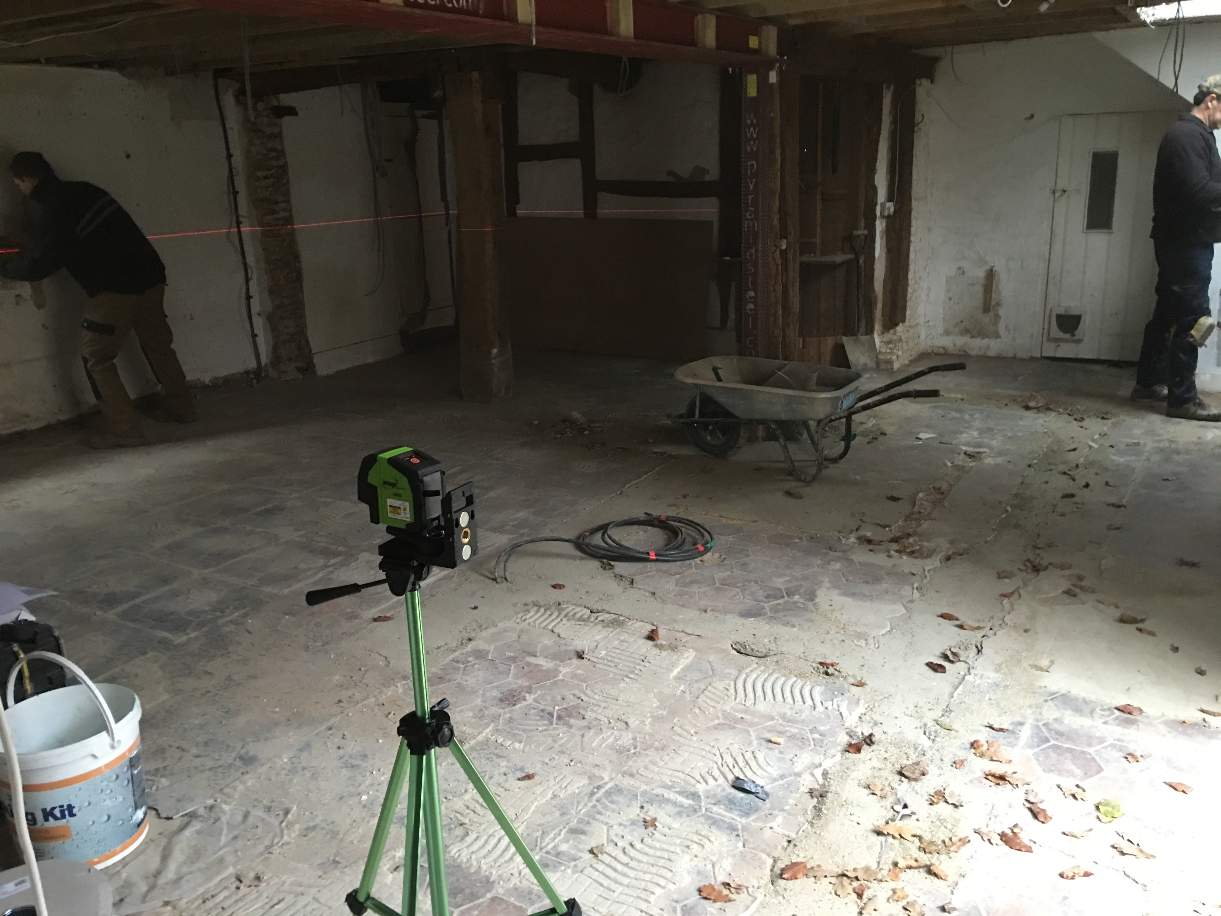

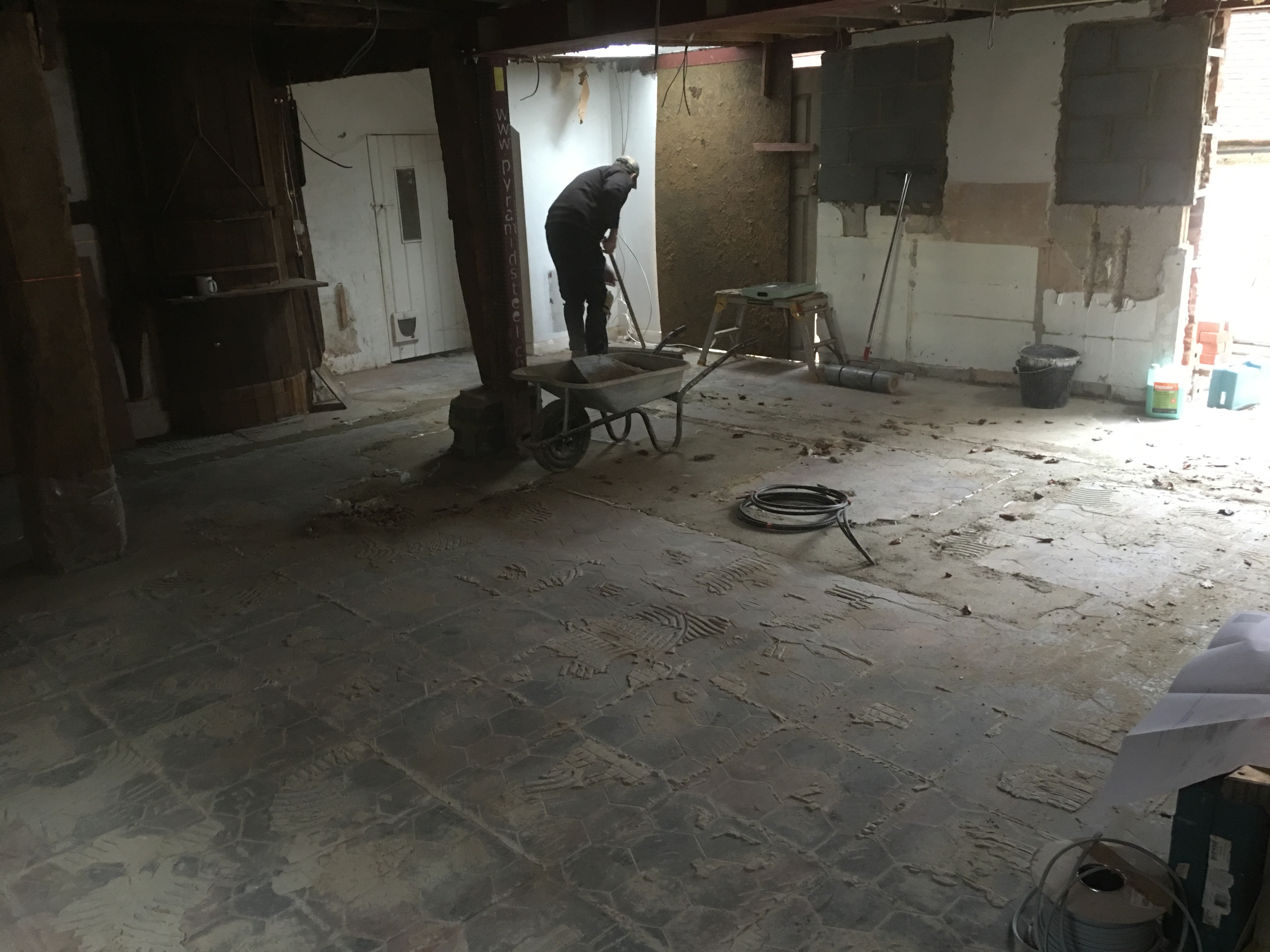

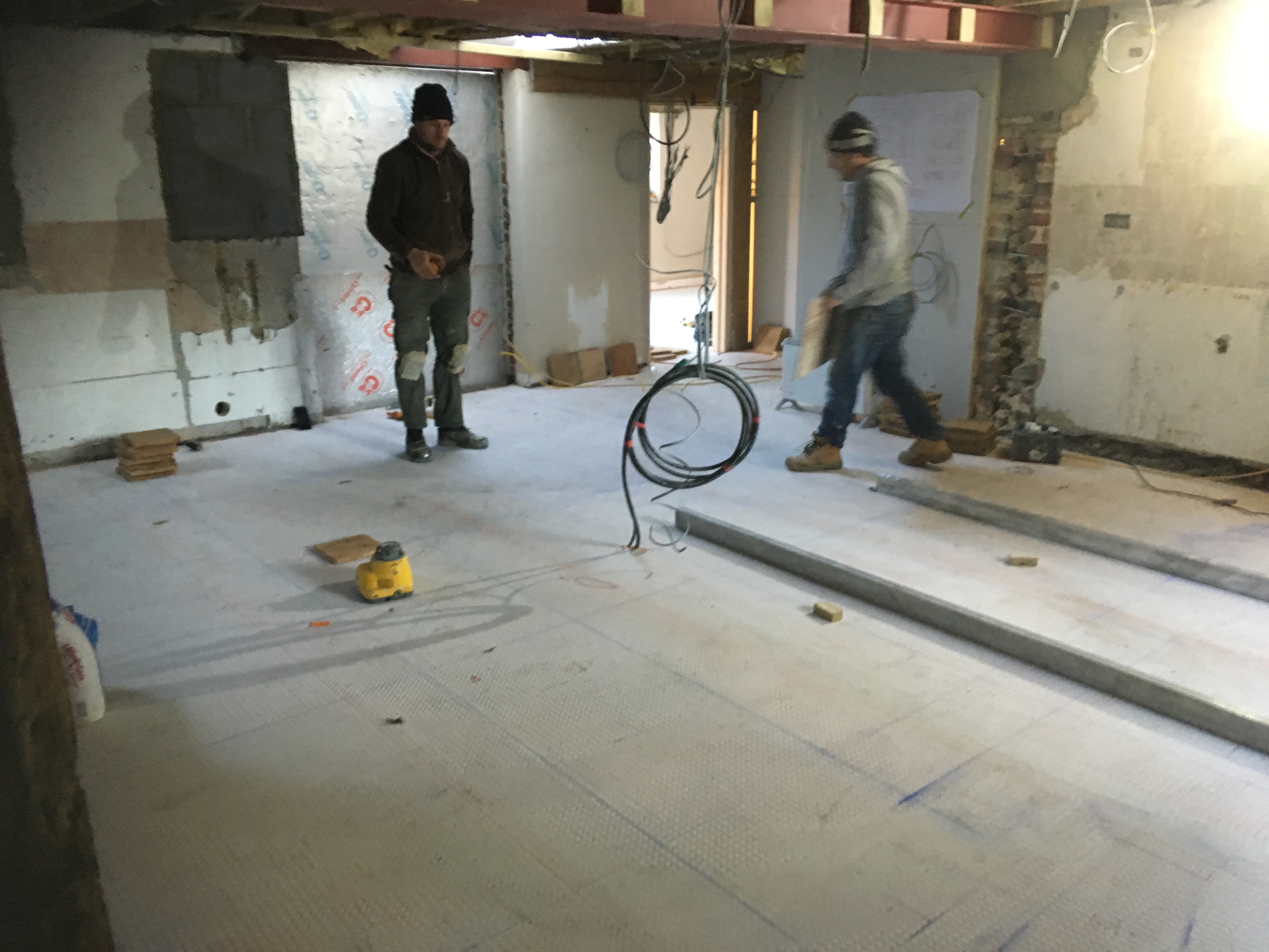

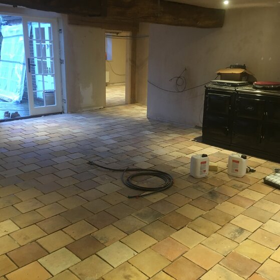

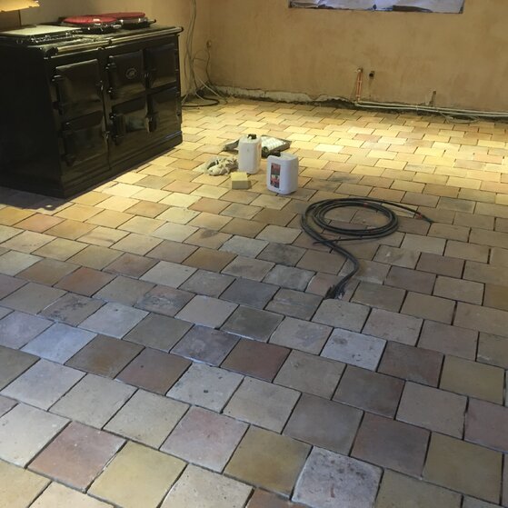

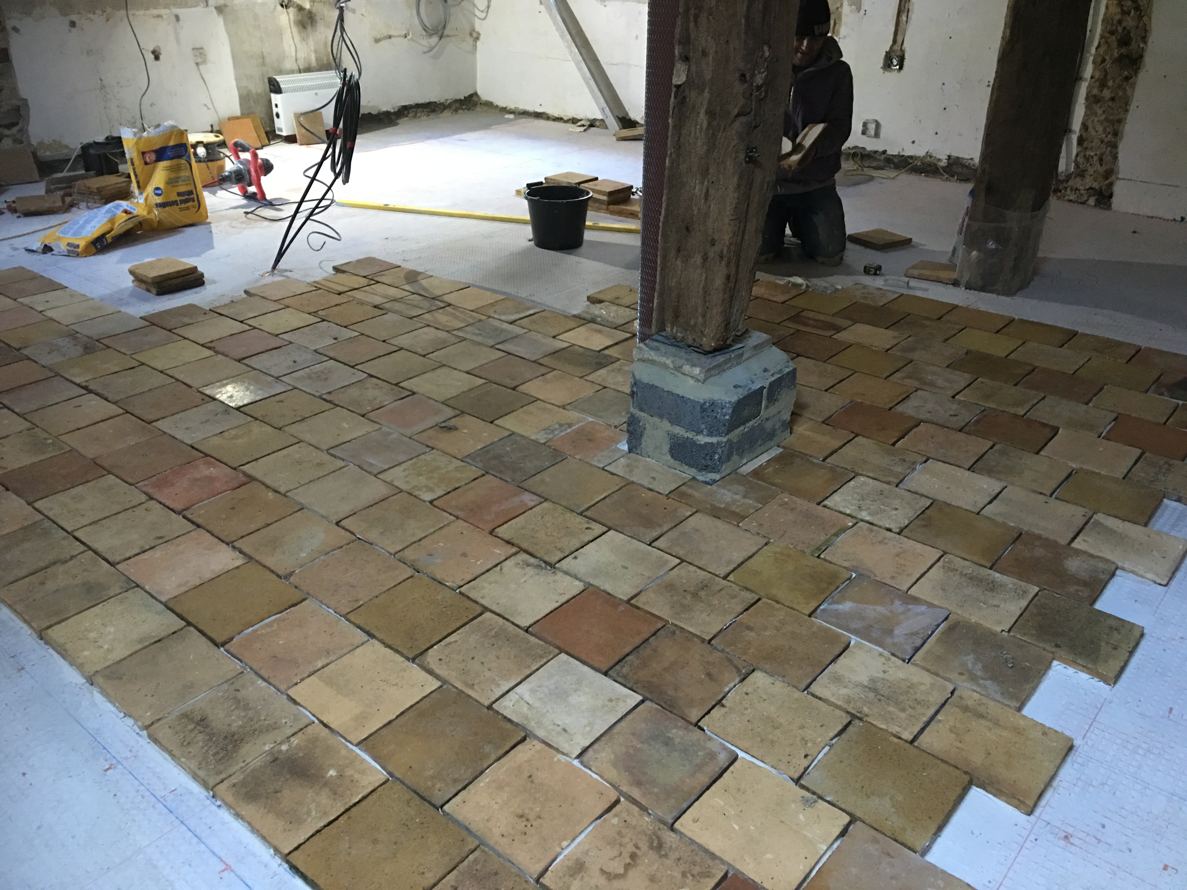

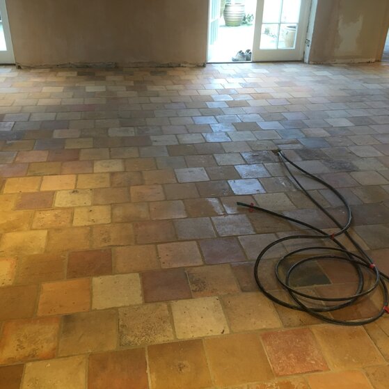

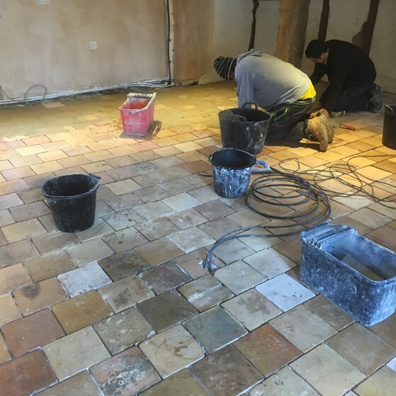

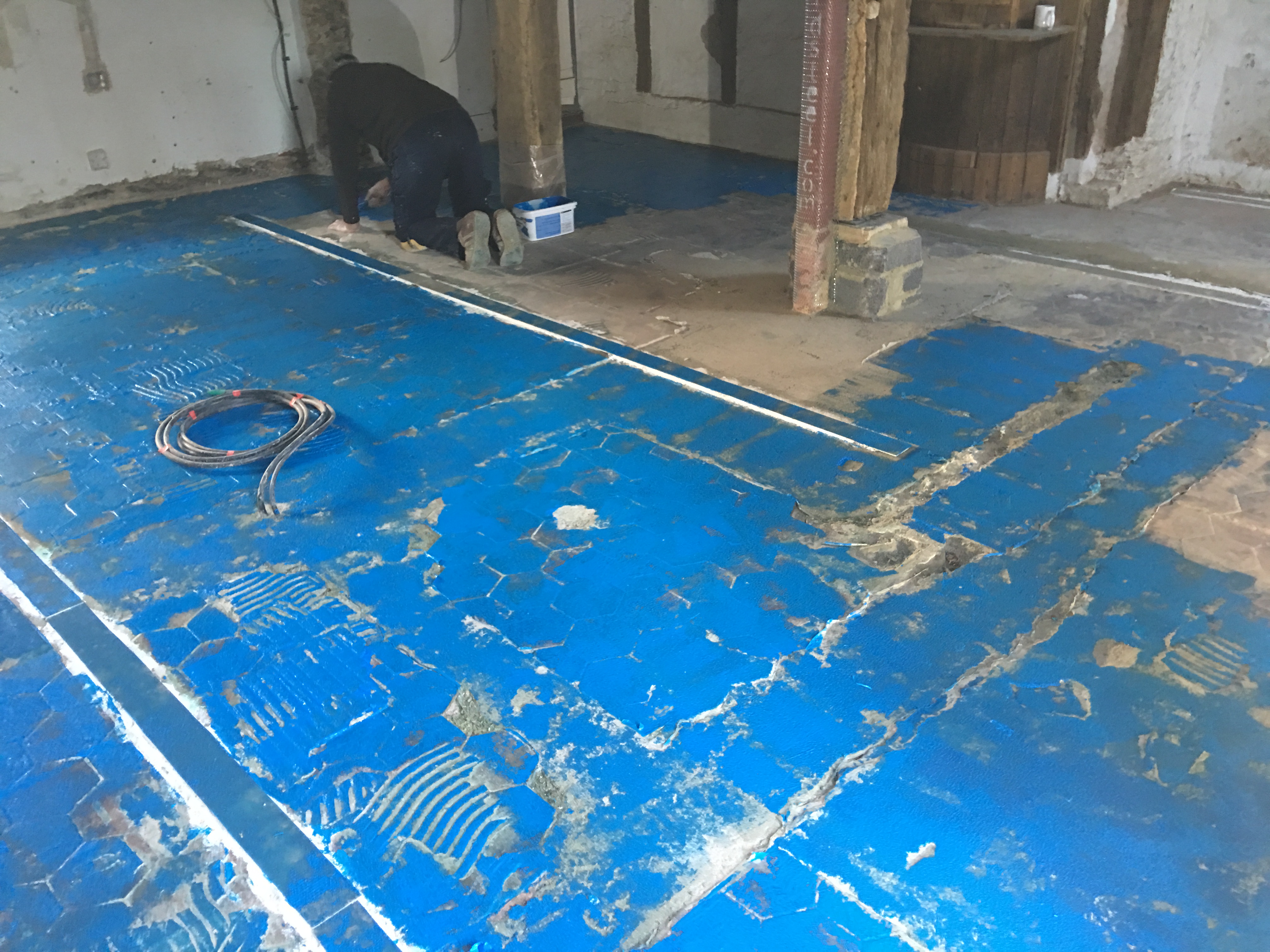

nice to get back on a reclaimed terracotta job . This is only the second we've done in last ten years . Used to do heaps of them .very uneven subfloor .laid strips of dukkaboard and levelled between . Tiles between 205 to 220mm . 2 days to sort out tile sizes and colour ratios but starting to take shape ,

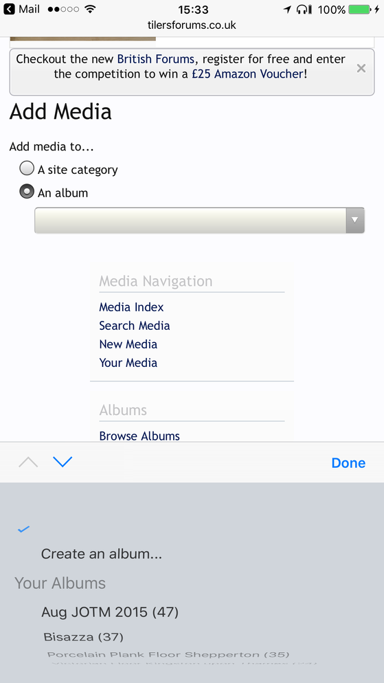

how can i add photos of jobs to my albums so members can see if they want to. i posted in forum arms yesterday coz i couldnt work out how to add to albums. got a few interesting projects to show that may be of interest to like minded tilers !! if you are one id wager you are unqualified like me !!!!!!
Click your avatar Jonny and when the pop up loads click your 'albums page'
When it reloads, top right 'add media'
When it reloads you'll see a drop down box with a selection box next to it.
Make sure 'an album' is highlighted and click the drop down box and choose 'create album'
Follow prompts Jonny, you'll manage easily from there mate.
Don't forget to 'save media' at the end.
You can create as many albums as you like or put all your images in one.

i just uploaded a load of photos of a reclaimed job and tried to save but not sure if i have . cant find it now !
