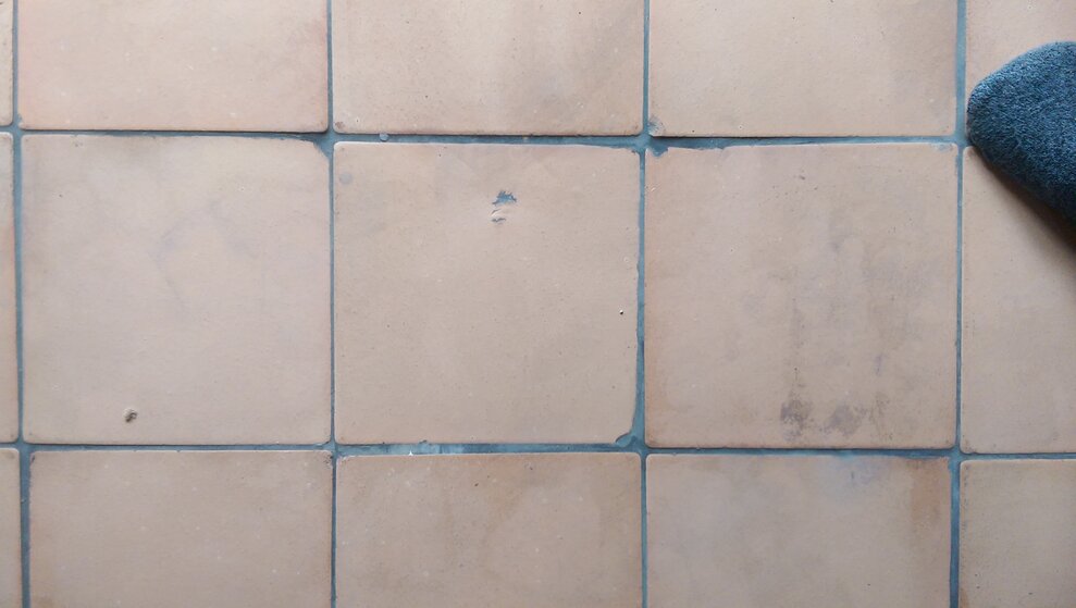

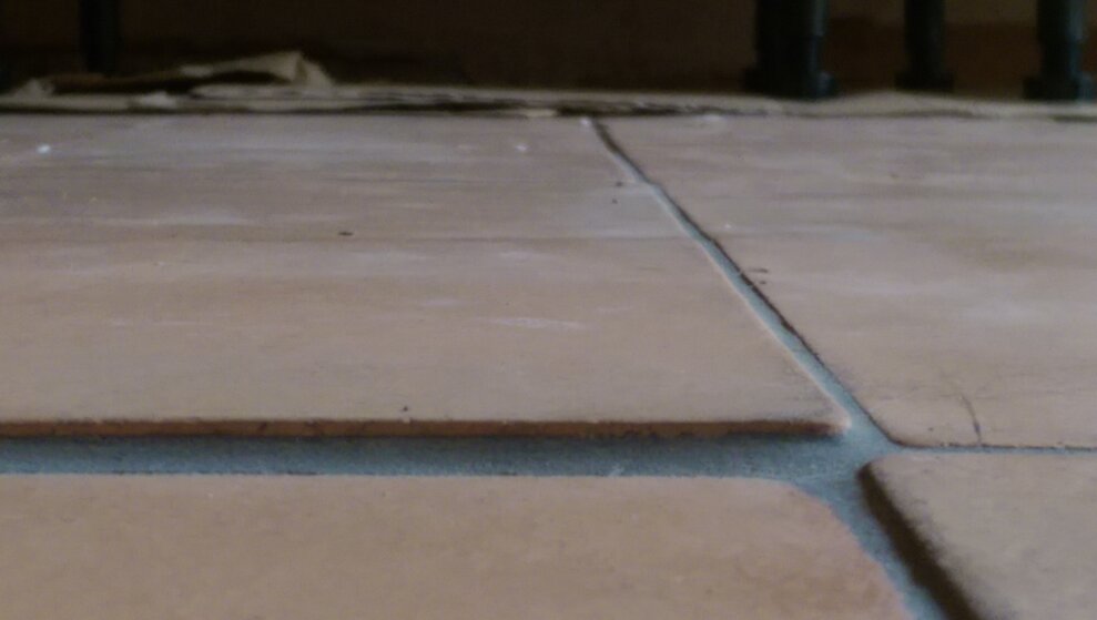

Apparently this tiler thought this was an acceptable way to leave a customers bathroom.
When she complained to him, he said it was a problem with the tile as it wasn't flat (I know, I laughed too) and wasn't his fault the grout was stuck to the face. He never came back to clean it, but she still gave in and paid him the full amount.
LTP Grout Stain Remover and White E-Pad sent, SORTED!

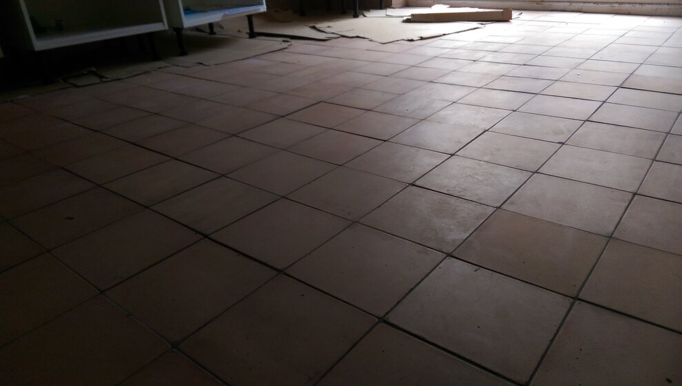

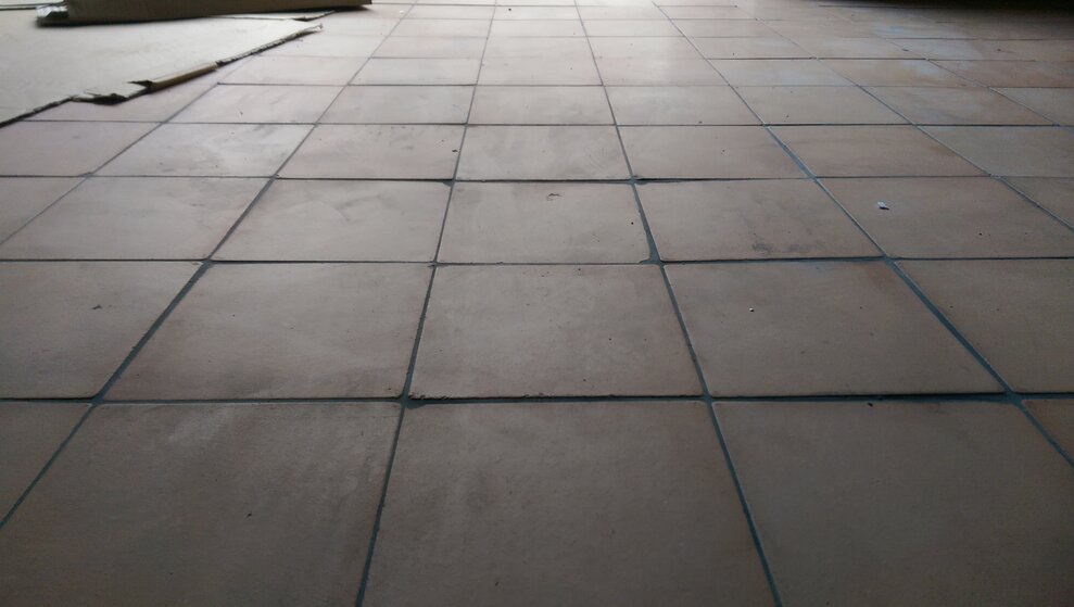

What's next course of action?
Builder forks out to do it again i suppose, but waiting to hear back from them. He tried saying the tiles were out of shape. We checked. As far as Terracotta goes, they're almost perfect. actually better than alot of ceramics i've seen.
Customer has said that the floor was never levelled after the previous ones were "Kango'd" up. I've asked her to send some more pictures when they get lifted
Bless 'em.

What makes me laugh but annoyed at the same time is whoevers' done these shambles think they'll get away with it and no-one will notice!
They were put down in 2008, customer bought the house last March, I found the house on Zoopla and they paid 950k for it, there is approx 300 m2 of tiling all fitted like this, it's only a matter of time before it all fails.

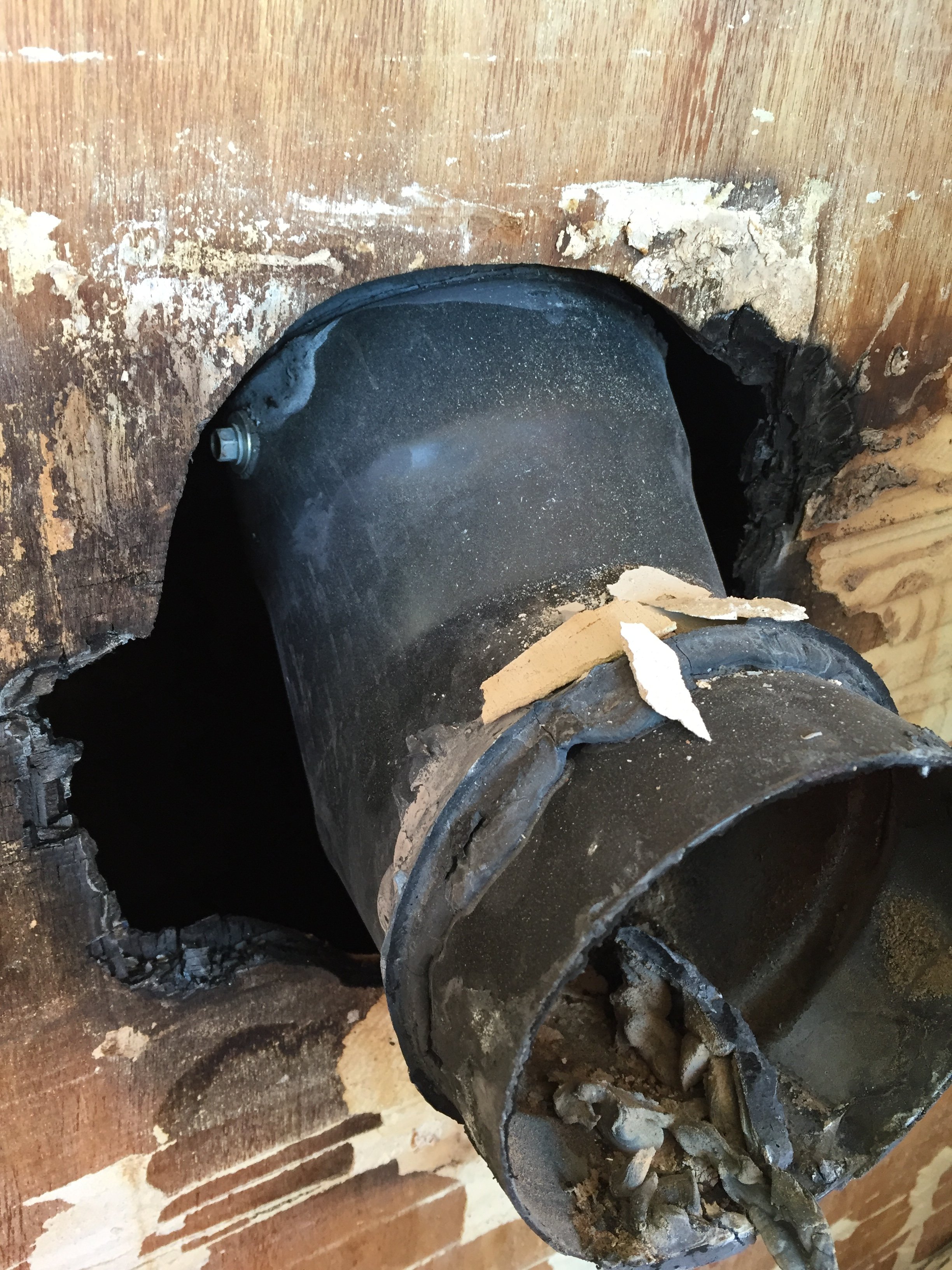

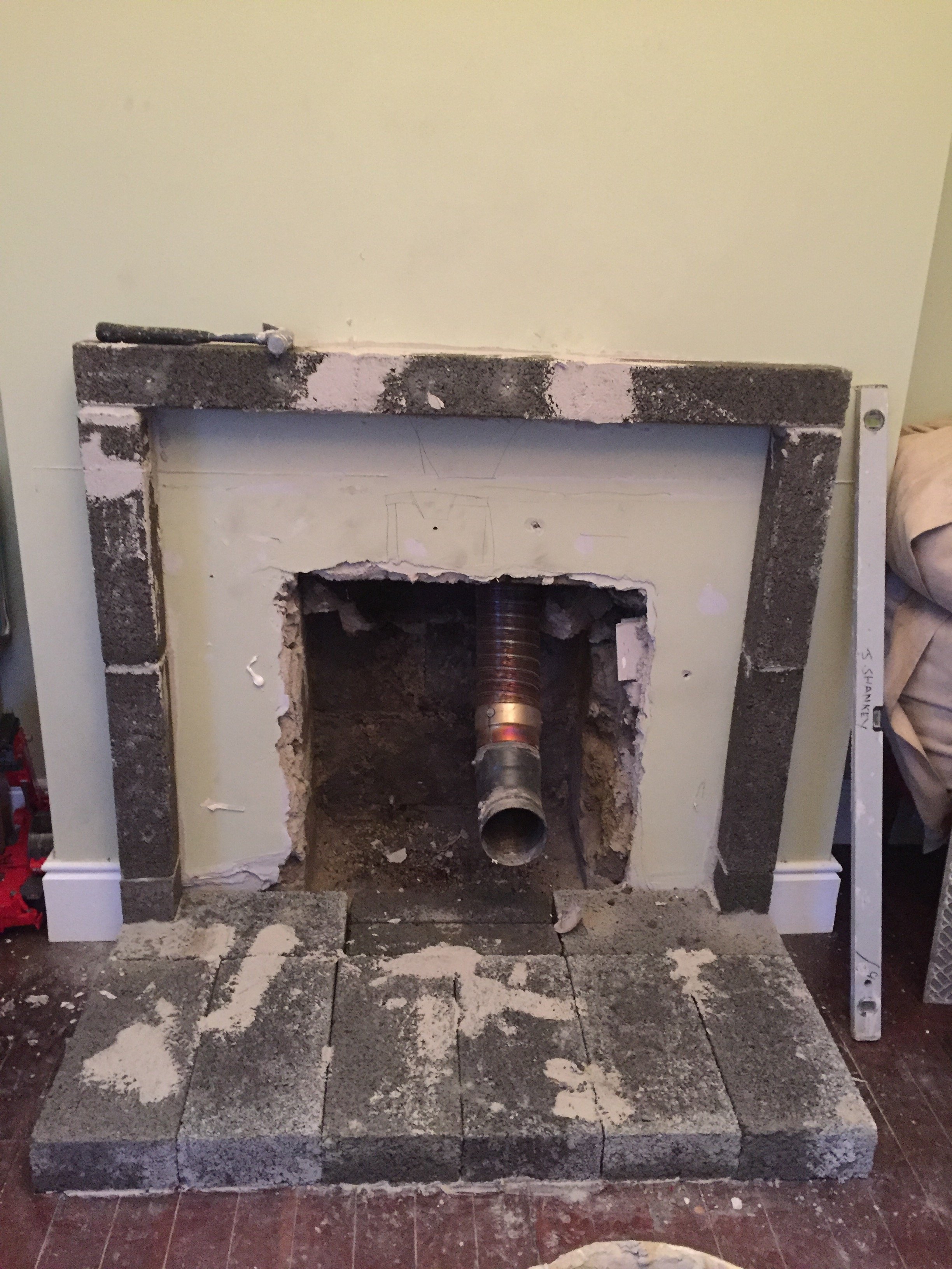

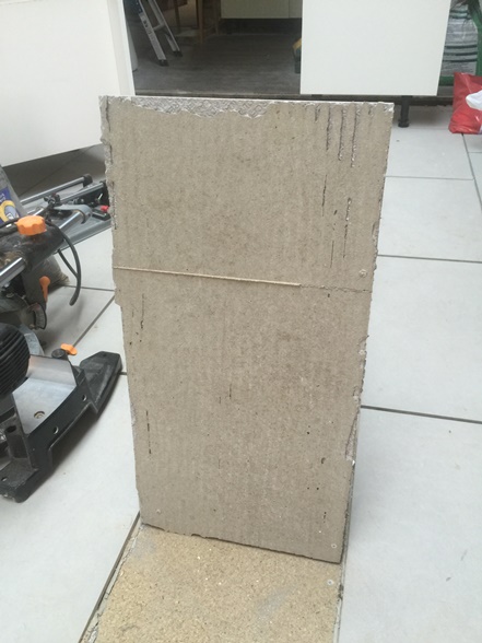

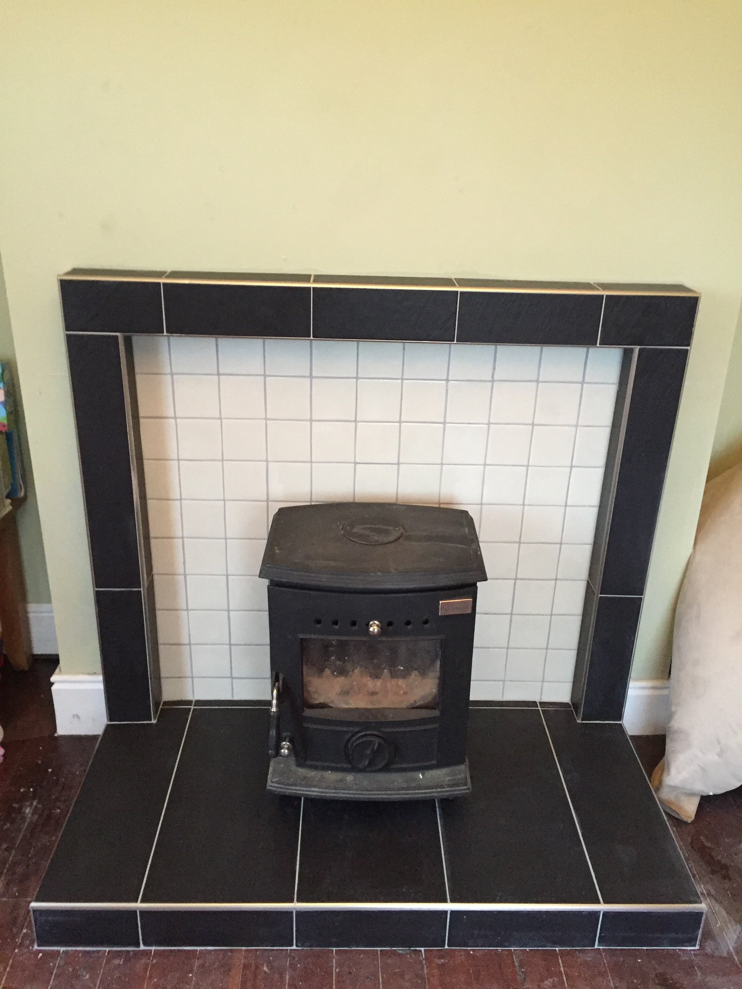

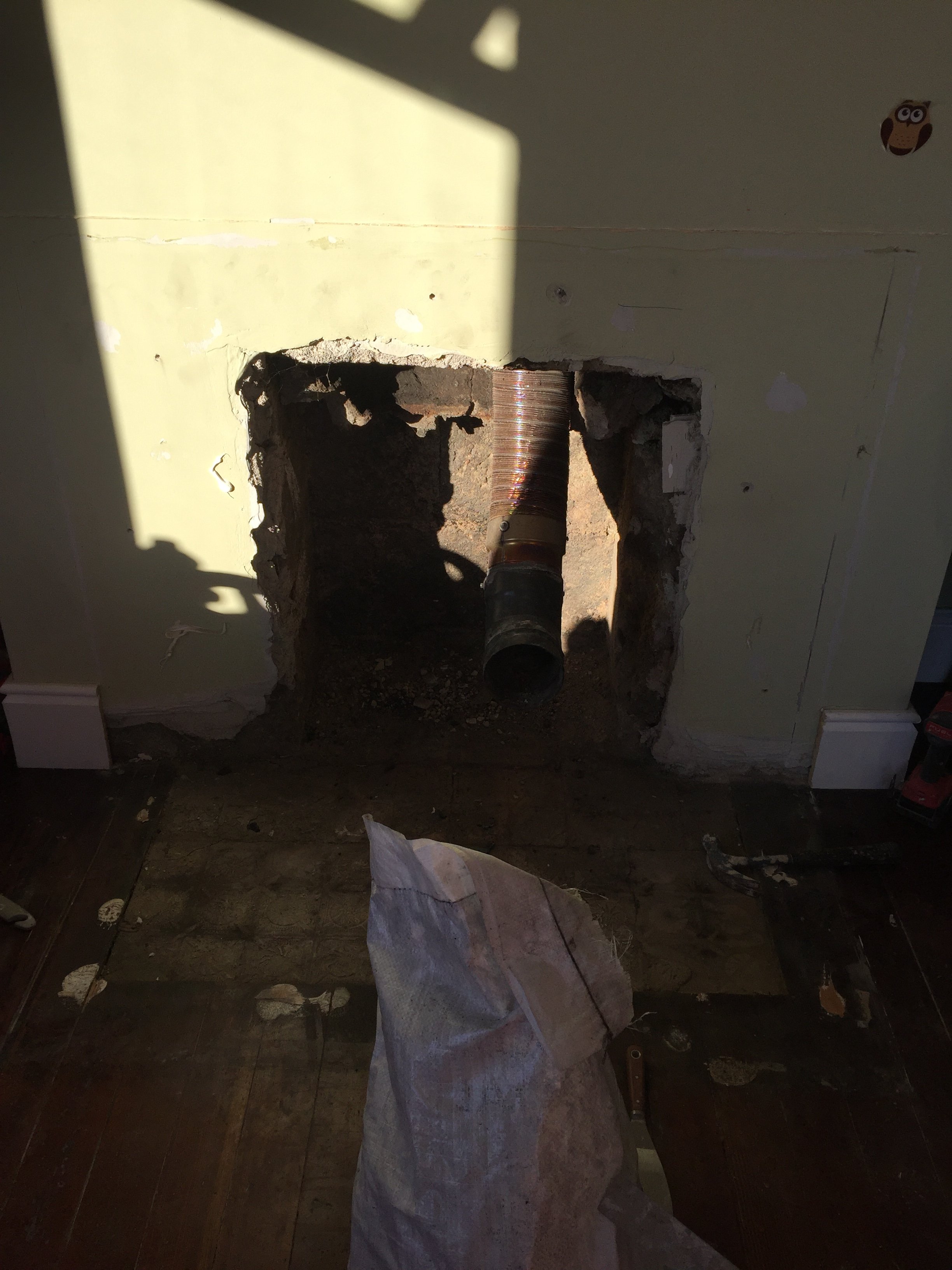

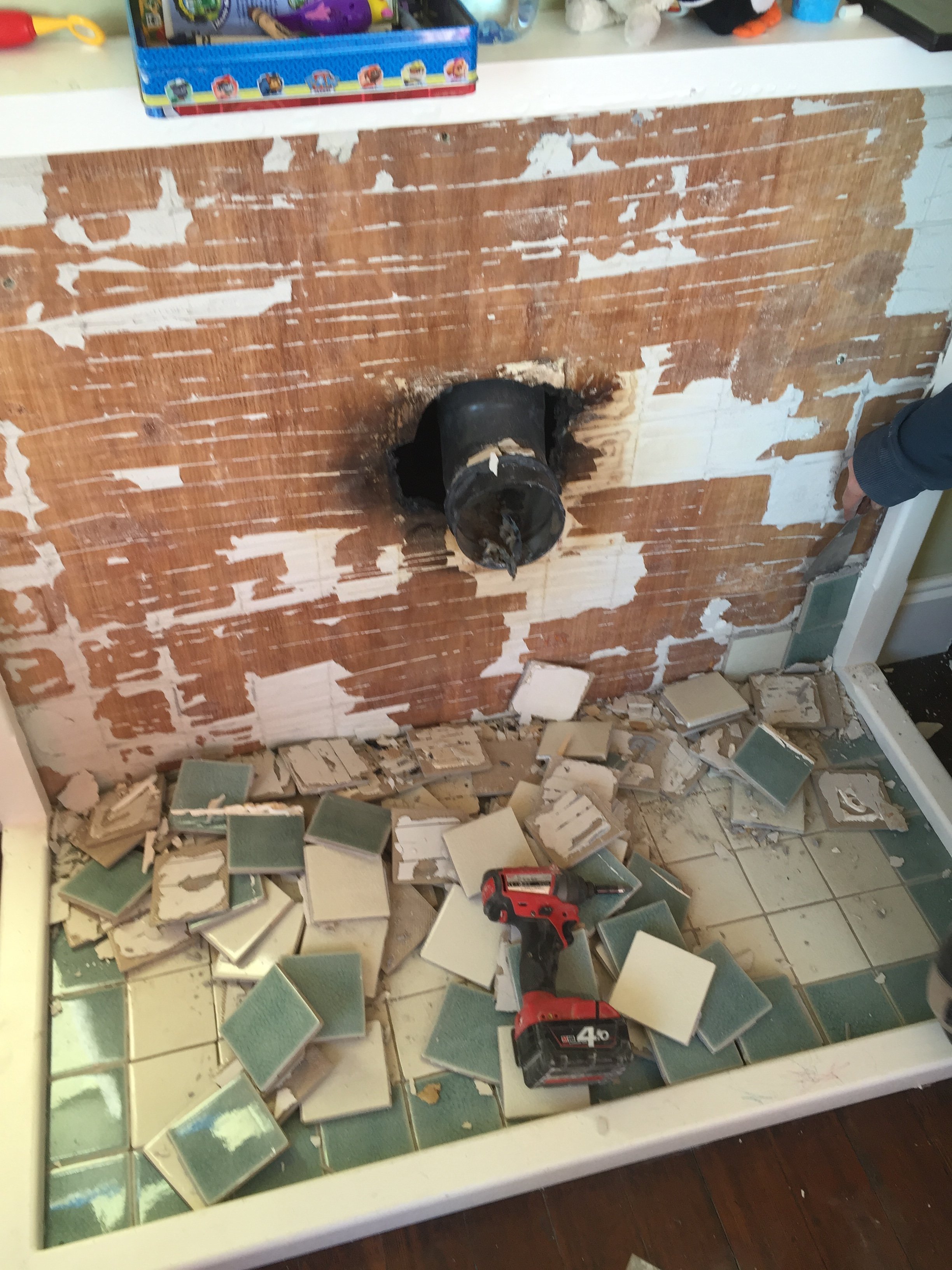

This is in a kids play room, all of it was done in timber, the back the surround and the hearth what an idiot. This is how I done it, it won't go on fire now at least.
I used cement board at the back and tied the blocks together with mesh
