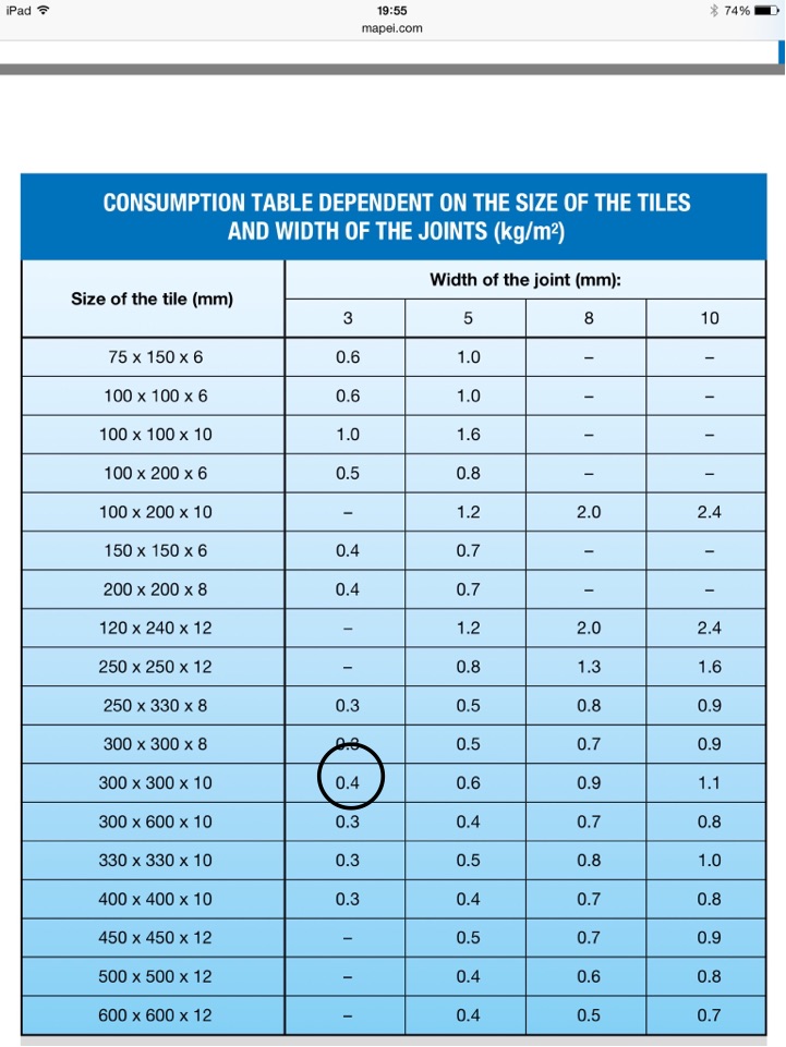

6.5m2 30x30 11mm thick tiles with 3mm joints
A 3kg tub is ample for that isn't it?
I wouldn't say ample Nick but reckon u should make it.
Consumption for 30 x 30 x 10 x 3mm joint per m2 is 0,4Kg
0.4 x 6.5m2 = 2.6Kg
So that leaves 0.4Kg for your extra mm
72.33 % in excess.
Over ,X3 times over, well ample 🙂
3 times over, am I reading this wrong then?

There calculator for there above mentioned product confuses mm and inches? I believe that if you enter the mm required into the metric side,( Although in brackets it says to enter it in inches),you get the correct results, when compared to the above chart from 3-fall.
Therefore,23.73% in excess only. Furthermore, when looking at the formula they use, that confirms this. Although oddly,(but only slightly)there formula and calculator do not seem to add up exactly.
