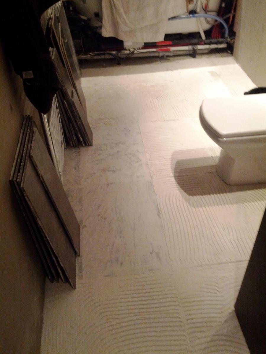

I spent two full days preparing the floor for re-tiling. I was in no position to self level again to the floor height, so rather than attack it with hammer and bolster, i used a heavy duty scrapper with replaceable blades to scrape the old adhesive of the floor. I wouldn't wish this job on anyone!

I work away sometimes and unfortunately the tiler started today whilst i'm away. I received a call this morning from the tiler and he told me that the tiles have all been laid out and we have 6 x tiles with serious chips! I couldn't believe it, as i was the one who cleaned them all up and didn't notice any damage! To be fair i was doing this at 9pm and had been working on the floor since 8am so i was hardly in the best frame of mind. The tiler sent me some pictures of the damaged tiles and they simply cant be laid so i have ordered yet more tiles! The tiler has packed up and will come back on sat morning to do the floor as luckily i can collect the tiles during my work trip and bring home Friday night. The problem however is the tiler will only do the floor first, doesn't work Sunday's and is booked up for the next 2 weeks so looks like i won't get this finished by the end of the month.

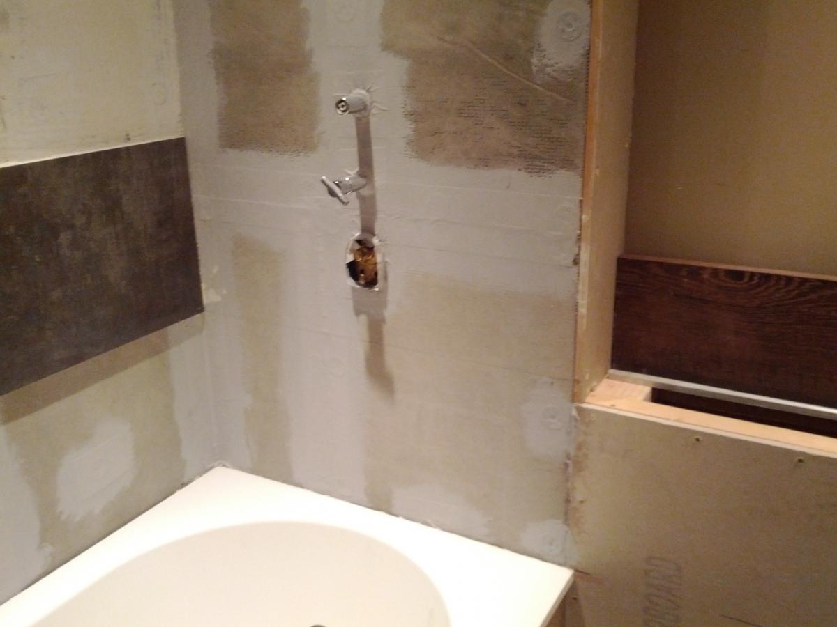

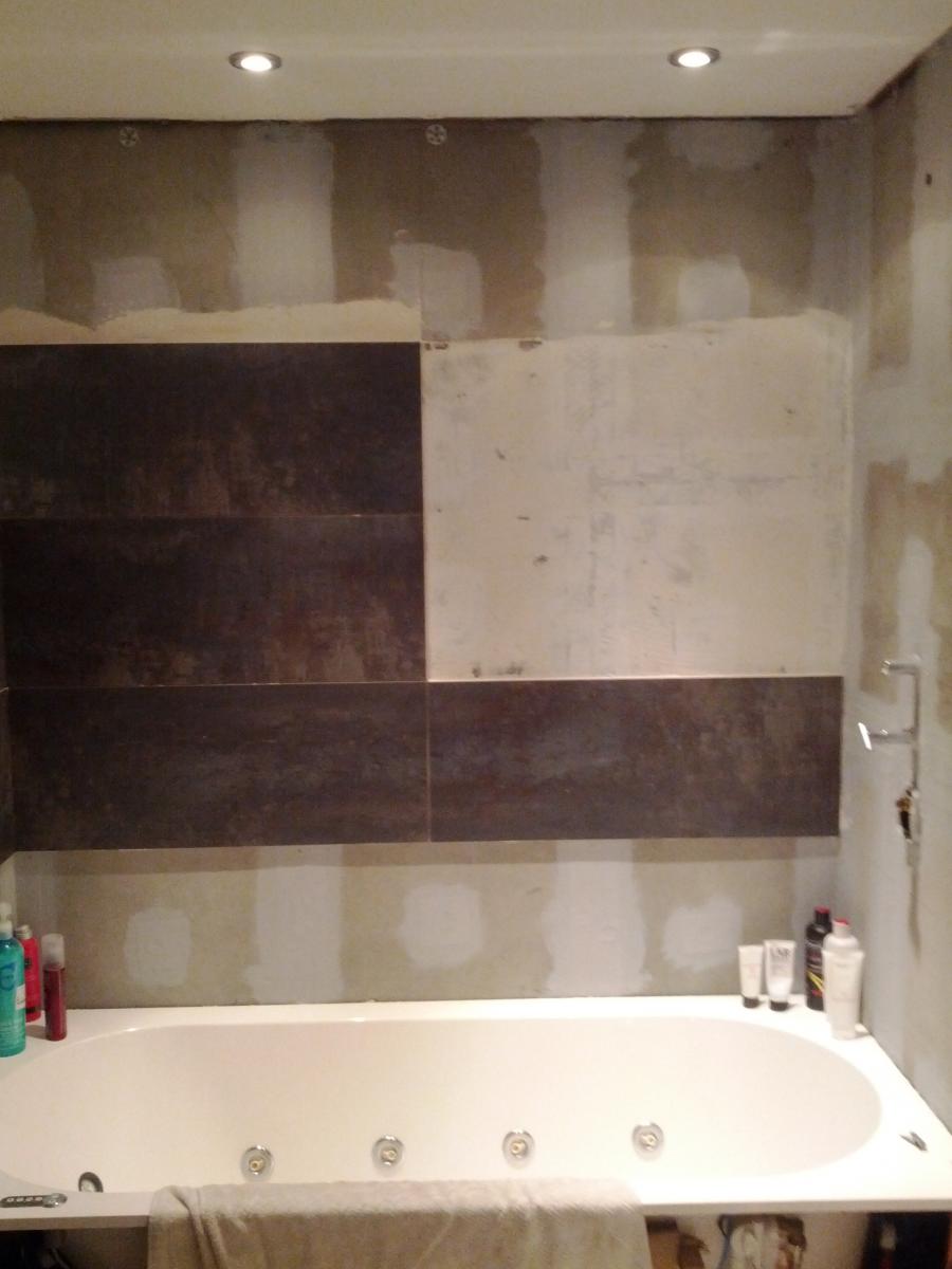

Looks like the starting point over the bath is relative to the window sill? Have no idea why he would start it like this. I don't fancy shaving what looks like about 10mm off the tiles cutting down to the bath. Whilst i think about it, what is the height of the bath? It might be the perspective of the photo but it looks awlfully high. Average bath panel is 20"-21". For sanity purposes just check the height mate.
Think the wall tiles around the bath are going to have to be removed really. Asthetically your going to have, what looks like around 1/3rd of a til to cut to the ceiling (100mm) and your cut to the floor looks about double this. This alone, and as others have stated, doesn't look like a pro has done it. Add about 2" to the height of the top cut and it'll be about right top and bottom. This will however leave a cut under your window sill of the same. Good solid porcelain like you've purchased should cut and fix nice of that size though and won't look out of place.

Hopefully this pic will explain why the tiler laid out the wall tiles around the bath in this way. The plan is to raise the box section to accommodate a full tile at the top, then a chrome strip and then 2 x full tiles at the bottom to the floor. There are no windows in the bathroom and yes a 10cm strip will be seen at the top of the walls around the bath.
I honestly dont know what to say to all of that. It has to be the biggest dogs dinner of a small job I have every come across!

does that not leave a small cut down to bath ,

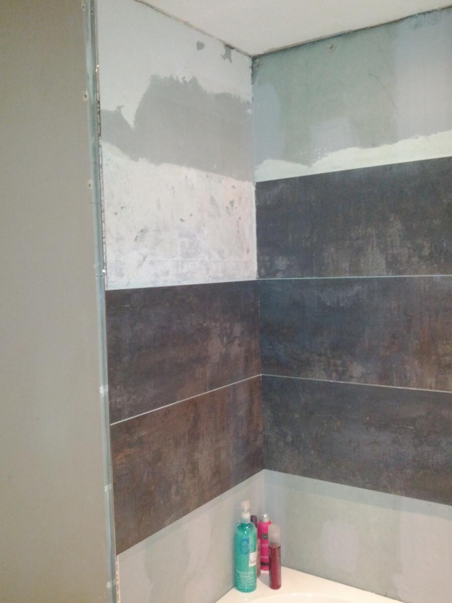

From this picture it doesn't look like the tile over the box work will line up with those already fixed over the bath.
