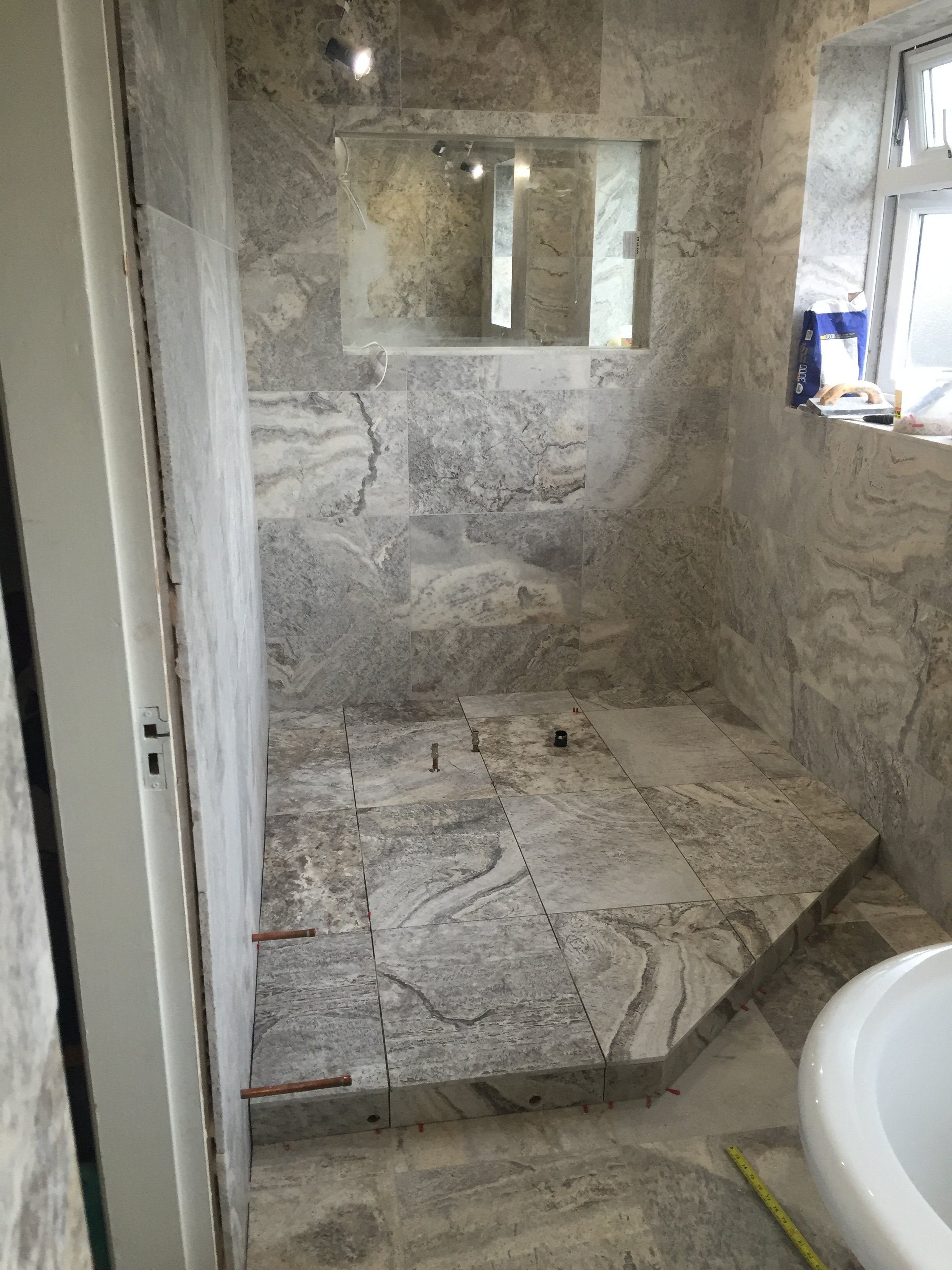

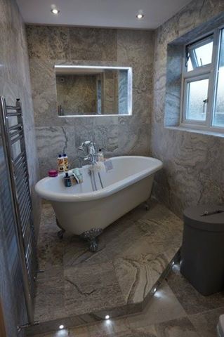

Sorry I have no before or during photos but here is one I did not long ago...soft as turkish ceramics..... no decoupler fixed in sand and cement onto a concrete base......

As for seeing it a year on ..........this job is from June 2014..customer hasn't called to say any problems.......so I take it is still perfect.
June 2014?? You stated that it wasn't long ago, I wouldn't like to hang around waiting on you for a meeting Tom!! :tearsofjoy::tearsofjoy:
