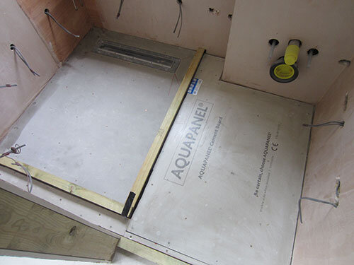

That is the En-suite.............and its ready for tiling......yippppeeee!
and here is the Master....
not quite there yet.....but i should have that sorted tommorrow!
all the best lads
Lee
Whats with the ply walls Lee ???
the guy is a self builder.......what can I say.....not only is it ply but it is "shuttering ply!"........eeeeeewwwwwww......But I can sort it out........ overboard!........
hehehehheheee...
Lee
They use a system like that in New Zealand, i saw it loads while i was there. It was good.
if you saw it there.......its the way to go........they have ledgeslation on tiling and wet rooms and everything!

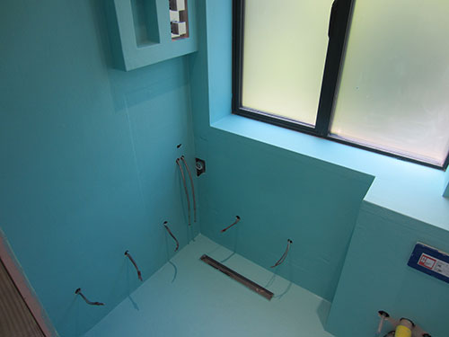

Evening All......just home from another day in the sticks.....been great TBH........nice weather always helps.......here is what went on....
first off I finished the tanking in the master bathroom and adjusted all the lighting holes so they are level with each other:
I have to plug the hole on the bath platform (under the window)......do that tomomorrow!!!........forgot to do it tonight!!!...doh!

dont worry lee i will get over it nice bit of cutting .what power is the self build client going to run through all them cables comming through the wall in a shower they look like 1.5 mm lighting cable 240 v
Well...........ahem.........ahem again..................
at the moment Ray they are 2.5 twin and earth.........and the lights I have seen do NOT have transformers......and even if they did.......how would they fit through those tiny,tiny holes?.......
I could go on.....but I wont.............
OMG..........I am now (all of a sudden) feeling guilty........it did not even occur to me today as I was just trying to "get on!" (I am just the tiler!)............he has kids Ray.........and this is their room........I have to stop............OMG......talk about blindsided........
Buuuuuuzzzzzzzzzzzzzzz flashhhhhhhhh BBBBaaaaaannnnngggggggggggg !!!!!!!!!!
